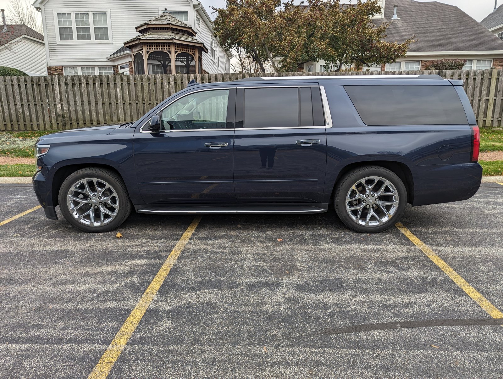

2018 Suburban Premier, 4WD with towing package
Measured from the ground to bottom of fender opening at the CL of wheel
DF 35-5/8" --> 34-1/2"
PF 35-1/2" --> 34-1/2"
DR 37-5/8" --> 35-3/4"
PR 37-3/4 --> 35-1/2"
