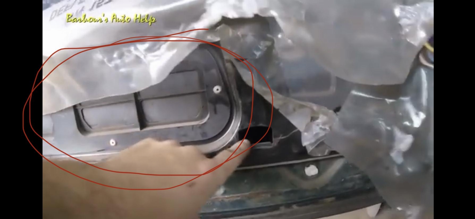

I’m tracking a water leak on my 98 two-door. Water splashes onto this plastic vent thing and then comes out the hole for the door panel clip. From there it drips to the inside weatherstripping, overflows and floods the carpet.
Here’s what mine looks like. The plastic vapor barrier is perforated and there’s a plastic flap inside the interior door panel.
Some of the trucks on YouTube have a vent thing riveted on. Is mine supposed to have this?

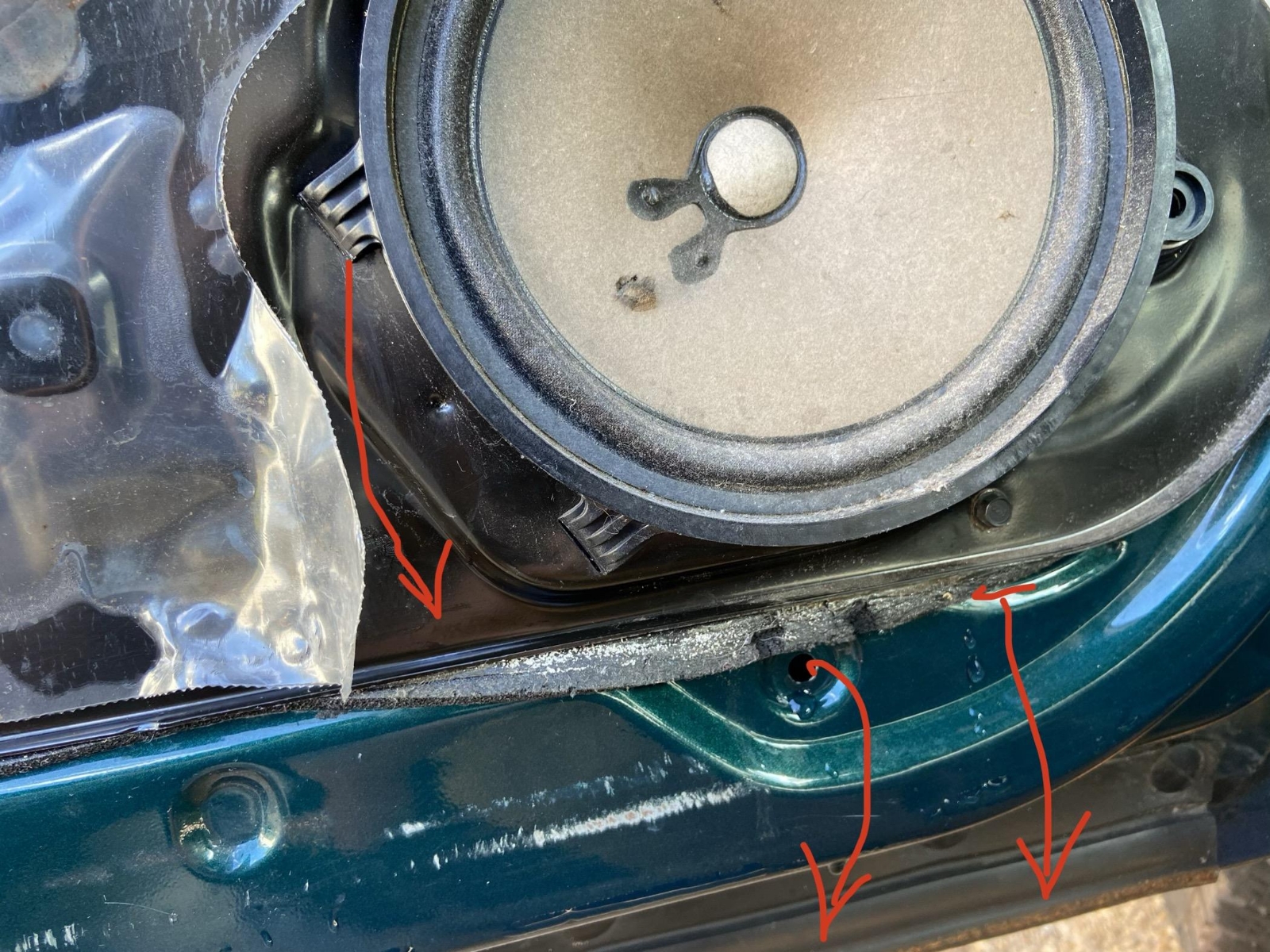

I’ve ordered a new strip for the bottom of the window glass, maybe it will help. The problem is water splashing over everything in the door and leaking out. Drain holes are clear. At last count, it comes out two door clip holes, the speaker and the bottom of the inner door panel where the seal looks to have been poorly applied in 1998.

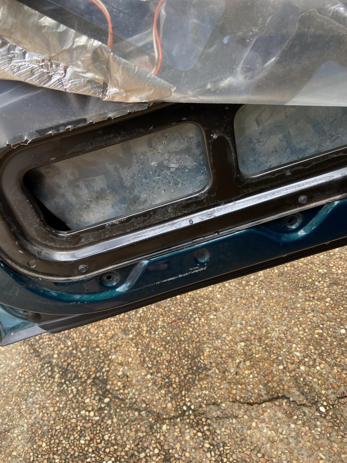

Looks like you have the rivet holes and sticky residue around the perimeter of the holes where the vent would go.... I wonder if previous owner.... or body shop... removed it and never bothered to replace..

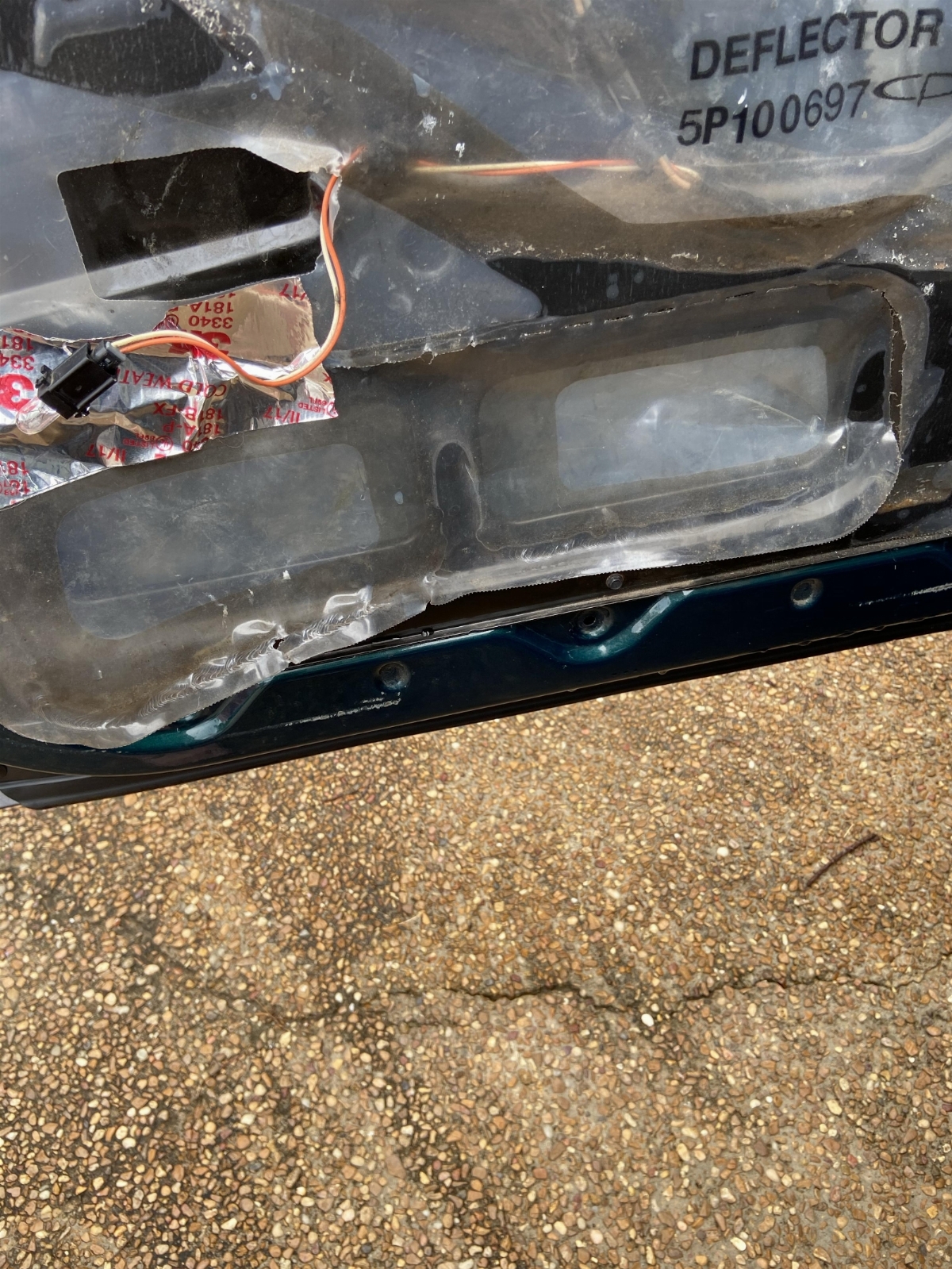

Thanks, I see the rivet holes that you mention. On my truck (extended cab) it has the riveted vent thing and the outer door plastic does not cover it.
On this Tahoe, the openings over the vent are perforated but not removed. The adhesive stains are from that plastic sheet. It may be that the Tahoe/Burb needed a larger vent opening and the smaller truck vents weren’t used. Beats me.
So I replaced the door strip at the window glass and nothing changed. The problem is that water is splashing over all the stuff in the door and coming out.
The vent plastic is cut at an angle, so water is directed along the edge straight to the door clip hole.
And then there are the mystery leaks around the speaker clip, the dislodged gasket and then a leak through another door clip hole. This is dumb.

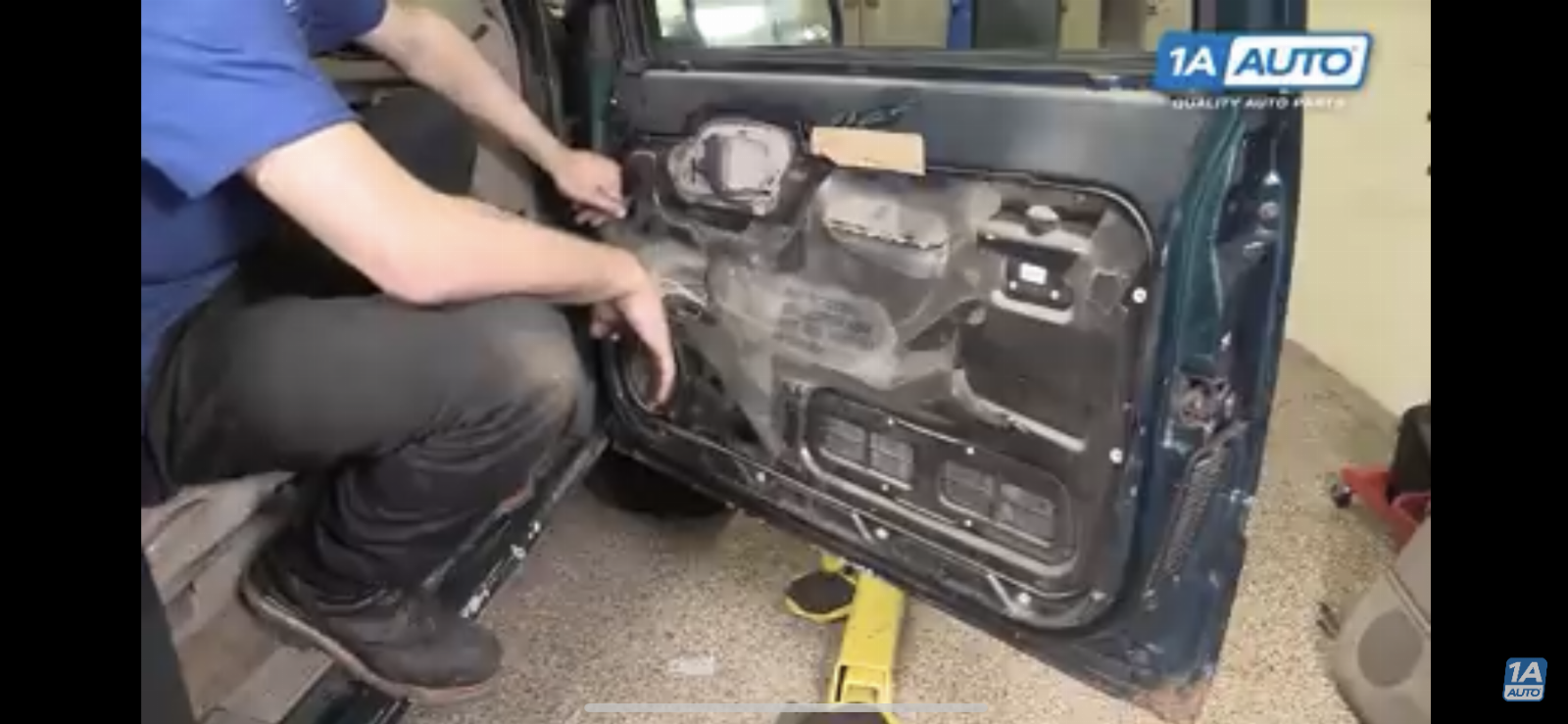

FWIW, I happened to have the door apart on my 1997 K1500 truck and it has the vent riveted in.

I’m thinking pickups have it because there is no vent in the rear of the cab like in the rear of an suv. May help In the pickups with the whole vacuum effect when closing the door...
