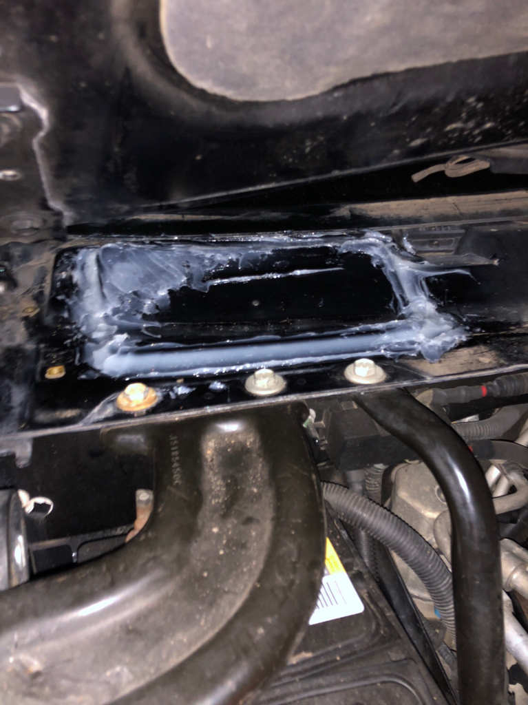

Everything was grand, then when vacuuming after a car wash, after a Texas Downpour, I noticed the carpet wet...

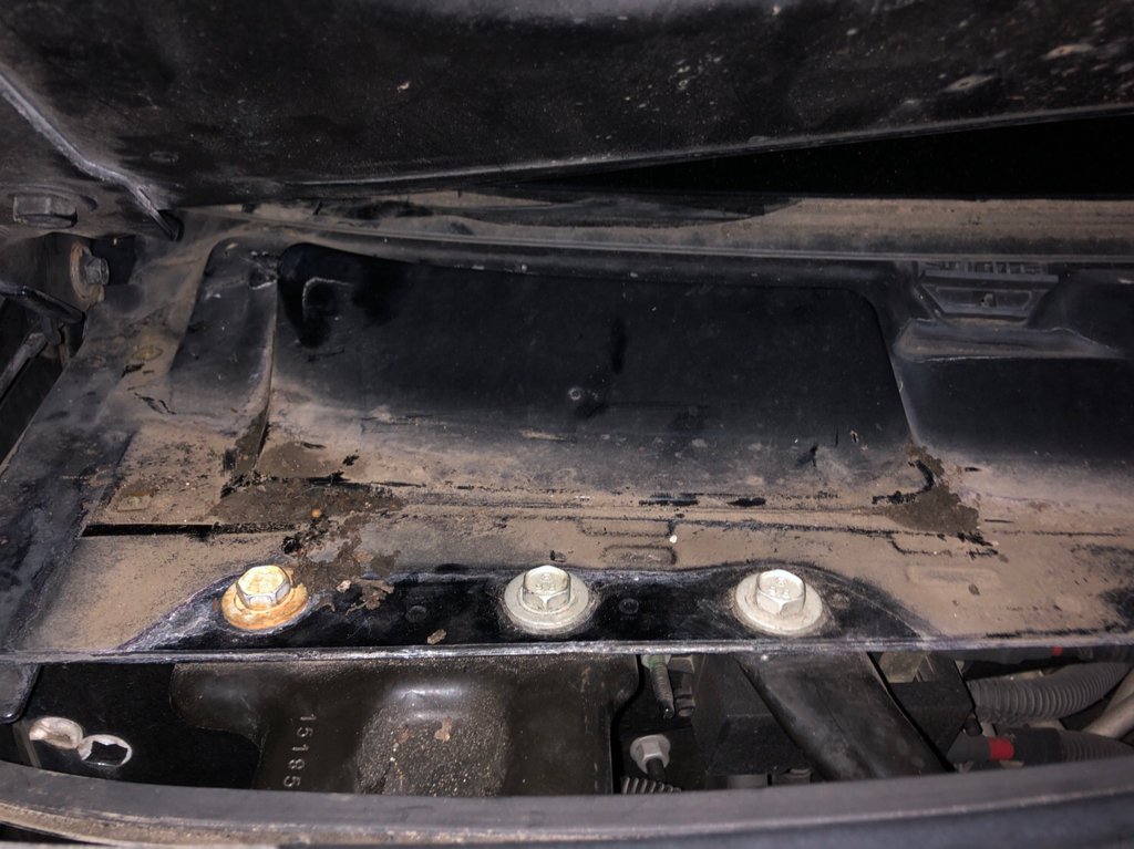

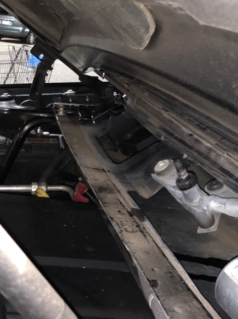

I removed the cowl
(wipers were a pain - tip - hit the nuts with WD40, let sit, and wiggle back and forth, they will come off, just keep trying) - also be careful of the wiper washer hoses, one got disconnected. I did not remove the cowl entirely, I just let it rest on the windshield, did not want to fuss with the hoses for the washers.
I noticed the cover, over the HVAC intake had gunk around the seal. I cleaned then siliconed over it.... then, after doing that [emoji849], I was googling to make sure I fixed it... I realized it could have been a multitude of things :
HVAC Intake seal
Gunk in the weather stripping (top of door)
Sunroof drain clogged
Cowl drains clogged causing flooding into the intake.
Turns out as I inspect each item- they were all probable causes, except the cowl drains being clogged.

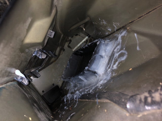

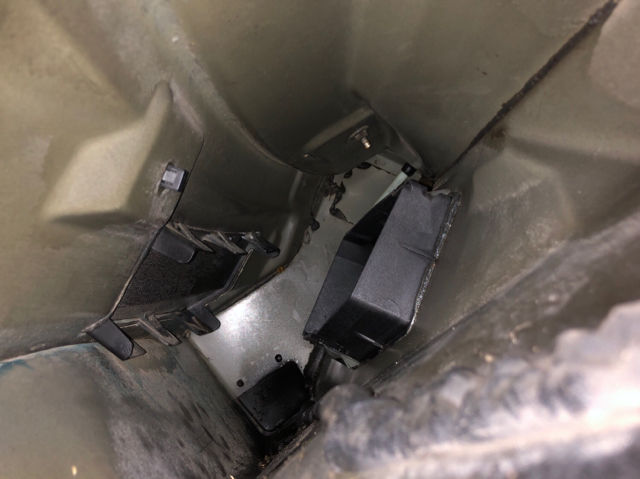

I undid my silicone seal on the cover plate to get under the cowl and asses the intake. The seals also had the same wet gunk look.
Then proceeded to clean out a little junk. Then bought a whole tube and went crazy with it to seal it all up around the outside of the seal for the intake. Apparently this is common in many other make of vehicles 10+ years old, Texas heat and rain type thing.

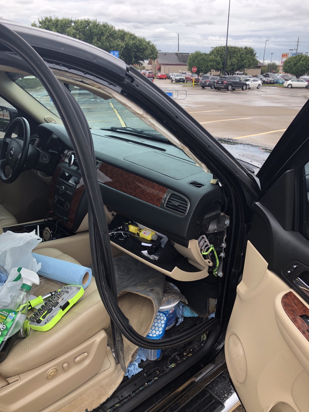

Then proceeded to check my weatherstripping around the doors and windshield... disgusting... there is no way water was evacuating right with all that gunk 27 towels later... they are clean.
Then I checked the sunroof drains, sure enough the passenger side was clogged. Pulled the tube and used my lungs to blow out a bunch of crap.. sprayed cleaner down it... repeat.
There’s no doubt in my mind all of these played a part, and least one was the primary cause for the leak... but it should be water tight now. I have no idea why the passenger side was so bad, I checked the driver and it was much cleaner!?!?!?! Maybe it was parked consistently next to a dirt factory on the passenger side.
I also bought a huge “damp rid” bucket from Walmart when getting the silicone. Sat it under the foam and carpet to dry things out, and I’ll be dammed.... while I was fixing the outside stuff it dried almost all moisture. I’ll leave it in the truck until it starts filling up, if it does...
Either way, as some of you know I’ve been through a crap load with this 104k mike 07 LT. I do pray it stays reliable, and feel good knowing I have caught up on all the maintenance with it.
Question, why does the vent stay OPEN when the truck is off, I don’t get it!
Here’s a before and after, my hands are big and I did this in a hotel parking lot as I’m on the road right now, it’s the not the prettiest... just call me “Picasso”

@kbuskill @swathdiver .... mind blown!
Thanks for that info... good to know I’m not crazy for asking. It’s looking like I need a tech 2... one day I’ll spring for one.
The leaks were much better. But I definitely had the weatherstripping leak found in other search’s. Ended up going crazy with silicon after cleaning to stop it again. Had to go through the car wash a few times with everything apart to make sure I stopped it.
Also siliconed the sunroof drain at both ends. Just to make sure.
Funny thing... my ONSTAR light is now permanently green so far. I tried everything but the VCIM and antenna cable to fix it... then just let be due to other issues. Either the water got dried up from the damprid, or I wiggled the cable enough to solve it. Who knows. Happy to see green.
