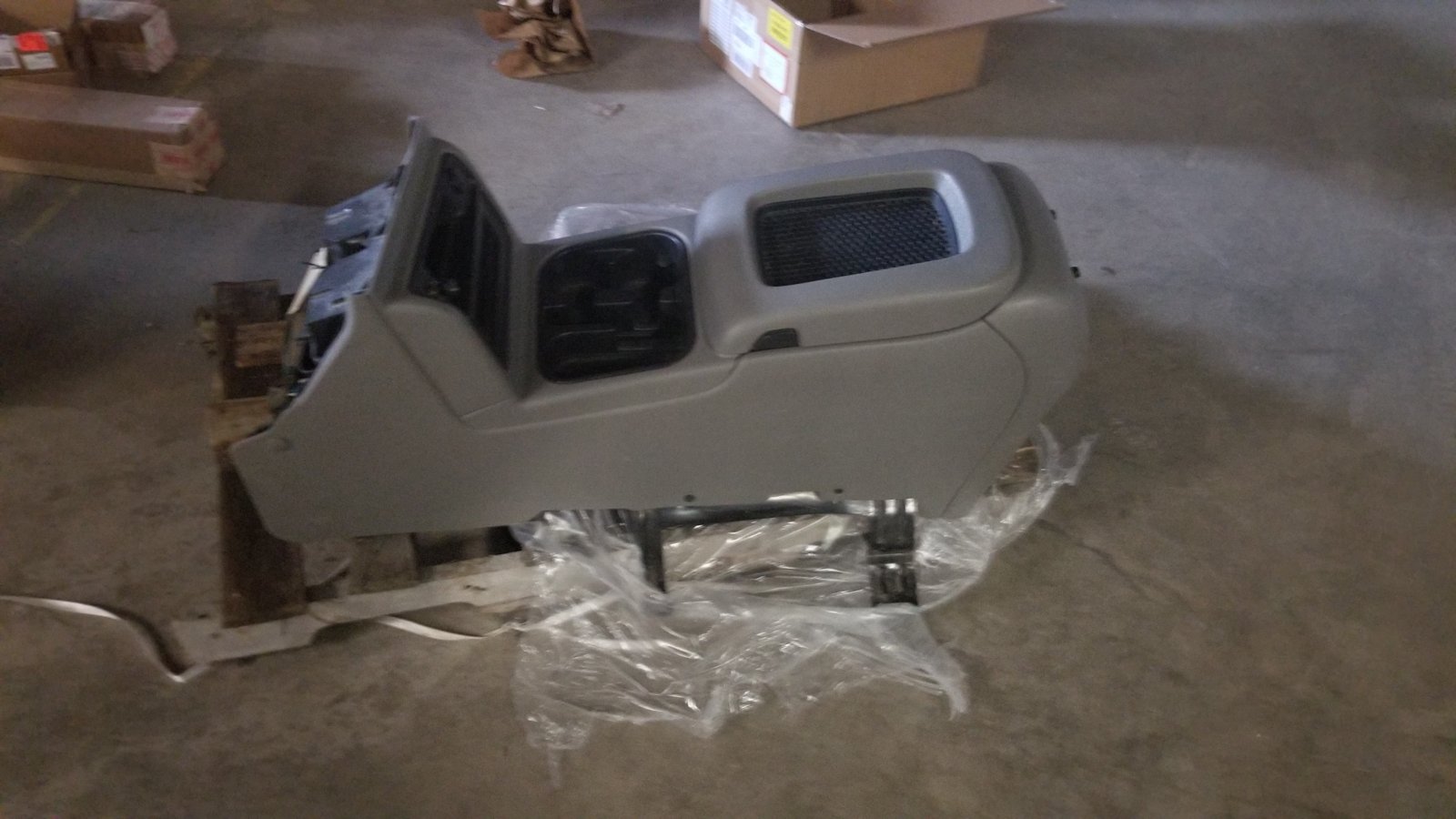

haven't had a lot of time to work on truck but I did get a center console for my truck, order some wire, and supplies so I can work on replacing bottom cubby with a single din. Once I have that moved I can work on installing the Android Auto, Rpi3 computer. slowly but surely getting there
Pretty sure that console has a Bose sub and amp in it.

haha yes the console has the sub and amp I need to get them stripped out.

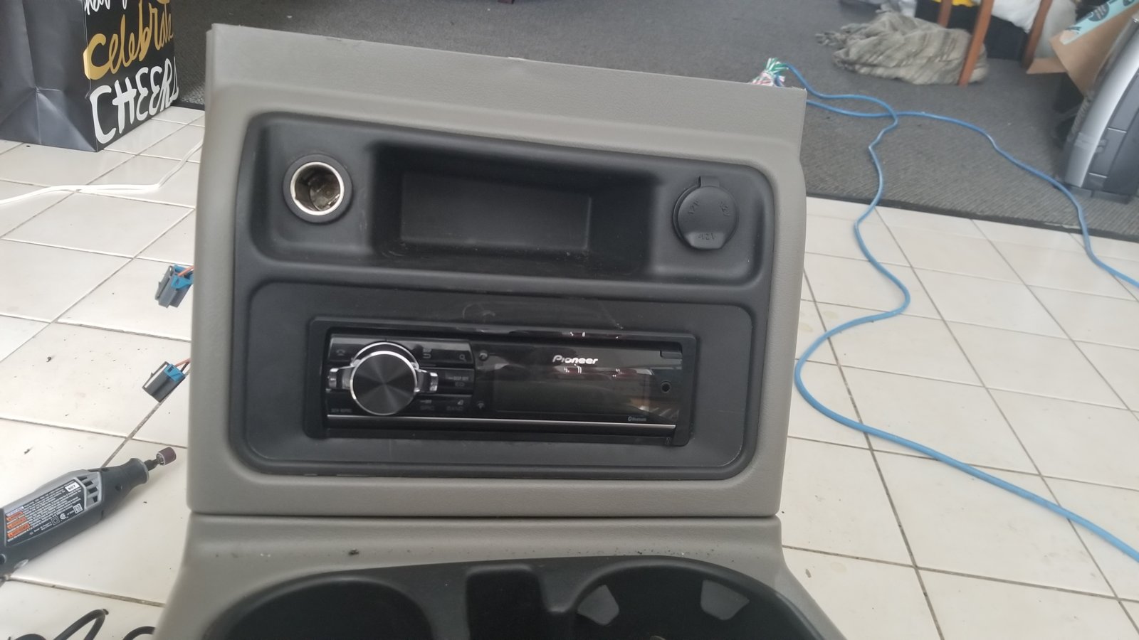

LOL, Well Ive made more progress on my stereo this morning got my 80PRS unboxed and started modifying center console to fit the single din stereo. there is a small gap on the passenger side that the ill need to figure out but it looks pretty damn good so far
Here are the results, i need to make a couple of extension cables for the stereo and i will be ready for a test fit in the truck

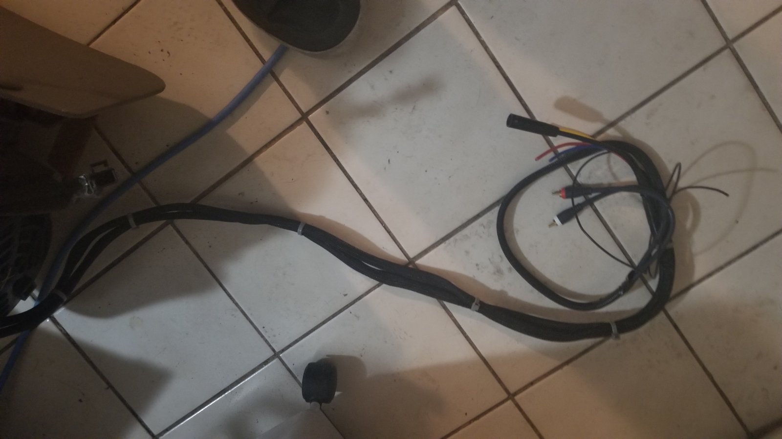

finished up my prep work for install extensions have been made for stereo harness and loomed up. it was 5 degrees high today couldn't drag myself to the garage to start install plus still waiting on glove box assembly to show up.

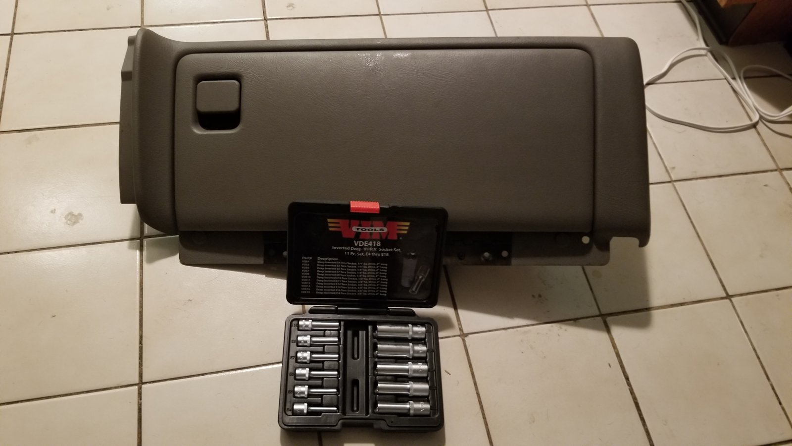

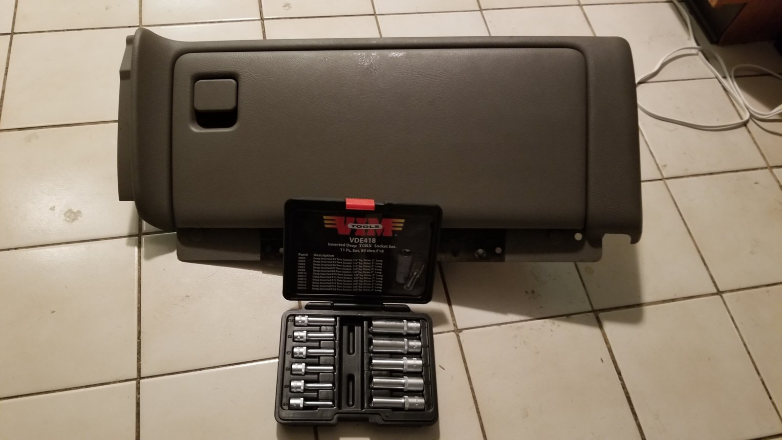

Well, I went to put the center console in today however. Aparently you need a e16 deep well for seats.

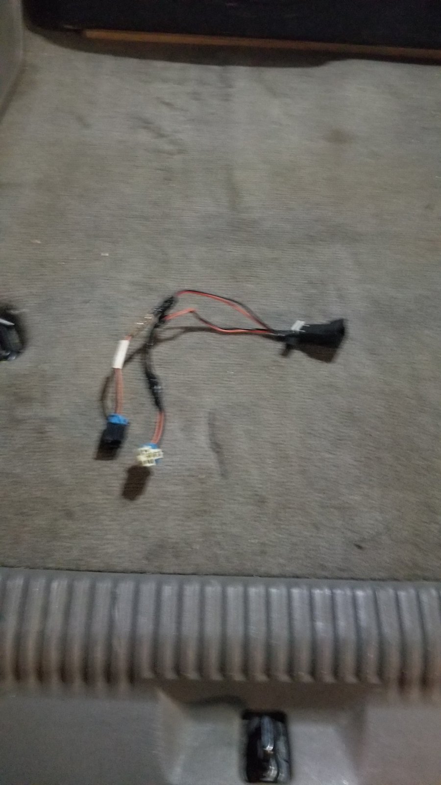

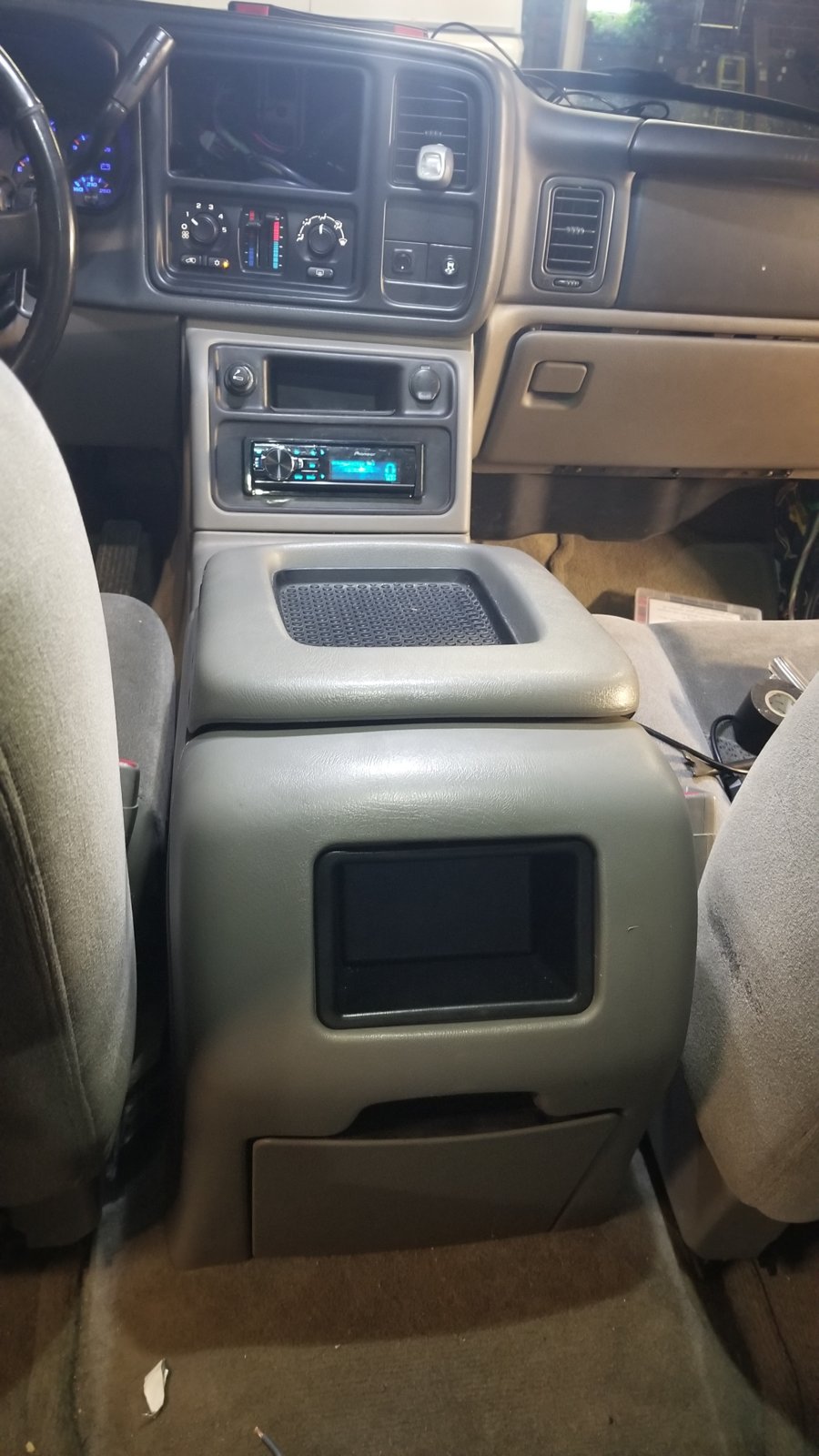

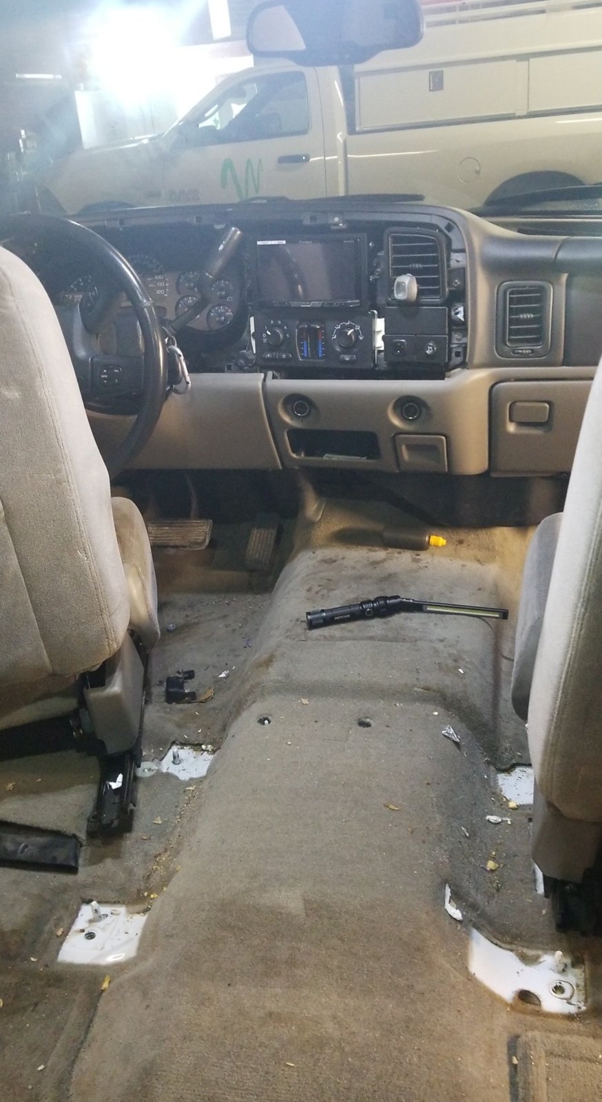

Well today has been productive and busy I got my center console installed, stereo moved down and ready to get the car computer installed fought with seat bolts more I found that it wasn't even an e16 for the front they are e20's however a 15mm worked to get the bolts out
Bench seat is pulled
After a good vacuum I got the console in and bolted down.. I did have to snag the harness from my glove box assembly to get the front two 12 volt ports working
Hopefully tomarrow I will get some time to get the car PC put in but I am all prepped to get it installed :)
Oh and I ended up flipping the cubby because I didnt have the rubber piece for the bottom

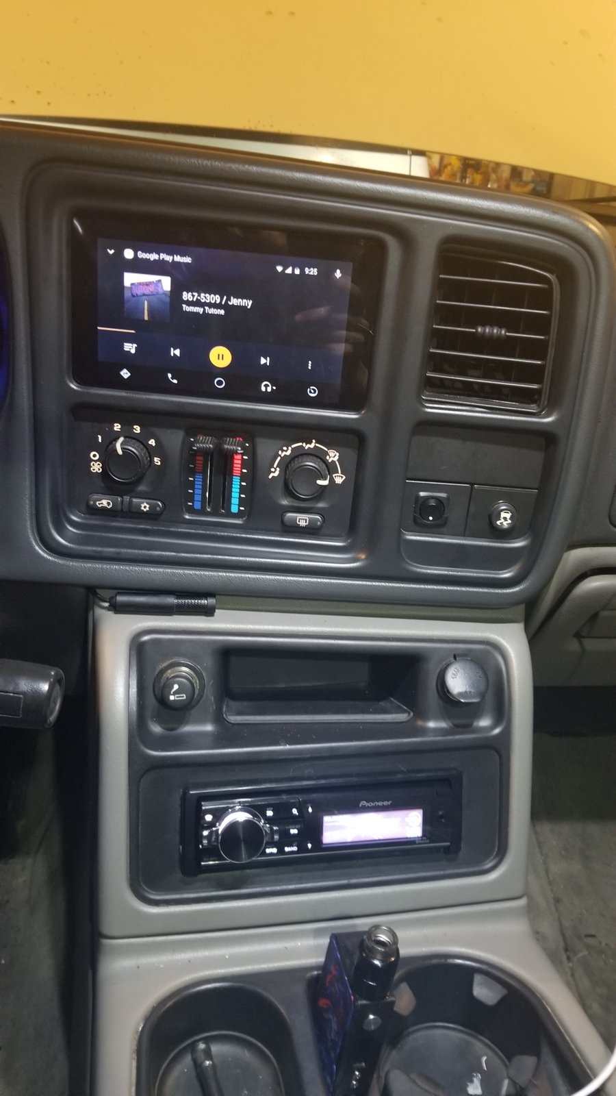

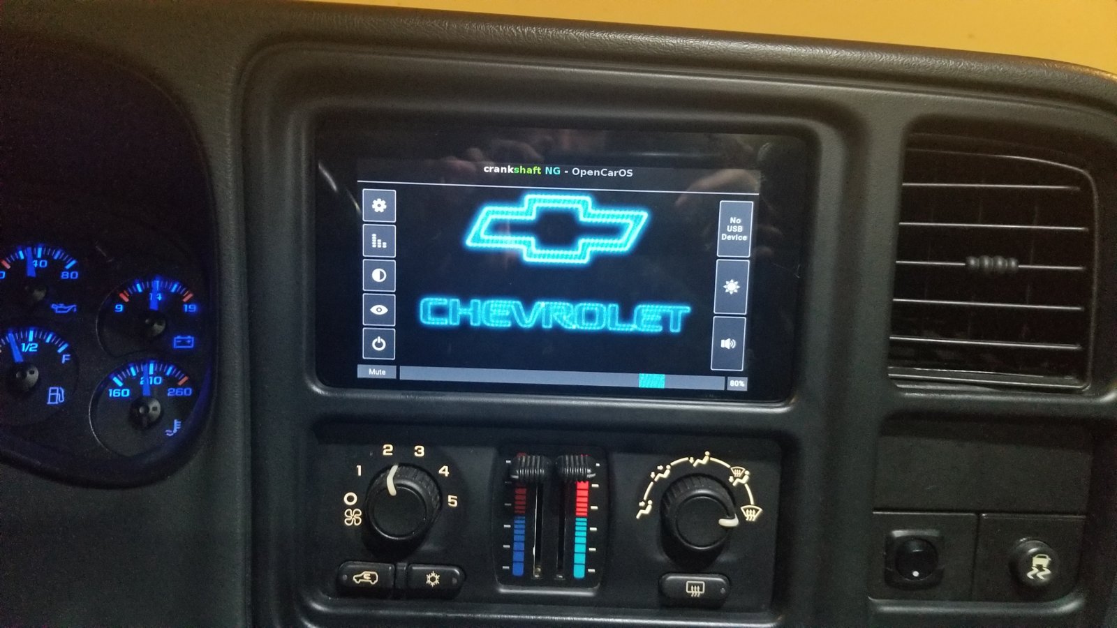

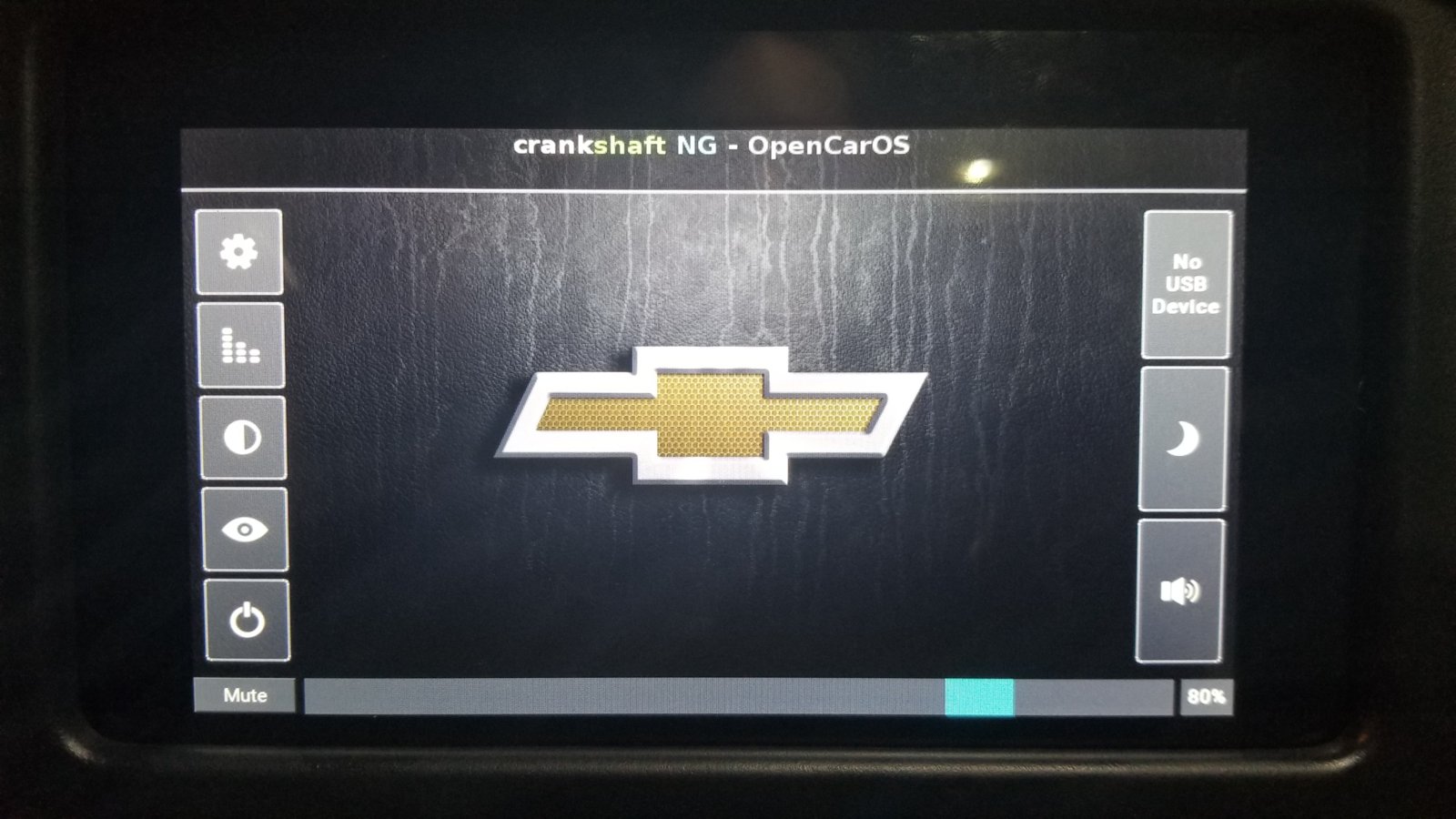

WhooooHoooo!!!!! :boti: it has its test fit in and is up and running =) I only fought the simplistic most task in installing I set up all my relays for positive trigger forgot to test at the bcm it is a negitive trigger for the headlights it's ok I set my night mode to run of the time for now.
