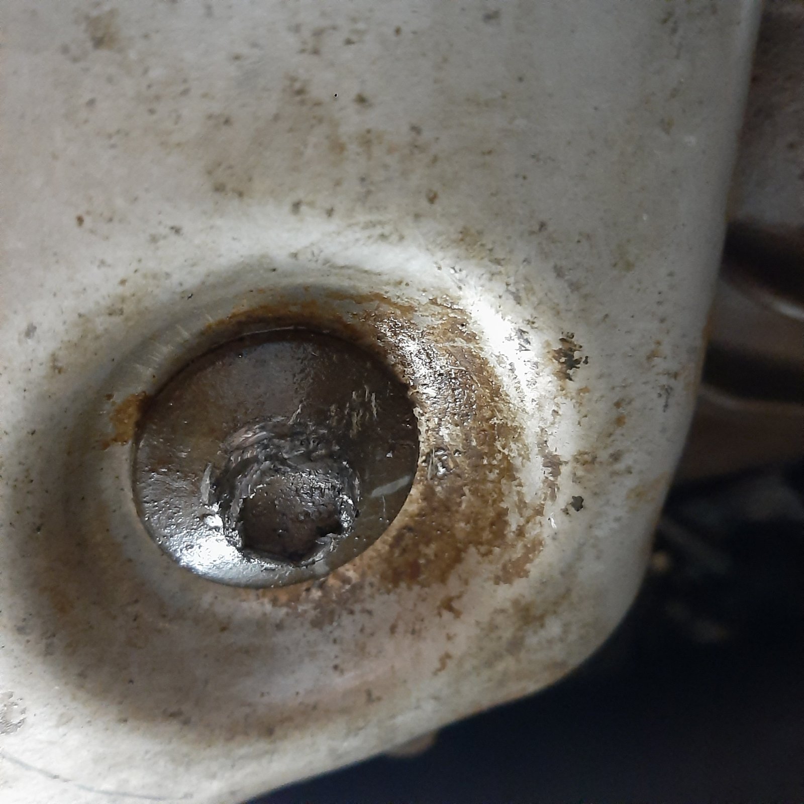

Well, latest curveball. This truck is good at throwing them. I got an easy out. It just rounded the head on the transmission pan drain bolt haha I hate to drop this and just have transmission fluid go EVERYWHERE. But maybe I just need to take the pan off and say the hell with it? Otherwise was thinking of trying to get a pump down the dipstick tube.
Weld a bolt to the trans plug, I've had to do that before on a customer vehicle.
I had thought of that and have a welder. Just a bit nervous about welding on truck with ECU, gas tank, etc. probably more so because I uave about 30 seconds of welding experience.

The factory started installing those bolts with a thread locker that will not submit to any amount of force or heat known to mankind. There was some reason they don’t want them to come out, I forget why. You can get a Dorman pan with drain plug for cheap at most auto parts stores and although I stay away from their crap in this case it was a good thing. GM doesn’t sell a pan with a drain plug.
WOW, that's crazy! I kind of like the simplicity of the 4L60E... Take that with a grain of salt, as I've not rebuilt any transmissions haha Although 4 gears, versus 6 or more in newer transmissions.
I got mine out using this with a long breaker bar. CRAFTSMAN 5 Piece Bolt-Out Bolt/Nut Remover Set With Case 952160 Tool Kit NEW 24721521606 | eBay
I guess I found the right amount of force with ingenuity, & no heat, and a LOT of patience to get my 04 Tahoe factory original one out. It was a real ***** to get out and I almost gave up, but now that I've used it multiple times, glad I didn't throw in the towel. I didn't see any thread locker on the original when it came out. The way I heard it, it's the O-ring getting stuck to the bottom of the pan from heat cycles. I've since had it out 5-6 times to 'refresh' the trans fluid every so often. Pulling that plug drops about 3.5 quarts out of 8-10 total in the trans and converter. I have a handful of good cond, original drain plug bolts that I harvested from dead vehicles.
I guess I found the right amount of force with ingenuity, & no heat, and a LOT of patience to get my factory original one out. I didn't see any thread locker on the original when it came out. The way I heard it, it's the O-ring getting stuck to the bottom of the pan from heat cycles. I've since had it out 5-6 times to 'refresh' the trans fluid every so often. Pulling that plug drops about 3.5 quarts out of 8-10 total in the trans and converter. I have a handful of good cond, original drain plug bolts that I harvested from dead vehicles.
I heard it depends on the year. The impossible ones are supposedly in the 1-2 years before they decided to do away with them. Now, I don’t know this for sure but I read it on the internet so it must be true but the higher-ups were concerned that owners were just draining the fluid not dropping the pan and replacing the filter so they decided to make it so you had to pull the pan to drain it, thinking it would be more likely they would replace the filter. But they still had a shit ton of pans with drain plugs so the super thread locker stuff was used. IDK but there’s lots of differing stories about this, who knows what’s right.

I will just drop the pan. Would be nice to not have to worry about all that fluid sloshing around in there though :/

Yeah, I gave up on the oil pan drain bolt. I used a pump that got a bit of the fluid out. I went to drop pan and still had probably 2 quarts in it *sigh*.
I also noticed a LOT of people doing really STUPID stuff on Youtube when dropping their transmission pan haha Everybody was bending the shifter bracket to drop the pan. *ahem* I briefly tried it but was like this is ridiculous this cannot be the way...
1. I loosened all the exhaust bolts but didn't take them off the exhaust manifolds.
2. Loosened two 40T bit shifter bracket bolts, removed the rear one. Rotated shifter bracket out of way.
3. Took heat shield off other side of transmission, two 10mm bolts
4. Took pan bolts off and pan came right down no problem.

I can’t even get to those 2 big torx bolts with my hands and a ratchet without getting in a ridiculous contortionist position so I pry the bracket a bit as the pan comes down. It doesn’t need to be actually bent.

Mine wouldnt come down at all. I do mechanic yoga all the time bahaha
My arms arent too big. I was able to fit them up along the diff and to the bolts, with my feet towards the front bumper. Not sure if I could have got in there though without the exhaust loosened but wasn't too hard to get on otherwise. I tried to pull it back with some force but mine wouldn't budge. Don't like forcing things though.

My 01 Denali was a tough one. 6 point socket, breaker bar and a 2ft piece of pipe for extra leverage.
All great ideas. As soon as I felt the 12point socket slip for the first time, I knew I made a mistake. You got it right the first time.
