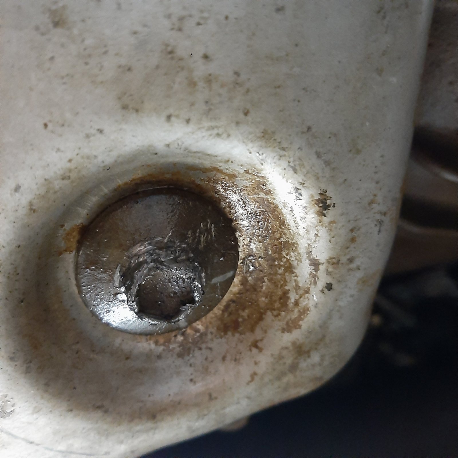

Went to service the transmission. Turns out my drain bolt was tightened by somebody with a bit much zest. It's locked in and head stripped off. I need to get an easy out now for it. I'm curious if I should get new Sonnax super hold servos while I'm at it. I think I can change the ones on the side of the case without dropping the transmission? I do plan on building another transmission but can always swap that over and am curious if it'll help this one handle the power a bit better till then?

Well, latest curveball. This truck is good at throwing them. I got an easy out. It just rounded the head on the transmission pan drain bolt haha I hate to drop this and just have transmission fluid go EVERYWHERE. But maybe I just need to take the pan off and say the hell with it? Otherwise was thinking of trying to get a pump down the dipstick tube.
The factory started installing those bolts with a thread locker that will not submit to any amount of force or heat known to mankind. There was some reason they don’t want them to come out, I forget why. You can get a Dorman pan with drain plug for cheap at most auto parts stores and although I stay away from their crap in this case it was a good thing. GM doesn’t sell a pan with a drain plug.
