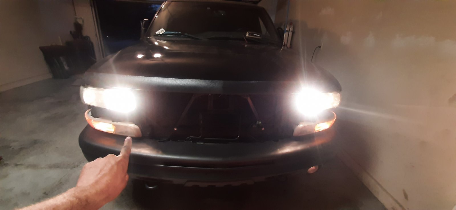

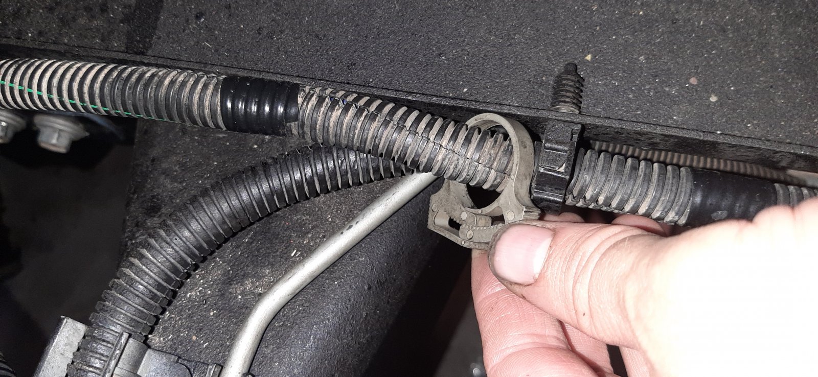

I'm currently stuck at my Daytime running lights, and fog lights not turning on and still waiting for some parts to arrive for the water pump. I also couldn't figure out what the little gray clips go to. They are on either side of the main line across the backside of the core support.

Figured out fog lights... altho, not Daytime running lights..
Do you have to have engine running for daytime runnibg lights?
Sent from my SM-A505U using Tapatalk
Key has to be in the on position and truck has to be in gear for the drl to come on.
45,013
As Tony said, key on and in gear. If you're in a relatively dark garage, the regular headlights will come on instead of the DRLs.

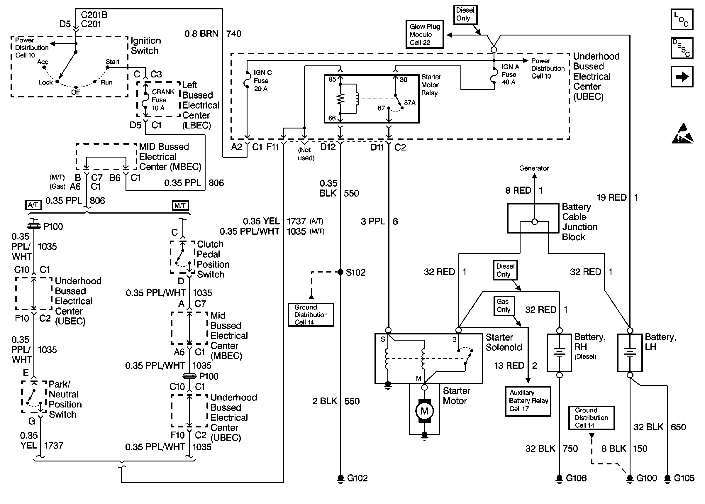

Found the symptom but not the cause. I need to go through wiring diagrams and figure out what all is connected to this fuse...

40 amp is a good size fuse. Hopefully someone can post the schematic of the circuit. If it’s a dead short you could see it with a multi meter.

Factory service manual says under description for that fuse "IGN A FUSE #3 40A STARTER RELAY, IGNITION SITCH-IGN 1, TURN, SEO IGN FUSES".
I wonder if I accidentally shorted out the starter when I put the heat shield back on it? I was worried about that when I was installing it but it looks hard to do with the design of the heat shield and I don't recall any arcing when I put it on.

I found this. Saving it here as I dianose. It's AMAZING how difficult it is to navigate All Data DIY. Would be awesome if the images were searchable. I had to find this in an internet image search:

If it was the shield the battery would be dead or you would have some hot or smoking wires. The thinking the shield would be touching the positive cable. I would pull the relay and replace the fuse, maybe with a light fuse 5amp or less. If it doesn’t pop turn the key on and check it. This would limit some of the circuit.
(starter relay)

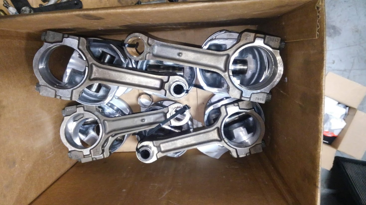

Hey, I've only made it thru 25 pages of your thread so far, and jumping to the last page I see it's fired up now. Thought I'd chime in and say you're not the only one with the Gen 4 rods with the notch. Mine came from a mid 2004 Yukon Denali engine that I picked up at the local Pick Your Part. I checked mine after reading here and I have the same notch on the rods. I wonder how long the notched Gen 4 rods were made??? Pic attached, this is a pic after the rods came back from the machine shop. New pin bushing and resized for the slight O/S bearings that are available.

I also think those rods are DEFINATELY superior. I just was concerned about oil pressure tolerances and had no way to validate them in the design, yet I installed low pressure drop lifters haha.
