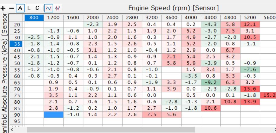

My MAP Adjustments from Baseline today to Final Run (note I swiped the LQ9 table from 2002 Escalade for baseline)
I'm still getting a little knock on occasion. I made the low octane and high octane tables the same. Before I started tuning the Spark I tried pulling 5 degrees across the table but it wouldn't run. So I put the regular table and pulled timing where I saw it was knocking. Pretty well got it cleaned up running on MAF but now running on MAP I'm getting a bit of knock... Not sure what made the difference. I suppose I need to pull this out somehow. SECOND: Does this mean my data logging MAP error is bad?

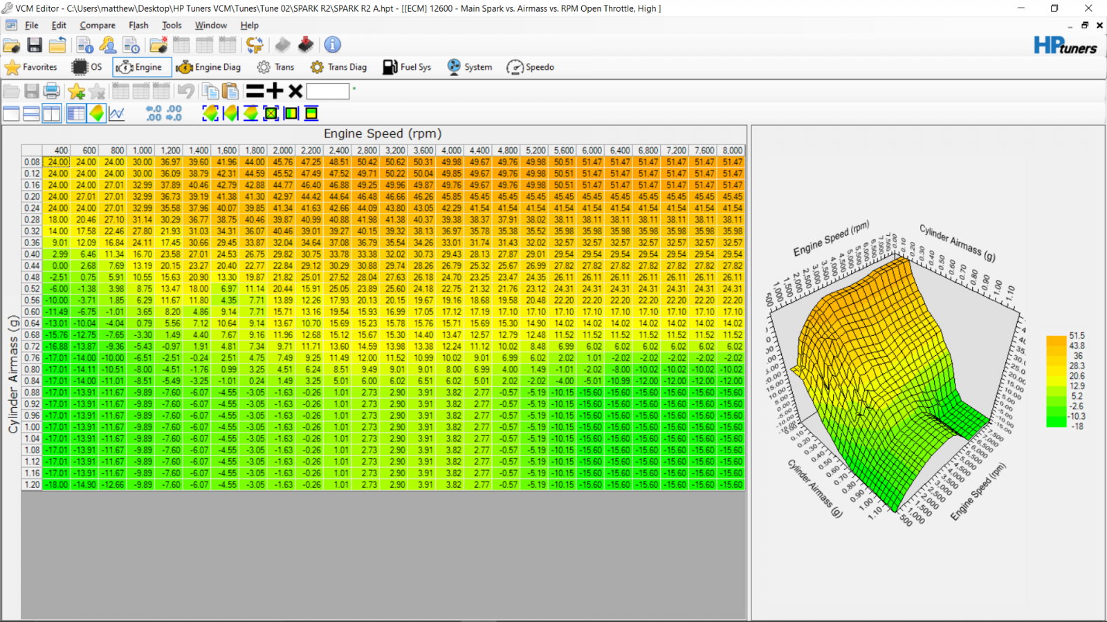

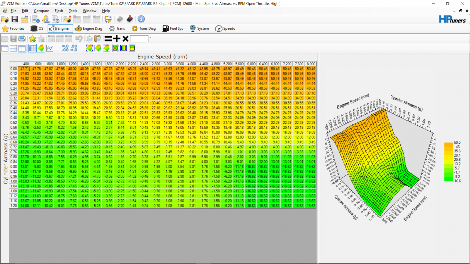

About ready to scream. Anybody here have experience tuning timing / spark advance on Gen III LS / P01 controller? Damn I'm having a hard time. Put everything back into closed loop with the fueling dialed in. Then picked back up my old spark tuning tables and started dialing in advance in both Low and High Octane tables.
I cannot make heads or tails of this. I added a bunch of timing down low like under 1200 RPM but 1600 to 2000 part throttle (0.52+) is all goofy. I pull timing there as I log knock. However, there's a massive hole in power right there. I cannot even maintain highway speed. If I punch up above to 2500 or 3000 rpm its find with light knock registered here and there which I can tune out I think. However, getting past that hole is a PITA / pretty hard & dangerous. I couldn't merge on interstate or even a road with 50 mph speed limit.
STARTED WITH THIS MAP:
AFTER ABOUT 12 RUNS AND 1/2 TANK OF GAS - 1400 to 2000 RPM sucks bigtime, no power and cannot figure out how to fix it. Add timing it knocks, reduce timing, no power.

Can you actually hear the knock? I would look into trying to figure out if it's actually knock or the sensors picking up false knock. If you are pulling so much timing that it's barley making enough power to move, that would seem like it's false knock.

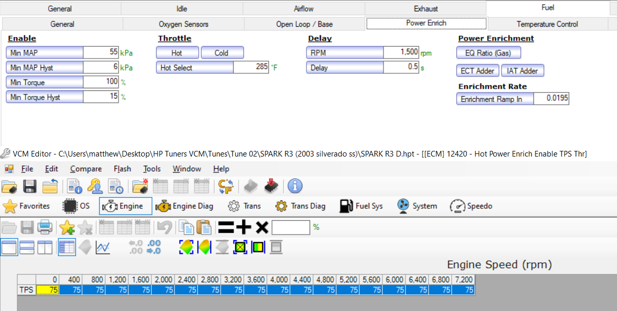

Welcome! How easily are you going into power enrichment? Ever since I lowered the threshold to enter PE through the rpm and MAP I am getting into PE/ open loop a lot easier and it really scoots well now with less throttle....and it's 95 here. I'm not logging any knock retard on stock tune. Haven't even touched timing or fueling on my tune. If it's not false knock...it could be the commaned afr not being not rich enough (cool enough) to support the timing advance?
You can see when it goes into PE by watching commanded afr/eq. The command will quickly drop from 14s ( or 1 if looking at lambda ) to 12 something / .85

My PE settings are below. Factory had the delay disabled. Somebody on HP Tuners said to set it to 1500 RPM and short delay.
Then factory had both hot and cold tables set to 90 PE Throttle Position. I tried 65 and now the 75 with no real noticeable difference.
