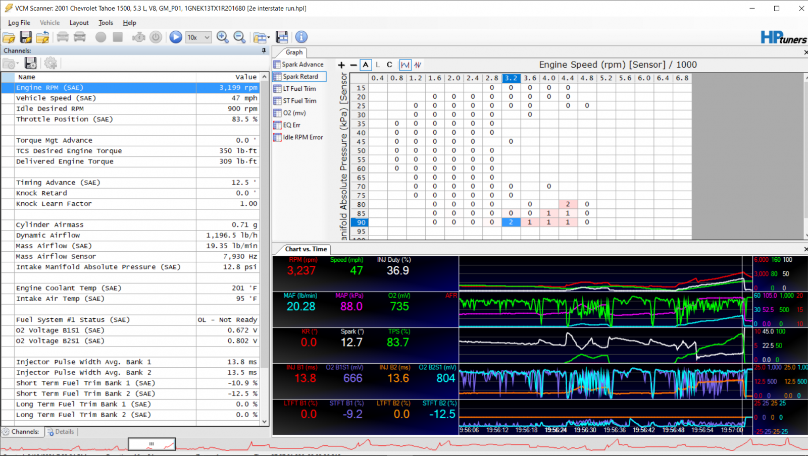

Currently doing Mass Air Flow Calibration then will move onto the speed density tuning. It's bit of a pooch but I think I needs more timing advance. It's basically running on 5.3L tune haha

The computer pulled timing, not sure why?

That was knock that triggered computer to pull timing. It wasn't registering right in the waveform graph. I switched the variable to another and it displayed the knock count. Learning as I'm going, just hate to see knock as well I think that's was breaks engines.

On your log file the coolant temp was 201, which is fine.
The folks on the HPTuners website can help you with your tune and logs.
