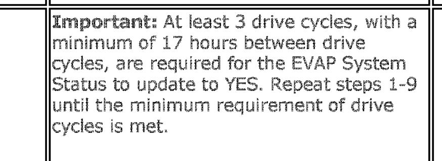

If the trouble code clears, readiness tests may begin, but it's not automatically ready the second after the code(s) is (are) cleared.

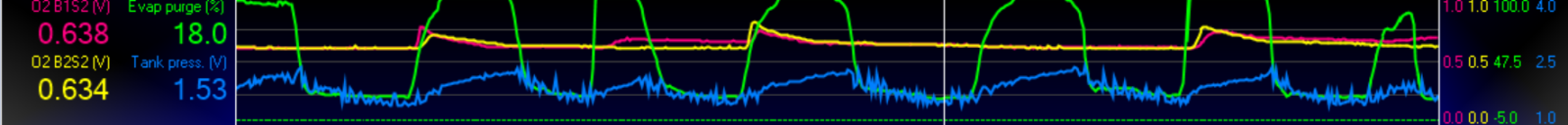

So I have no codes for evap, but evap monitor has not set.
I notice my fuel tank pressure is not smooth if purge valve is not either fully open or fully closed.
Tank pressure (yellow) fluctuates about .45V if purge valve (green) is not fully open/closed.
Starting FTP voltage is 1.50V. One log showed 1.56V after evap vent open at startup.
(higher voltage is less pressure) So I would have expected voltage to do down..
(seen rnentions voltage should be 1.3-1.5V, I would have expected 1.3V since I'm at sea level..)
Defective valve or clogged line/canister or? Normal pressure spikes?
I was thinking the PWM purge might have a restriction in the line.
Purge valves are cheap, so I ordered one. (Along with new gas cap and vent valve for now)
Not saying this is the reason monitor has not set, just looking for clues.
If anyone can log theirs (maybe @strutaeng :sorrysign: ), or can explain what I should be seeing,
it would be much appreciated!
Have also considered a small leak could be messing with the cooldown fuel tank pressure reading..

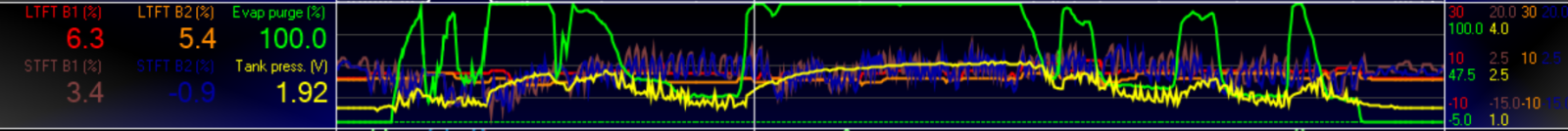

If you look at the datalog, sometimes purge is open 100% (when on the throttle) and sometimes it is fully closed (mostly at startup, sometimes when stopped) and the rest of the time it is PWM some percentage. Just curious if tank pressure is supposed to be unstable during the PWM modes, at least thats what mine is showing. (post #1)
And here's another clip with throttle position..(purge and tank pressure bottom graph)
I thought purge was fully open at WOT, I was wrong. Looks like 100% mostly during light throttle

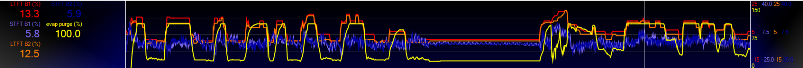

YET, purge (yellow) lines up with LTFT increases rather neatly.. (except at WOT, the first section following the flatline is WOT)
Not a cause and effect situation, since LTFT jumps a bit earlier, but maybe the LTFT and EVAP% partly utilize the same algorithm.

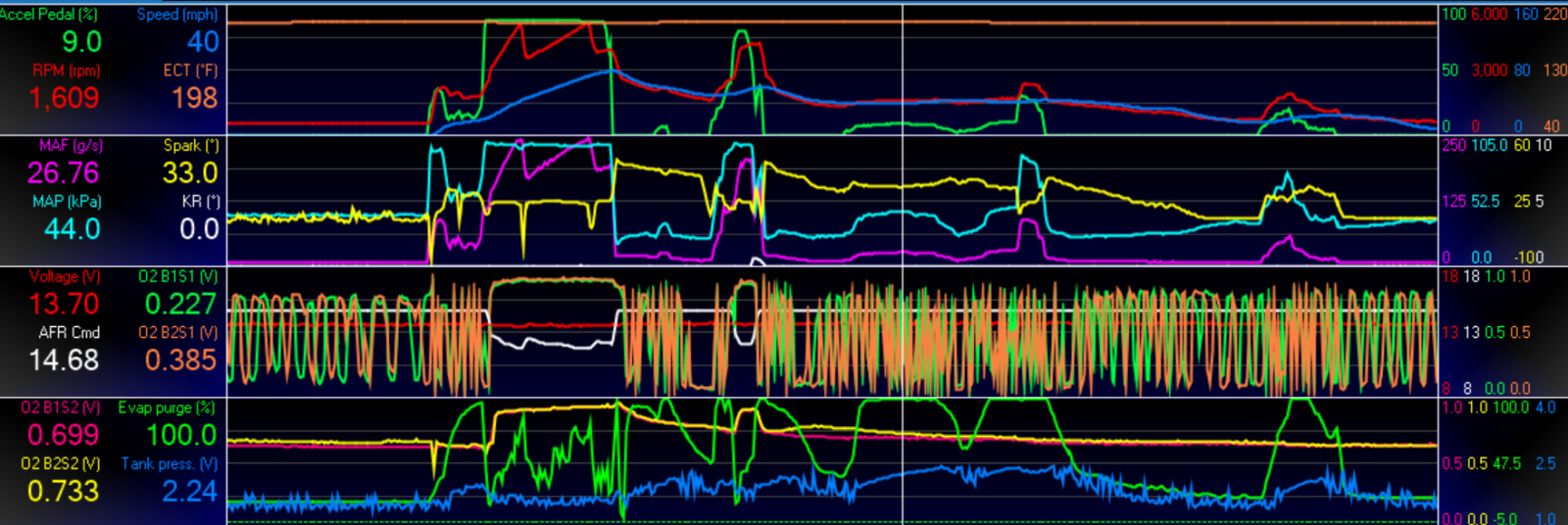

During closed throttle coastdown, the evap SEEMS to mirror the fuel tank pressure..
Probably coincidence and graph scaling. Closing the purge will reduce vacuum to tank.
Looking through just a handful of logs, purge can begin at ~144degF coolant temp, ramping up to 100% at 180degF ECT.
Fully warm idle can be either closed or 16%. Free rev to redline purge hits ~50% @ ~25% throttle...
Light throttle driving it's 100% open.. At WOT acceleration, it mirrors RPM's (but jagged!) up to 81% open at redline.

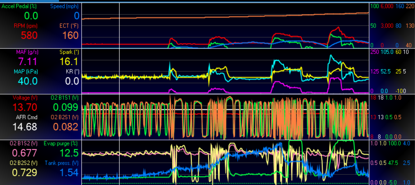

Caught the PCM doing an evap test! Two tests.
Vent open/closed is labelled backwards in hptuners scanner.
First test? starts 10seconds after startup @79degF ECT.
Gas tank half full & half empty. Vent stays closed for 1min37sec.
Purge 0%.
Second test begins 5min30sec after startup, ECT @160degF.
Evap vent closes for 1min8sec. (cursor at start, peak tank voltage is end)
Here purge tested in two phases, first vent closes for 20 seconds.
Then purge valve reaches 36%, lasts for 5 seconds.
Drops to 16% for 13 seconds. Second phase reaches 64.3%, lasts for 10 seconds.
Drops to 16% again for the remaining 20seconds. Tank pressure sensor peaks at 3.85V.
Have not checked if EVAP monitor has set. Doubtful, but will check tomorrow..
Previously I have logged the evap vent closing, but did not log tank pressure.
12seconds after startup @55degF ECT.
Stayed closed for 1min36sec, purge 0%.
Second phase, the vent closed again at 4min30sec @171degF ECT.
Stayed closed for 1min17sec.
Purge opened to 40%, 50%, 16%, then 0% for 20seconds..
Then, while I happened to be at WOT, 42%, 30%, then off WOT, 20%, and finally 52%.
The vent opened when dropping below 36%.
Another log, vent closed from 11sec after start @61degF ECT.
Also closed for 1min36sec duration, purge 0%.
Second stage at 5min35sec @158degF ECT.
50second test.. Two bumps, 36% and 50%.
And another 16seconds after start @57degF ECT.
Closed for 1min36sec duration again, purge 0%.
Second stage starts at 4min4sec @164degF ECT.
20second test, one purge at 76.5%.
One more 7 seconds after start @68degF ECT.
Same 1min36 duration, 0% purge.
No second stage vent closure.
