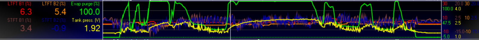

I notice my fuel tank pressure is not smooth if purge valve is not either fully open or fully closed.
Tank pressure (yellow) fluctuates about .45V if purge valve (green) is not fully open/closed.
Starting FTP voltage is 1.50V.
One log showed 1.56V after evap vent opened at startup.
HPTuners has the vent position backwards..
(read that voltage should be 1.3-1.5V)
Normal pressure spikes? Or defective valve or clogged line/canister or?

Sure, I can log mine. Was planning on that anyways. Although not sure how useful my log will because I had a code for small leak something related I never could find the leak...had a code...

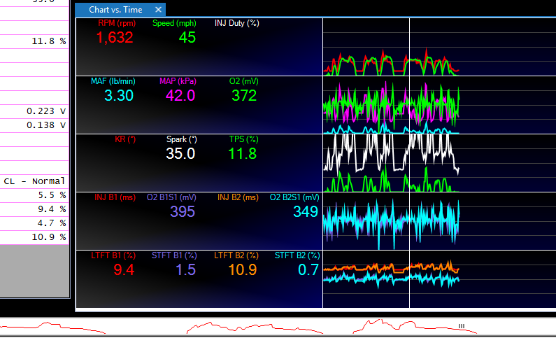

Question: How do you get those EVAP parameters to show on the graph?
My log from yesterday shows this? You can add anything to show on the graph?

Thanks! Yes you can add any parameter, first you need to add the parameter to the list on the left window. I think its under fuel or fuel tank. Then you right click on the graph and go settings and click the +graph icon and select the parameter again from the list.
