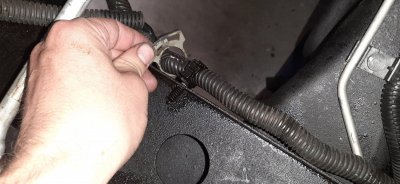

Also there were two gray clips. I cannot figure out what they attached to before. Picture below. They are off the main part of harness going across backside of the core support.

#1 there's two gray clips that are on either side of the cable run that goes across back side on core support. I think they snap the one harness to another? But not sure where? Or which?

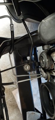

#3 a bit unrelated, the transmission cooler lines run under the core support. Is there something, a clip perhaps that holds them together. The one seems to rub on the frame rail.
