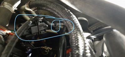

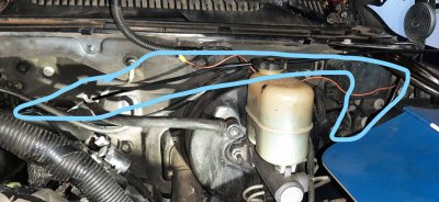

Thanks everybody for the help! I finally got to the point of running cable for the wideband. I fished it through the factory cable gland (hole in firewall). Royal PITA. Note to self, cut a second cable gland for aftermarket stuff next time. Couple questions...
Where did you guys tap power? I thought maybe I'd use the driver side dash fuse block and do one of those double tap fuses for now... But I always like slick ways to do things that look a bit more "natural or factory".
Any thoughts on cable management? I have a bit of a mess under my hood. For time being it's all zip tiedied up. My goal is to clean the cable management up and bring everything along backside of transmission bellhousing. Any ideas???
- I want to get some sort of nut with loop that will hold the line to that bell housing stud there.
- You can see where I routed along firewall. Would like to get some more cable management loops to organize that there and hold it against firewall.
- I zip tied the connector for O2 sensor to the knock sensor line for now but want to do something better to hold that connector from falling down behind bell housing or worse on exhaust.
