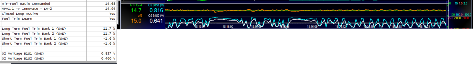

I need to know of a very good injector cleaning solution. I'd like to start with something I can add to my gas tank and see if it helps. I've got trims of 20% right now along with some annoying and somewhat random knock retard and think it maybe due to varnished and or gunked up injectors. I'd resolved originally by pulling LOTS of timing from my tune but I'm at a point I want to fix this and suspect I might have an injector issue.
Backstory: I've been chasing my tail tuning and with out of spec fuel system for years now. I thought I had it all sorted out but have a 20% anomaly in my trims when using good configuration (tune). It dawned on me, I've verified EVERYTHING in the fuel system, except Fuel Injector Flow. To adjust the tune we lowered the fuel injector flow by 20% which isn't ideal in my mind. There's an issue somewhere mechanically and I want to sort it out. I bought a set of used L59 flex injectors years ago... They don't leak but I never tested nor cleaned them beyond a leak test. I suspect there maybe some varnish buildup or gunk in them.
My bank 1 Sensor 2 O2 voltage seems to always lag bank 1 sensor 1. I fixed the EGR right after my build as it was leaking and that resolved a bank mismatch code but it still seems to lag. The O2 sensors were replaced in my build AND they are the same make / model. I do have an earlier P01 controller setup, where the grounding is chassis ground I believe for the O2 sensors. Not sure if that's causing some error (I'd think not). I've cleaned and inspected my grounds as well. The error doesn't show up in the trims which seem to be pretty close for both banks. However, if a few injectors lazy, maybe it could cause some issues that wouldn't quite get caught by the controller?

Are you actually running the L59 injectors, or just waiting to use them? Based on your graphic the fuel trims are closer to 10%, so running a bit lean.

I'm running them. The graphic is from a older tune. We trimmed the fuel by lying to the PCM about injector flow rate. That was one of the intermediate tunes isolating the problem.

I should be more specific. I'm going through my system with a microscope so to speak. There's a knock anomaly I cannot isolate and the only thing I've not mechanically verified is the injector spray pattern and flow. The PCM is generating low trims, banks are mostly the same. However, I'm not convinced the 0411 P01 nor P59 PCMs we have are capable of isolating more nuanced injector issues; specifically injector spray pattern and injector to injector balancing (only bank to bank).
I've taken apart the entire fuel system, replaced new & verified all specs per FSM. I bought used Flex Injectors years ago for my build. I verified the injectors don't leak but never verified spray pattern nor injector balance (flow per injector). I'm thinking the injectors were well used and I should have had them cleaned in the least... They were good enough to run the truck but I've never been able to address what appears to be a random knock issue in my tune (the knock is real not false).
I've never been able to advance the timing beyond the base timing table (low octane spark advance table). This is basically the factory's known safe timing table. I finally hired a professional tuner to help me figure this out after many years of never being able to clean up this knock issue.
- The knock is experienced under throttle changes that are gradual to rapid. VERY VERY VERY light throttle changes under load do not provoke the knock.
- I cannot isolate the knock to any given airmass and or RPM. If I could I could just pull timing in that area... Basically it's not correlated with airmass.
- I can see random knock when TCC is locked or unlocked. However, it's more pronounced and can appear consistent under lockup. Yet I can be locked and have the condition appear one time but not the next the engine is under that given load.
- AFR is good and verified by WB. Power enrichment / non stoic AFR tracks accurately and quickly adjusts as expected.
- I have no misfires... I'd assume a misfire if I had one wouldn't create knock though (possibly a rich condition?).
- Engine runs PERFECTLY smooth at idle and light cruise (around town part throttle) say under 45 mph.
- The trim between banks is no more than 3% different and that's only at idle (under 1200 RPM where I have no knock issues). That said bank 2 is biased lean under idle... possibly a effect of distance from bank one rail where fuel is fed in? Either way likely a non issue.
- I'm running Shell premium octane fuel. I'm at 2500+FT MSL here so that's 91 octane. NOTE: I only ever run name brand fuel typically Shell.
I'd had scaled my VE table to 150% in my tune (I always found this odd as engine is naturally aspirated)... The tuner however, helped me better isolate the fueling error. We used a known good VE table scaled for my cam then adjusted the flow rate in the calibration from what should be ~36#/hr down to 30#/hr. This leads to me to believe there maybe some issue with the injectors. I'm starting to think I'm not getting a consistently (1) metered fuel mass and or (2) even mixture in the cylinders.
I could buy brand new injectors but I'd still want to verify pattern and flow. So I'm leaning toward getting a couple used sets; reconditioning them (clean), then measure their flow and pick the ones that are most evenly flow.
Side note I'm looking for a fuel rail, & crossover tube... and or a shop in Tucson AZ area that does injector flow testing. I keep searching google for one but it's just shops that run cleaner through the fuel system.
I can however, build a test bench. I have the stuff and function generator to create the required pulse. I might do this by raising the fuel rail, pulsing a single injector at a time then measuring the weight of the fuel metered.... But would be much easier to rig up a second fuel rail on my workbench if I had one.
OR God willing run several adult doses of fuel injector cleaner through my system and have the problem clear itself up.

This, more than anything else, makes the injectors suspect; they should be able to keep up with your foot.
I'm thinking so. It's not surfacing in the WB data but then again, maybe too little resolution in that data to catch it.
Have you changed all of the injector data from the original stock tune over to the data that flex fuel injectors run?
If all of the data is correct, why are you using the fuel injector flow rate to dial in the air to fuel ratio, rather than adjusting the maf and ve until the air to fuel ratio is correct?
The injector characterization is correct. There were two choices for the same part number; choice one is return style characterization w/ ~3 bar, choice b is return-less style at ~4 bar. I tried both... The 3bar return style was correct. We originally scaled the flow as I'm using a 4 bar regulator so it went from 33# to 35.4# (simply use the figures from the 4 bar return style config). Long story short, the tuner's config resulted consistent trims for LTFT and STFT at low and high loads which leads to me to believe the characterization is accurate.
I'd formerly done as you suggested and tuned fuel mass empirically scaling the VE table and MAF calibration. The tuner I hired used a stock 85mm MAF curve and known good VE table for my specific cam. How he built the VE table I have no clue. But it was SPOT on for my engine. Trims were consistent across the board. What was off was a 20% offset for LTFT nearly across the board.
With the 35.4#/hr I got 20% LTFT. As we'd verified the VE and MAF correct the finger pointed at the injectors. Given it was consistently around 20% LTFT leads one to believe it's an issue with fuel flow so adjusting injector flow rate seemed appropriate and brought the LTFT within a few percent. It was brought down to 30#/hr in the PCM which is even lower than the spec for those at 3bar which is 33#/hr. This seems to point to the injectors having some issue. Maybe varnishing on the pintle and or behind the cap, possibly more, restricting flow and spray pattern?
That's when I suspected an injector issue. Either atomization and or metering is possibly off. Am I splitting hairs. Likely you'd never notice this on a stock engine with stock tune. Unfortunately my custom build requires I get nuanced to sort these things out. Something is certainly off mechanically as I can only run the base timing map reliably. Advancing it even with premium fuel results in random knock only correlated with anything but the slightest increase in throttle position.
Even adding more fuel; 12.6:1 AFR doesn't mitigate the knock. I've tried even richer (somewhat pointless) and the knock when throttle is increased the knock response is somewhat consistent... under what load and RPM never seems to be though so I cannot address it with the tables in the PCM.
