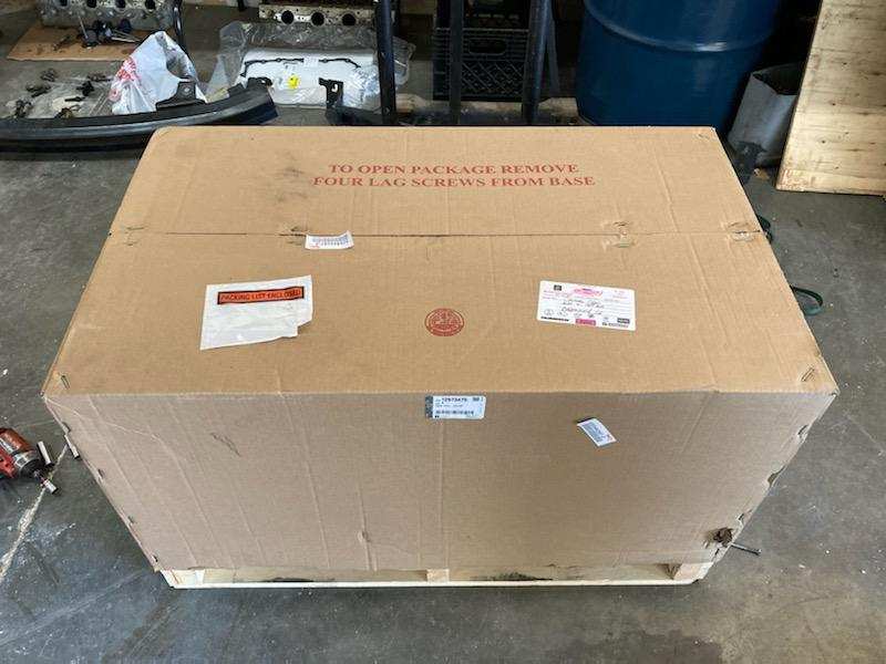

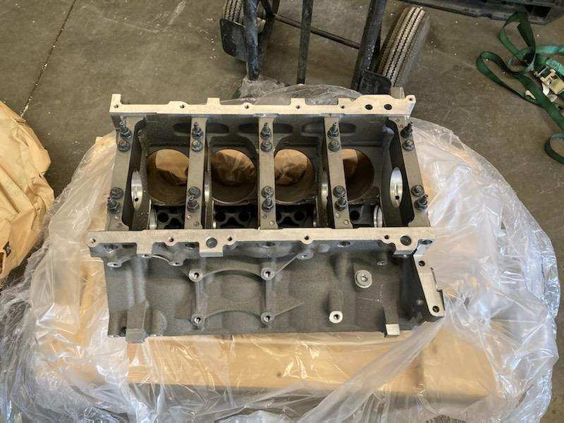

Block, rotating assy, and some odds and ends are on the way. Had a setback this past weekend, my other half had a co worker test positive for covid, so we are doing our part and got the test and have isolated until we know results.

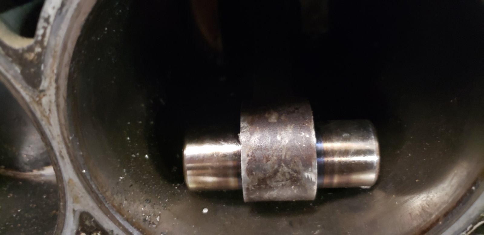

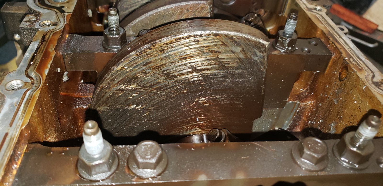

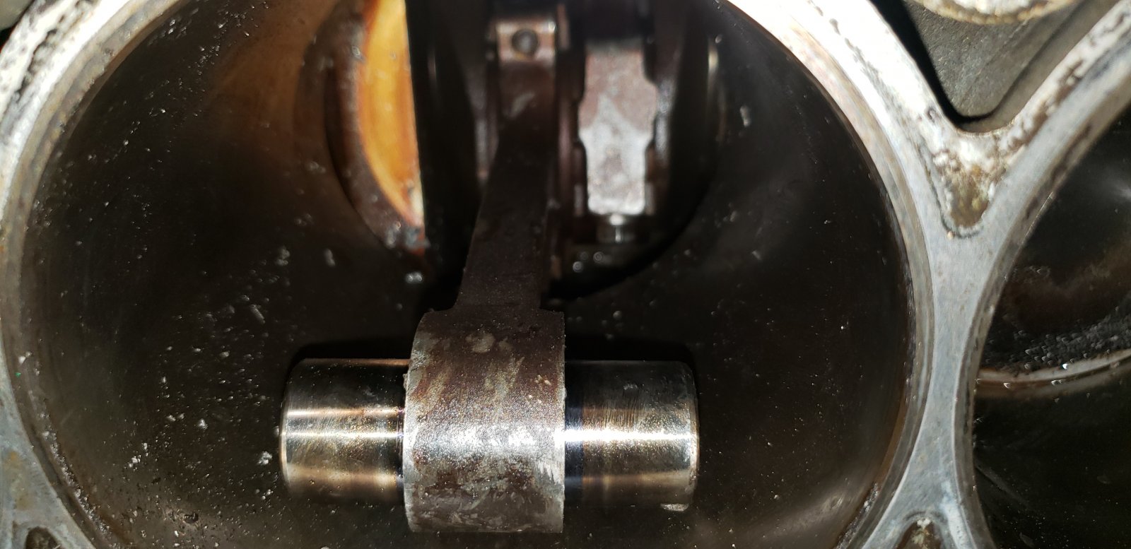

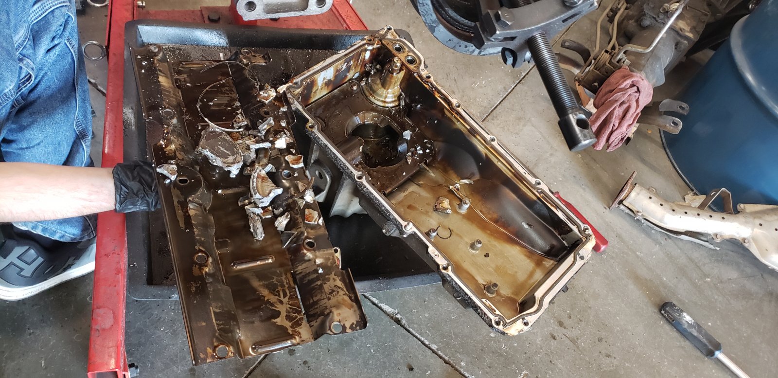

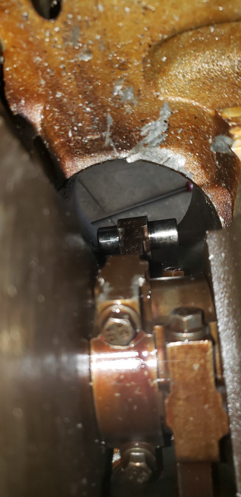

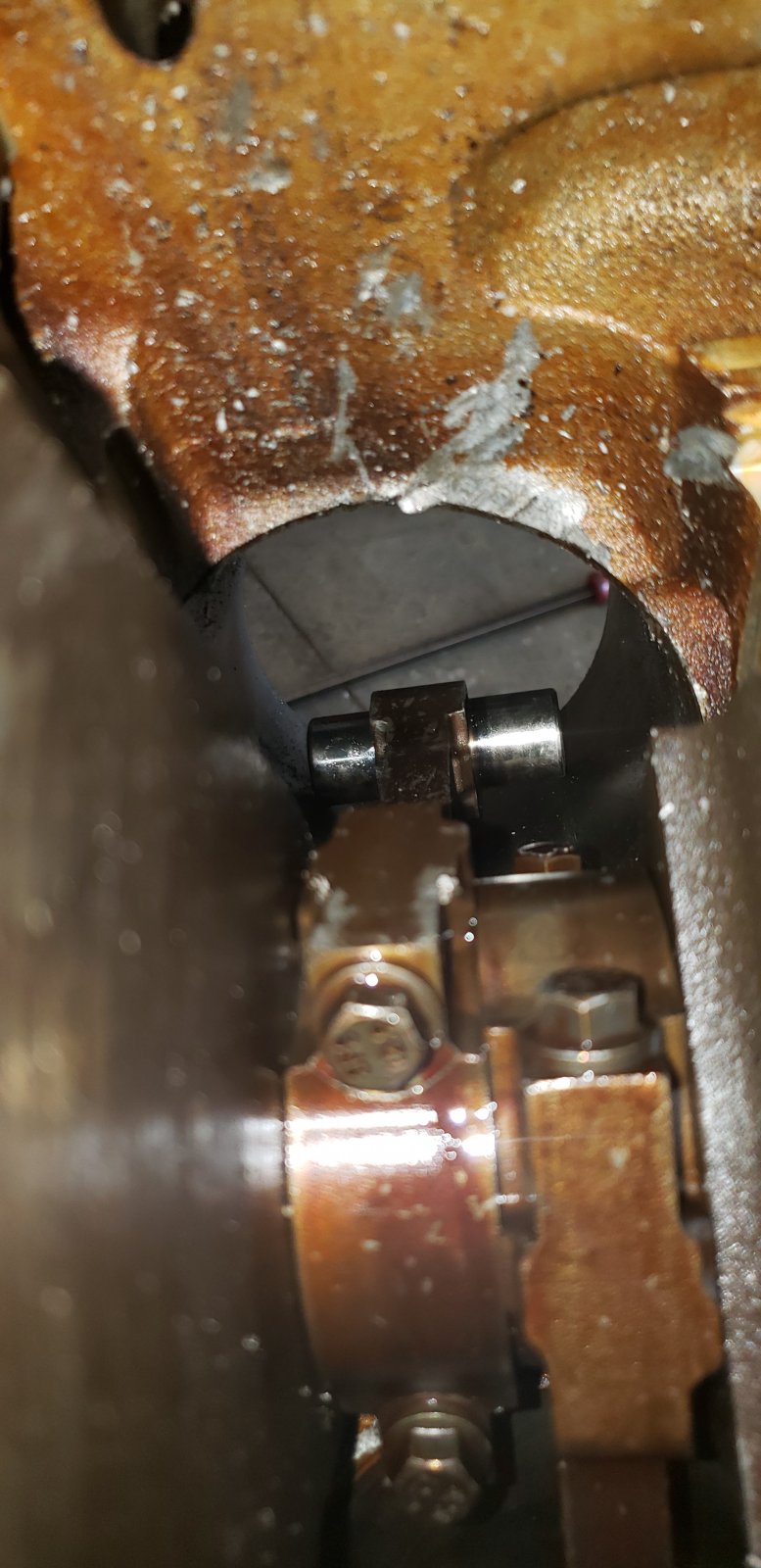

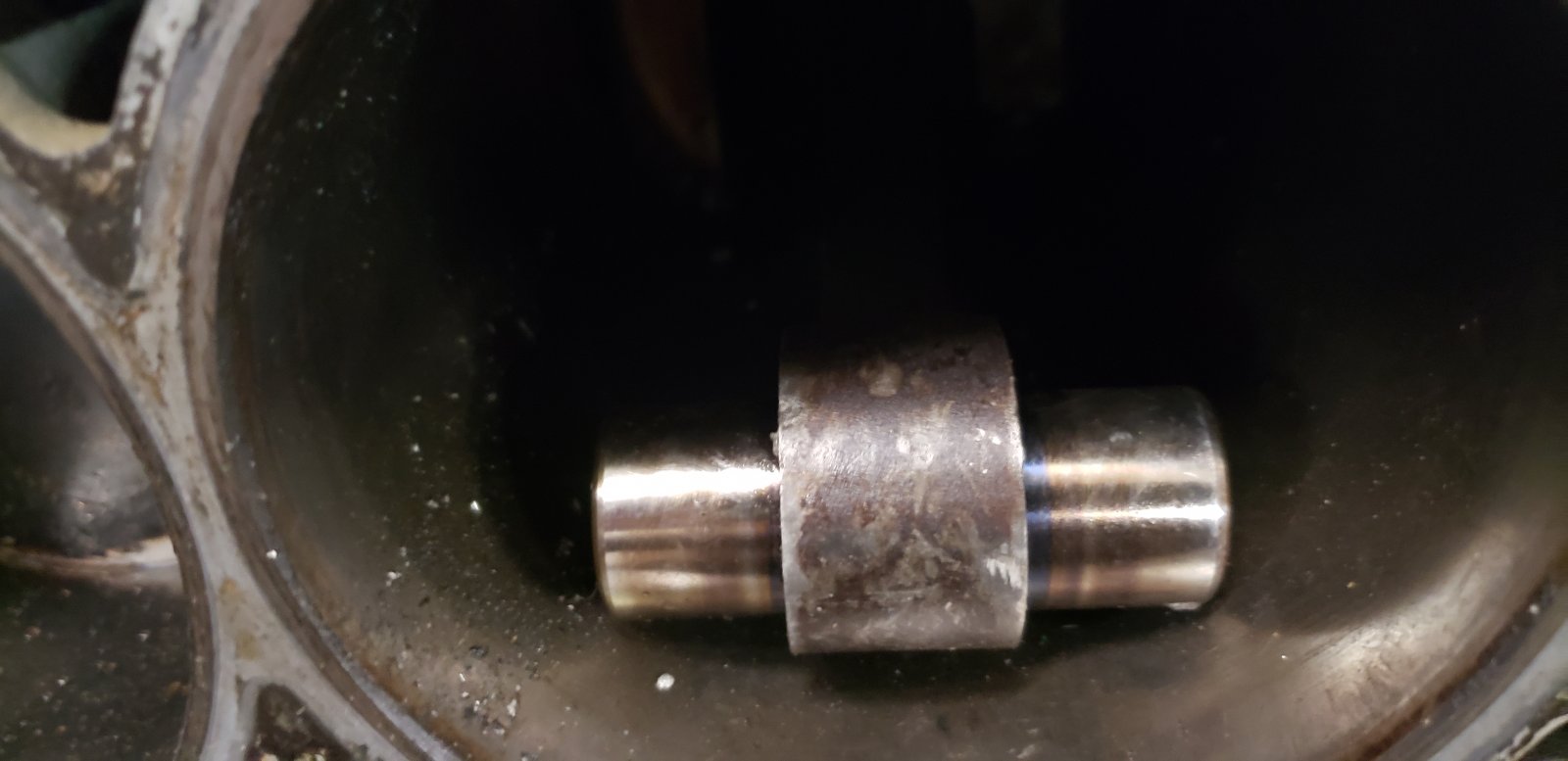

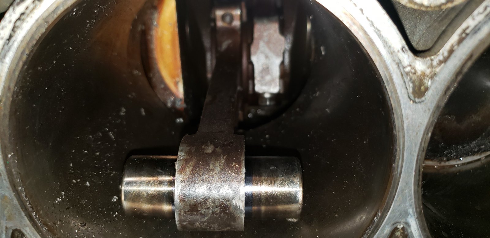

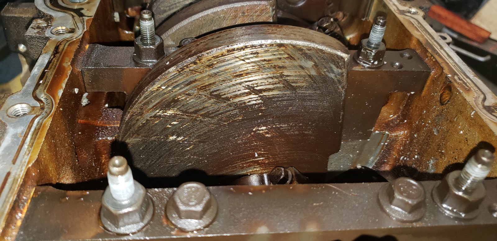

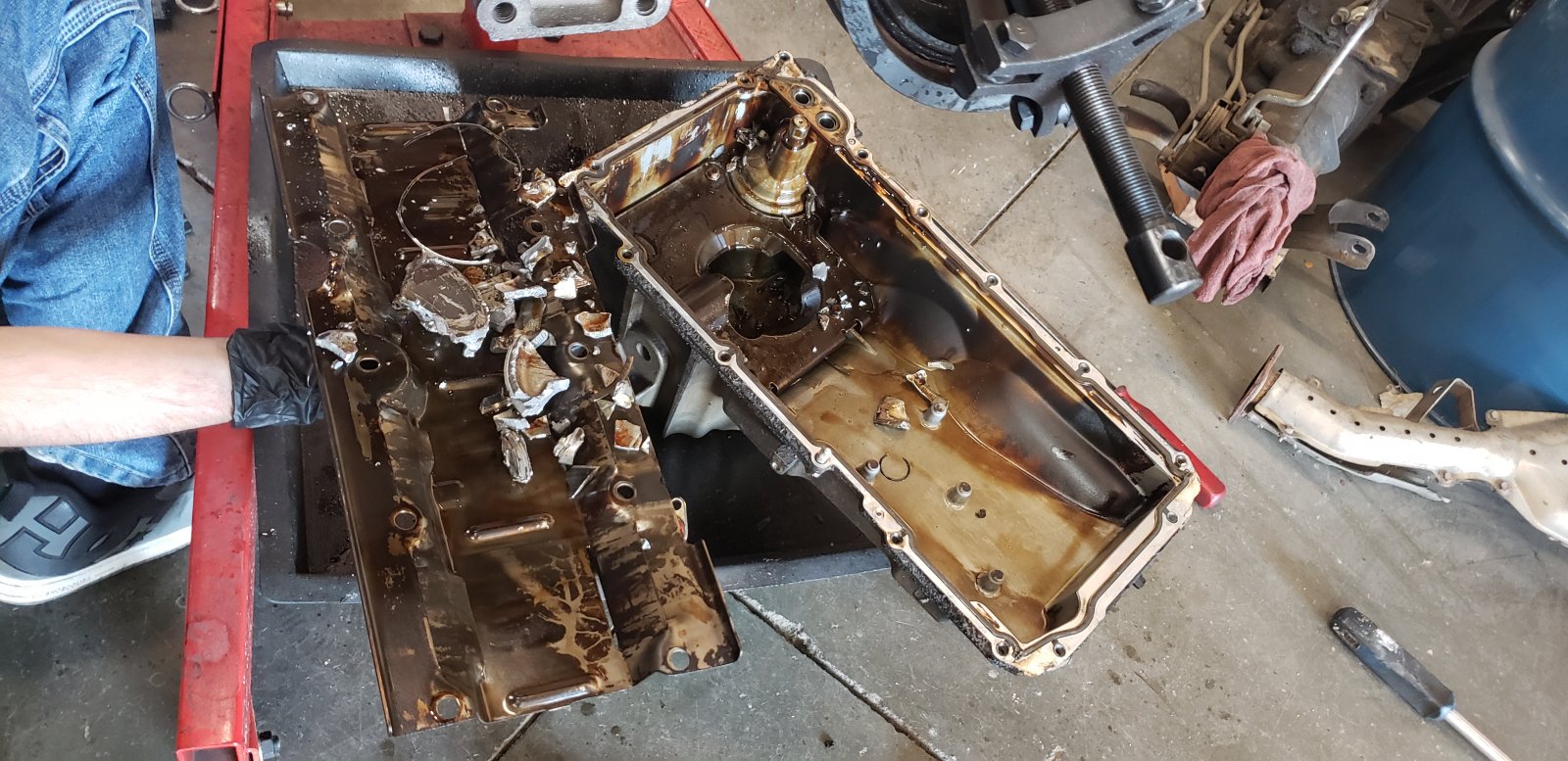

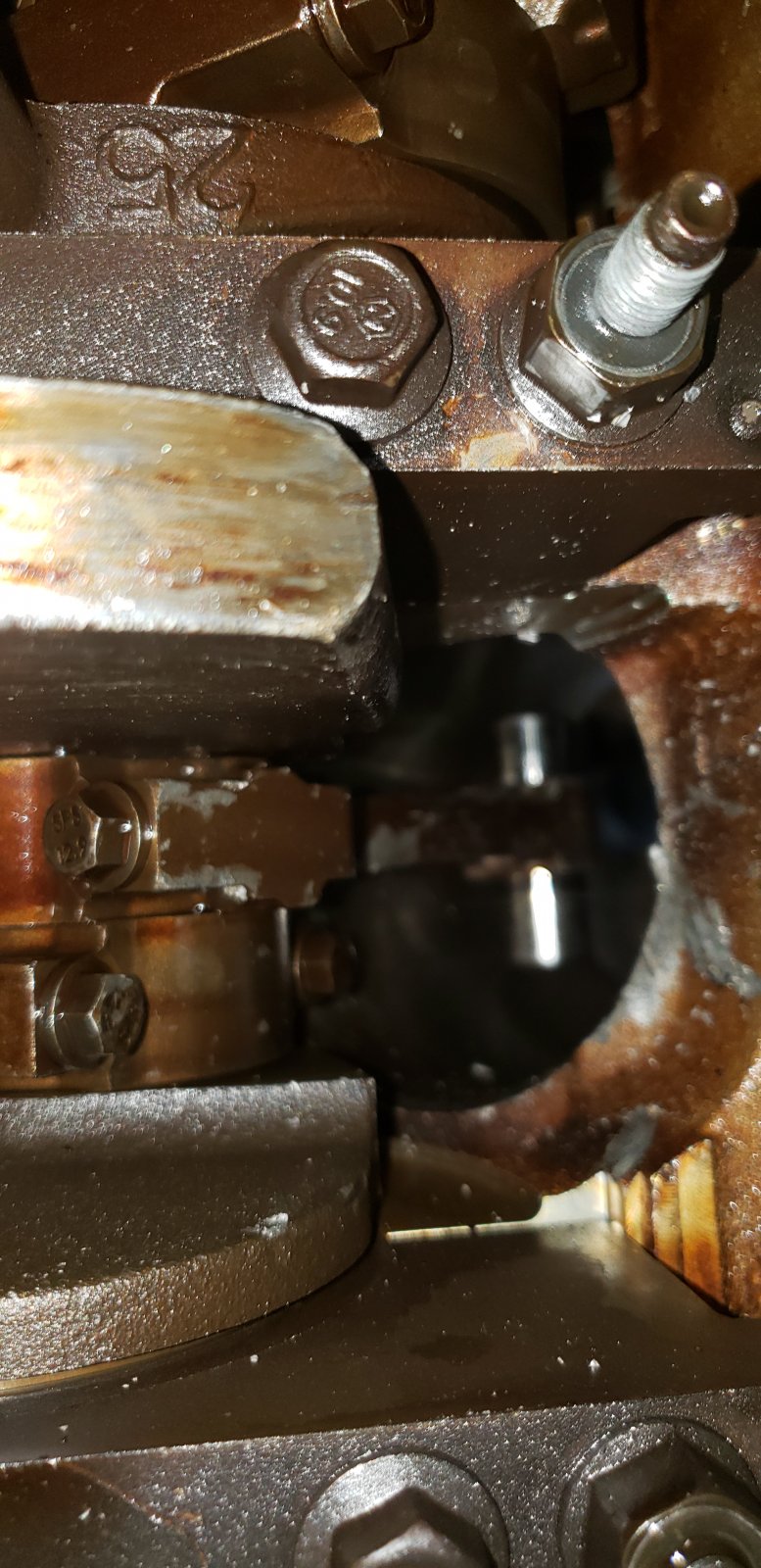

Went to the shop today to do more tear down and got the engine out. The damage could have been a lot worse if I'd actually been driving when the valve seat let loose. The block is definitely salvageable and will most likely get a rebuild and go into my 06 SD someday. The crank may not be able to be reused though. Here's some pictures.
33,344
51,833
Went to the shop today to do more tear down and got the engine out. The date could have been a lot worse if I'd actually been driving when the valve seal let loose. The block is definitely salvageable and will most likely get a rebuild and go into my 06 SD someday. The crank may not be able to be reused though. Here's some pictures.
CARNAGE!! Lucky you can save the block tho.
45,014
...could have been a lot worse if I'd actually been driving when the valve seal let loose.
*valve SEAT
Wanted to correct that in case others that don't know the prior story read it and might get scared of their leaky valve seals. lol
That wouldn't be any real loss. The crank will have to come out anyway to have the reluctor ring changed to run it on a Gen3 harness and PCM.

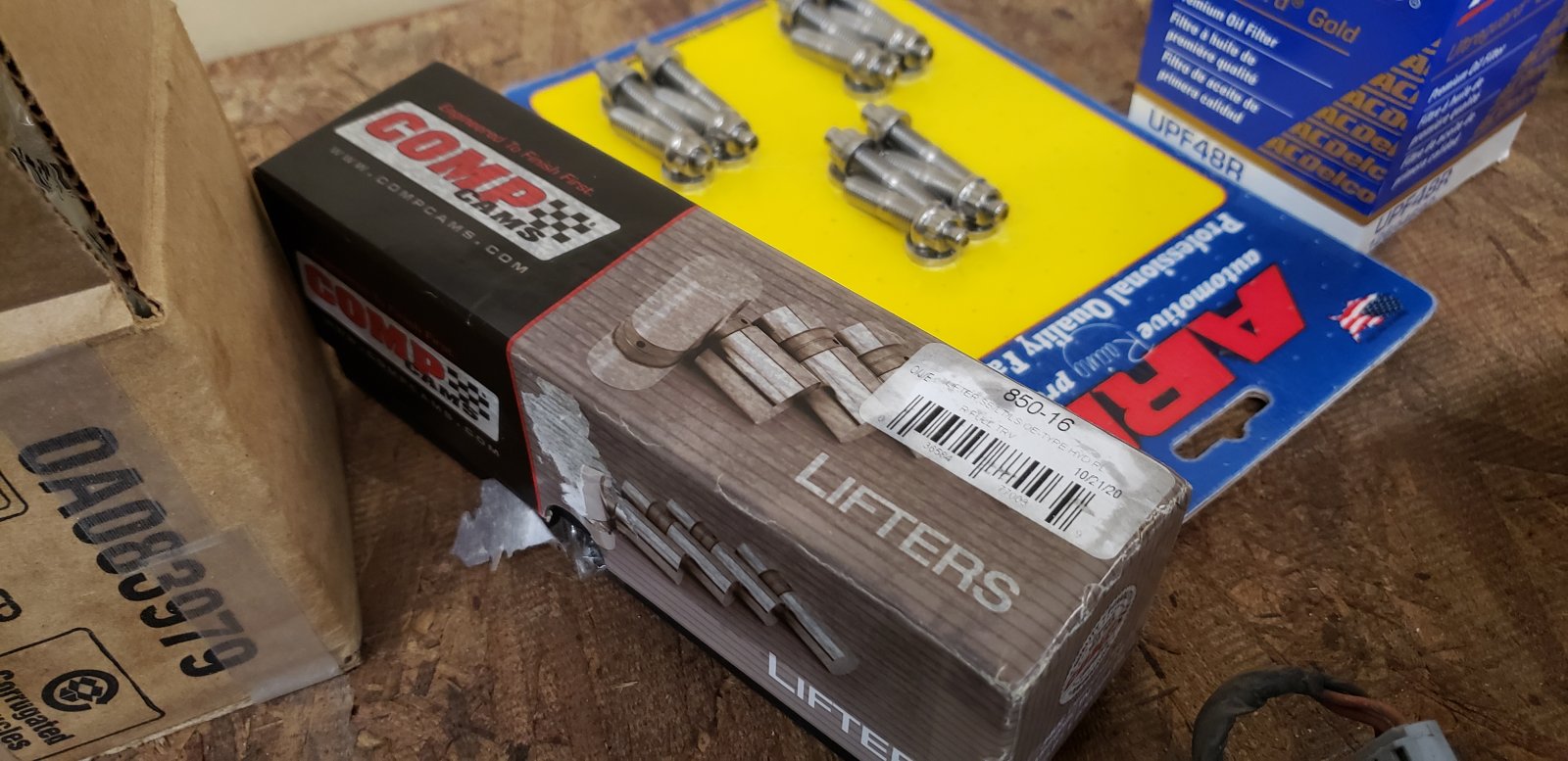

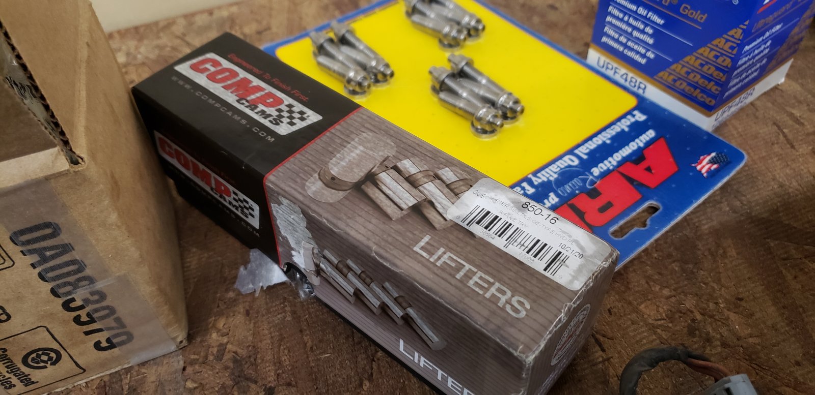

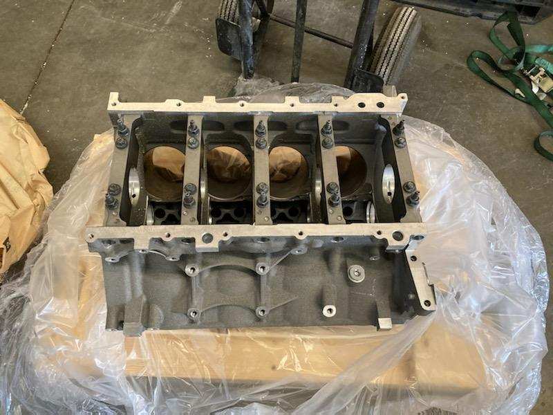

...But somehow these arrived even though I wrote them off months ago, not sure what ones I'll use now.
IMO, it's kind of a toss-up. IIRC, the Comps call for significantly less preload than stock lifters. I'd research to see which, if either, would complement the cam better than the other.
