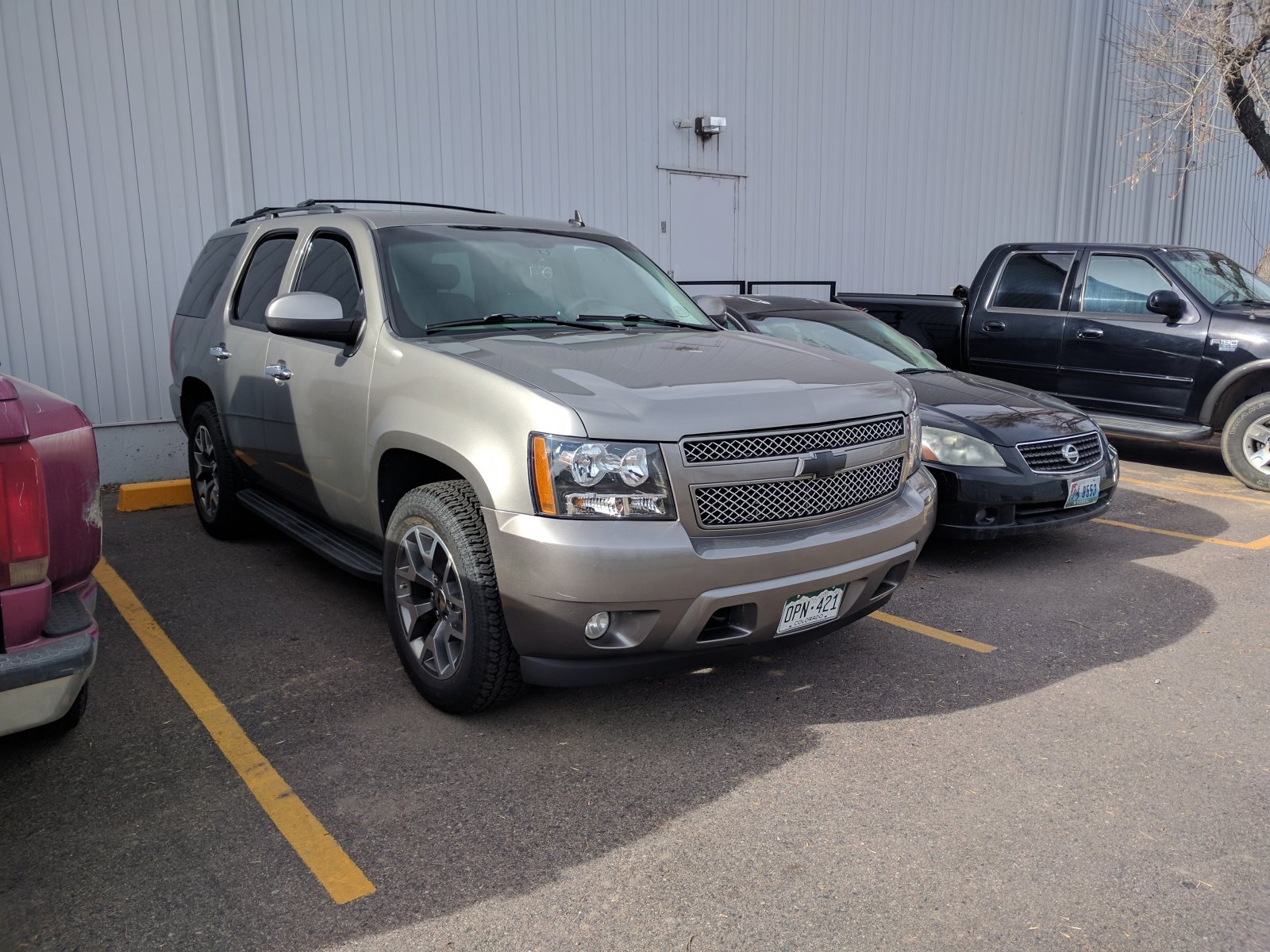

I have a 09 Tahoe LTZ with a 6.2 L9H.
This is the day I bought it

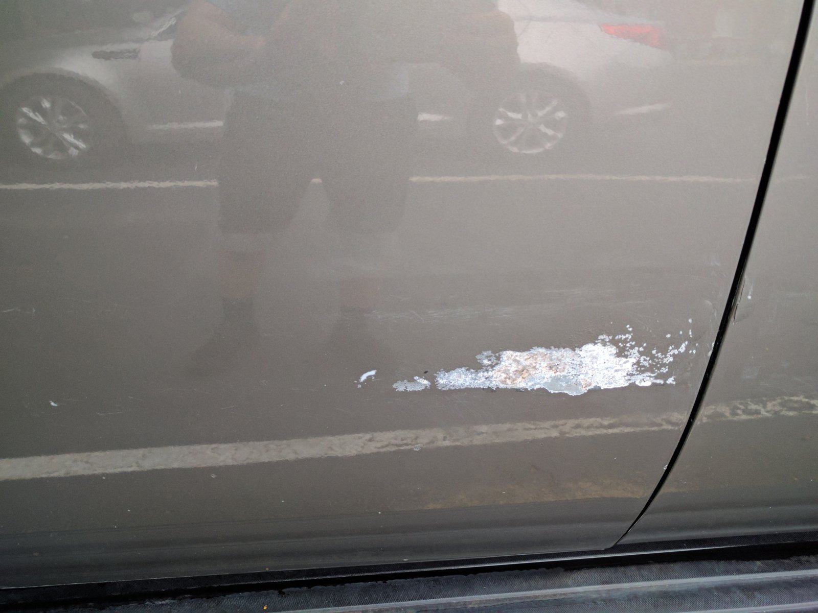

After I bought it, I decided to make it more of a sleeper. I removed the side moldings... But found this...
Cont...

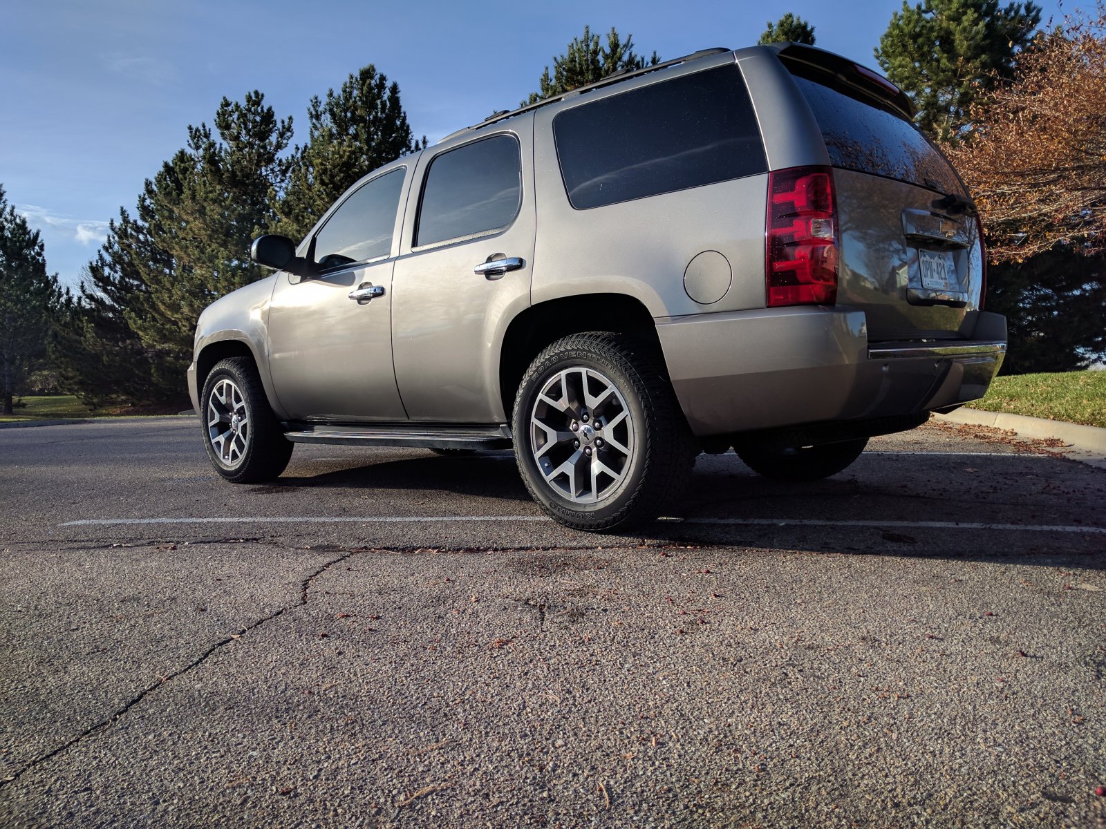

After that I color matched the grill surround and mirror caps.

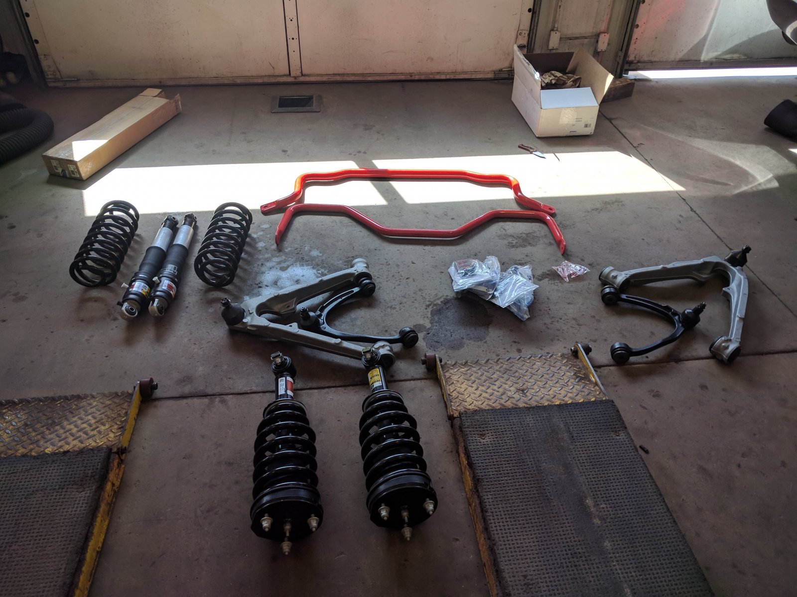

Then I got a Blackbear tune. I added a Airaid MIT tube and dry open filter element in the stock airbox. Also replaced the original 5/7 rimmed fans for the 2012 PPV K5L dual 5 blade rimless 700w motors. Then I rebuilt the suspension and added Eibach Sway bars..
