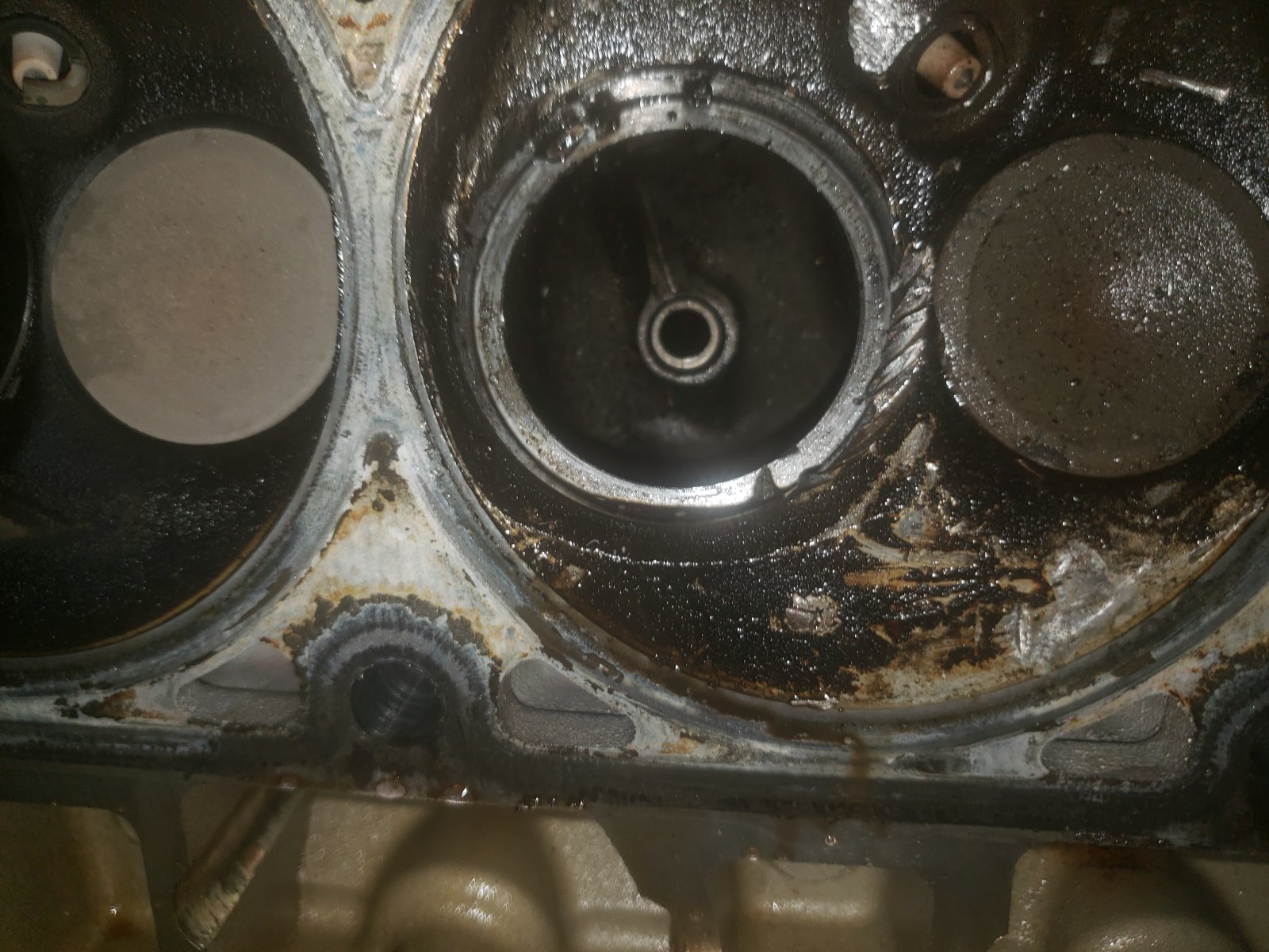

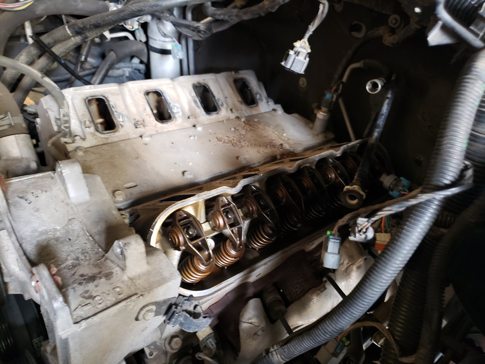

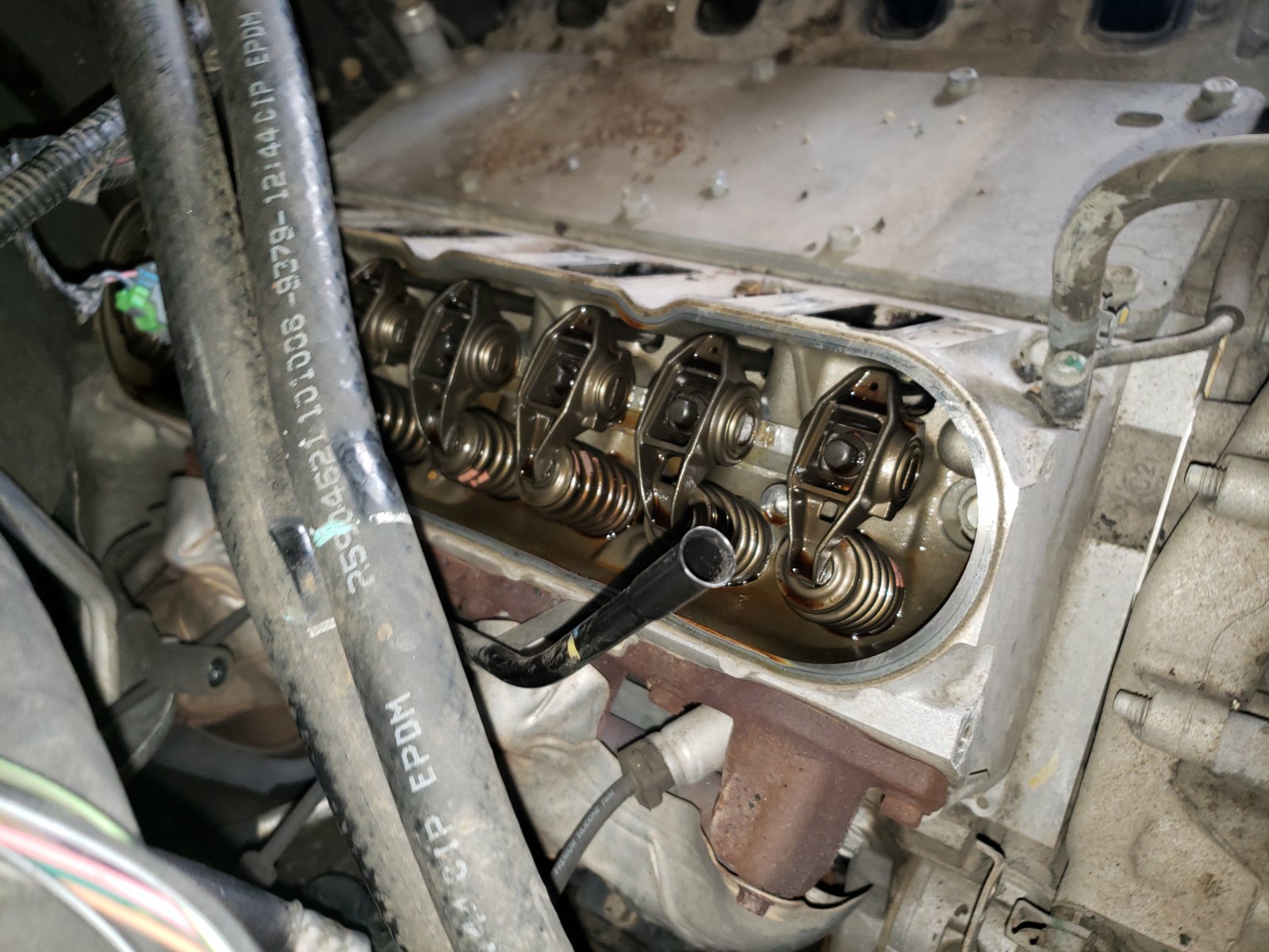

Fired the hoe up to put it in the bay, and she made some horrid noises, like the lifter decided to collapse. Tried to get it in the shop, when a REAL bad noise happened. A valve seat decided to break, and destroy a pistonView attachment 260294
Sorry to read about this Mike. Did the crack up take out the cylinder? Melling makes the replacements (CSL359F) and they are $35 at Summit. Good machine shop can swap them out in no time for minimal expense. Then of course you could always go with DART sleeves and a 4.1 bore and stroke for more cubic inches!

The valve seat broke in half and dropped into the cylinder. Half of the seat was stuck in the intake valve and wouldn't allow it to shut, lol
I'm gonna look for a new short block I think... I'm just still in disbelief that it happened and I hadn't planned on this contingency, lol.
My old heads just have a few bent valves in them if you need a good core they should do one of them anyway. The other has a few battle scars but I think a competent machine shop could prob clean it up pretty easy

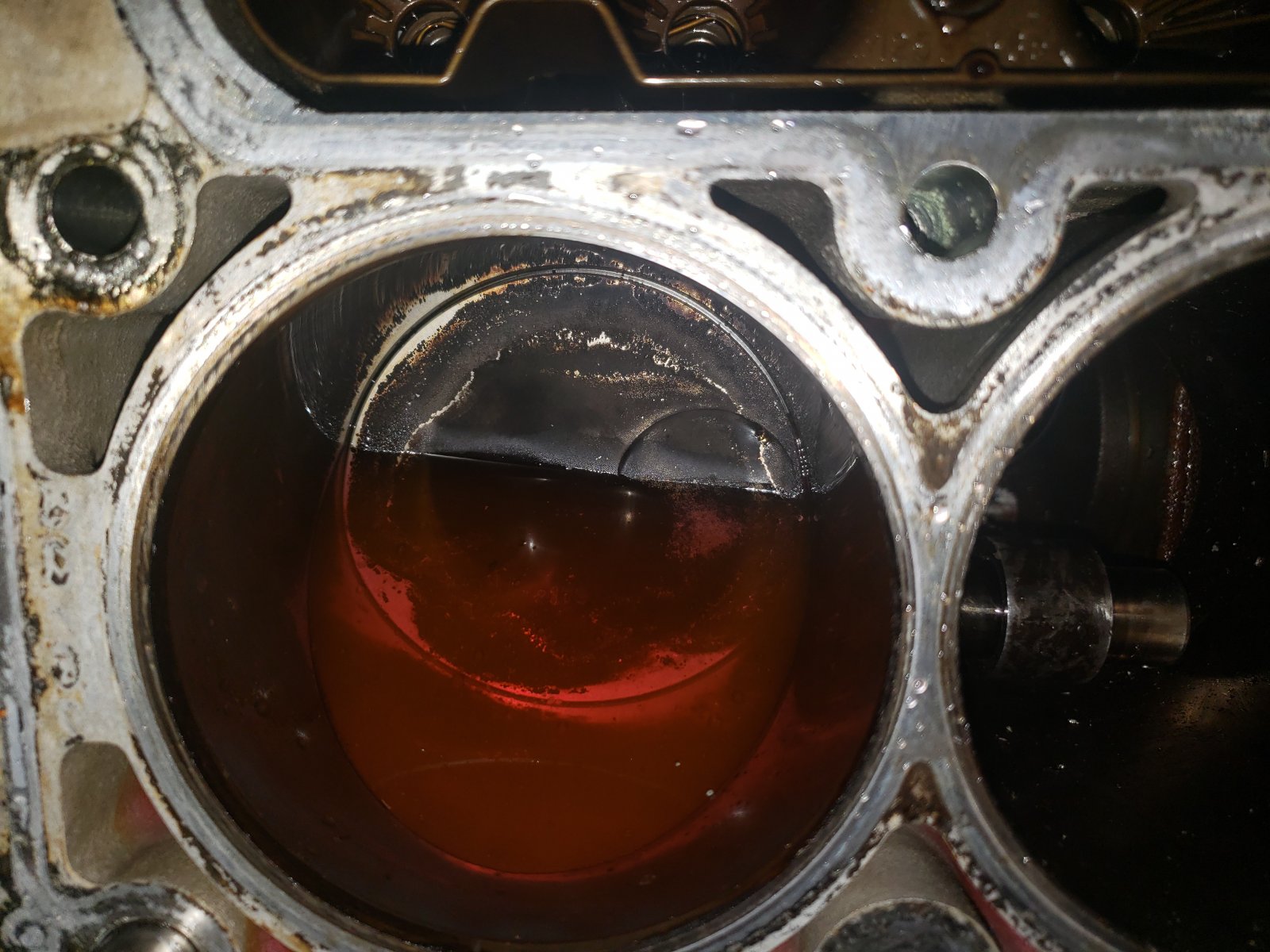

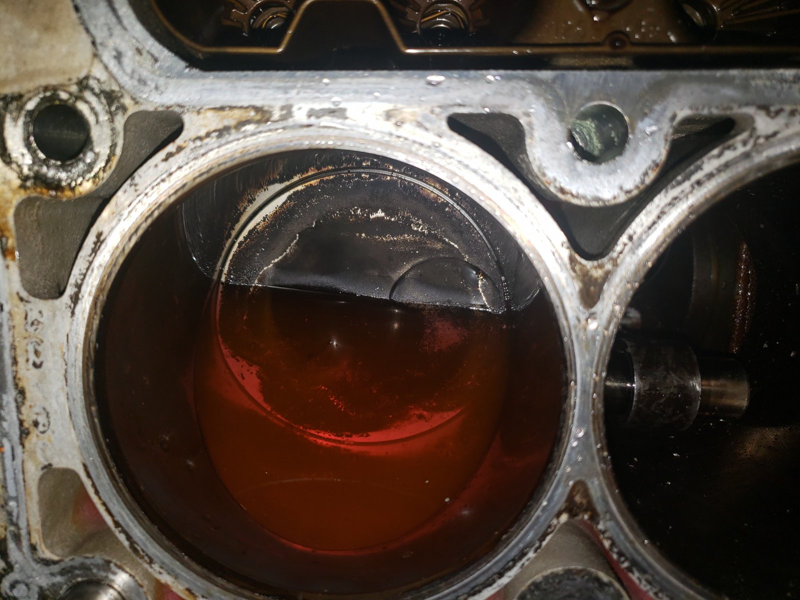

Doesn't this piston looked ****** too?
nah, i'll have some of that fruit punch tho
how does the cylinder wall look in the one that checked out? rod and piston are pretty cheap, rebearing the bottom end. should be able to get it back together
i say this because finding a l92/l94/l99/ls3 for under like $3500 is becoming harder and harder. if youre swapping the cam theyre all viable

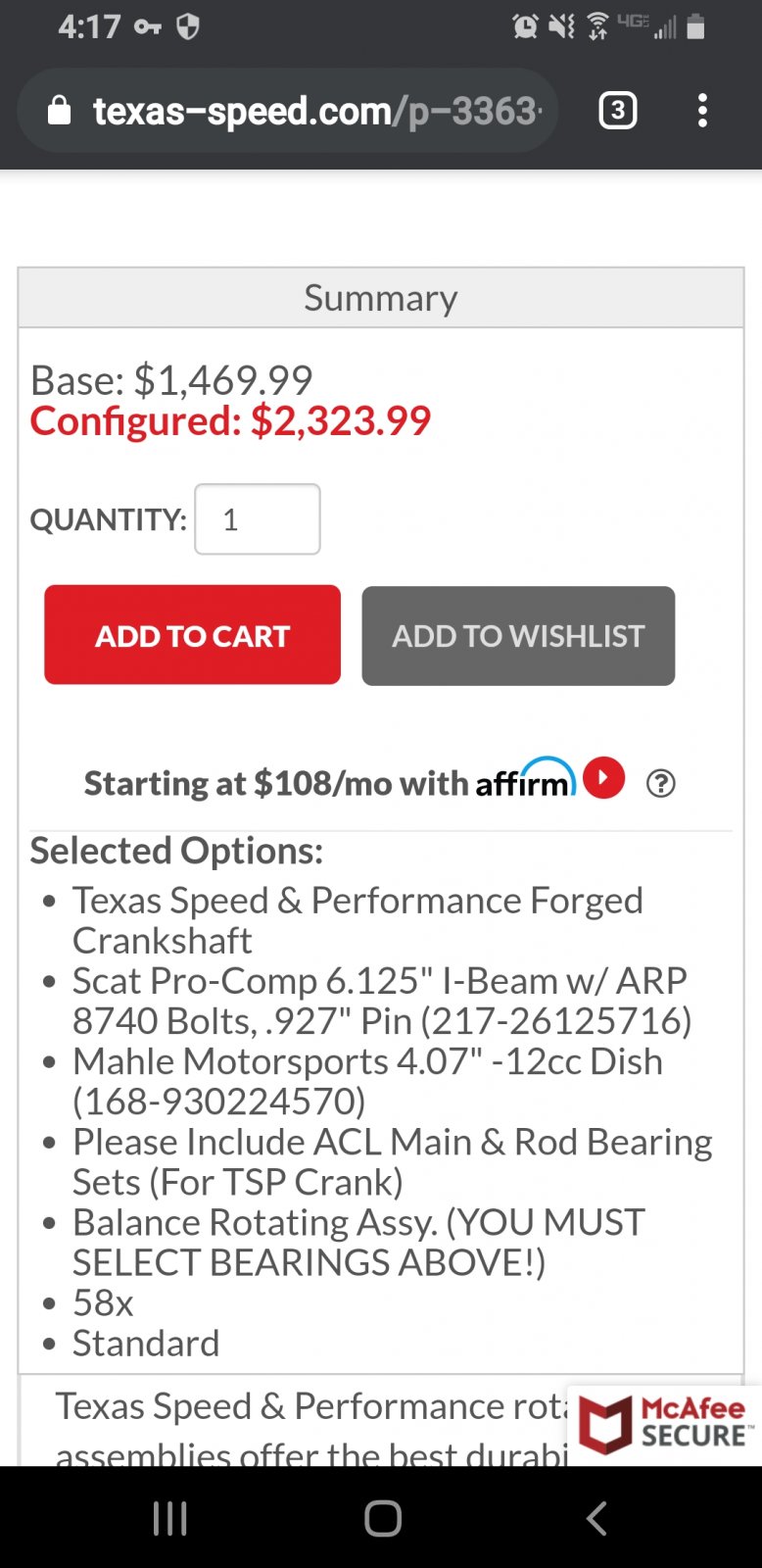

I found a new LS3 block, and am leaning towards the following for the bottom end

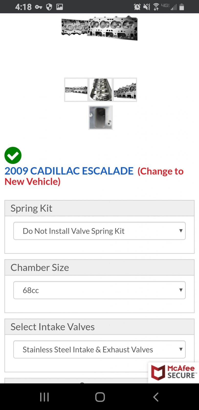

And these heads
I have to tell the site I have an Escalade in case anyone wondered. The site doesn't believe there is a 6.2 Tahoe, hahaha

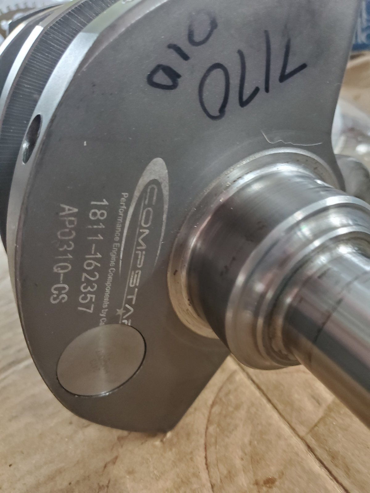

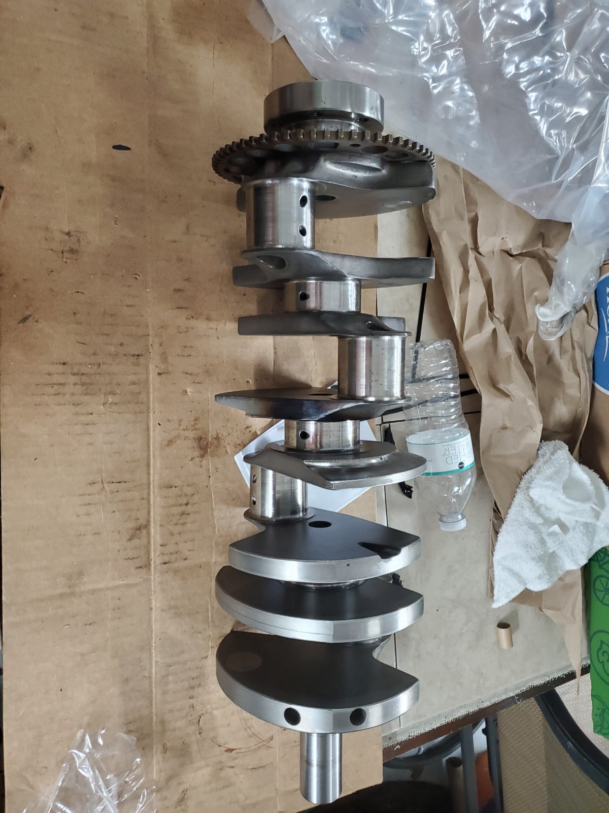

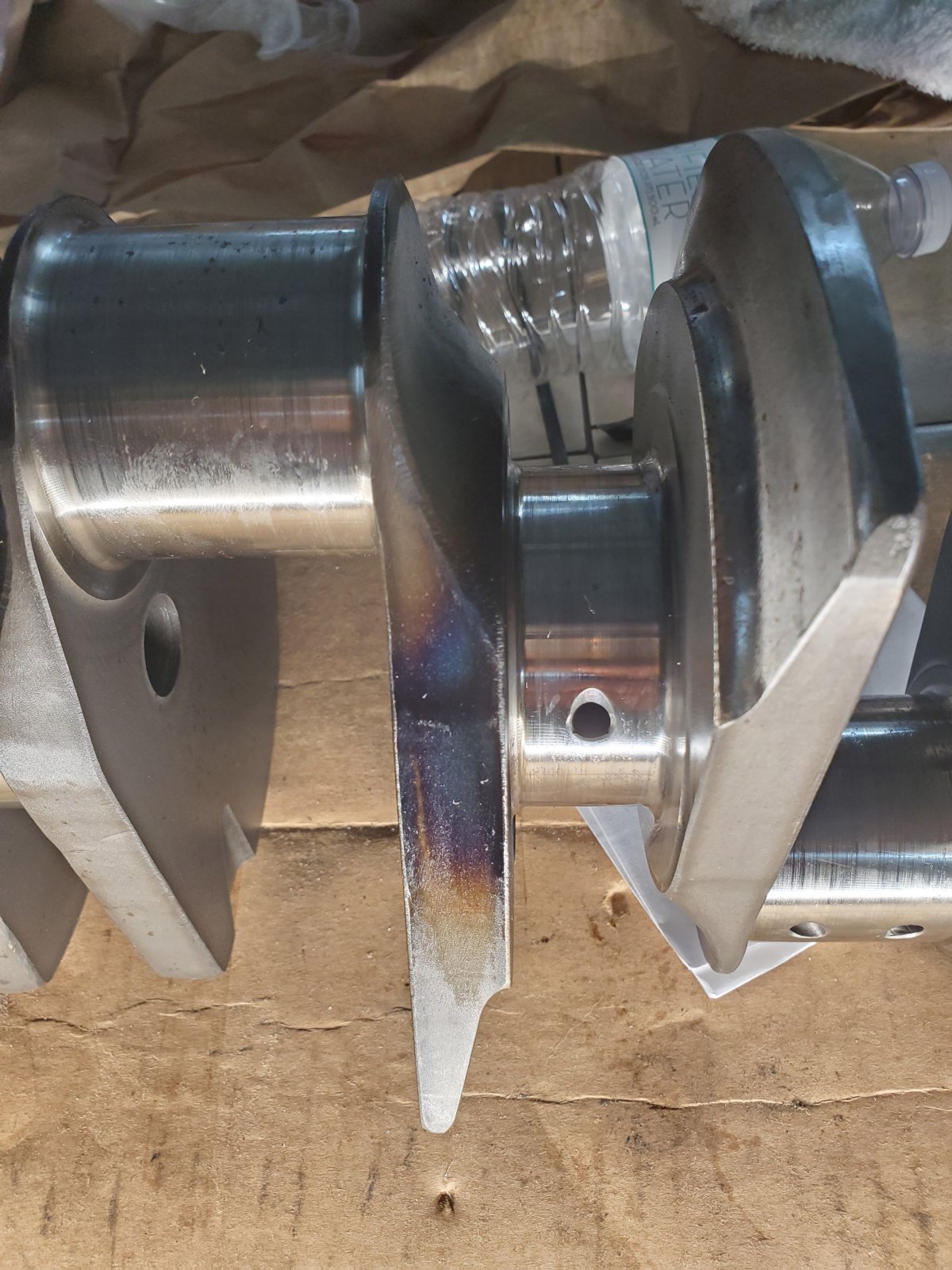

Also you reminded me I still have the first crankshaft that the thrust bearing ate up. I don't think they wanted to clean it up and expect it to perform as a new one. Going to run it by my local guy and see if he thinks it can be saved for something with a few less hp
