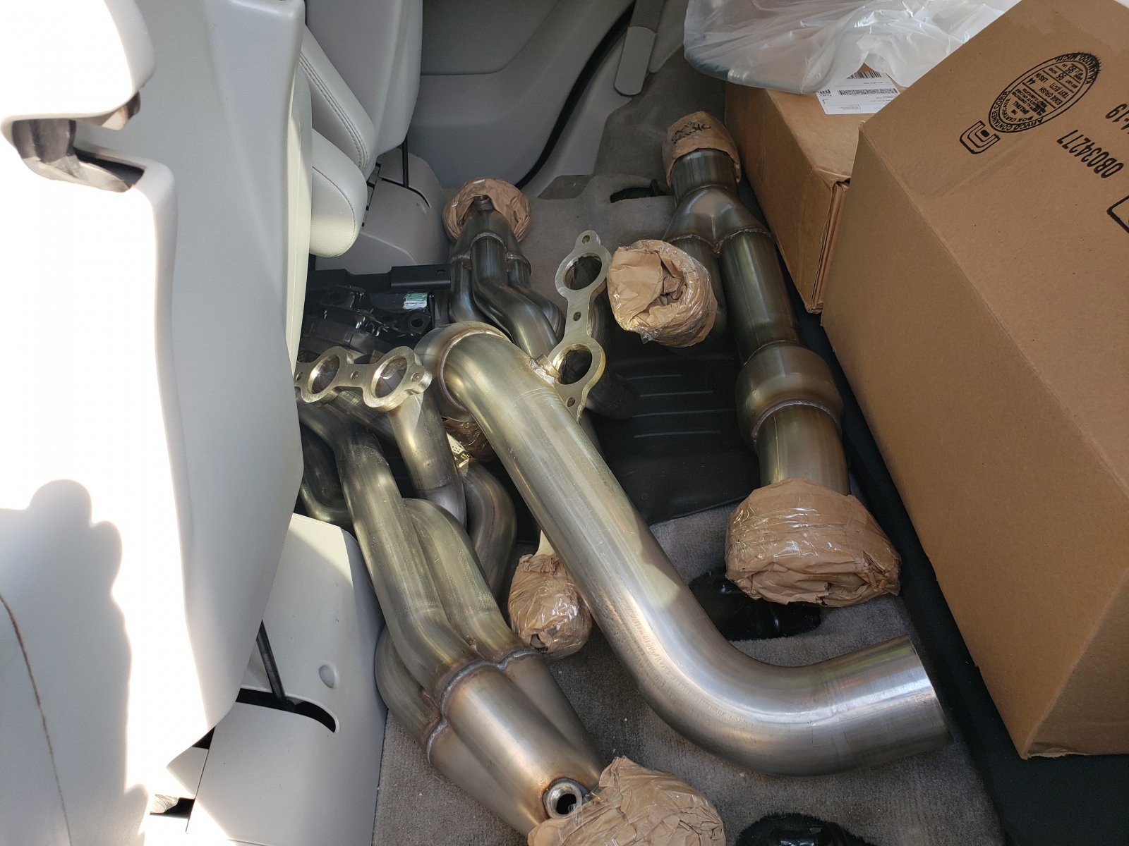

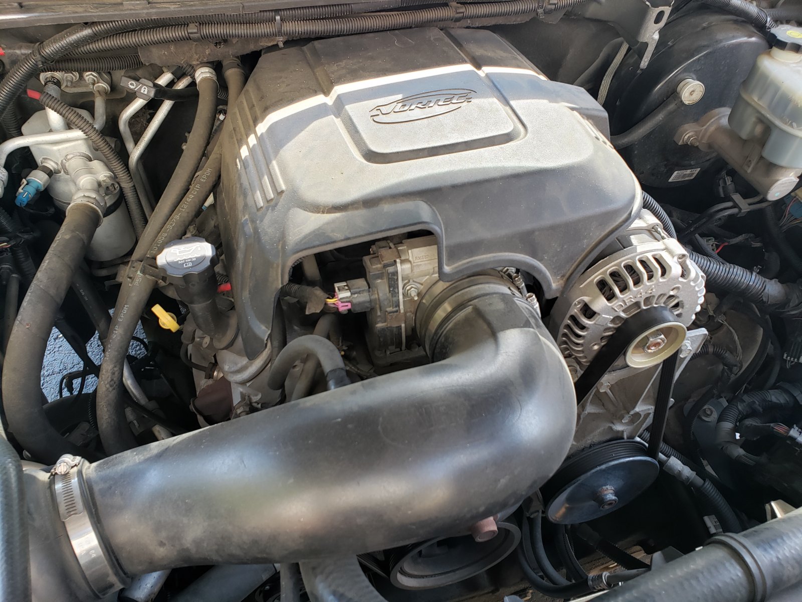

The build starts this weekend!!! I'm expecting 1 week till we complete it. This Saturday we will be taking the top end apart, and R&R various items under the hoe. Also gonna remove the bumper and get the TruCool installed. During next week, the heads will be resurfaced by our friend, and we will also install the new springs and guides and trunnions. The following Saturday will be putting it back together and having lots of fun afterwards.
For those that forgot what I'm doing:
Cam and goodies for the heads
ARH headers
Huge Radiator and Trans Cooler
Trans service
All 3 mounts.
That's the short version, haha

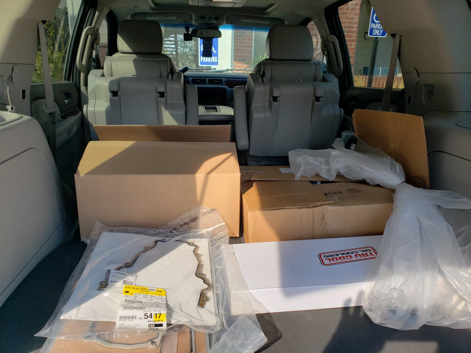

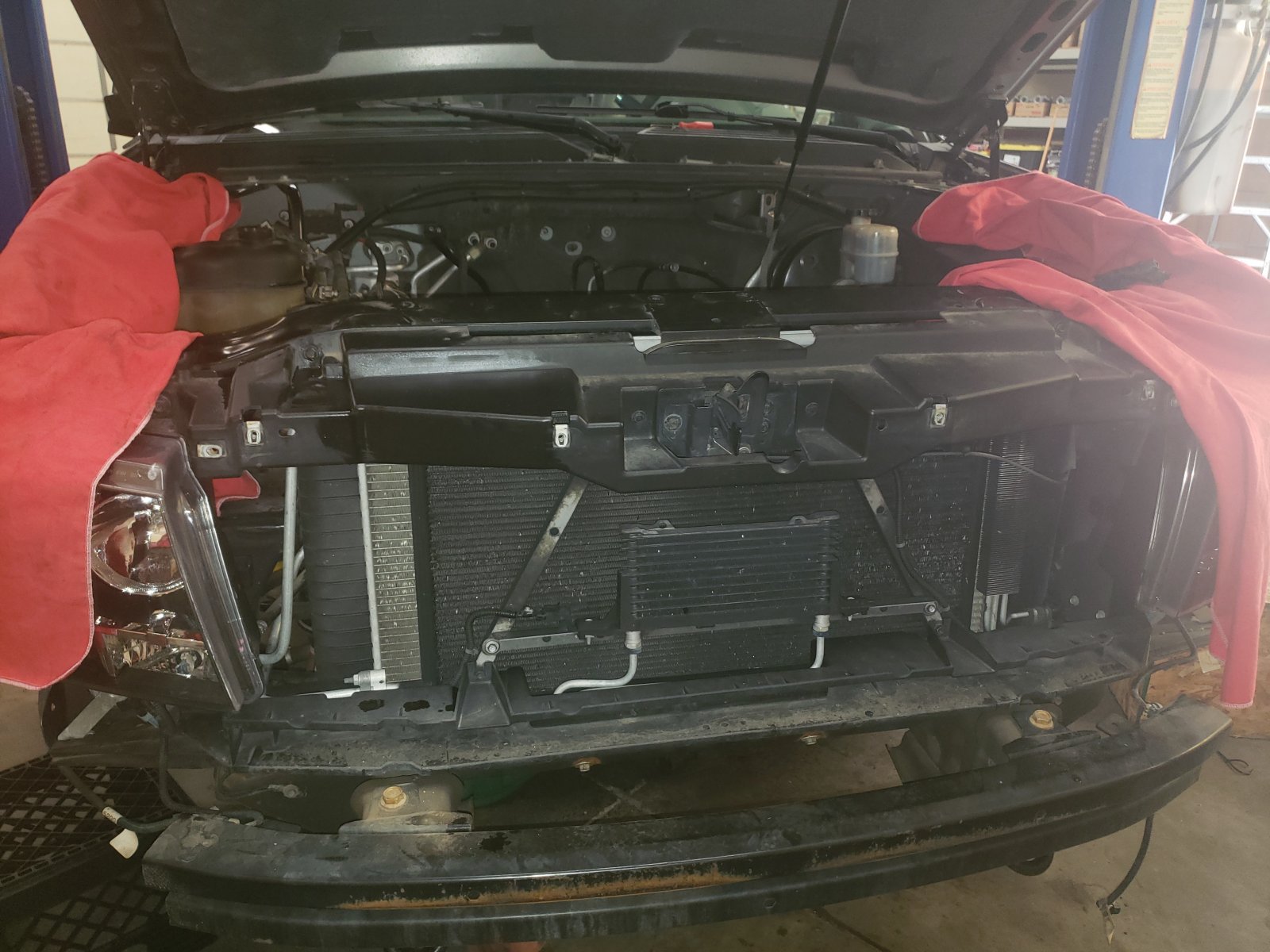

Twas the night before wrenching... Most of everything is loaded up and ready to head to the shop in the morning.

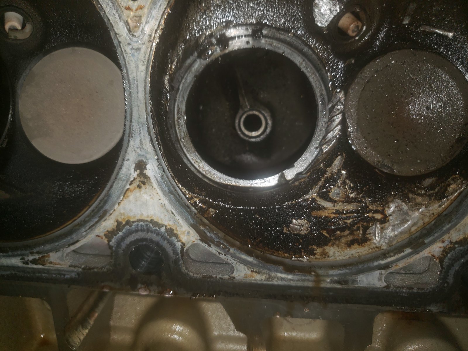

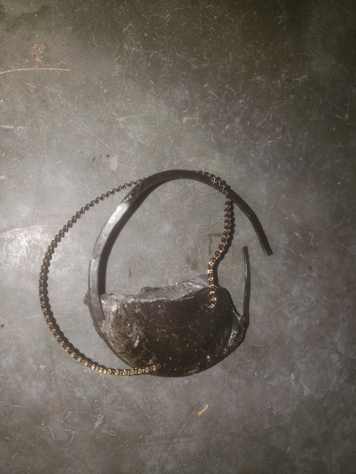

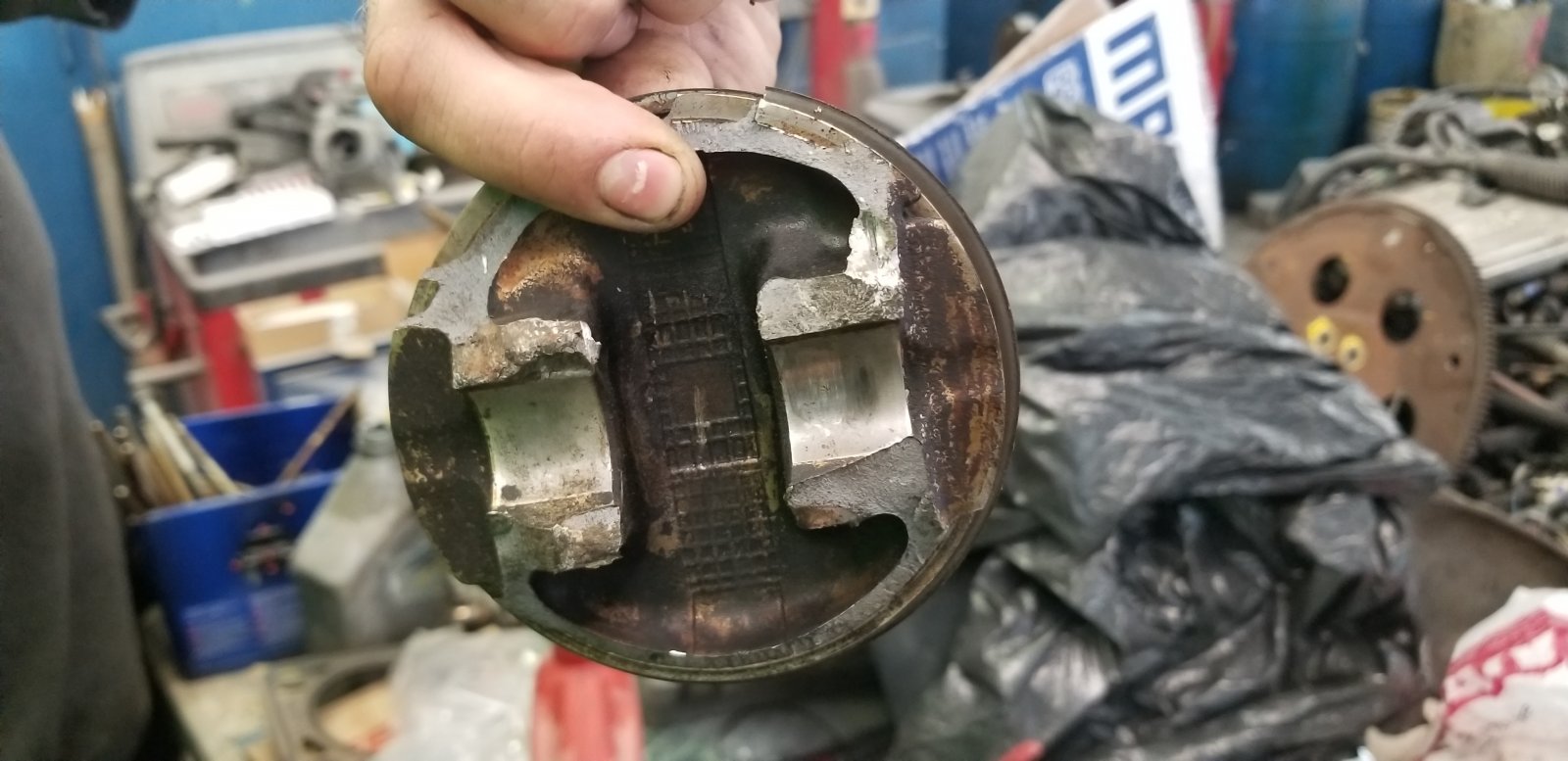

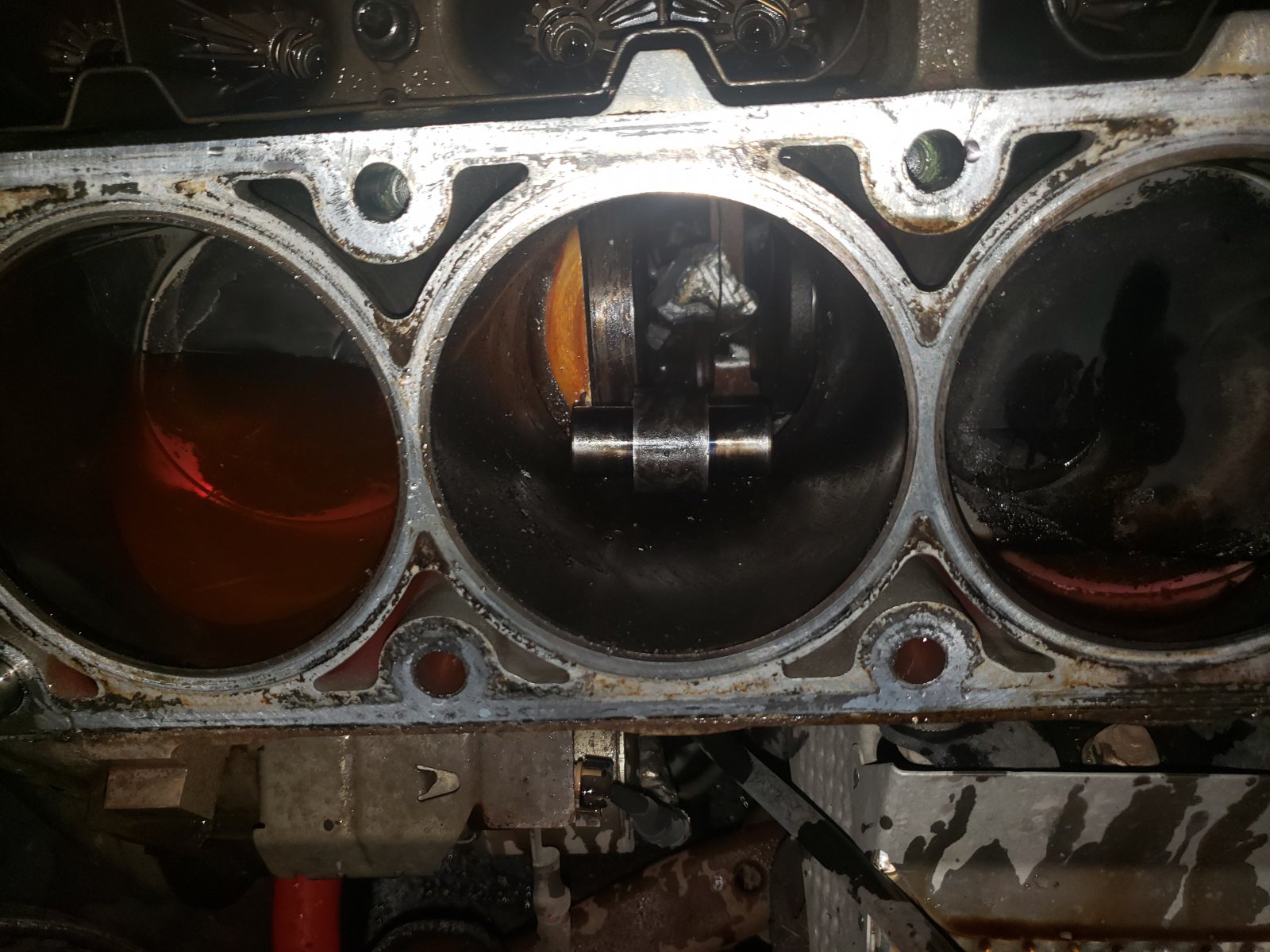

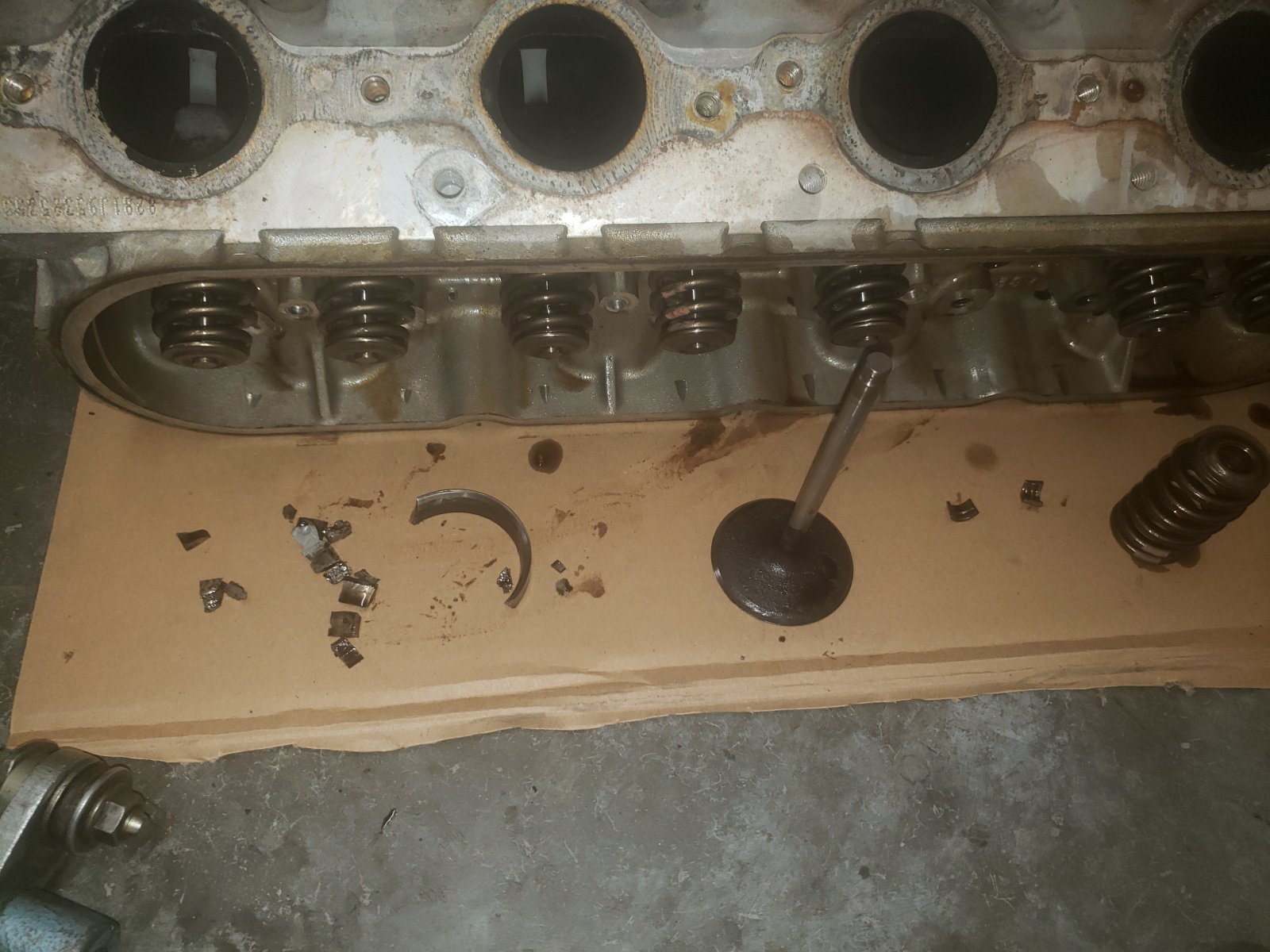

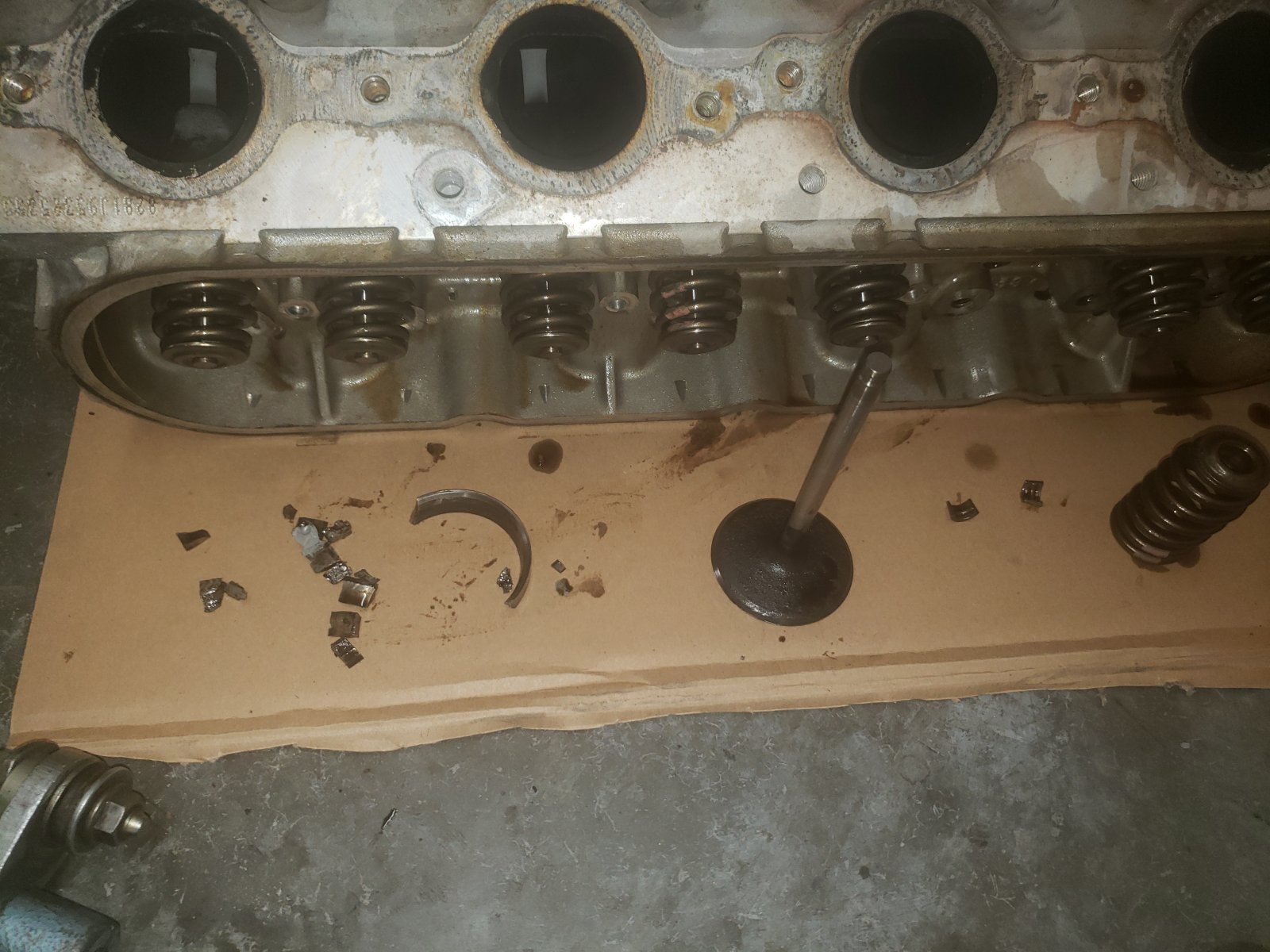

Well ****.......

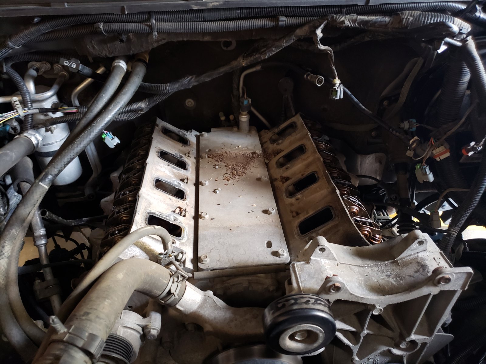

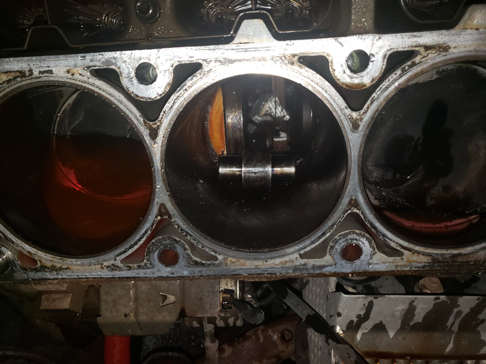

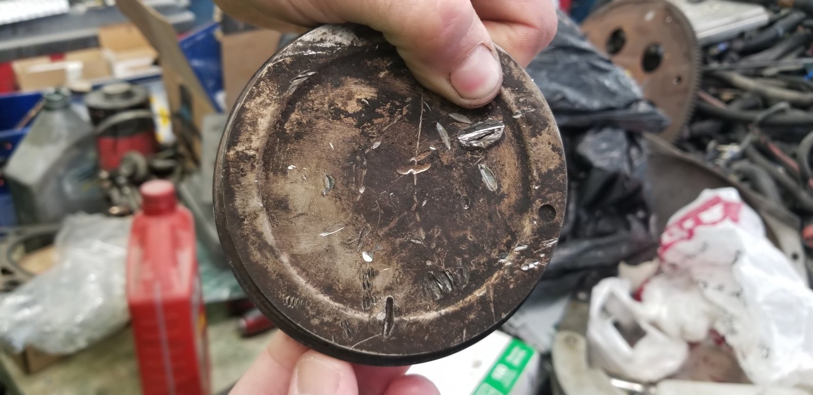

Got the hoe to the shop to begin the work. Made it there, got the bay that our friend said to use ready to go. Fired the hoe up to put it in the bay, and she made some horrid noises, like the lifter decided to collapse. Tried to get it in the shop, when a REAL bad noise happened. A valve seat decided to break, and destroy a piston....****
I'll post more pics later, and the video I was making for you guys to hear what I thought was a lifter.
Here are a few teasers...

Well ****.......
WTF??!! You're the 3rd person with a dropped valve!
Me....
Destroyed my 6.0. @Dantheman1540, who was SUPER LUCKY! Just messed up the head, and now you. WTH is going on??
Getting another motor now? Or gonna try to sleeve it?

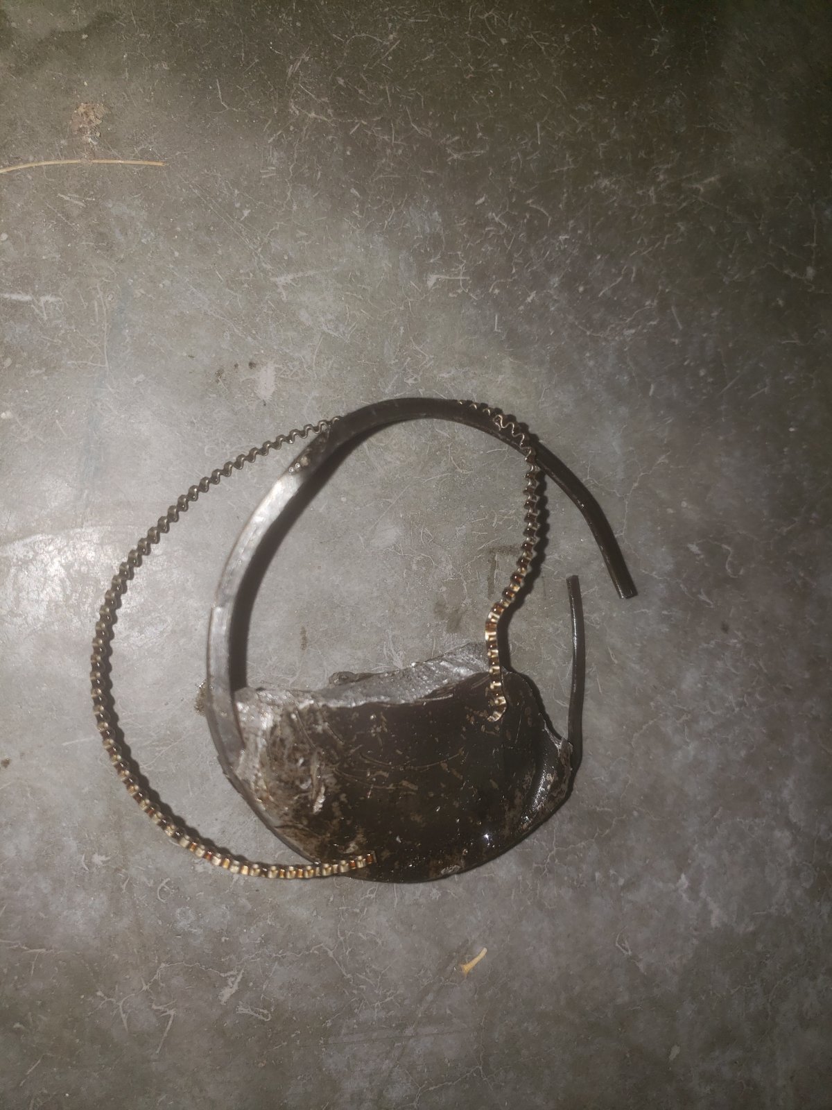

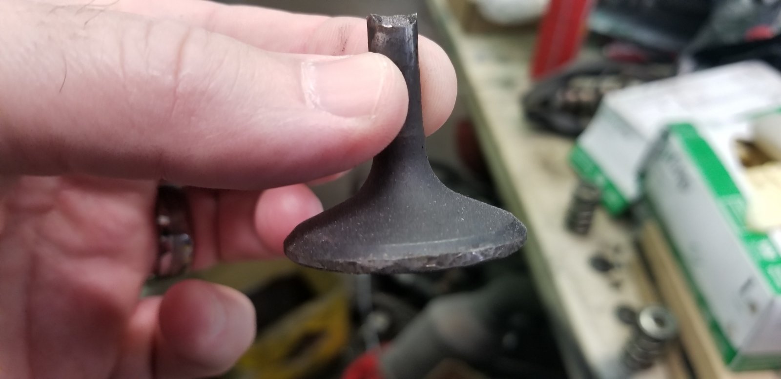

The valve seat broke in half and dropped into the cylinder. Half of the seat was stuck in the intake valve and wouldn't allow it to shut, lol
I'm gonna look for a new short block I think... I'm just still in disbelief that it happened and I hadn't planned on this contingency, lol.

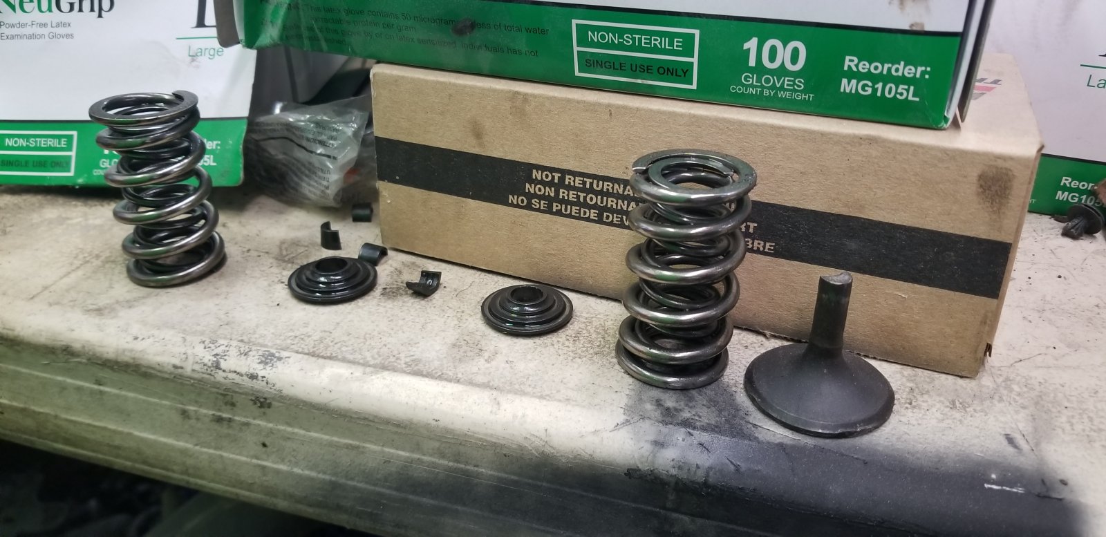

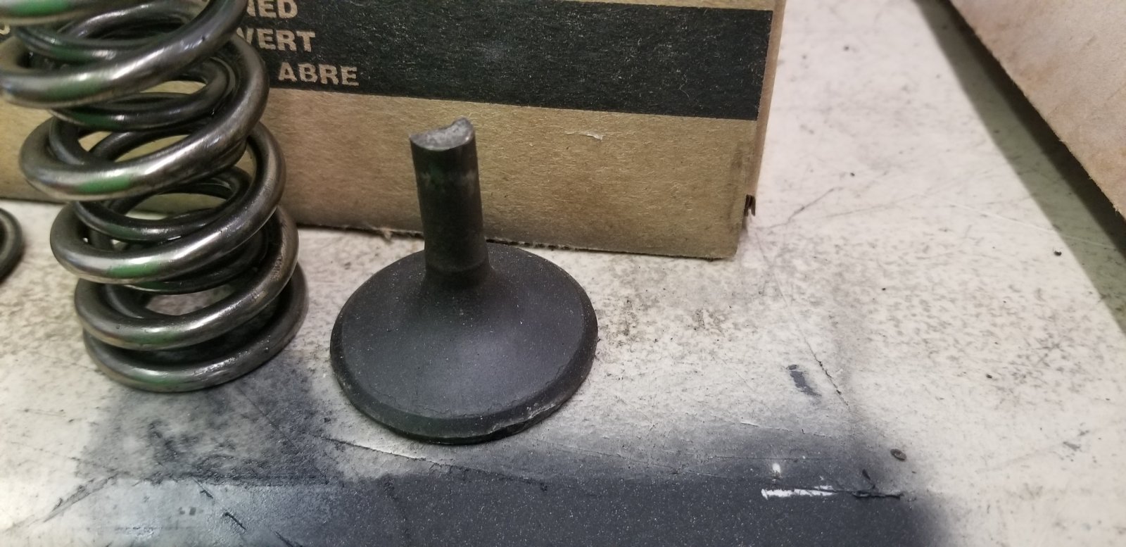

My valve....
