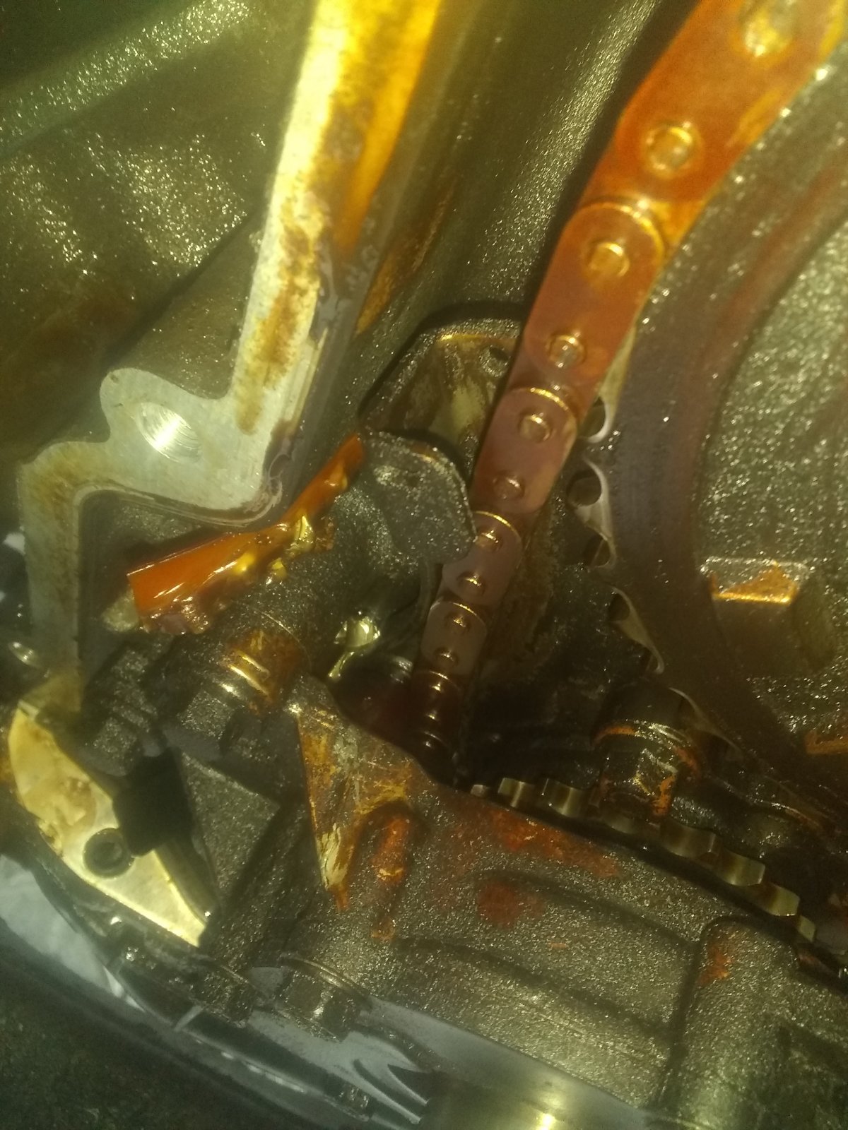

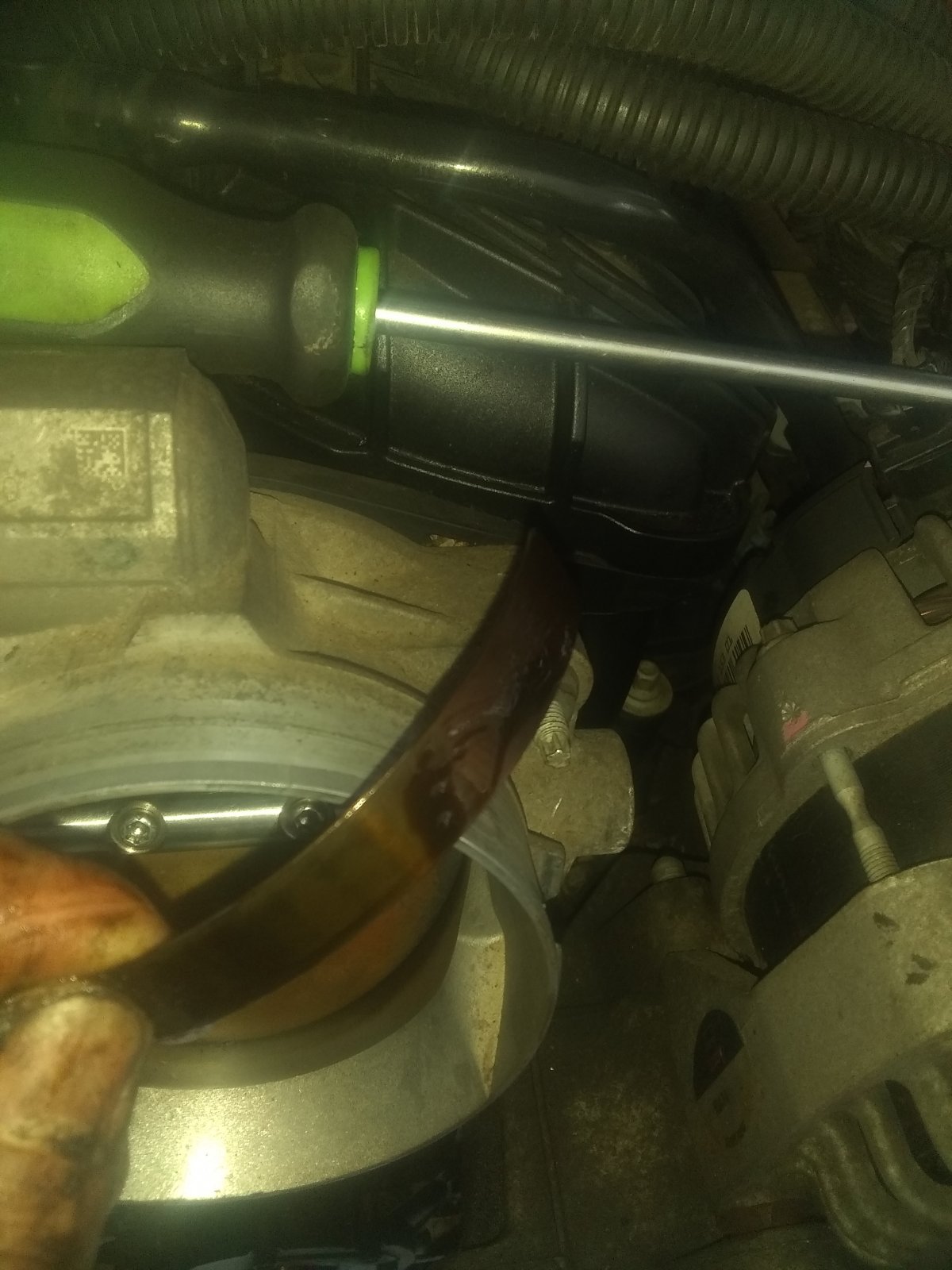

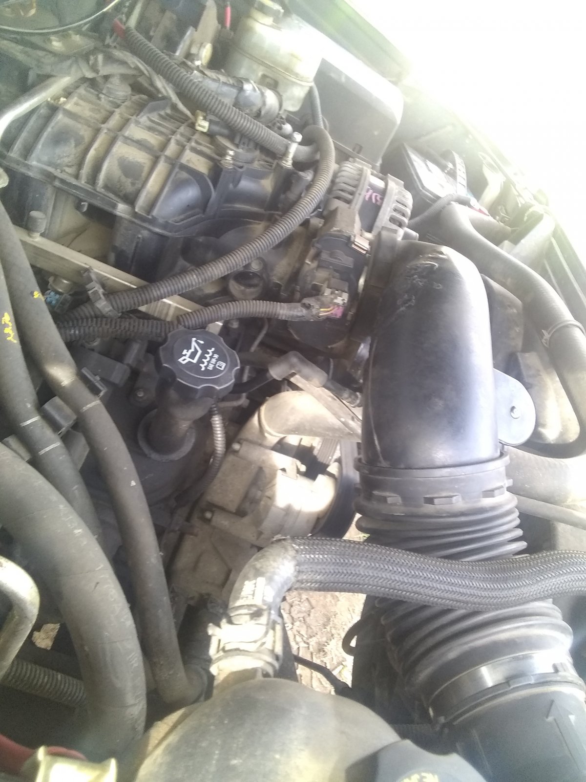

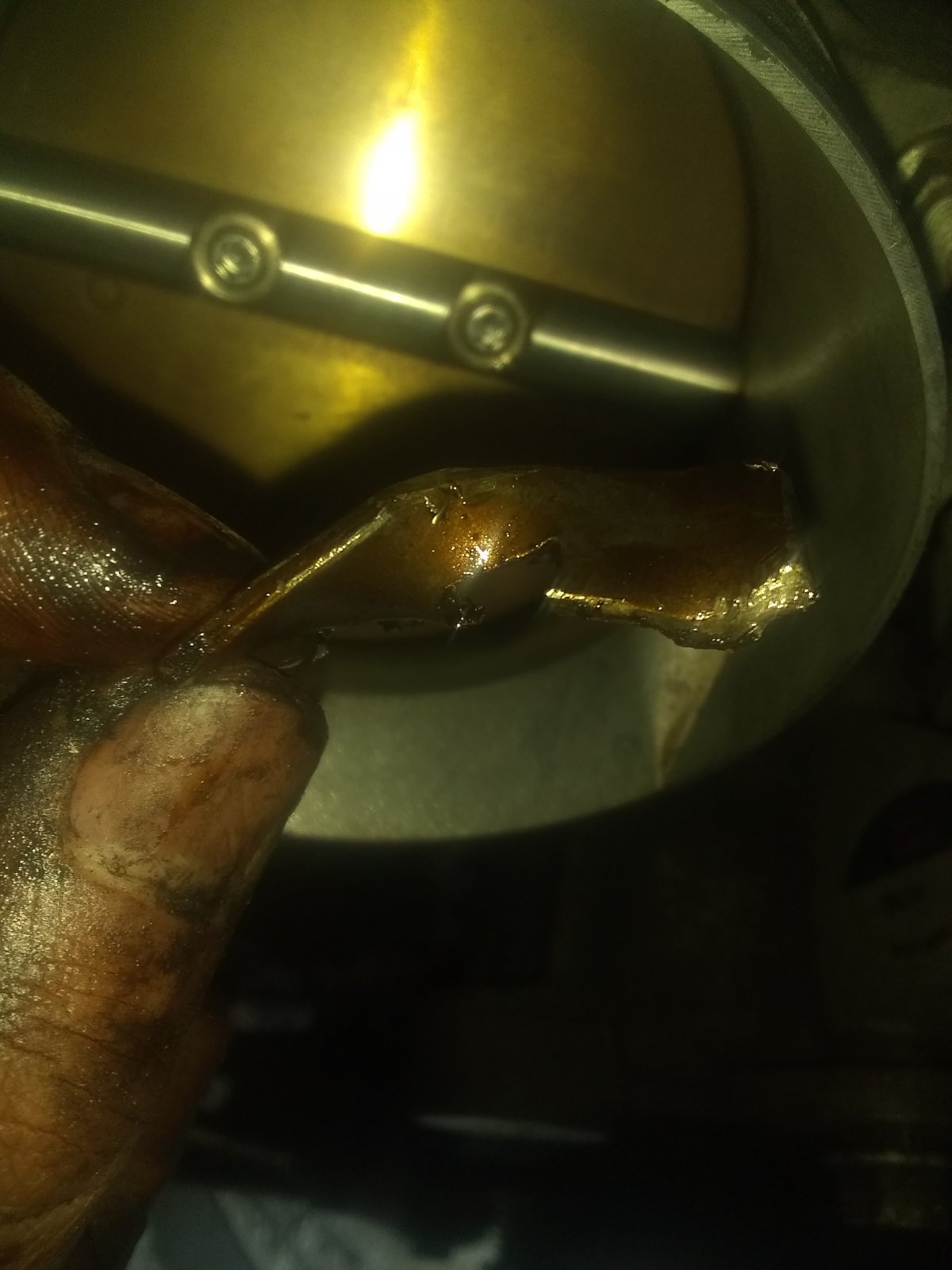

Just got front cover off found the problem timing chain tensioner came apart. And the mangled piece in second picture was between oil pump and crank sprocket grinding on sprocket. So aslong as the metal in the oil didn't damage any bearings or anything it should hopefully be alright? Still gotta drop the differential and steering rack to get oil pan off. Sorry pics are dark phones dying and I'm under a tarp it's pouring out.
View attachment 276039 View attachment 276042 View attachment 276044 View attachment 276046 View attachment 276047
Holy shit! Great work given the conditions you are working in, Reminds me of me! Hey JMO but given the conditions you are working in you may consider simply flushing the pan by pouring diesel fuel down the front cover and flushing the pan that way. Laying and assembling in "mud" wont be the cleanest finished result anyway. Just consider it? i mean a couple gallons as fast as you can pour it in, to wash the windage tray and flush the pan through the drain plug. Your oil pump is for sure damaged.
It quieted down after second oil flush ran in for a While. Didn't think to try diesel fuel but with it ticking second flush I stuck 3 quarts of 15w 40 1 quart lucas and 1 quart atf. Started thick and light pink came out dark pinkish brown still getting metal on the magnet but oil is looking better coming out. Running great no codes but can't get it inspected yet because o2 sensor and o2 sensor heater and evap readiness monitors won't set. Evap almost never does on this burb. but normally o2 monitors will set so idk why it won't. Drove over 200 miles already. Only theory I have is morning before I did oil change that lead to all this, I deleted the resonators off the parts burbs intake tube and swapped it on also opened holes between filter box and fender. Basically a ugly but free cold air intake. Worked surprisingly well. This burb usually struggles climbing the hill if taking right out of our driveway before would barely do 55 going up it after doing intake it was able to hit 70 by time I got to the top. didn't expect that only expected more noise lol. Idk if that is messing with o2s? I've had cold air intakes cause lean codes on other vehicles. Later I will swap stock tube back on temporarily and see if they will set.
