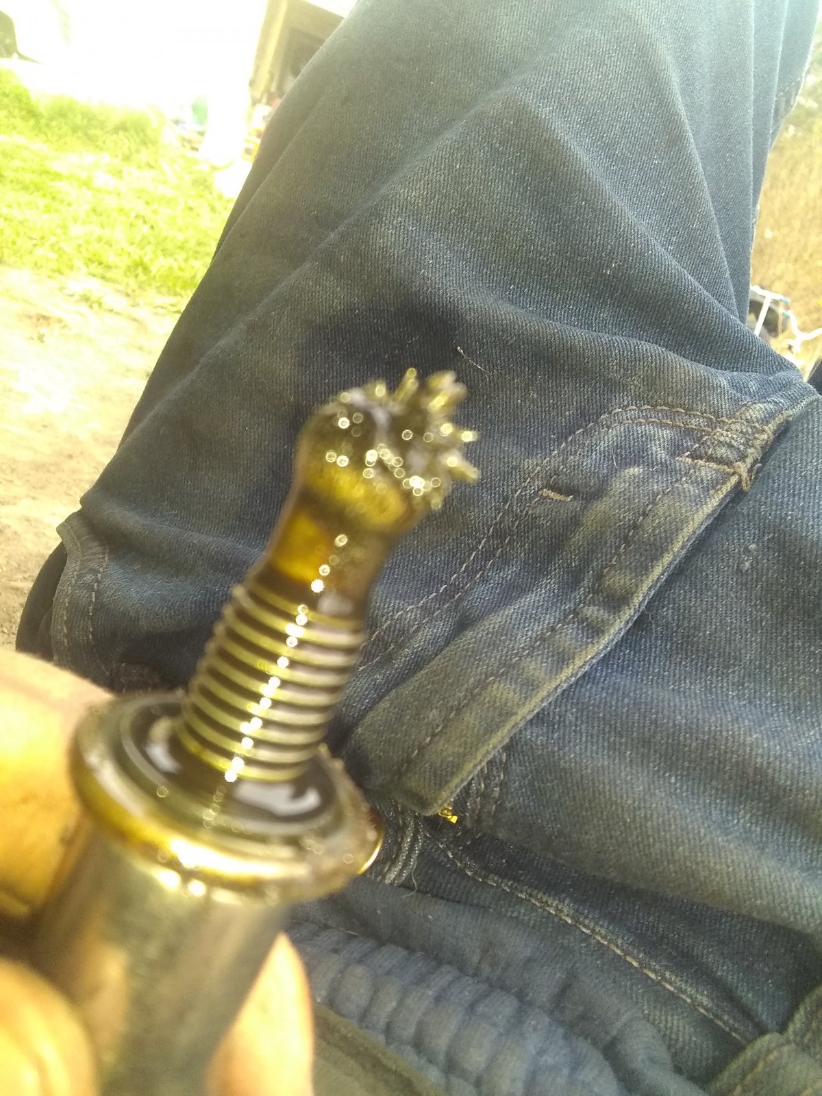

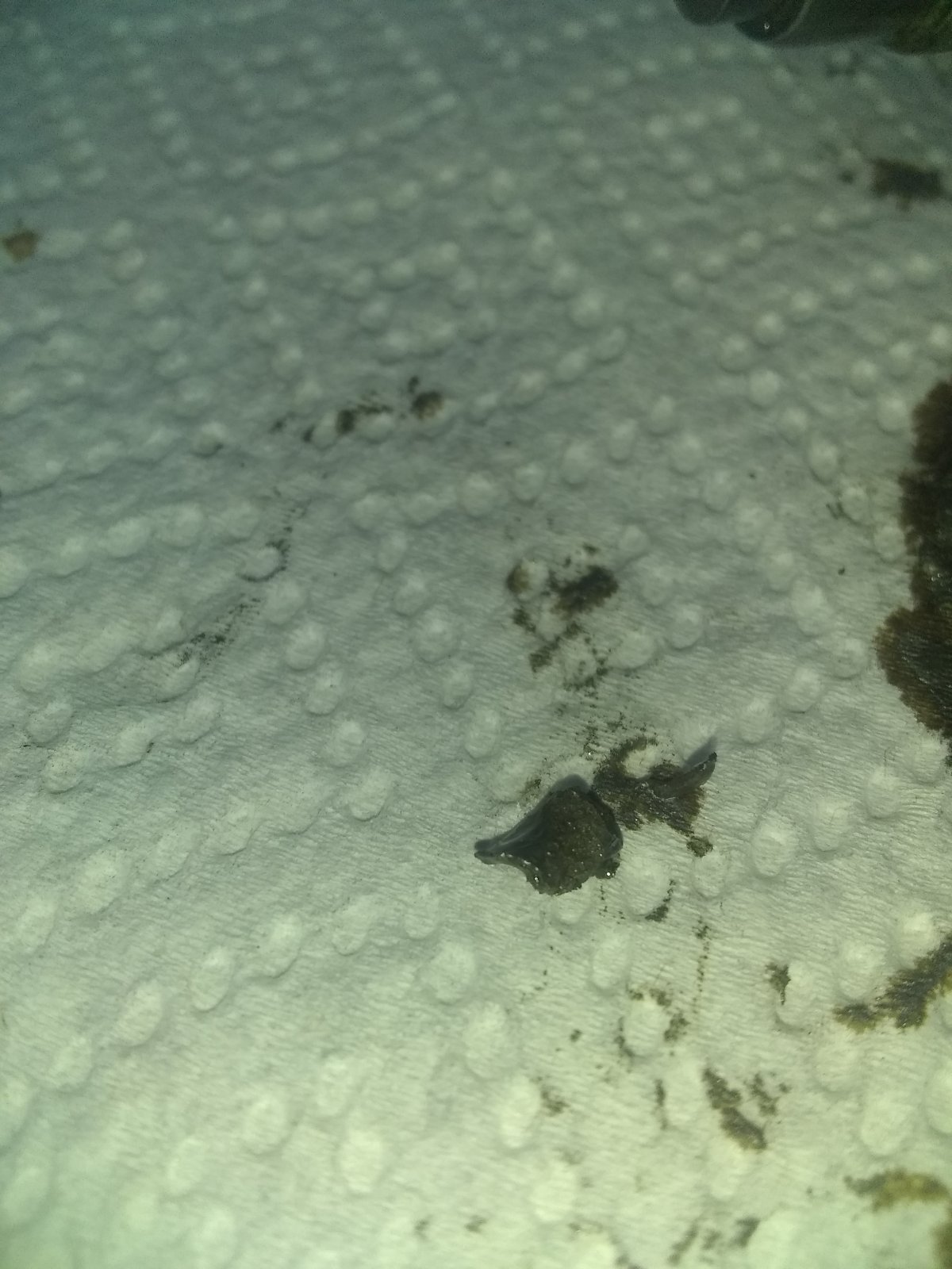

Went to change oil few minutes ago and found this on the drain plug alot of flake and a couple big chunks. She has been throwing p0016 cam crank code for couple of weeks. Could all this be just from a bad timing chain? Do I need to rebuild the engine or will it be fine if I just put a new timing chain on?

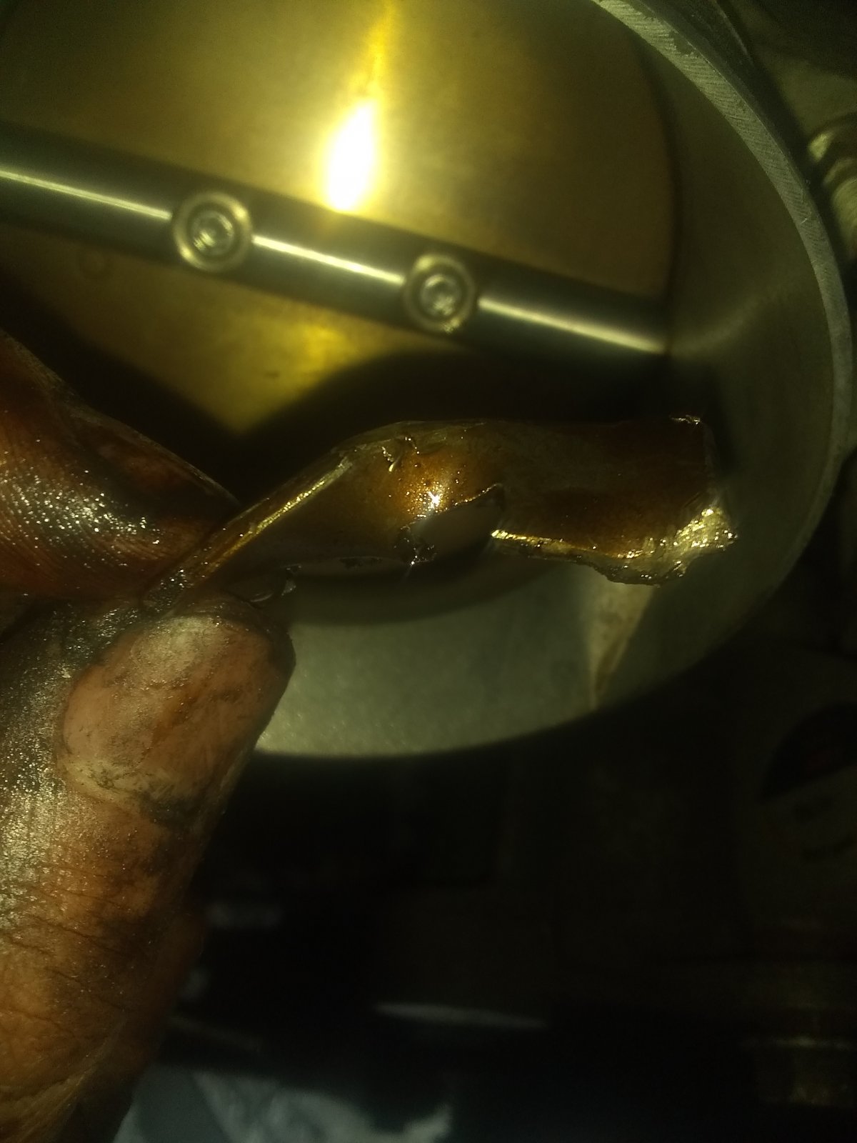

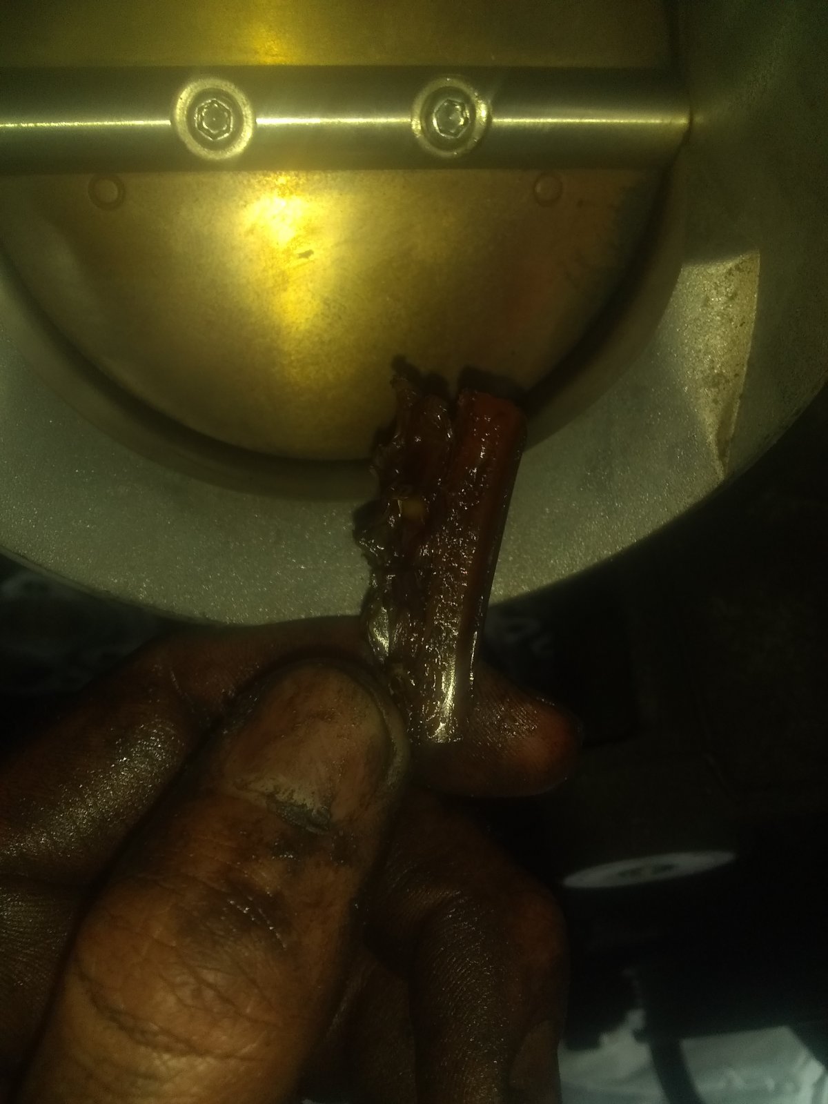

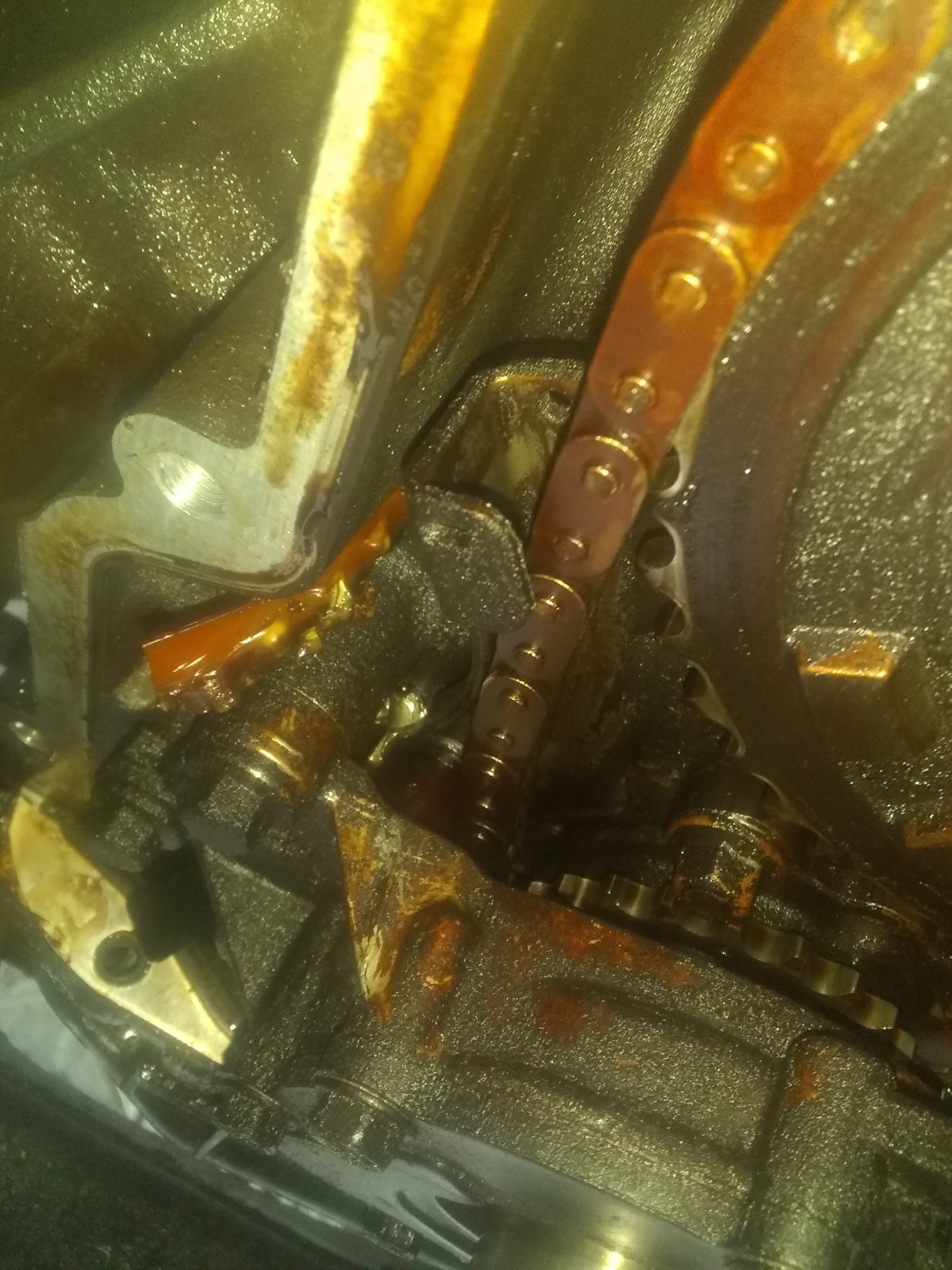

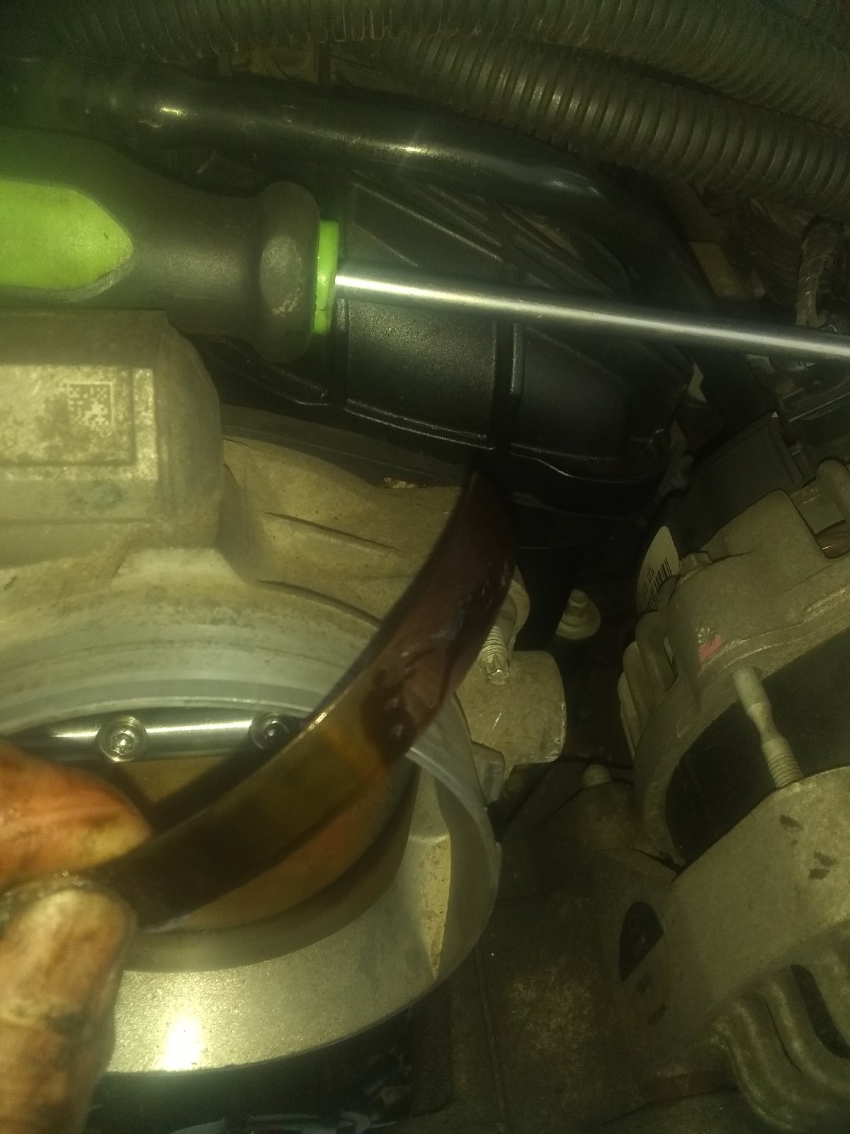

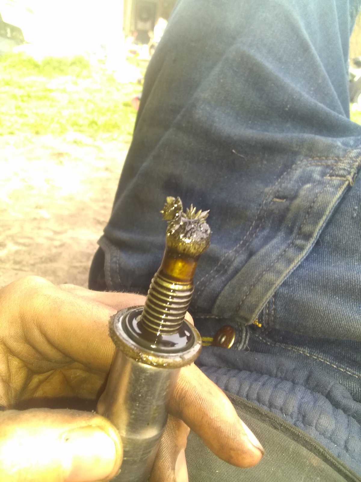

Just got front cover off found the problem timing chain tensioner came apart. And the mangled piece in second picture was between oil pump and crank sprocket grinding on sprocket. So aslong as the metal in the oil didn't damage any bearings or anything it should hopefully be alright? Still gotta drop the differential and steering rack to get oil pan off. Sorry pics are dark phones dying and I'm under a tarp it's pouring out.
