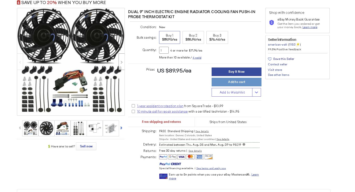

ran it a little hard today and yesterday in 100deg ambient weather @100mph and above she likes to hang around 203-205deg's at sea level
I'm thinking I will pick up a fan kit like this, comes with everything including a thermocouple switch that turns on at 180 and shuts off at 165
it's generic and that's fine if it holds up for a while. It's a puller by default but can be reversed as well.

mine does ok just putting around it will stay under 200 but if I push it hard it goes up, since it was re-built for 500hp it runs about 15-20 deg higher than it used to then putting it down below it gets less air, the fan kit looks pretty simple to install the tru cool is 8.5 X 22 and the 2 fans are 9" each so should fit just right
