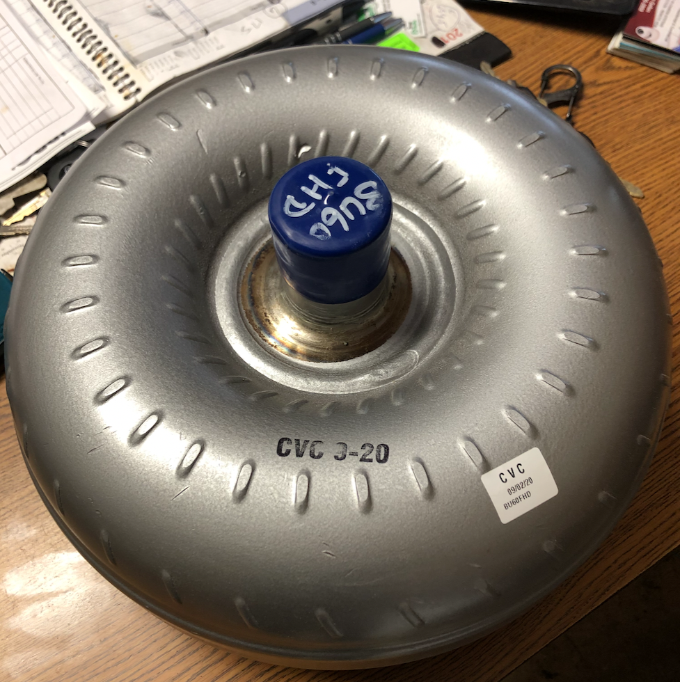

per the local shop they start seeing them come in around 120-140k I guess it really depends on how hard you beat on it, and I am referring to the 6l80's the TC is weak and takes out the pump, wears out the bell housing, stator.
Is there a TC that’s recommended for replacement, or is better off sticking with another OEM since 100-200k is still a good number (unless you’re behind the wheel, in which case that “actual” mileage number is doubled to then reflect the “abused” mileage)?
a billet torque converter, mine was done with one from a local manufacture from the san jose, ca area, "saxco", there not a "brand name" company but are popular with the locals
Same. Mine was from a national overhauler that my transmission shop works with, called CVC. It's an upgraded OEM unit with a billet cover (stronger, less flex and ballooning), and a stronger lock-up clutch mechanism. The model is BU60FHD.
