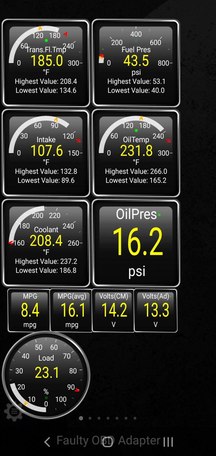

I did some moderate hills yesterday pulling my 5000lb camper and my engine temp reached 237 and it was about 100 outside. My trans temp reached a max of 208 so I'm not worried about that, just my engine temp. The rest of the trip I ran with no AC and it peaked around 220. I have a Derale transmission cooler and my next mod might be to relocate it to the lower intake. But what I don't understand is that pulling the camper in traffic or around town in stop and go is fine and the temps stay normal, but on the highway when it should be getting tons of airflow is when I seem to have issues? Here's a screenshot of my numbers.
