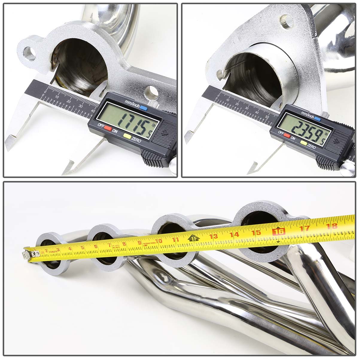

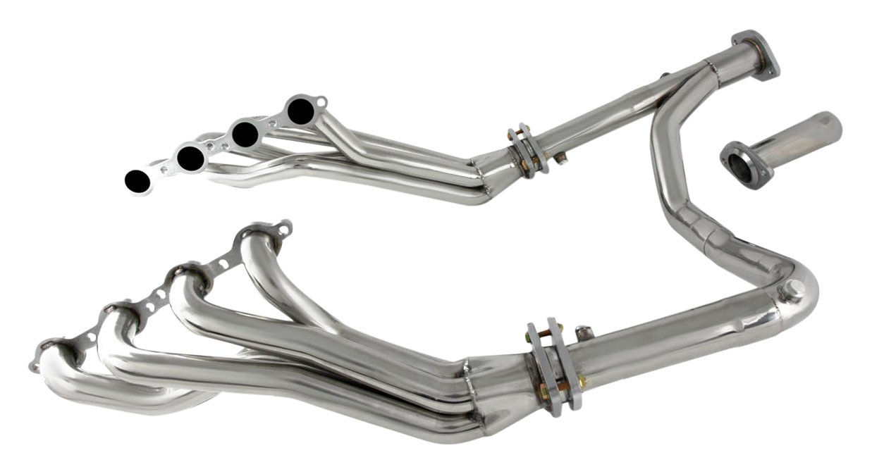

I had to research this. Unless these are just stock photos, I can see some notable differences:
I'm gonna look for real-world pics of the headers to be sure. They are all advertised as being made of 304 stainless, but I don't know what gauge. Just comparing the two above pics, I like the SE better due to the slightly less abrupt primary-to-collector transition and smoother Y-pipe merge. The primaries also appear to be equal-length or at least closer to it. I'd rather equal length over "whatever fits" length as a second place to tuned length.
It also looks like the DNAs are a bit undersized- not quite 1.75" primaries and I don't know what's up with that 2.36" collector outlet diameter.
This is all just fine for a stock motor, but it's leaving power on the table and not allowing any room for future mods. I'm sure they sacrifice some upper-RPM power to retain a bit more low-end, though.

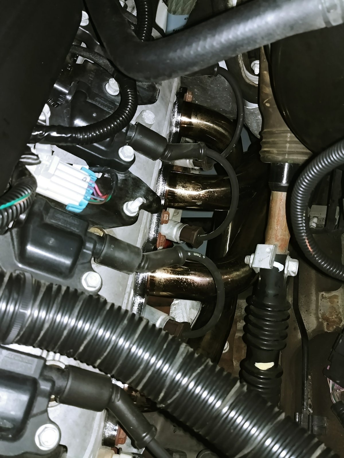

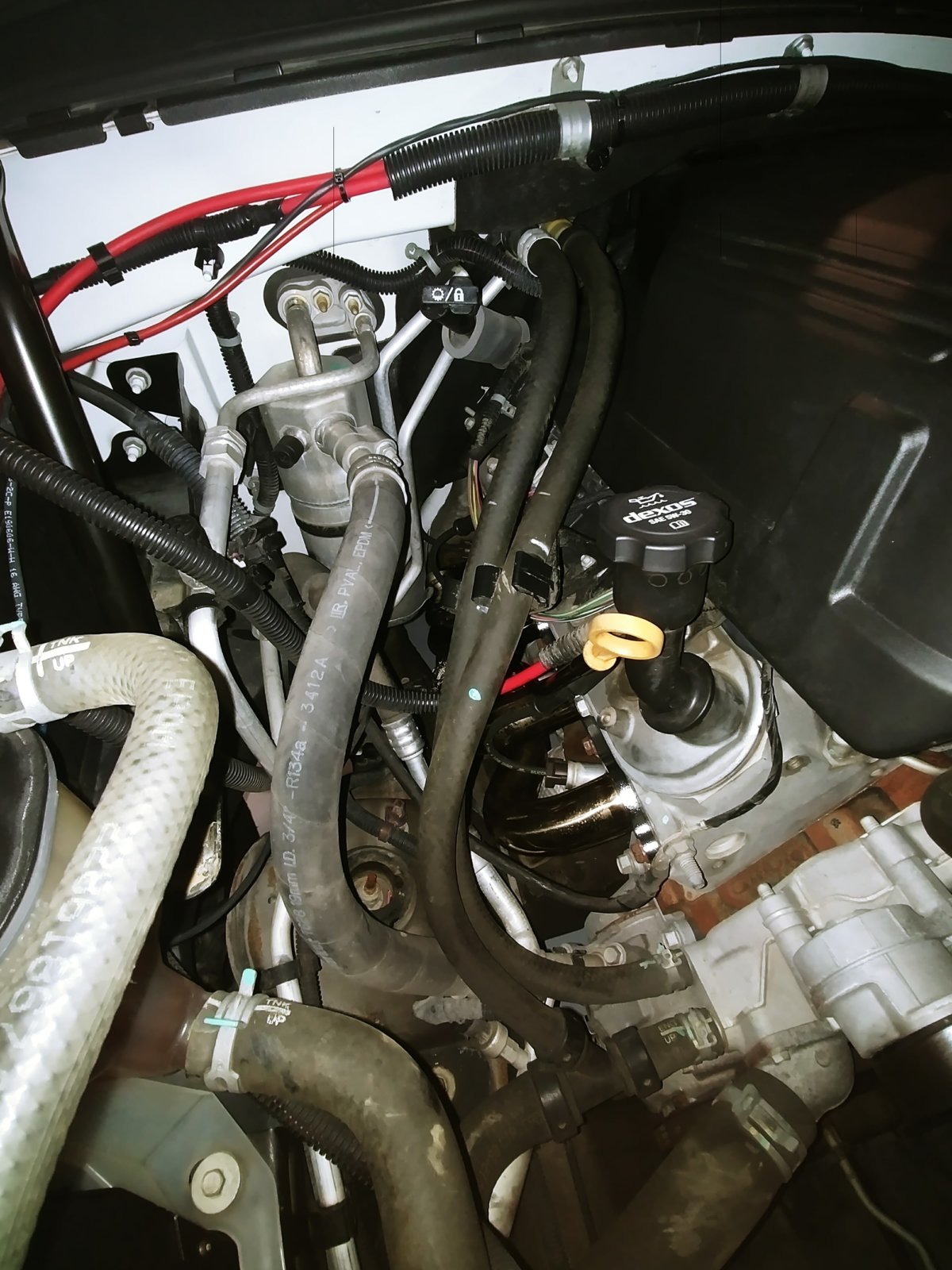

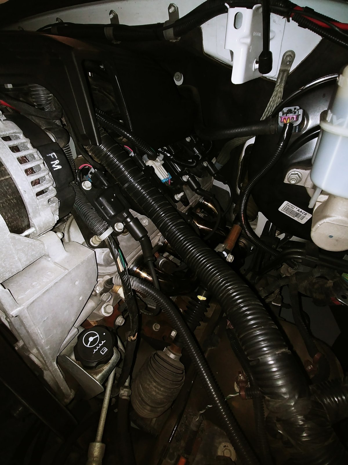

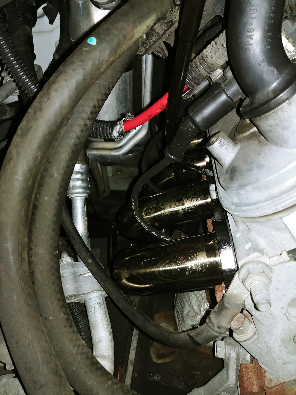

Ok so I got the truck tuned Friday at Horsepower Sales. I had them remove the DOD and secondary O2 sensor. To sum it up in one word, awesome! I am very happy with the results from my mild modifications. I promise I will get some more pictures of under the truck and a video of it running. It does not drone on the highway and is actually quite tame unless you get on the throttle.
Also to answer a previous question. The mid/y pipe is above the transmission support beam.

Did your truck already have only one down stream o2 or did you have two
Kyle Pezzetti
Nov 16, 2017
55
71
OK wasn't sure how these worked for it since from the pictures it inky has a bung athe the y. Would that matter if the down stream o2 gets turned off with a tune
