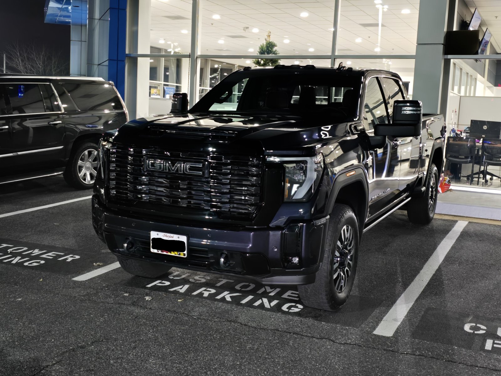

I appreciate everyone's help and assistance. I got the 2 quotes back, with a ridiculous timeline and no promise that it would be fixed from each place I asked.
I decided to cut my losses and traded it in for a 2026 GMC Sierra 2500HD Denali Ultimate. My first diesel and first pickup. Stoked.
It was awesome being part of this community. I will certainly miss you all!
Very Nice! No DOD there! LOL Just as an FYI, I ran into a guy at the gas station today with a for sale sign on his ESV ($10K). 2018 with 370K miles OMG. DOD deleted at 100K. Same engine, 2nd transmission. I'm thoroughly convinced that the gen 5 engines without DOD have good longevity. Good Luck with the truck. Now ya need $10K in lift and new 37" wheels....right?
