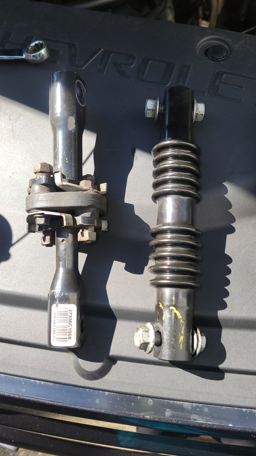

I'm running Texas Speed silverado 1⅞" headers with cats and 3" y pipe out the back. It was my first time doing headers but I got it done in a weekend.
*Remember the o² extensions
*Personally, I needed to find a piece from a Silverado steering shaft for my headers to fit without rubbing. He's a pic of the one from my 2018 Tahoe vs the one I found from a junkyard Silverado...
Watch lots of videos on YouTube and search this forum because there's a lot of good info out there already.

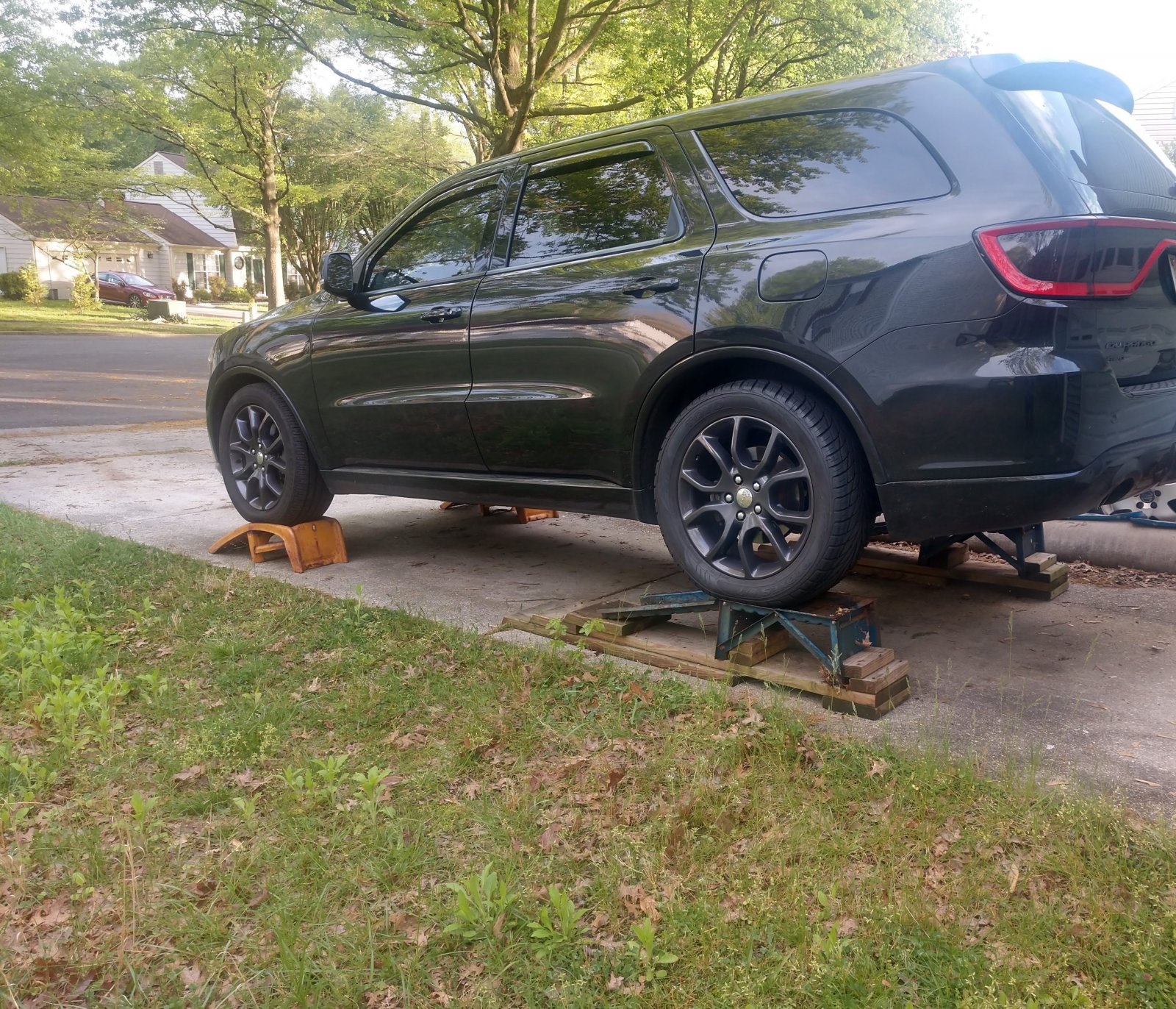

Oh yeah, the higher you can get it off the ground, the better. You want at least 2ft of clearance between the ground and undercarriage. Bare minimum. And even that will be a struggle. This was my setup when I dropped my Durango's cat back. Same ramps I used on the Tahoe, I just didn't take pictures this time around.
