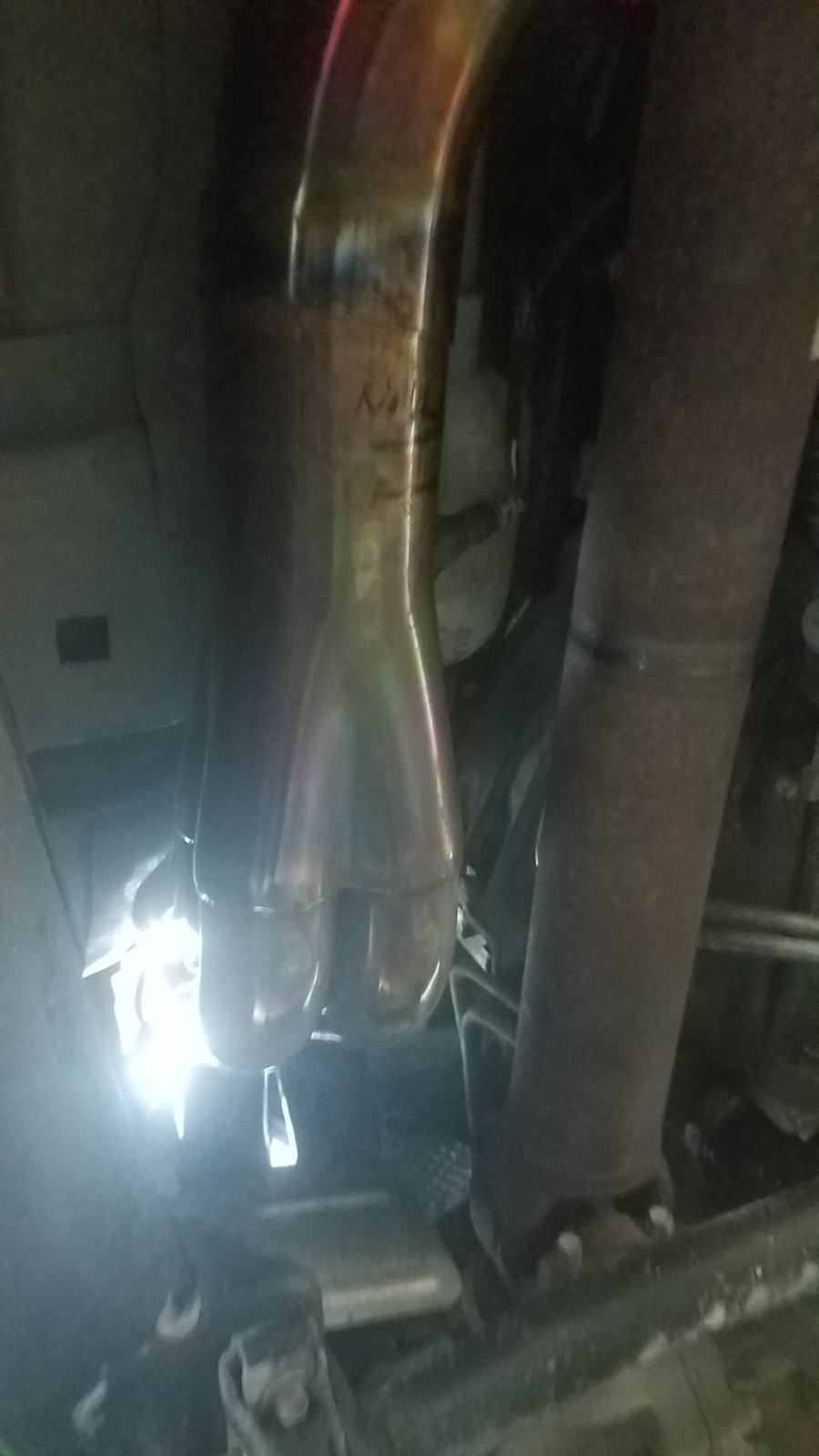

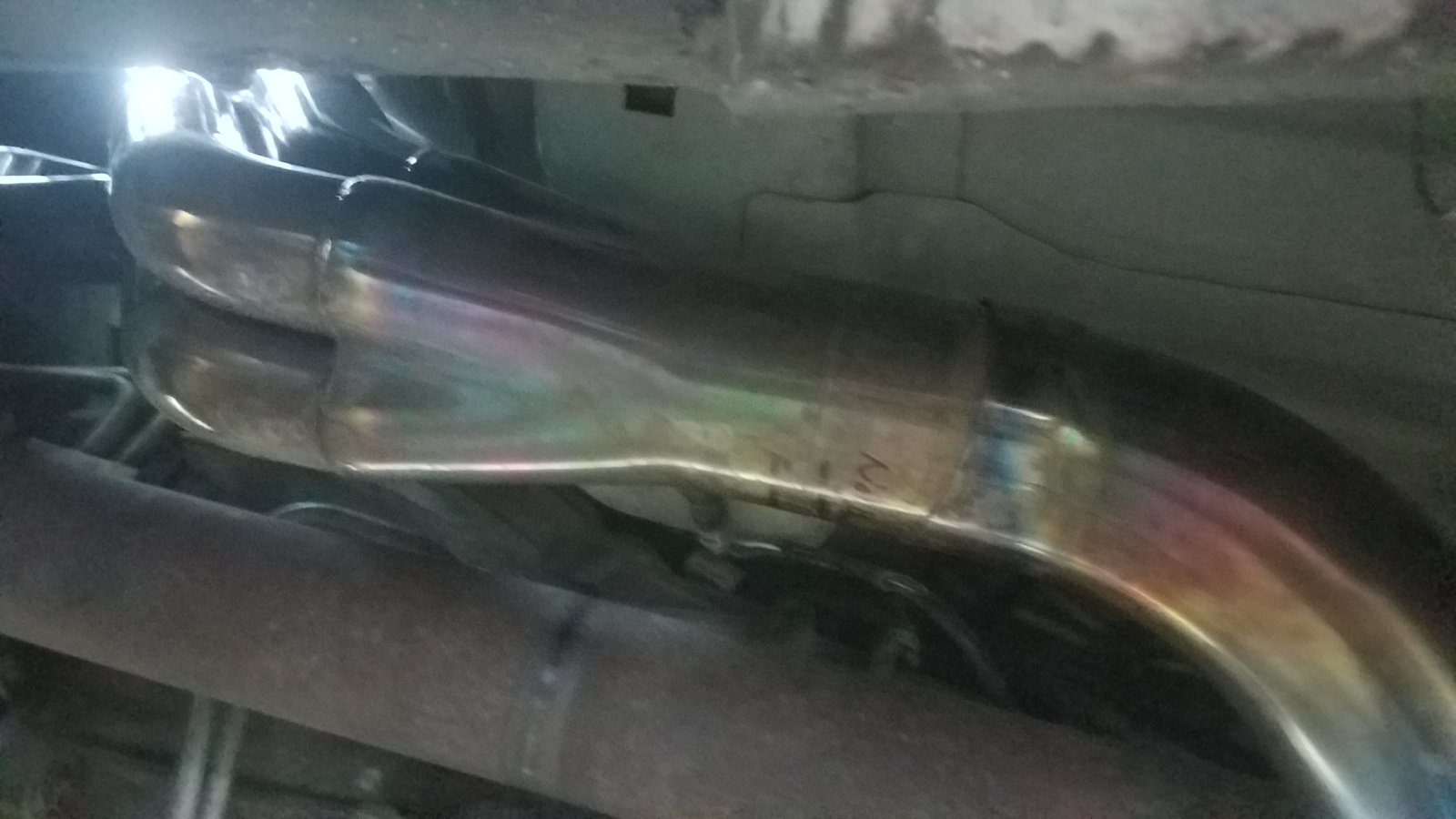

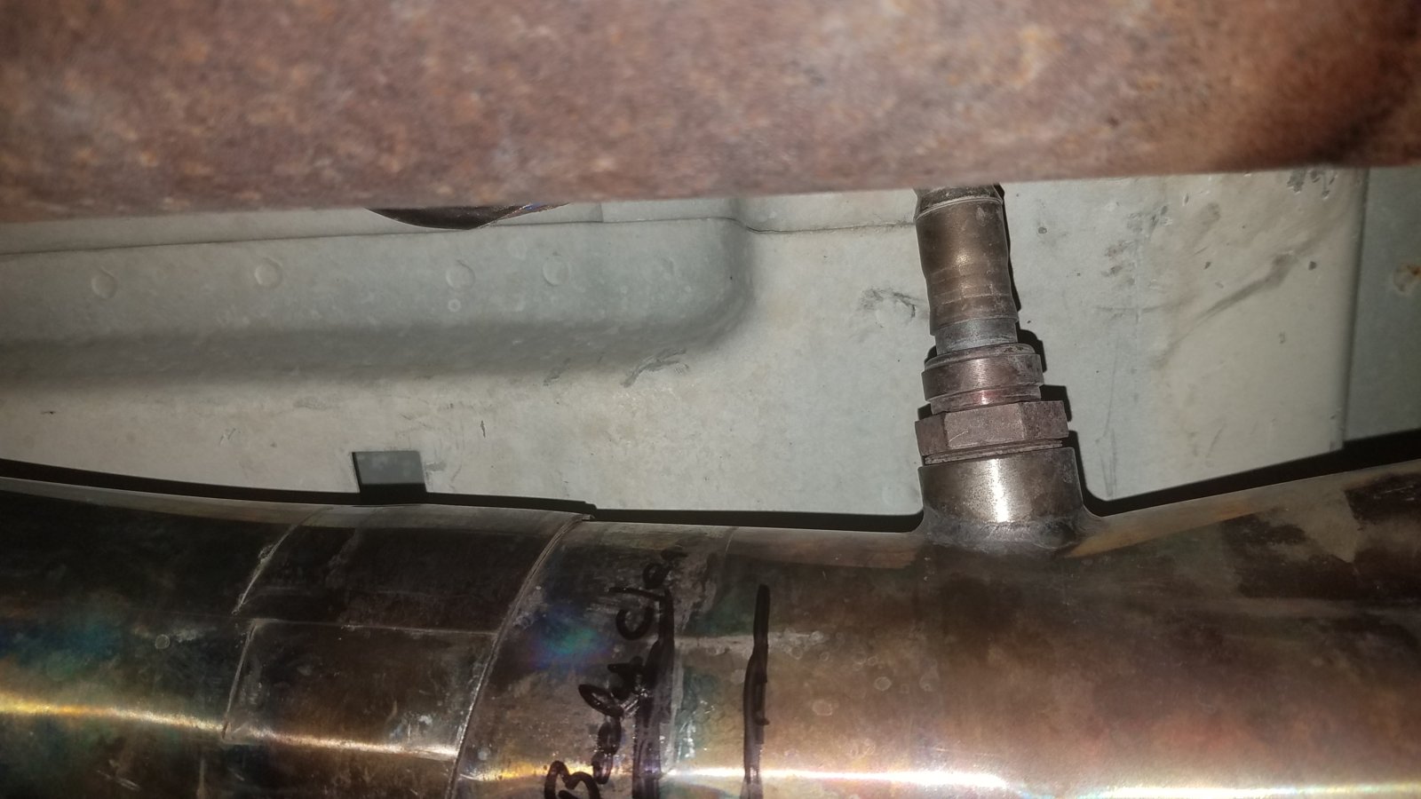

Collector on driverside is doesnt have much room on topside between cab floor and then goes right into a 90 under the transmission.
Even dropping the crossmember you still had to take that 90 off both ends to get the slip joints apart. Vbands ahould let me weld ypipe up as one peice getting rid of a few more joints that cant leak

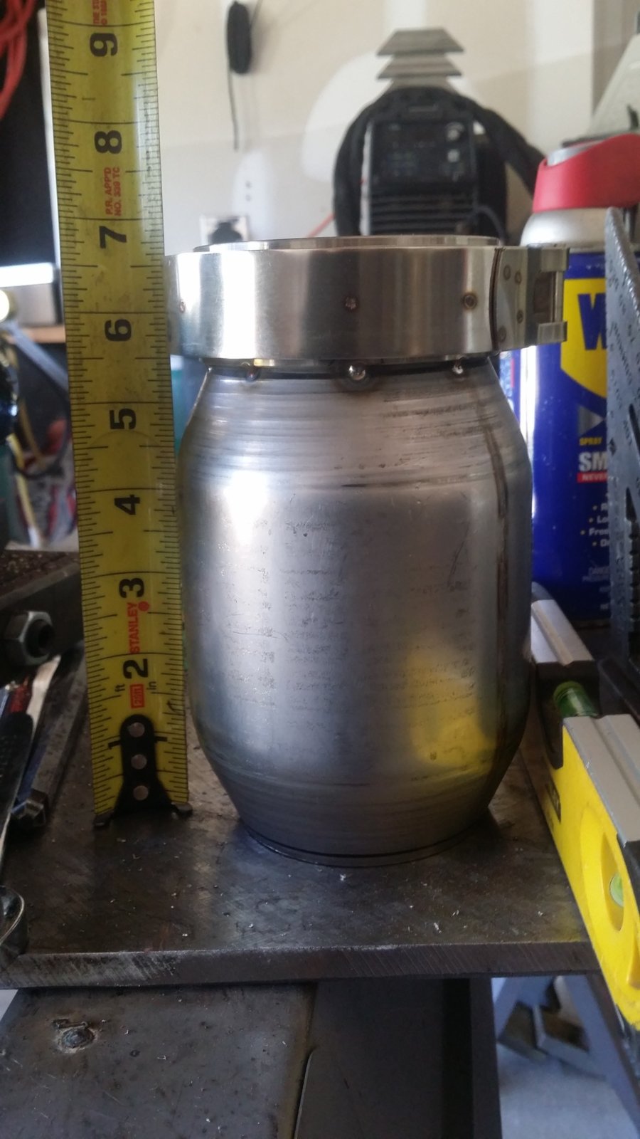

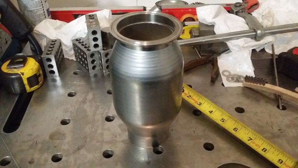

I'll modify the header to accommodate the cat. I had to modify the cat for such small quarters, haha. Its only about 5.5" long. I have a picture of it somewhere. It started as a 2.5" in/out cat that I cut down to 3" in/out. Made it dramatically smaller, haha. I turned it down a little more after this picture was taken.

Yes, speed eng is slip fit. I have the 1-7/8 they also make 1-3/4 that may have better clearance. Driverside my guy is cutting the collector back to about the o2 sensor bung for the vband to fit. Ill take some better pics when i get headers back from him as i put them back on.
Passenger side has plenty of room for a cat before the ypipe merges

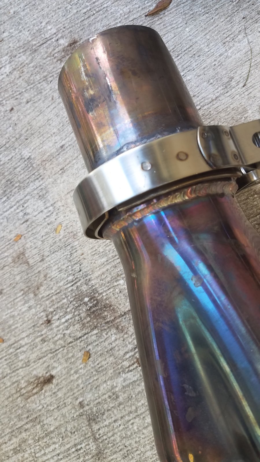

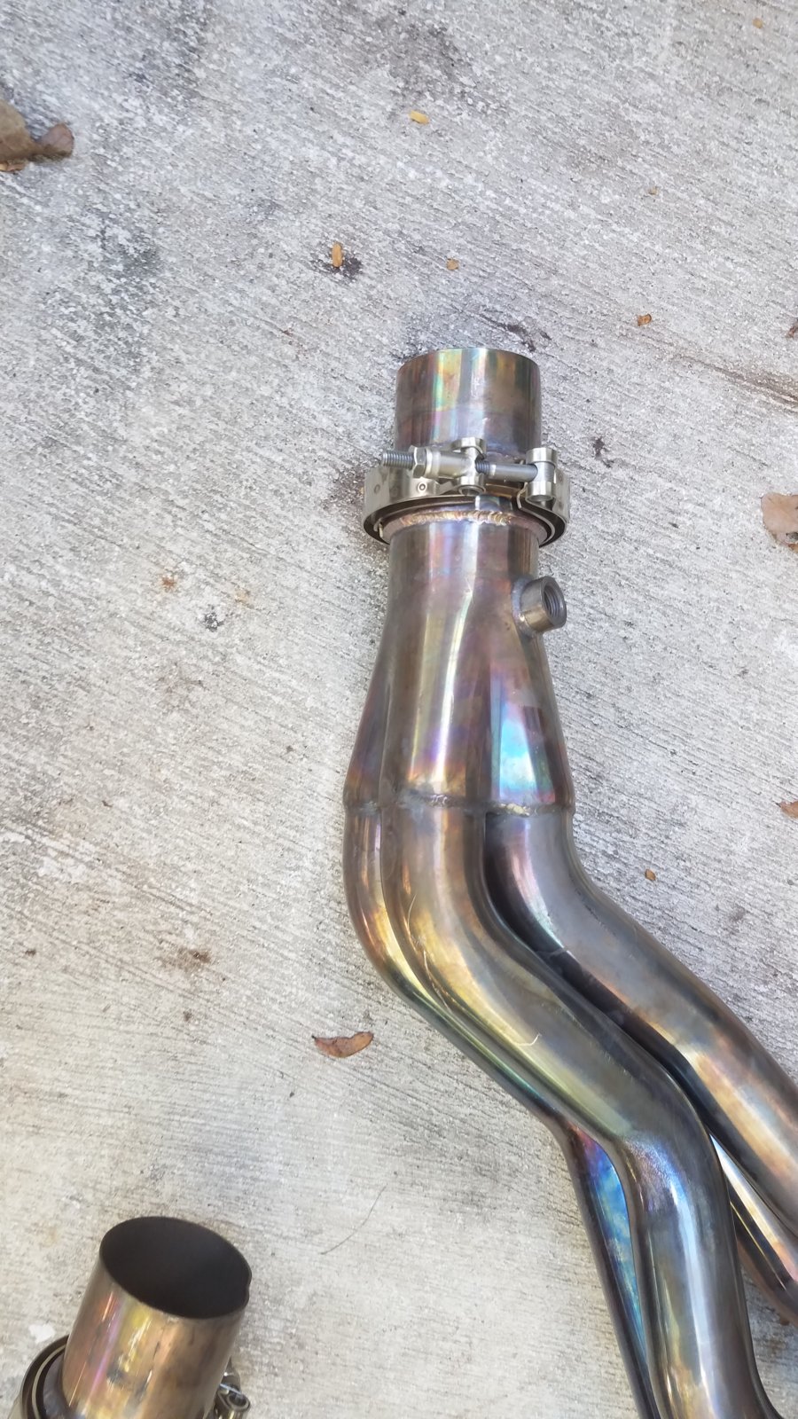

Vband to collector done....wont have time to do ypipe, but i got it all mocked up and i should be able to pull it out without taking out the trans crossmember
Driverside wasn't close enough to o2 bung, had to trim and flatten out body under there
