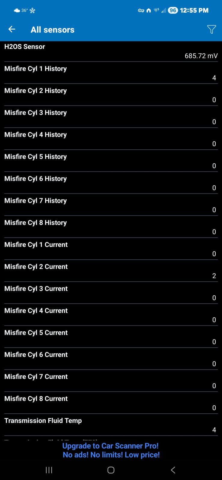

I ran all the diagnostics and I have some info to report.
1. I checked codes with ACC on and ENGINE OFF. There were no codes.
2. I checked for loose spark plug cables. Nothing was loose; everything was connected perfectly.
3. I proceeded to check for an exhaust leak. There are no obvious signs anywhere of an exhaust leak. No broken bolts, no soot, no marks, no sign of an issue with the headers.
4. I set my OBD scanner to view live data. I turned the vehicle on. I noticed immediately misfires on a few cylinders: 3, 4, 5. Then they went away and it went to zero. There was no tapping noise. Slowly, I started to hear slight screeching and then the tapping began slightly. Looking at the live data, there are misfires all over the place on all cylinders, but RANDOMLY, and they are very small. 1, 2, but not constant. Tapping noise and screeching are still there. Sometimes, they all go to 0 and stay there, then small misfires. Screeching and tapping still there, but screeching eventually goes away and just tapping.
5. Still no codes set. No check engine light.
6. I shut it off and disconnected.
Still sound like early stage lifter failure?
Here's a video.
And here's a screenshot of the random misfires.

Check wire connections to coils too. Listen to this vid.
Also you can drain a quart of oil and add a quart of AFT. ATF can provide a cleaning function. See if that changes the noise. It won't fix a broken lifter
but the detergent in ATF can unstick a stuck roller. And it should change the noise a little if its a lifter. Does the noise get louder if you rev it up to like 3K?
Yep that was one of the videos I watched. Checked the coils, no problems.
ATF? I read about that before, but I'm leery of doing that, I just changed the oil yesterday.
The noise doesn't get louder as I rev it, it just speeds up with the engine speed.

Another update: wasn't able to get the valve covers off; I know that's the most definitive test, but I did gather more info:
Ok, so I've confirmed. The screeching had nothing to do with the issue at hand. It is something accessory related. The screeching disappears when running the engine without the belt.
That being said, I removed the belt and checked for misfires. With the belt removed, I get misfires on cylinder 4 and 5. My scanner says "Misfire Cyl 4 Current: 2" and "Misfire Cyl 5 Current: 2". With the serpentine belt and intake all connected up, the misfires are all over the place.
