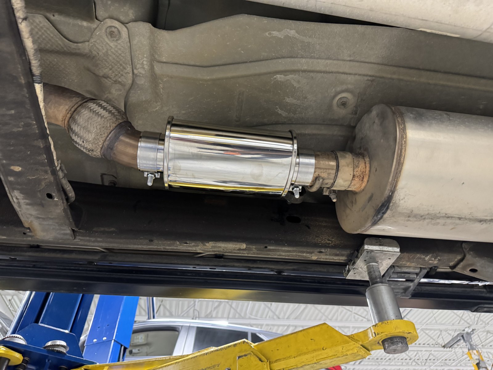

Yes, the muffler is clamp in. I was hoping that would allow me to do something without welding. I looked under my 08 when I was driving it the other day and there is zero room to put a resonator. I forgot to look at the 13 yesterday, but it is a LWB, so maybe there would be room between the differential and the bumper, but I bet not. Corsa sells a resonator that claims to reduce volume by 6-8 db, but it is 16.25” long. The LWB might have room before the muffler but I don’t know if that will do anything.
You're probably right in that the only place in your '13 LWB Escalade where there was enough "straight section" of pipe in the exhaust would be before the muffler. I do not have a definite answer on if placing a resonator before the muffler would do anything. That being said I would think the answer is that it would for a couple reasons.
1. Even if the resonator is placed before the muffler it should still have an impact on reducing the exhaust sound level before entering the main CORSA muffler AND still before exiting the exhaust tip. In theory I would think the resonator would reduce the noise level the same whether it was before or after the muffler as long as it's in-line in the exhaust system prior to the sound exiting the exhaust tip.
2. All of the Gen2 ('09-'14) CTS-V sedan guys who add resonators to their exhaust systems do it in the straight X-Pipe section before the rear axel which is before the mufflers at the end of the exhaust system cause that's the easiest location to put them due to clearance/fitment and length of straight pipe, and they noticeably reduce the exhaust sound when placed there before the mufflers in the exhaust system.
I would try placing one of these before the CORSA muffler in your system: https://vibrantperformance.com/ultra-quiet-resonators-v1249/
That model is 3" CI/CO and the whole thing is only 13.75" long, but it would require you to cut up your CORSA exhaust system to add it.

Corsa actually said it would be better to put it before the muffler but didn’t explain why. A coworker of mine said he has a used 3” Vibrant Ultra Quiet, so he’s going to bring it and we’ll see if it’ll fit. Corsa told me the pipe in front of the muffler is still in production, so I can replace it if needed.

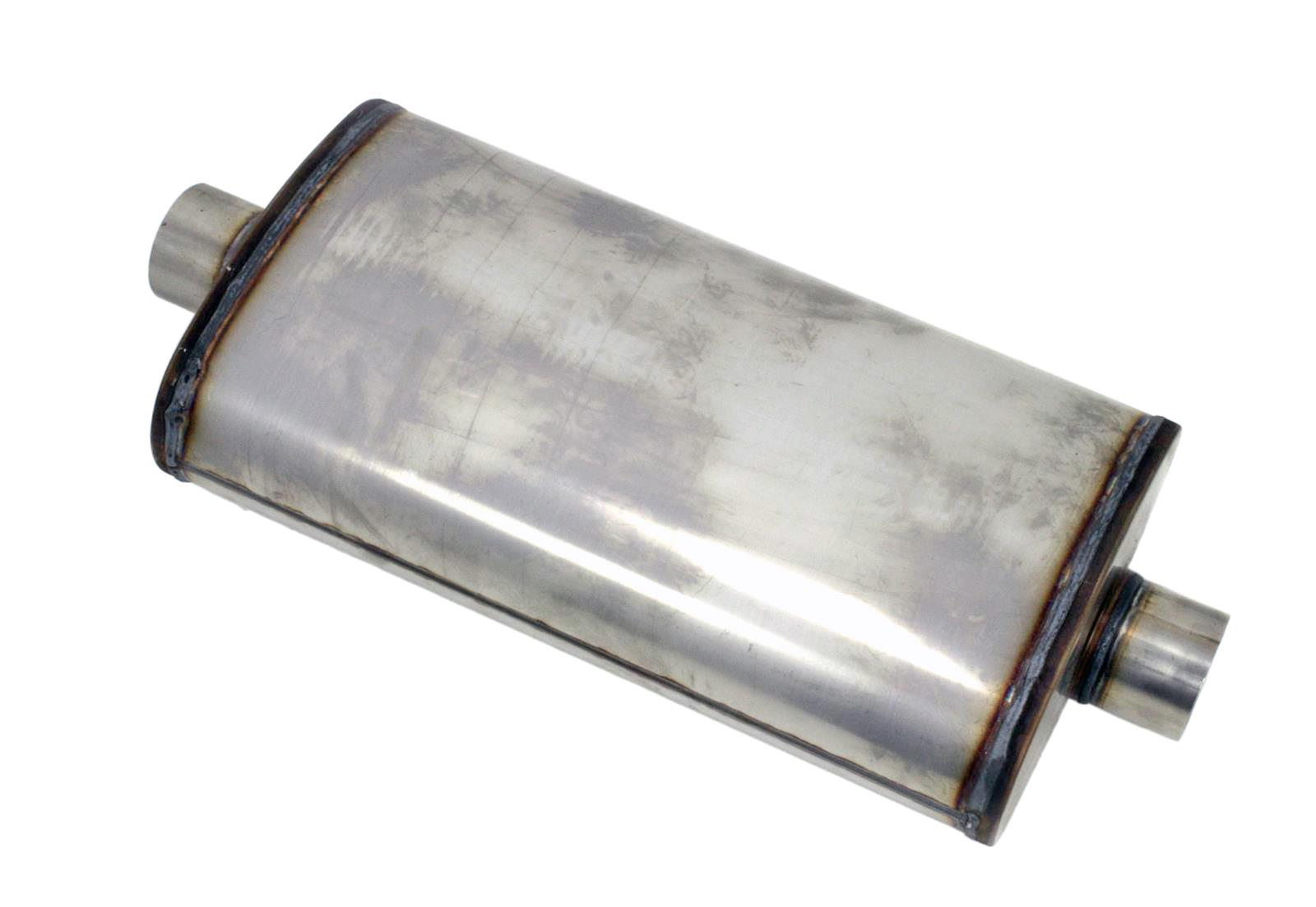

JBA muffler, I have run two of there catbacks on Rams which drone bad without the stock muffler. Only muffler that is no drone, 304 stainless 3" in and out center but still has a nice tone to it. Inside it takes the 3" and splits it into two (surrounded by sound absorption) and then brings it back to 3" to go out.

I’ll look into those. I’d still like my 08 a little quieter also but that isn’t a huge priority. I ordered the Vibrant Ultra Quiet since I think I can squeeze it in front of the muffler on the LWB.

I installed the Vibrant Ultra Quiet Resonator this morning and went back to my original Corsa Sport muffler and it reduced the volume at hot idle from ~81db to ~74db. Pretty much every bit of rasp is gone, which kind of stinks since I do like the raspy sound, but you probably can't have it quiet and raspy. I do think it sounds pretty similar to the way my 08 sounded with the Touring muffler on it, if I remember correctly (it was probably 3 years ago). I actually think the smaller Corsa resonator that claimed a 2-3db reduction probably would have been fine, but I didn't want it obnoxious and that's exactly what I got, so I'm happy. I wish there was room for the small Corsa resonator on my 08, but I don't think there is. The Vibrant Ultra Quiet barely fit on the LWB.
