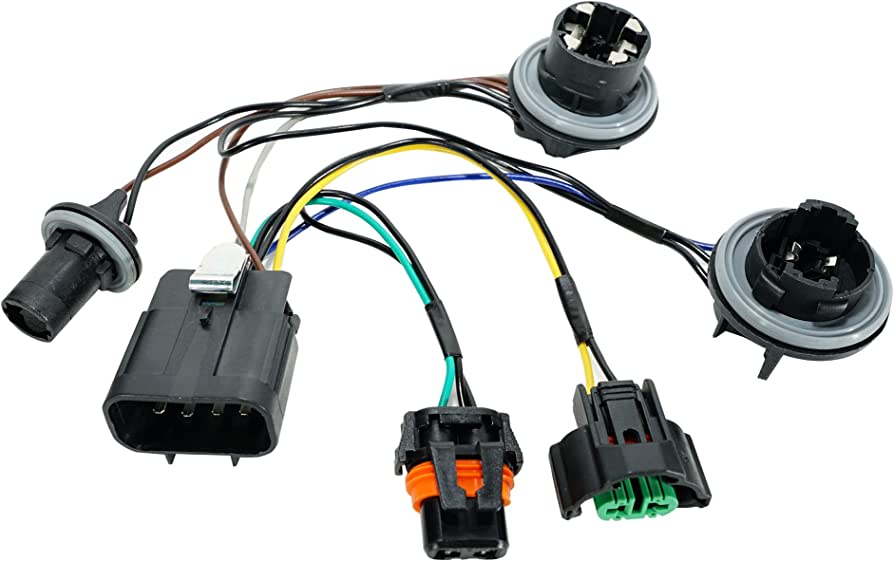

I also did the confused puppy dog look. lol Until I looked up the harness. It looks as if multiple items take the power and ground on the same circuit. So it maybe possible ? I attached the harness photo. 2005 tahoe.jpg
30,763
48,455
I also did the confused puppy dog look. lol Until I looked up the harness. It looks as if multiple items take the power and ground on the same circuit. So it maybe possible ? I attached the harness photo. View attachment 393240
pretty sure that pictured harness is for a 07-14
