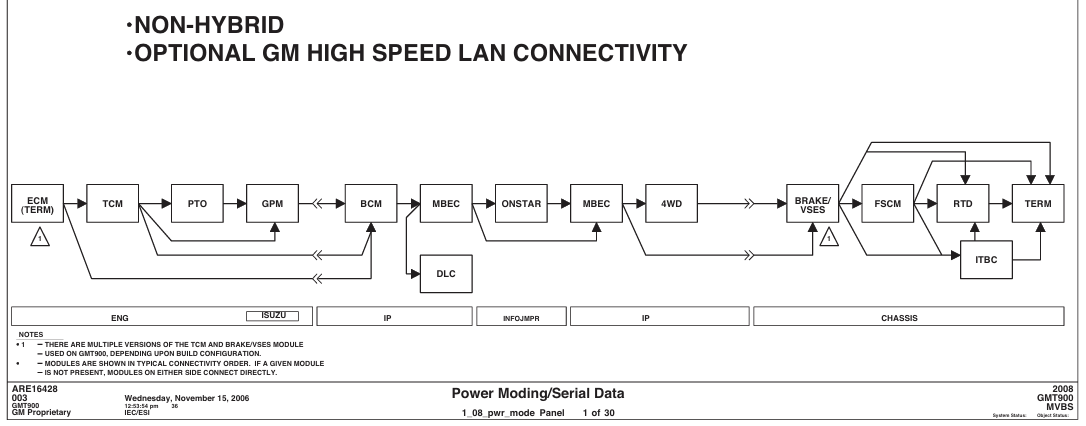

I'm guessing a bad module that freaks out and makes noise when it feels like it..
May take some time, being as intermittent as it has been.
Since you say the TCM is reporting the error, I wonder if it has anything to do with the connection order..
Looking at this chart, the ECM and BCM are next to the TCM.. I think..
I'm going to say BCM just because the ECM's are known to be pretty solid.. (wild guess, don't take me seriously)

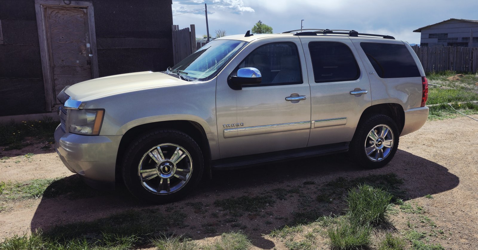

What drives me insane is that we love this thing so much and it's in no way worth giving up on. It's getting up there in mileage because we use it for business purposes, but it's fairly clean and we've taken good care of it. (It came to us with that little dent in front of the driver door, but otherwise there's barely a scratch on it. Interior and engine bay are still really clean too and the thing runs GREAT outside of this issue. Have barely had any issues.)

More specifically, the VCIM or OnStar Modue. As with most of the other modules we've been suspecting, it's on the high speed lines...so when/if it goes, everything goes.

Removing a module may be a solution, but if the network goes through the module you'll lose comm with any other modules that are downstream. It depends on how the network is wired.
mikez71
Mar 9, 2023
3,334
4,137
Yep, the onstar is one of those modules.
If removing, you must jumper the network cables. (tan = tan, tan/blk = tan/blk)
