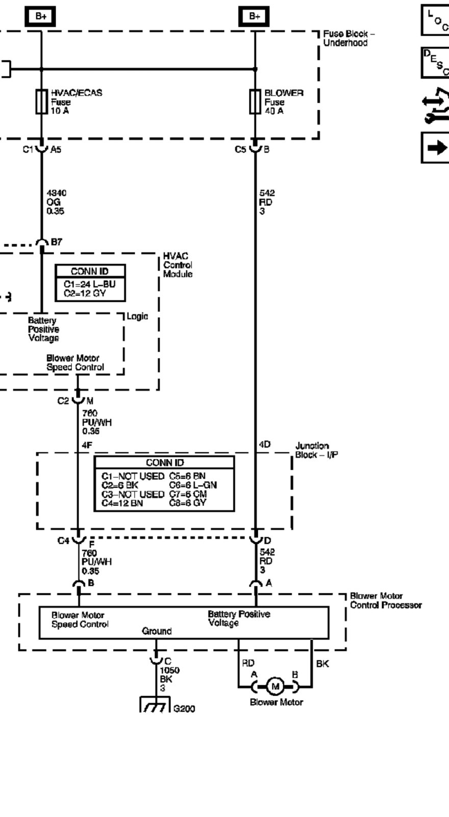

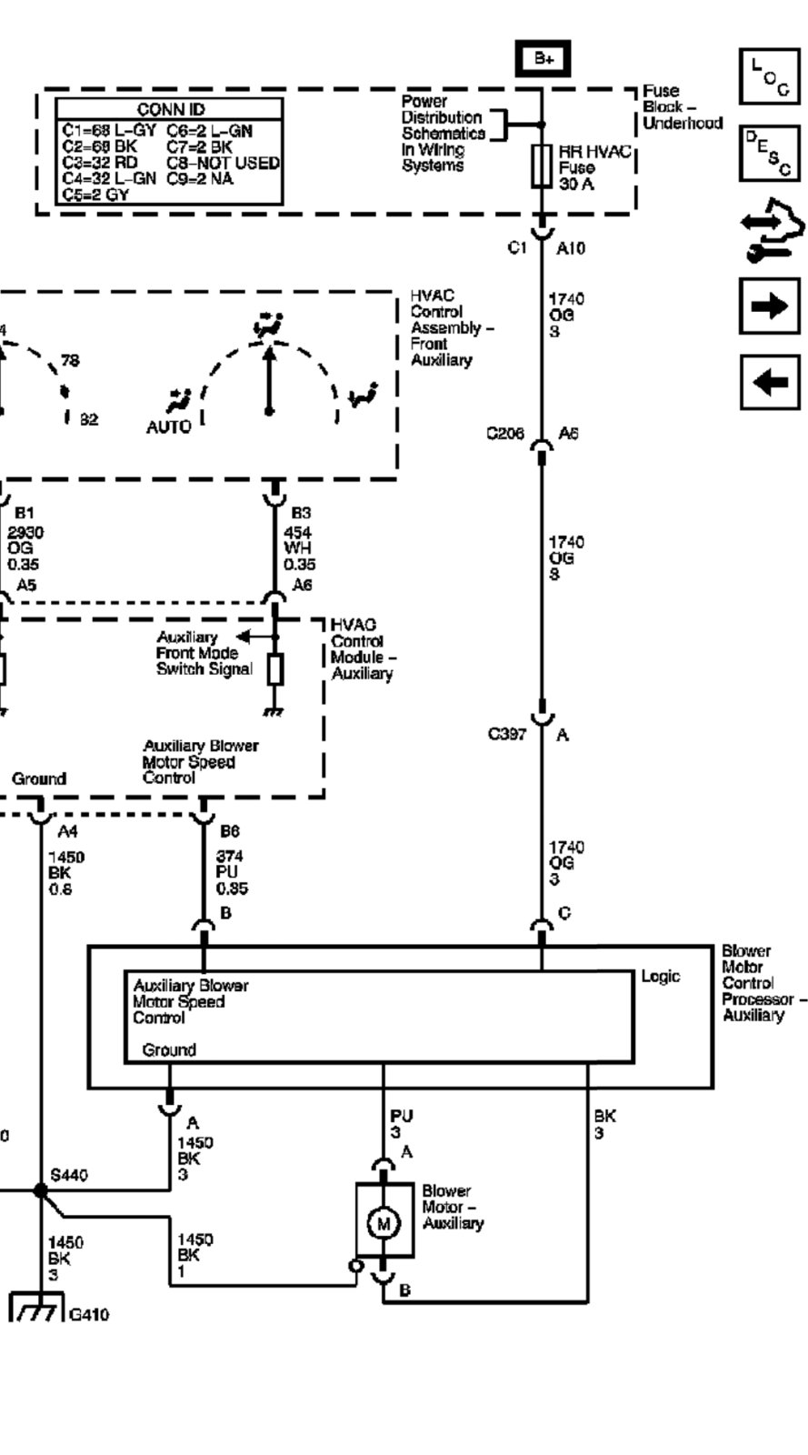

Here are a pair of diagrams. one has the 12 volt battery power at terminal A and the other has it at terminal C.
So on the oe resistor it shows 12v hot at pin c. The new ones don't have a diagram on them
However for ***** and gets I just swapped the pins a and c and have the same issue, once I plug it in the blower comes right on.
