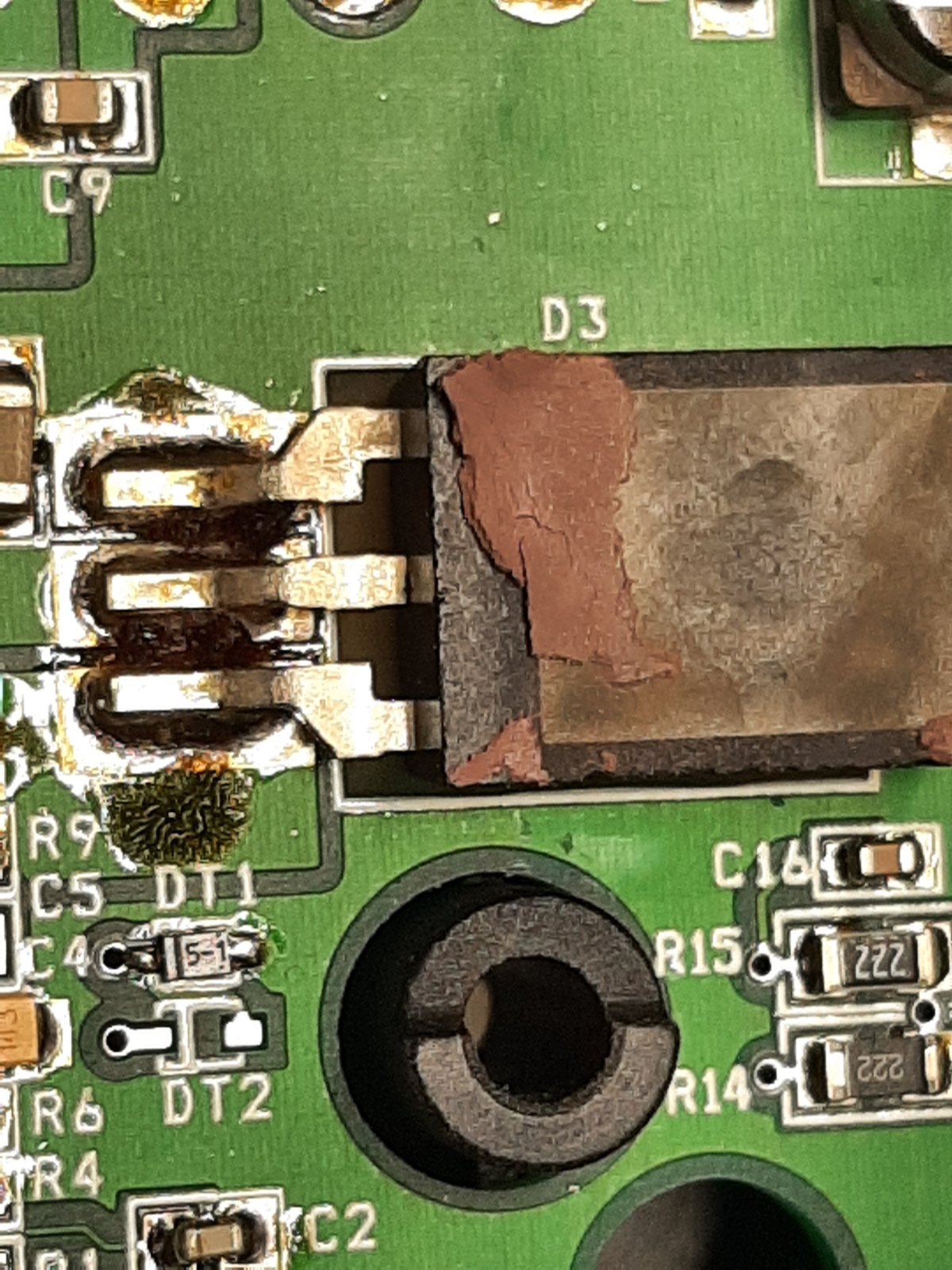

This sounds like you have the automatic control system that uses a solid state blower speed control.module. This is not truly a resistor at all even though it is frequently called that.
This is key in understanding what to look for in testing. As I understand it, the speed control works like this: 12 volt positive is supplied at the orange wire at all times. Ground is applied at the black wire. The interesting one is the purple wire. This is a Pulse Width Modulated ground signal from the HVAC control. If this wire gets inadvertently grounded the blower will run full speed all the time.
Since you already tried several new blower speed modules perhaps it is time to check the purple wire between the HVAC control and the speed control for a short to ground.
On my own 2005 Yukon it was easy to see the issue as the blower speed module had failed and a new unit fixed the issue.

Mine was quite clearly toasted...

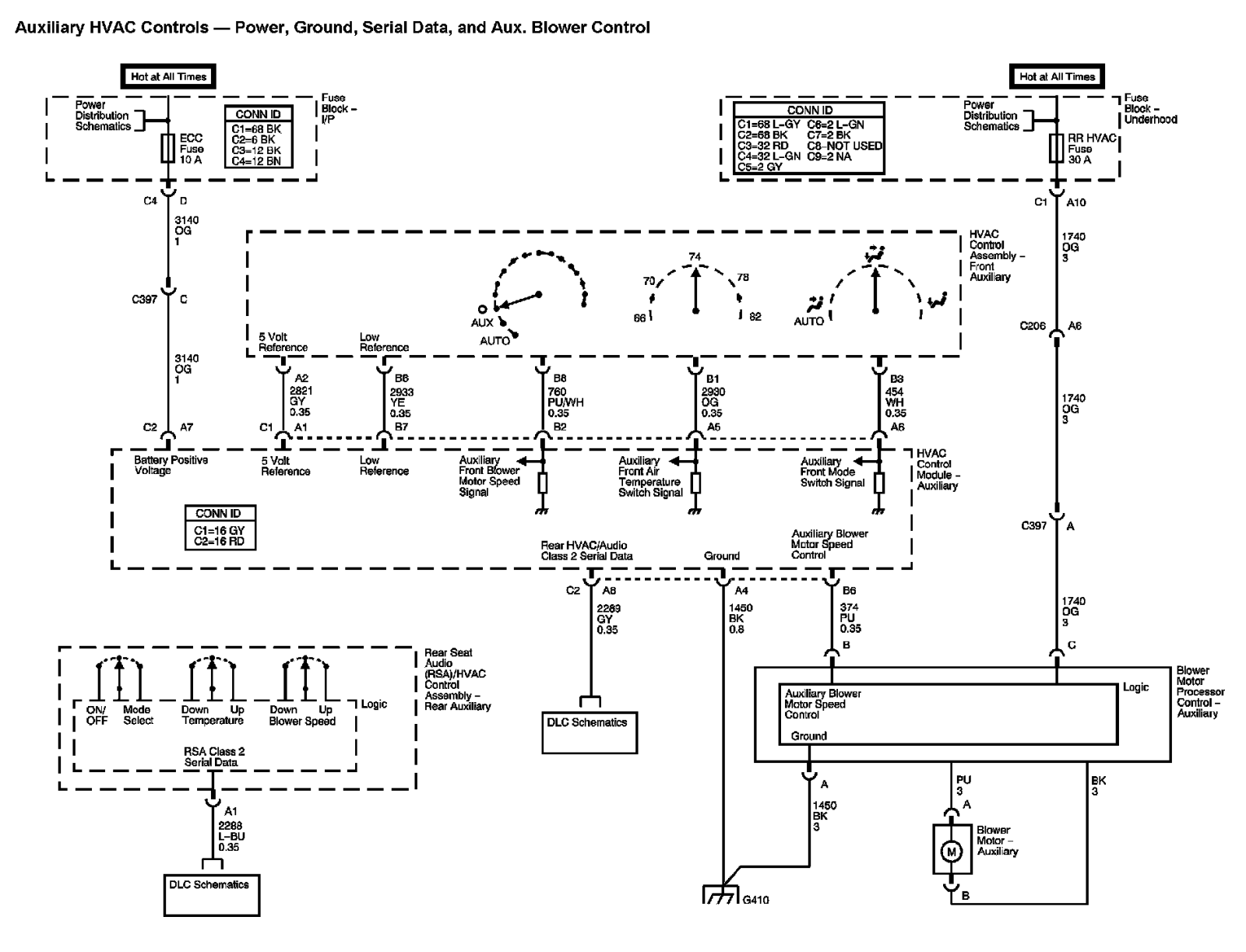

Weird! Here's a diagram for the rear blower from charm.li
It looks like that purple wire goes to the HVAC control.. And it looks like that's the primary method for controlling rear blower...
Is the blower running full speed?
Blower runs full speed.

Wiring diagrams can be found at www.charm.li.
Confirm that it has the AUTO (with digital temp setting on front control) or Manual HVAC system?
Manual diagrams:
