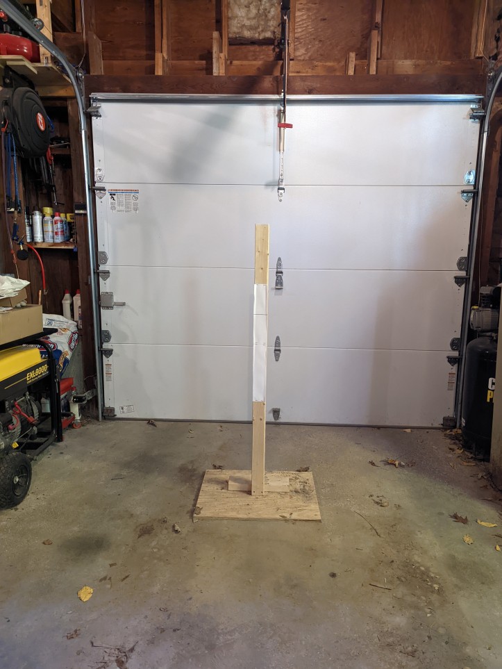

For my 07 Yukon XL Denali, the manual says to adjust the headlight beam's vertical adjustment so that the top of the beam at 25 feet away is the same height as the bulb itself in the headlight assembly. So, I aim for the top of the headlight beam to match the line drawn on my home made measuring tool. I use a section of lightly travelled road that is level to do my adjustments.

Same here. I also crank the P side out towards the side of the road just a bit. Always did the final on a back road in the dark.
