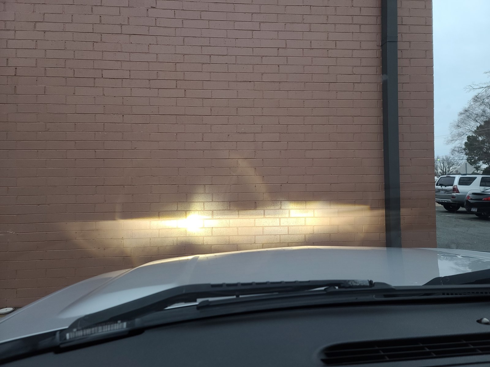

High beam
As you can see, the low beam has a great pattern while the high beam is absolutely terrible. Useless. I consulted with AlphaRex, and agreed this high pattern was not good. The inquired about what LED I had installed, and weren't familiar with what I was using. I asked multiple times what they recommended, but they would not give me a recommendation. After rephrasing the question, I asked them what they TESTED with, to which they told me Headlight Evolution S-V.4, which is a $170 pair of LED's. Gulp.

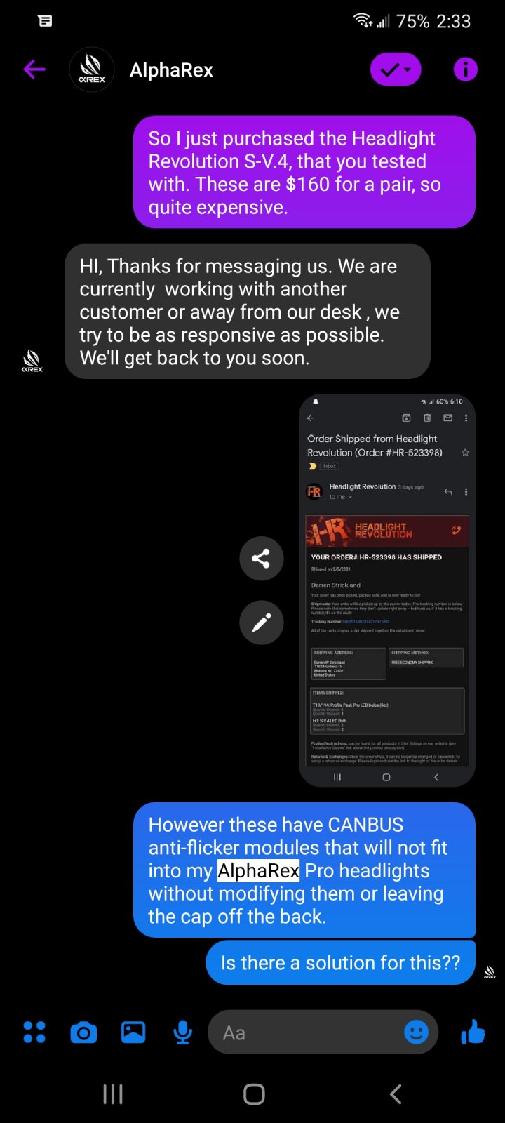

Frustrated, but I purchased a pair of S-V.4's. They came in a few days later, and I removed my right headlight assembly. My idea was, if these LED's are so much better than my "cheap" $50 pair from Amazon, then I am going to test them out by installing them both in one headlight (high and low beam). If they packed a whole new punch, I'd buy a 2nd pair. I got the Amazon LED's out, and took one of the Headlight Evolution LED's out of its box. To my dismay, there was a fairly large driver on a pigtail with their LED, it cannot be bypassed. I gave it an effort anyways, but knew there was very little clearance between the back of the projector and the headlight housing. After paying nearly $400 for these headlights assemblies and $170 for the LED's, I wasn't about to modify anything.
Showing the size of the driver and lack of needed clearance:
I packed that S-V.4 back up, having not even plugged it up to try out, and sent them back to the vendor since they wouldn't work for me. At this point I was a bit more frustrated, as AlphaRex told me they had excellent results with that specific brand and model LED. I reached out to them by their recommended source, Facebook messenger. I still have yet to get a response back.
Thankfully Headlight Revolution is very receptive with communication. I explained to them what happened, they were very open for an exchange or a return. They even offered another version LED which had a smaller driver. I took some measurements and think it MIGHT fit but would be very close. Rather than take that chance again, I elected to get a refund. They authorized my return and I shipped it out last week. Great company to deal with!

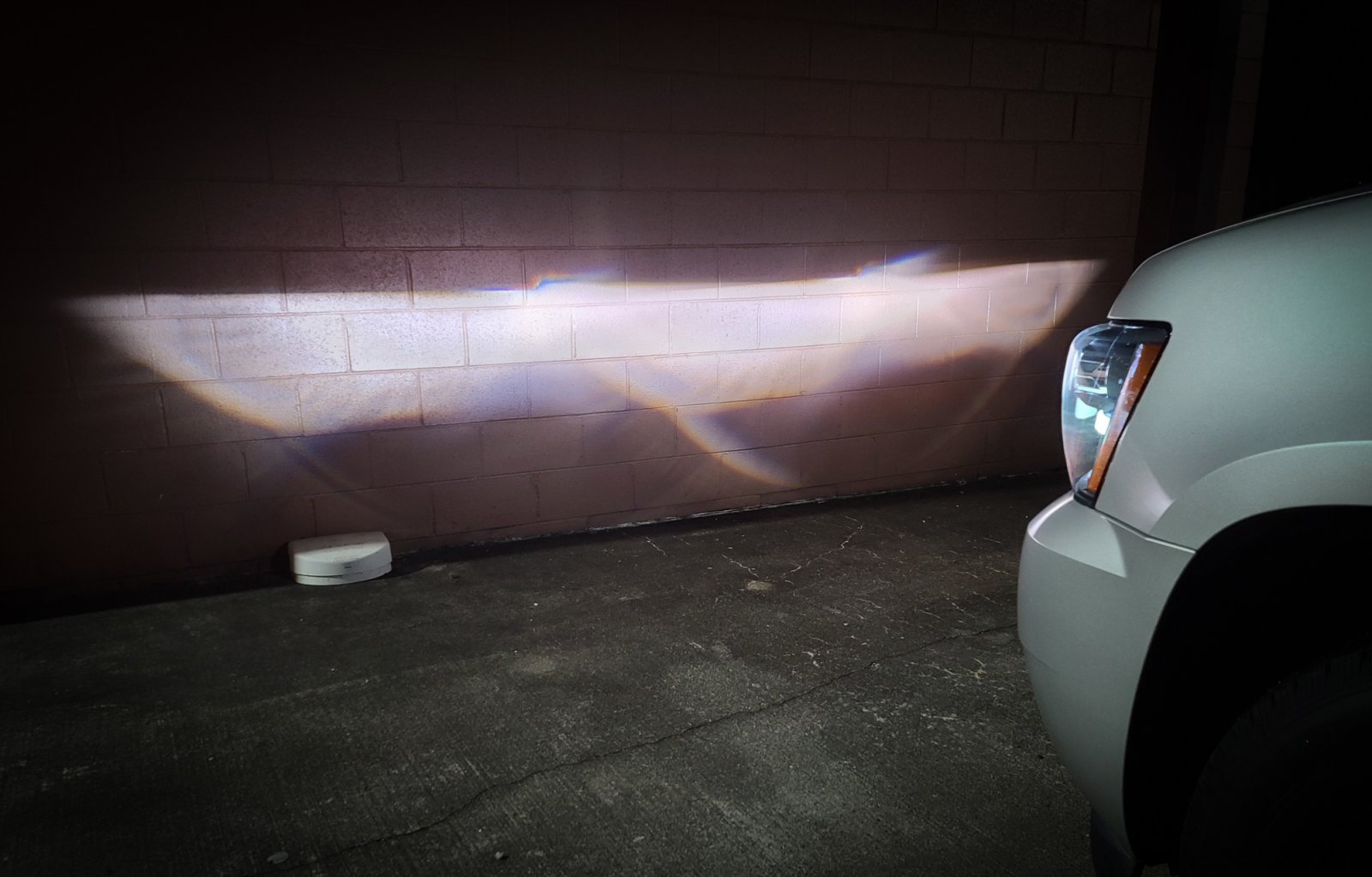

I threw my Amazon LED's back in. This time, I chose to invert the bulb. I installed both LED's with the wire pigtail on the top. It wasn't really dark out yet, but I tried them against the same wall for a comparison and saw a drastic improvement with the high beam. I actually swapped the drivers side around as well, but it still isn't showing a good pattern. I am going to rotate it slightly until I get a good beam, then I should be set.
I hope to find the time this week to pull the headlights out and get the drivers high beam adjusted again. I will report back when I find the sweet spot for that one.
