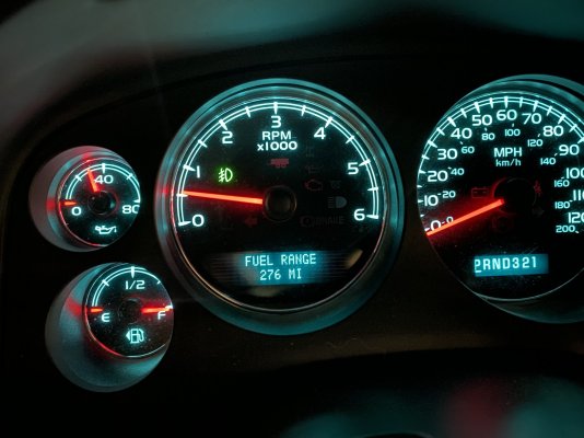

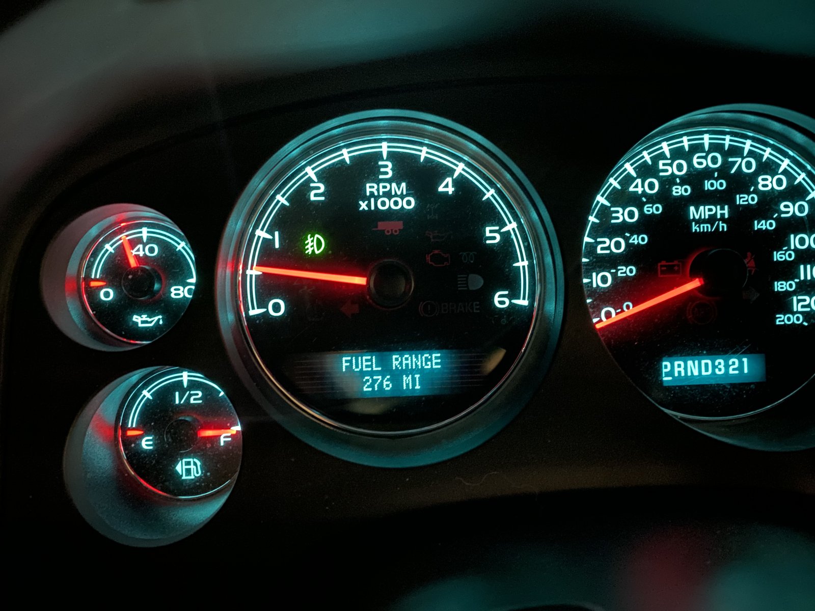

Adding to the many mileage posts. Full tank just topped off. A whopping 276 miles. I still haven’t gotten the transmission serviced and I’m thinking my likely failing torque converter is contributing. Still, she drinks what she drinks and so far I love her. (Will love her more when I finally pull the trigger on a supercharger. Then I’ll hate her while I shop for a new motor and trans. Then I’ll love her again until I do something else stupid. Like doing the SierraKon conversion. lol.)

These aren’t THAT bad on gas. They could be a Freightliner lol
But 276 miles seems low? Or does the 39 gal fuel tank I have just make the difference?

My 14 has a 33 gallon fuel tank.. So even just in town I can get about
330 miles per tank depending on climate etc
IDK how many gallons the OP's tank is... but that's crappy mileage IMO
no matter what

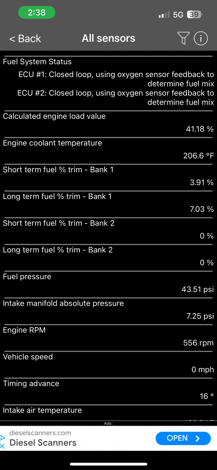

My 08 Escalade gets a whopping 6mpg right now. It has an exhaust leak at one manifold but I really don’t think it would make the mileage be THAT bad. Pretty aggravating to have to put $120+ in fuel in it a week when I only work 2 miles from home

Yaaa… something sounds like there is an issue somewhere. This type of range means the average mileage is low single digits (towing type mileage). Not sure but that’s just me and I’m more on this site to be the nagging random person that says a lot but of little value… maybe every 1000 words equate to a penny of knowledge?
the exhaust leak actually sucks in air and that makes the o2 sensor report lean, so it runs richer than it should. the easiest fix is a clamp you can bolt on to take its place. I use one on mine?
also being that short of a drive is ******* mileage, never gets a chance to really warm up and cruise. that said 6 is pretty bad, maybe check your alcohol content %? sometimes it drift high and makes it run rich on gas too.
^^The exhaust leak can adversely affect the trims. Short trips are also notoriously bad for gas mileage. Have you looked at short- and long-term fuel trims lately? Does it even go into closed loop on the trips to work?

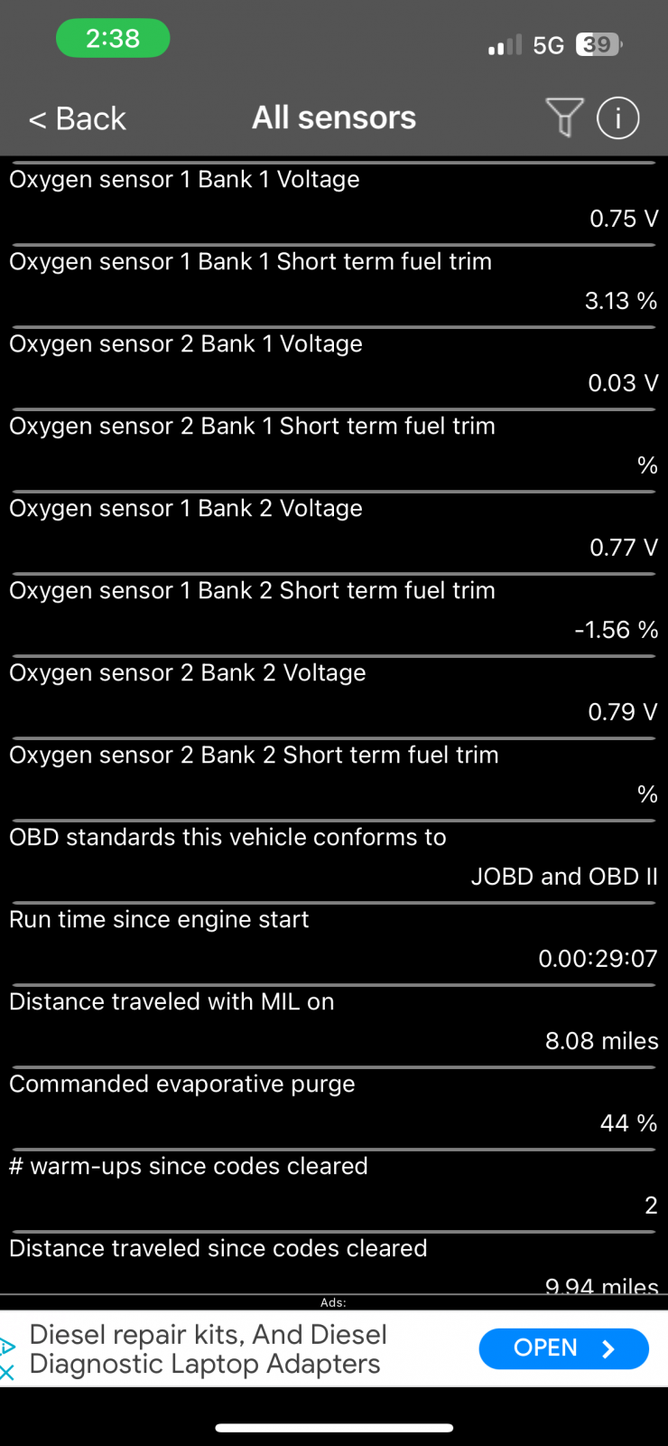

Not on my way to work but this was after driving around the city for a bit

you add the short term and long term together. so about 6% extra fuel being added on both sides. which isn't to bad.. under 5 is fine. but also it's at 44% purge, which is I believe is opening the Vapor cansier. they might be adding more fuel too. but I don't know that forsure.
keep an did on the short term and long term trims. if you see say 10% fuel, it's definitely running richer than it should

What was your average speed for the last tank of gas?
When my average speed is below 21 mph for a tank of gas the mpgs will be about 12-13 mpg. She'll be burning about 1.2 to 1.6 gallons per hour. She burns about 3/4 of a gallon per hour just idling with the AC on. It's even been in the 10s before on gasoline, probably lots of idling and local driving.
Poor quality fuel doesn't burn as efficiently either in these Gen IV engines. Mine gets E85 or top tier 93, never 87.

Mostly in town and short trips. 20-25 mph average max. I’ve yet to find e85 here (Tallahassee Fl. Probably here somewhere but I haven’t looked specifically for a station that carries it.) And I alternate 93 and 87. Running 93 right now. Just done replacing a lock and a window mech. Which has no bearing on this conversation, just sharing. lol. To be clear I still love this truck, was just lamenting relatively old school v8 problems. lol.
