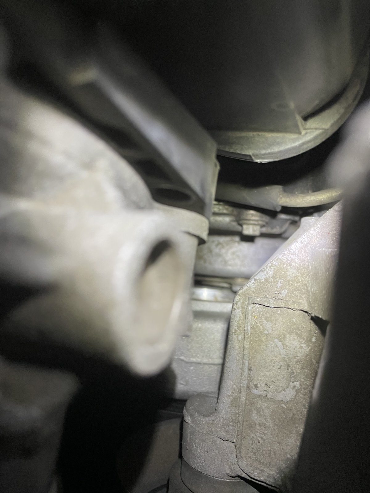

Thanks! That's great information. I am attaching a picture of my RPO sticker. Looks like I do have 3.08's. What exactly goes into this 14 bolt swap? I imagine that its bolt in as far as getting the rear end in. Will my factory brakes bolt right up?
Hey, you've got a unique truck there! Did you know that it is an XFE model? If you did not know, they were a lowered and lightened truck that in 2009 delivered 1 MPG more in the city and on the highway. This advantage went away in 2010 with the introduction of VVT on the engines, but yours has all those fuel saving features and might also have a 2010 VVT motor. If you see a connector on your engine's front cover, you have VVT. I considered getting my wife one but after driving a 6.2 that went out the window! What kind of mileage do you get with it?
The Saginaw 14-Bolt is a direct swap, everything bolts up. It can be most easily found in RWD Escalades and Denalis and they all come with 3.42 gears. Some say you need a conversion u-joint and we're waiting for a fella to respond to that query who has done the swap already. @RooTBeeRthe1st Just got his and will be doing the swap soon, with pictures I hope! Mine is buried on my work bench and probably wont' get to it until next winter.

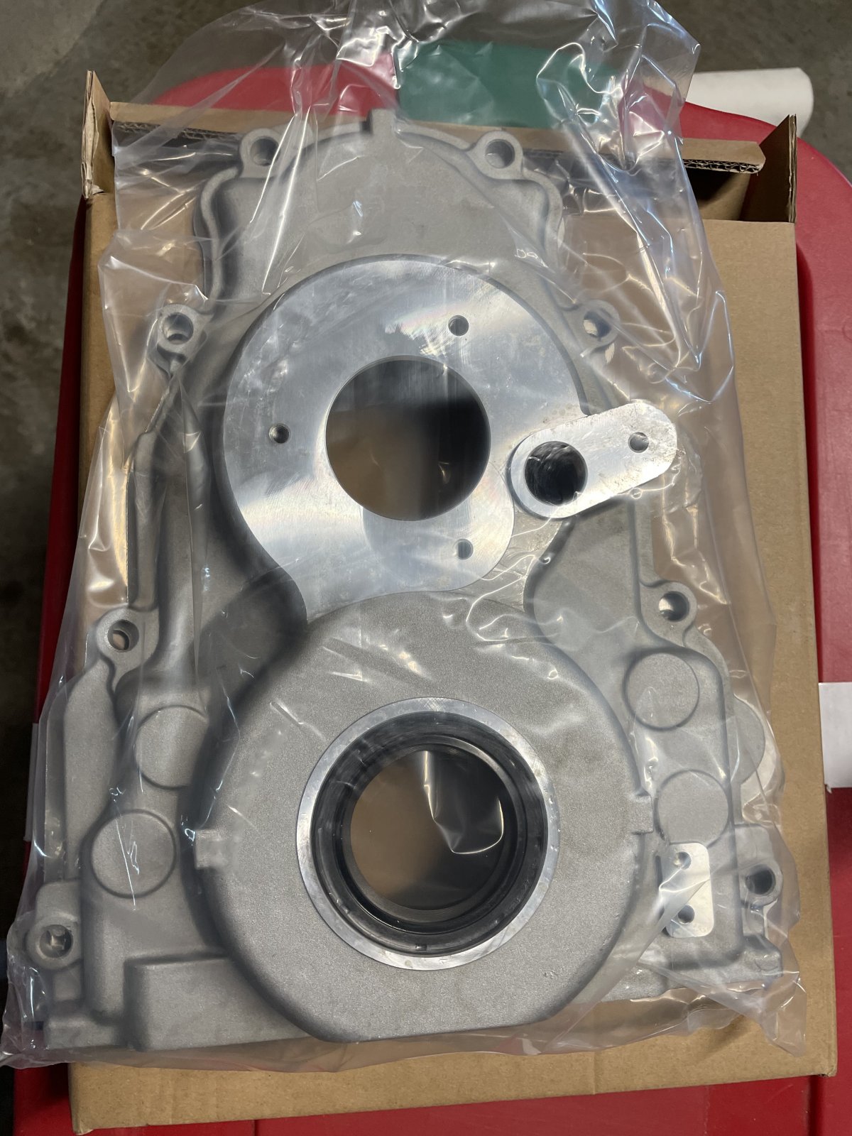

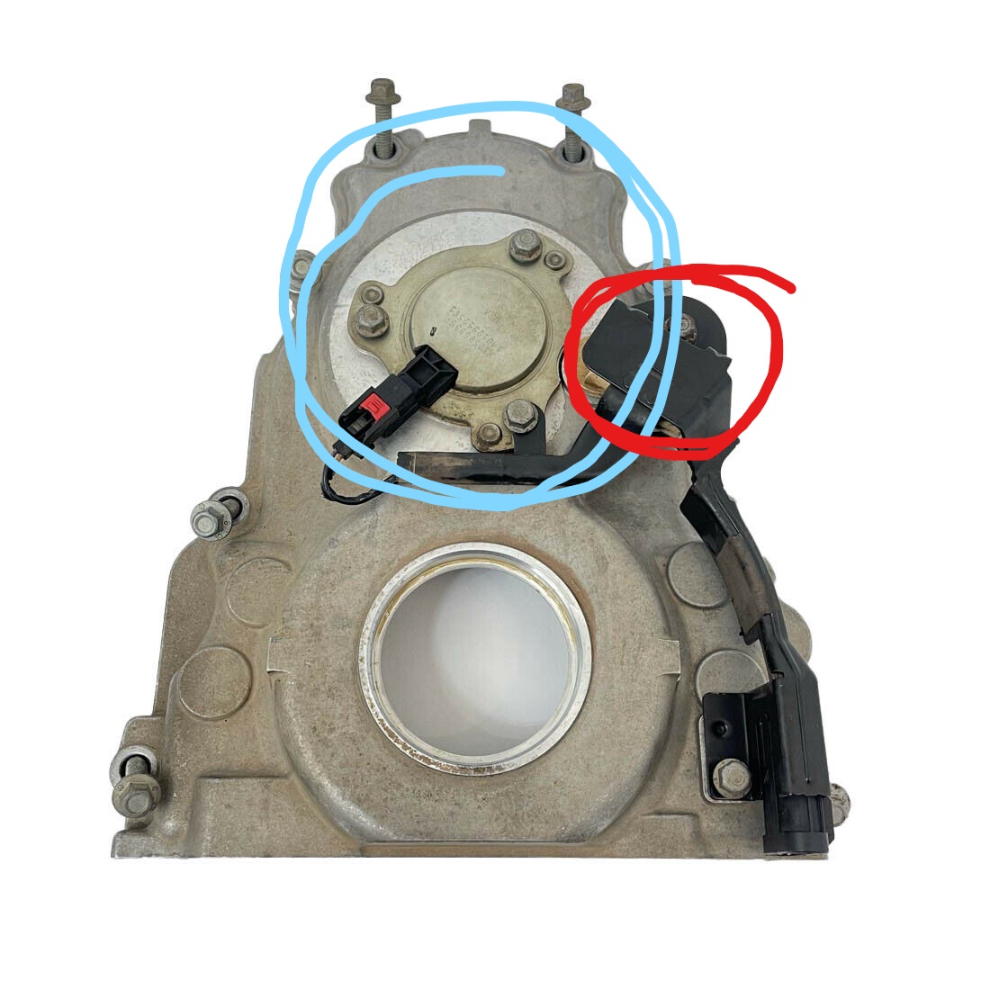

And so it begins...

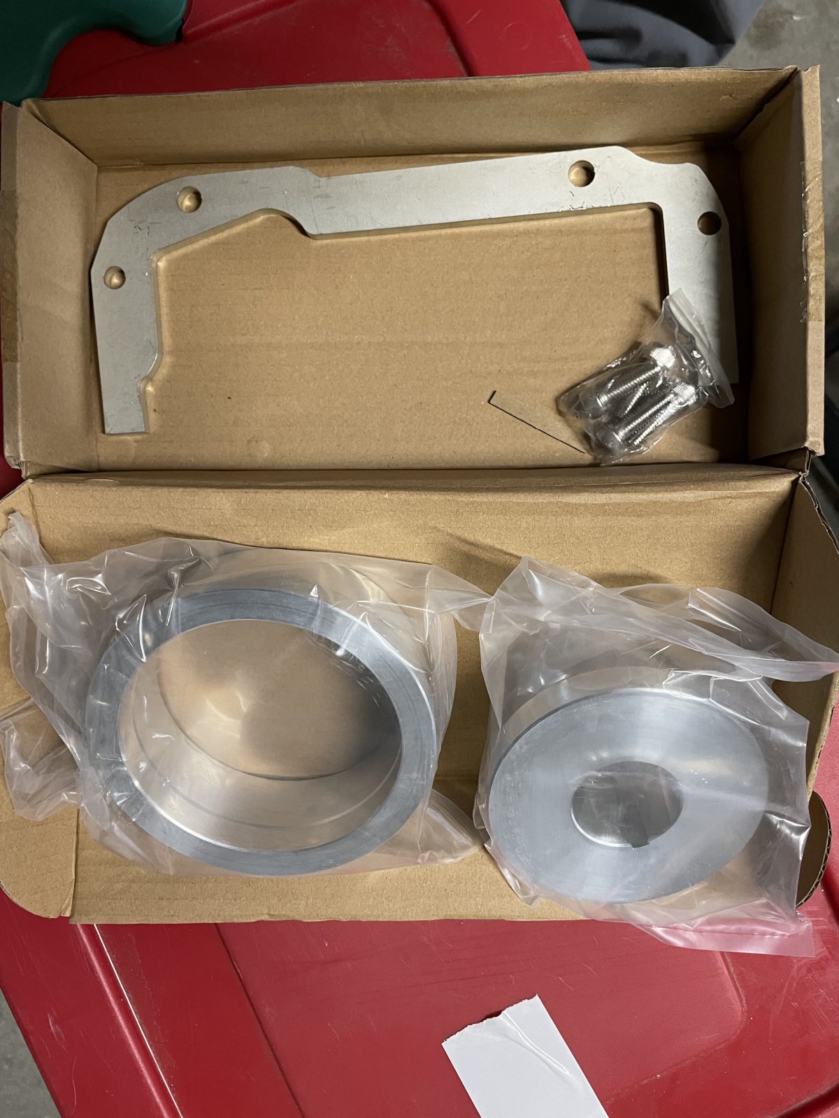

I got my first parts for this project in the mail today. My VVT timing chain cover came from Summit. I'm not sure what the promotion was exactly, but I also got a pack of shop rags for free with my order. These will come in nice and handy.
I also received today my timing chain cover alignment tool.

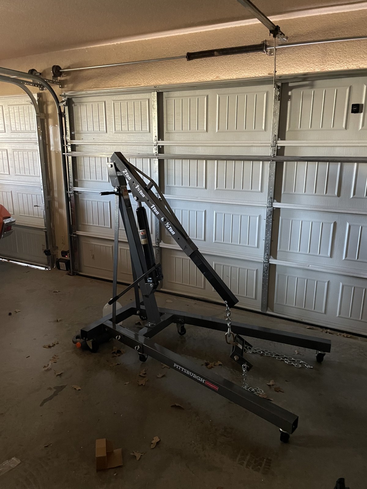

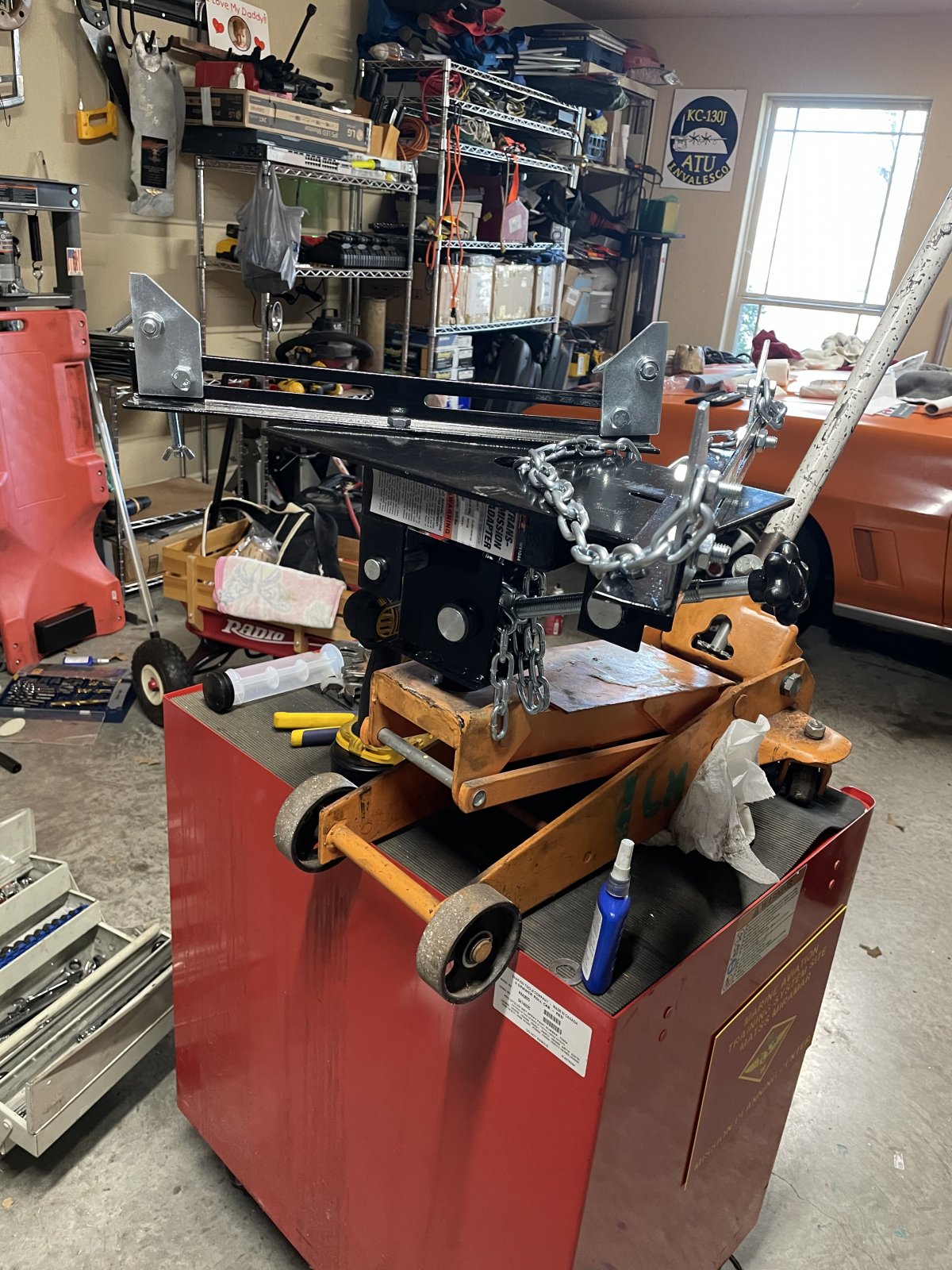

Lastly, here are my hoist that I just bought, and also the jack that I converted to a transmission jack. Anyone see any issues with using either of these tools for this project?

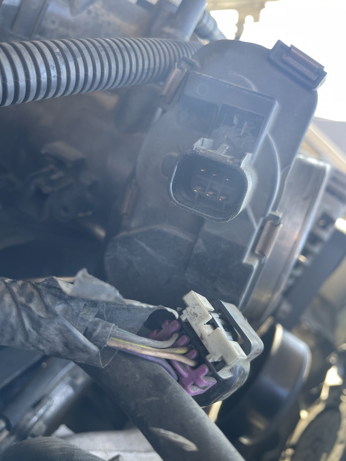

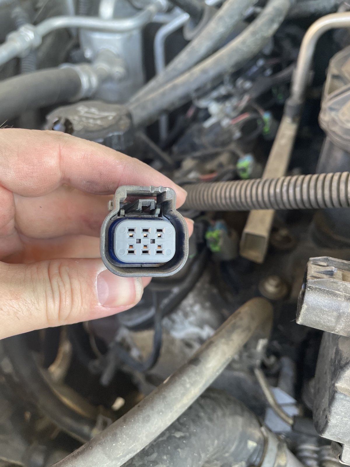

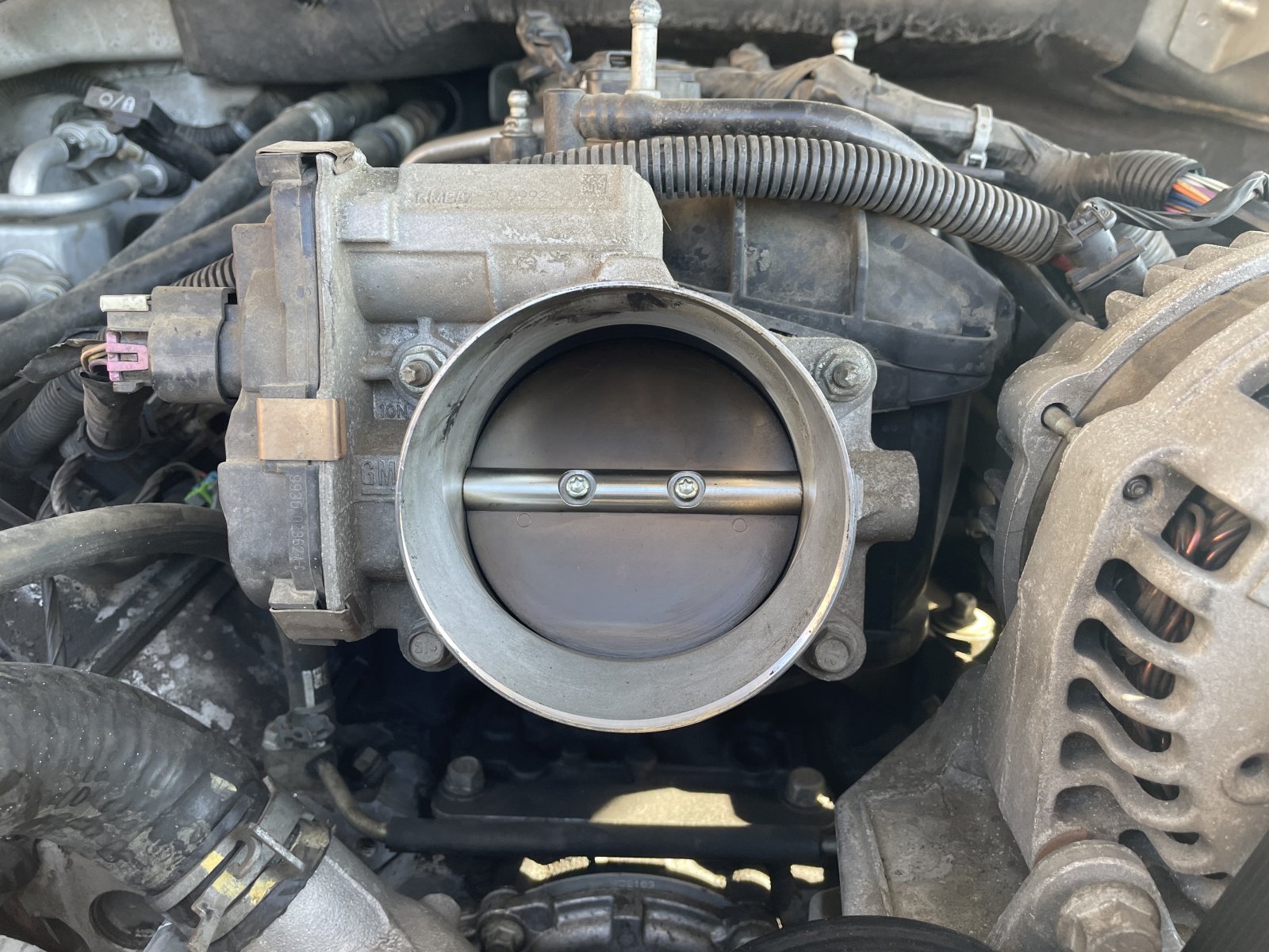

Tim - thanks so much for the continued information. I just went out and looked, and it appears that I have a 4 bolt throttle body and intake, so I'm thinking that I don't need a new intake.
I am definitely staying with Cathedral Port heads. I pulled the connector off the throttle body and this is what I saw:
Its hard to see in the picture, but the pins in the throttle body are gold colored. is that what is meant by the gold or silver in the Xlink type? I'm trying to find good pictures of the Corvette TB, and it seems like it also has a 6 pin connector of the same style, although I can't find a great picture.
Any reason I can't just use this?
Thanks again for all your help.

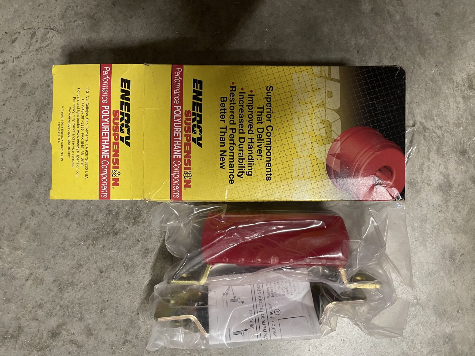

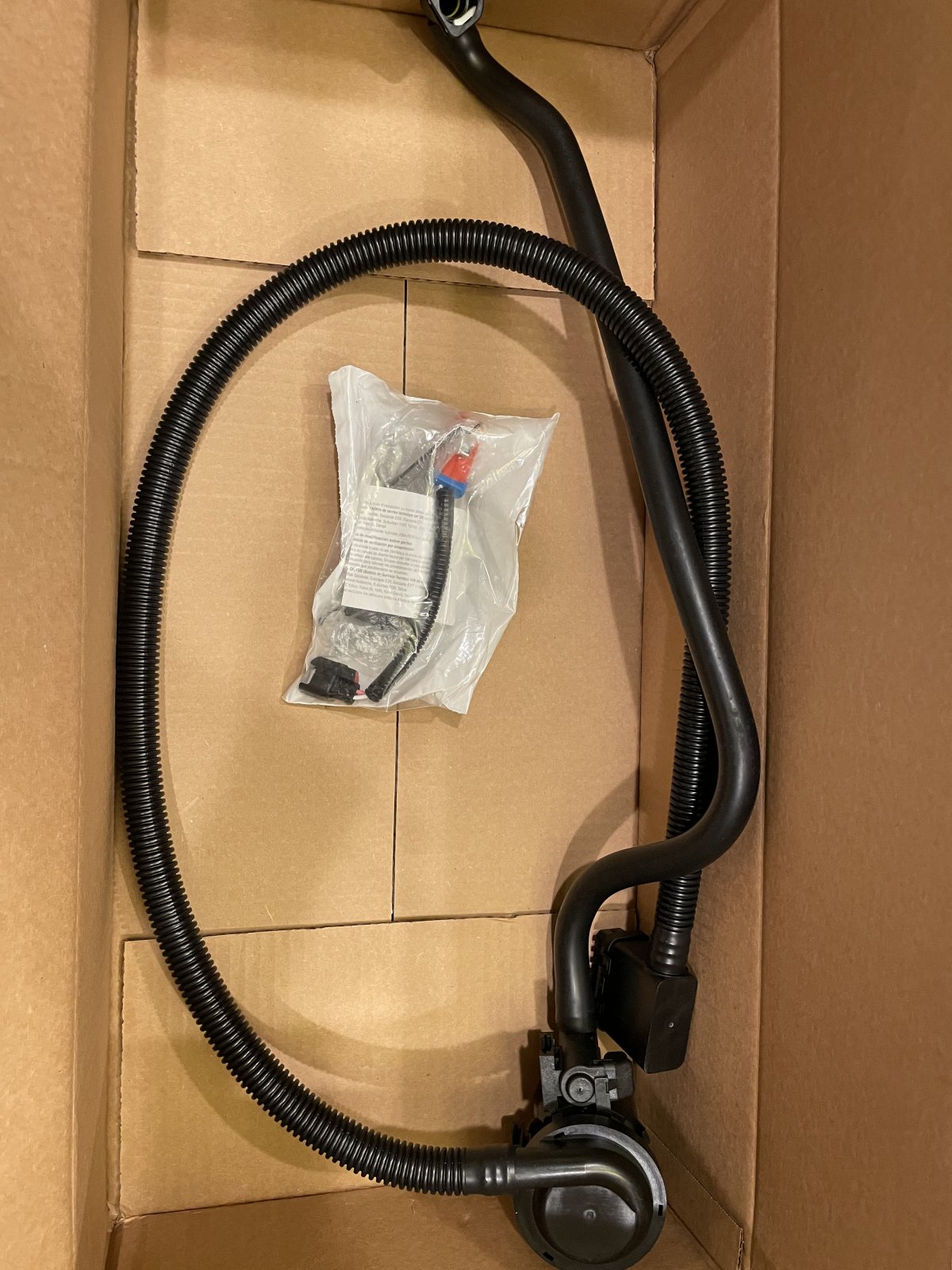

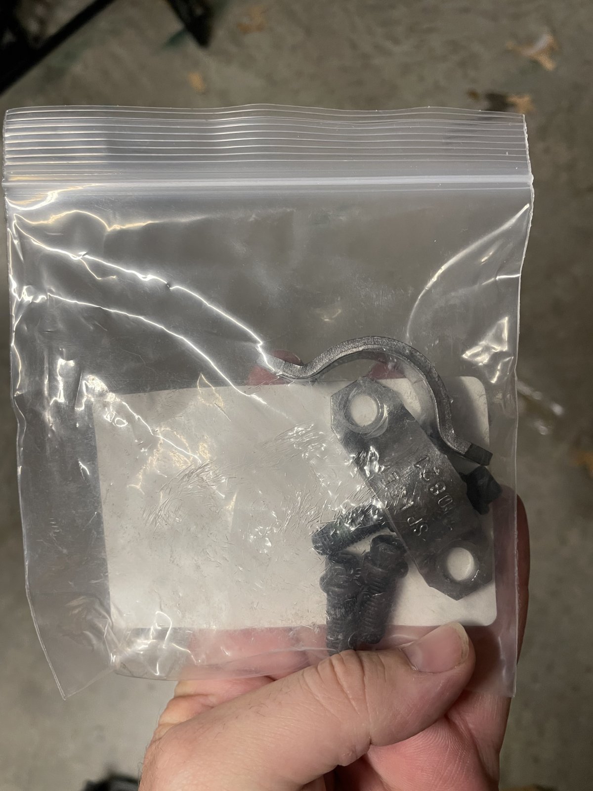

More parts arrived today. First up was a box from Amazon with new U-Joint straps, and a Poly transmission mount.
Then a little while later I got a box from A1Auto with a Vapor Canister Purge Solenoid Valve in it.
I've read a bit about just deleting this system, but it sounds like it might cause me some issues on my annual Texas State inspection, so I guess I'm keeping it.

...Then a little while later I got a box from A1Auto with a Vapor Canister Purge Solenoid Valve in it.
Don't be surprised if you find carbon pellets in the lines when you remove them or if you end up having to replace the EVAP ("charcoal") canister.
