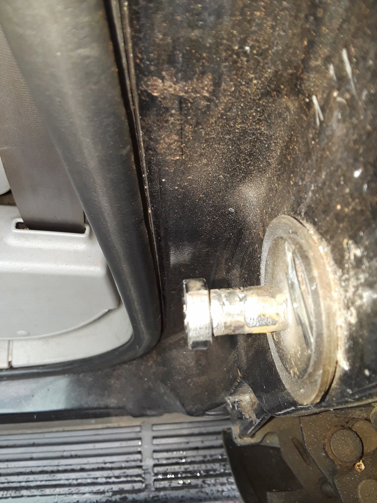

Is the plastic bushing on the striker still ?
Wedge
Oct 20, 2018
34
Ok looked at the part here in the store. Sorry, it doesn't have a plastic bushing like other GM's. However you may want to look into replacing it. Dorman #38428 @ Autzone.

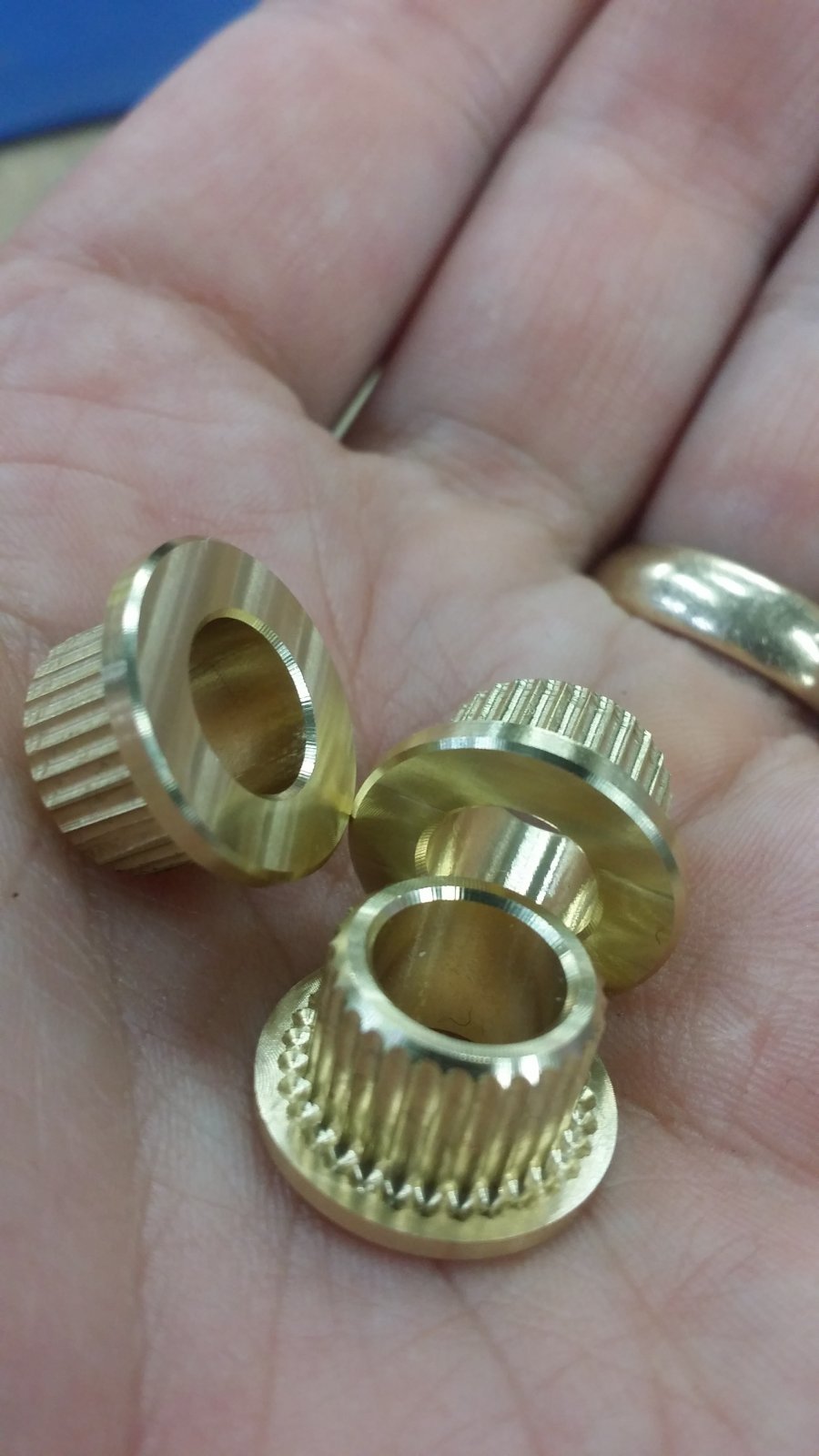

go the to a real hardware store and look for a sleeve or have some made by a machine shop, there is a few on ebay but you may have to message them for specs

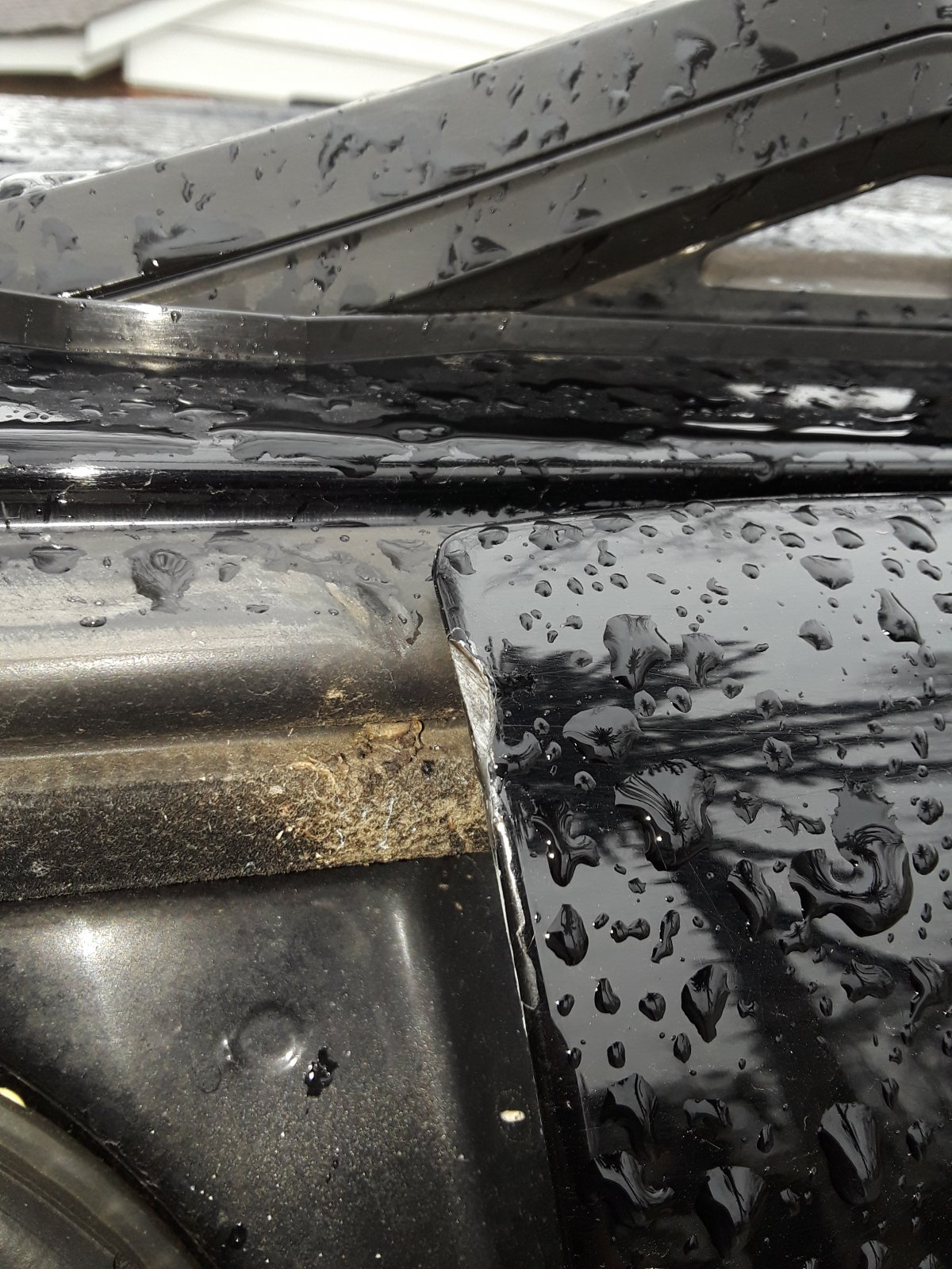

View attachment 220354 View attachment 220352
Don't go too long without replacing them or you may end up with the hinges wallowed out also......:)
I'm gonna guess they are since the bolt that catches the door lock is showing wear and I've shaved about an 1/16 occasion metal off the top corner of the rear driver's door smh.
I'm liking that idea. It would be a whole lot easier than the other options.
Come to think of it, somewhere on ebay I saw oversized bushings. Possibly allowing a guy to just drill out the pin holes a little larger and inserting the oversized bushings.
