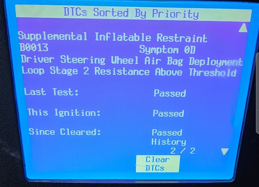

I get a random "Service Airbag" on my DIC, and it shows incorrect resistance and points to the clock spring. However it's just a loose connection in the 4-pin harness near the kick panel. A quick wiggle and it goes away, I am going to tighten up the female pins to hopefully fix this.
dkad260
Jul 21, 2019
658
671
It was this connector here that had me taking my steering wheel apart until I realized what it was.
Reason i'm posting this is to check the connections underneath the kick panel as well or anything you may have disturbed.
