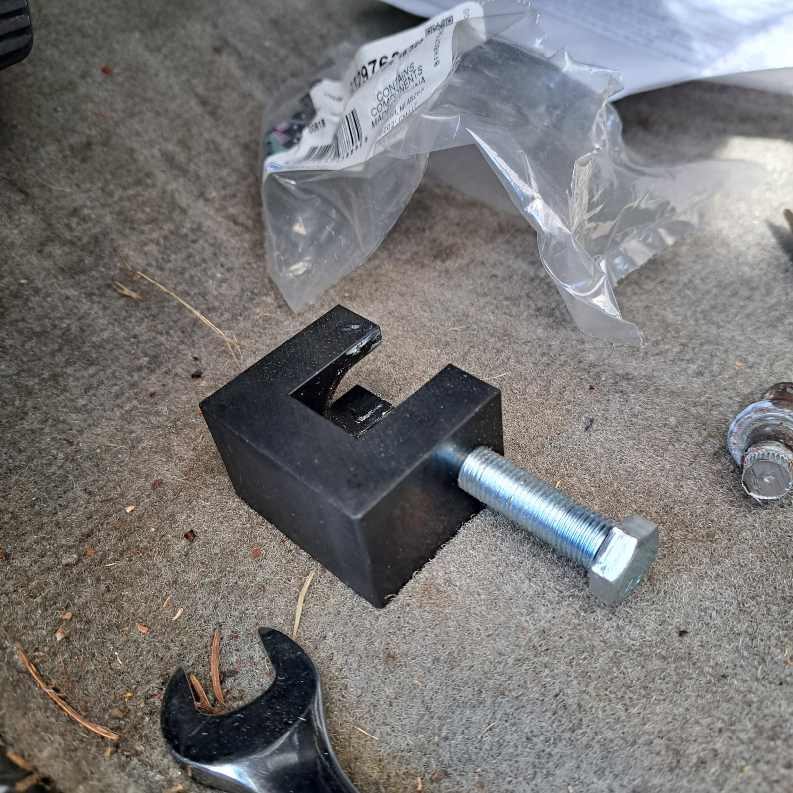

They are awesome if you just call them up. Derek is the sales guy and Ron designed the parts.
Ron also designed a part to press the hinge pin out. It has an interference fit with the inner hinge. Many people punch them out with a hammer and or chisel. This tends to deform the welded on parts of the hinges.
You can buy the little tool which he lists on his website. I didn't need it. I don't recall how I originally removed the pins... however, you could use a large socket, and something on end of c clamp to press it out.
Aftermarket pins don't have that interference fit so if you've rebuild it before you may not need the tool.
