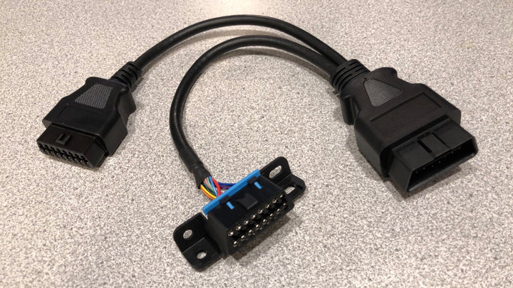

Another thought on this is get a OBD splitter cable and keep the Range dongle plugged in tucked up under the dash while leaving a OBD port available under the dash. Like this one from BTDieselworks
