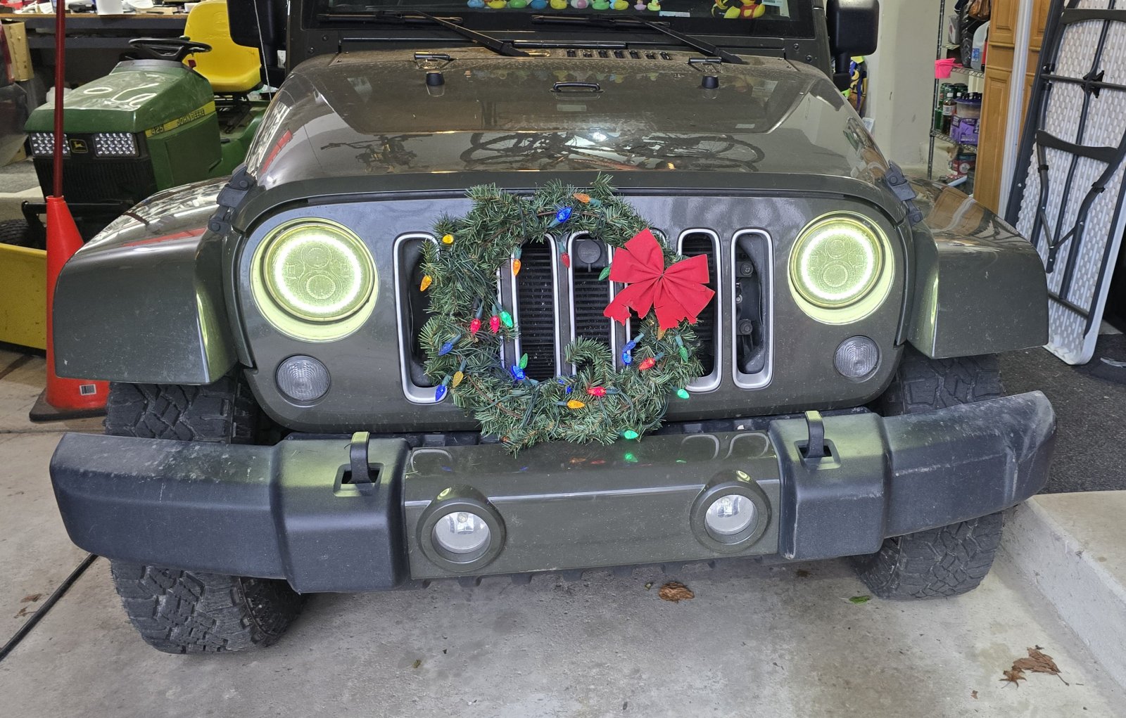

I will add one more thing that's worked both on my GM trucks and my Jeeps. In fact, I just did it again with one of the Jeeps.
BLUF: leave the battery disconnected for AT LEAST 30 minutes.
Just had some work done on my wife's 2016. Rodent damage to wiring. Get it back from the shop, and the tech had disconnected the tap I use for the headlight halos and Christmas wreath. I'd forgotten how I'd hooked it up, pulled the wrong fuse, and now the TPMS wasn't reading any tire values. 4 dashes instead of pressure readings. :banghead:
Disconnected battery for 10 minutes.... reconnect.... nothing changed.
Tried a few different things, no change. I just really didn't want to take it back to the shop. "Hail Mary" move was disconnecting the battery for like an hour. Reconnect and all is well.
Again, this has also worked on my GM trucks. I don't know why, but it's worked several times. YMMV.
ETA: Jeep with lighted Christmas wreath..
