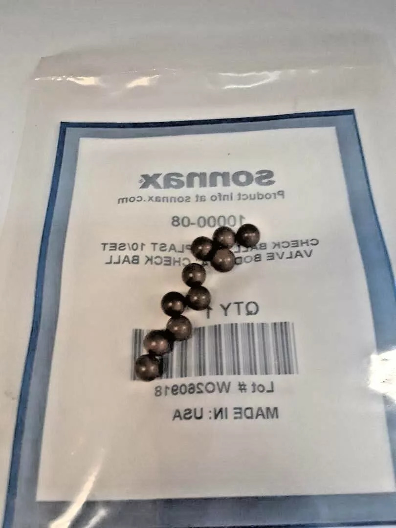

So today's update.
Sonnax Zip Kit and Torlon Check Balls arrived. Decided to swap out the cheap nylon check balls wit hthe Torlon Check Balls. These are overall more durable than the cheap nylon OE check balls that may start to wear over time.
Project Carbon Valve Body Kit should be shipping today. They were waiting on a spool valve delivery.
