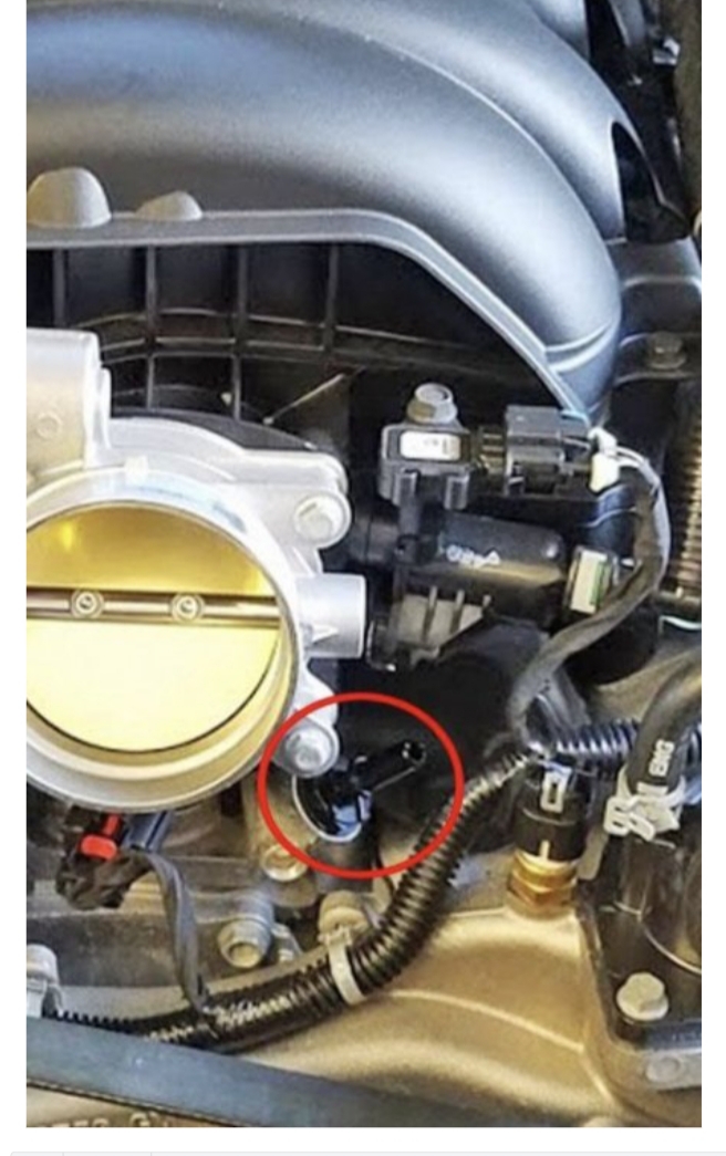

The PCV valve is not integrated into the valley cover, please see attached diagram. Please change it out and report back.

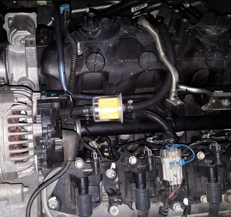

You can also add a fuel filter after the pcv valve an see how much oil it collects on it. I added one on my 6.0 and you will be amazed how much oil still goes thru the catch can.

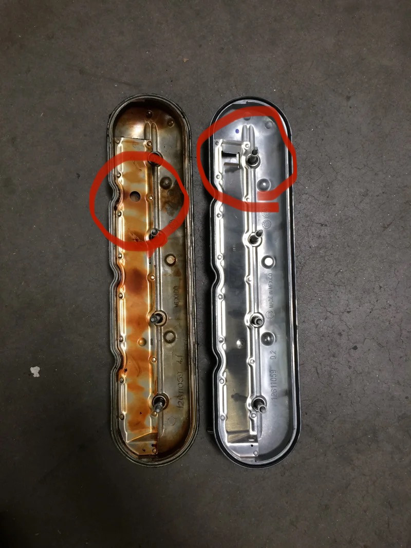

Mostly it is the valve cover that comes on it, the one you buy (OEM) comes with the lip rather than a hole and it makes huge difference with the oil loss if I may say.

PCV valve is not in the valve cover on these engines. It is under the bottom corner of the throttle body. The 2 valve cover hookups are just breathers. They do not connect to a catch can. Though you could connect a clean side separator to them.

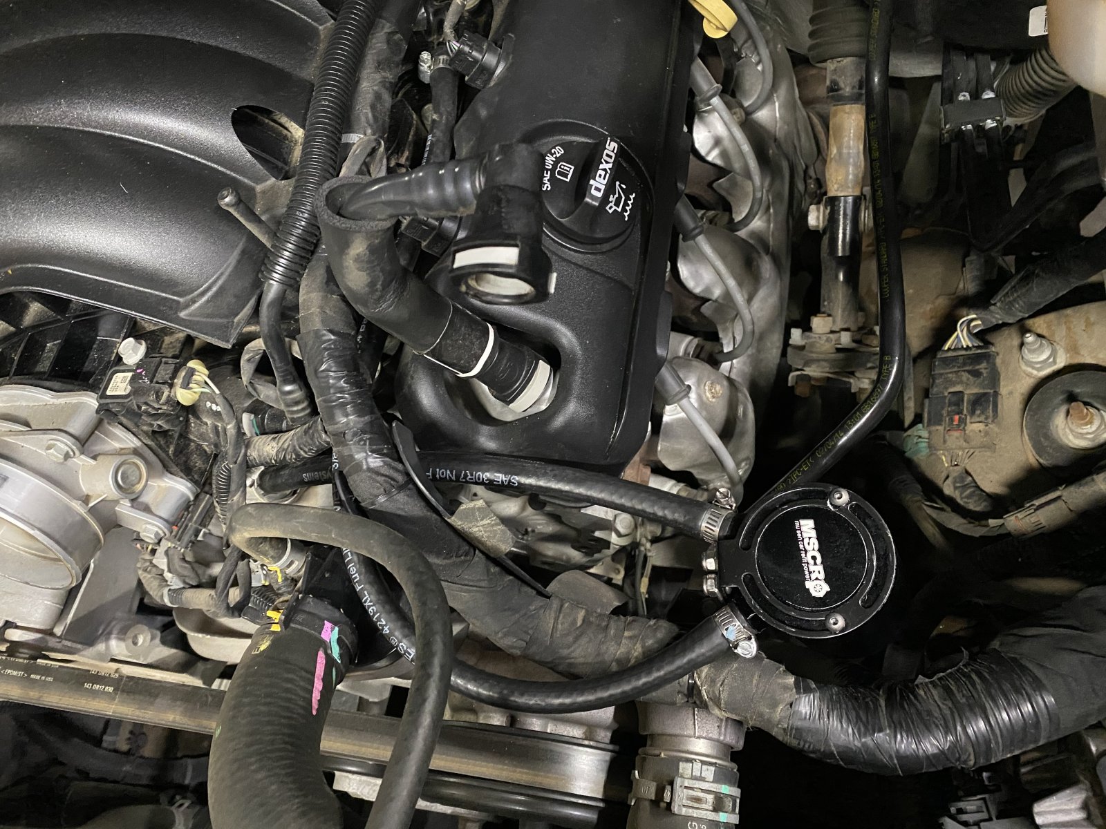

post a picture of how u have it set up. since it's been said the pcv isn't a part of the valve cover then you most likely have it wrong

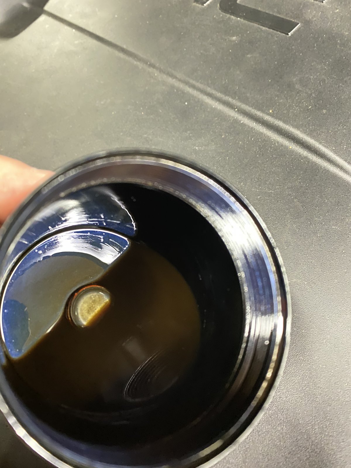

New PCV installed, 225 miles later still getting quite a bit in the can:
