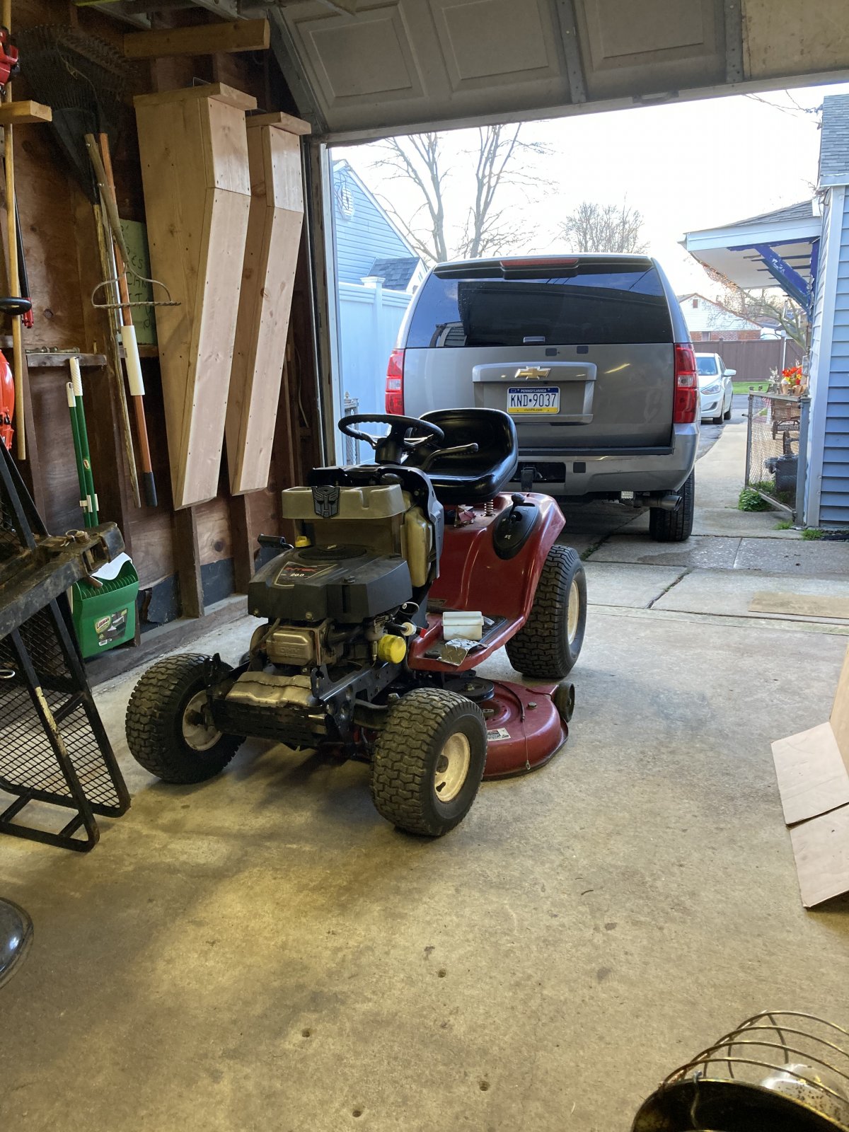

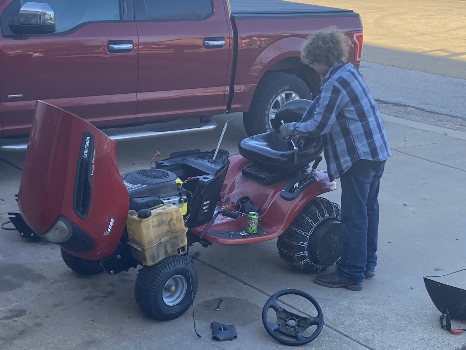

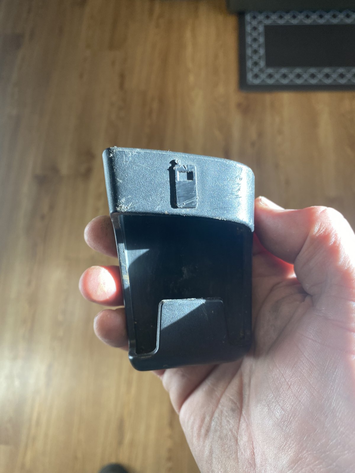

Joseph is getting things ready for his lawn mowing business by switching his rider from its snow removal configuration to its grass cutting configuration.
Yesterday afternoon he was replacing the broken lower console on his riding lawnmower with a used one off of ebay and it had this “strange” plastic thing mounted where his rider has the cruise control lever. He couldn’t figure out what it was for so he asked me. I had to laugh because I realized he’s never seen a cell phone that would fit on this. I’m envisioning an old Nokia fitting in this perfectly.
View attachment 366588View attachment 366589

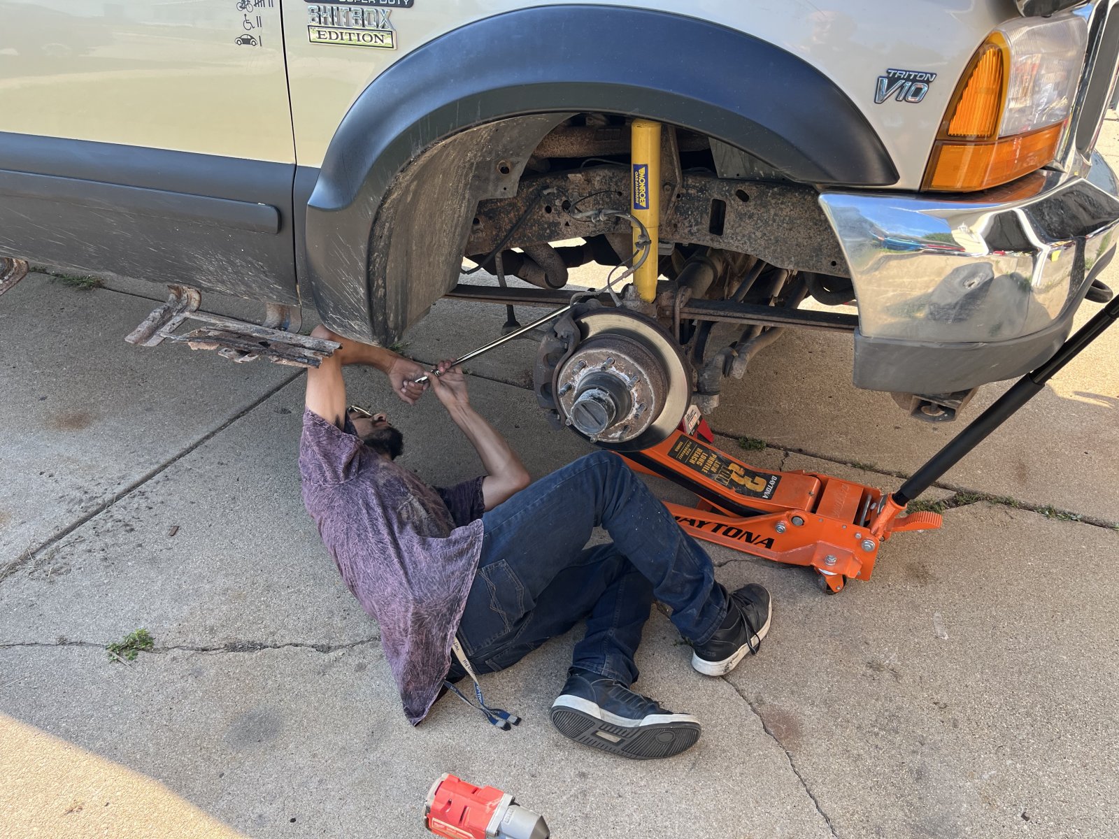

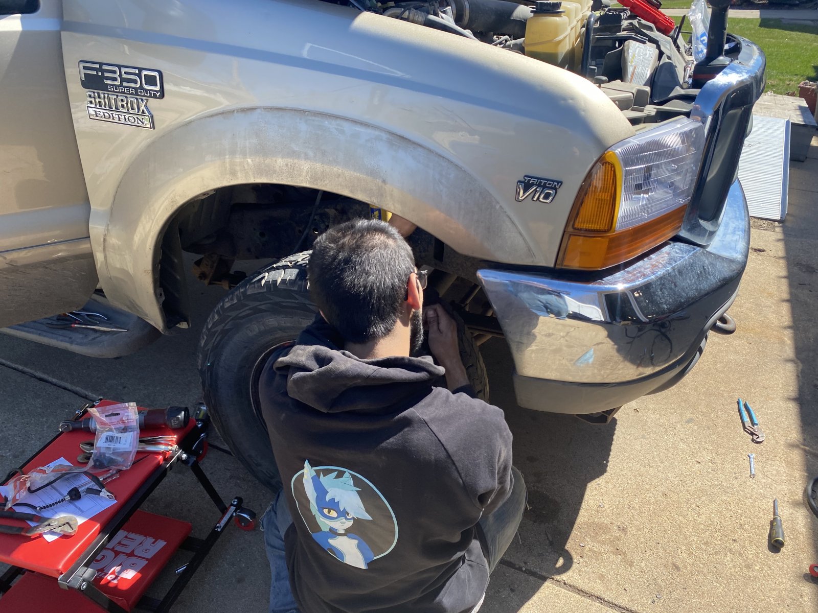

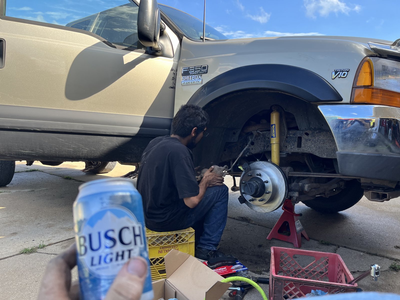

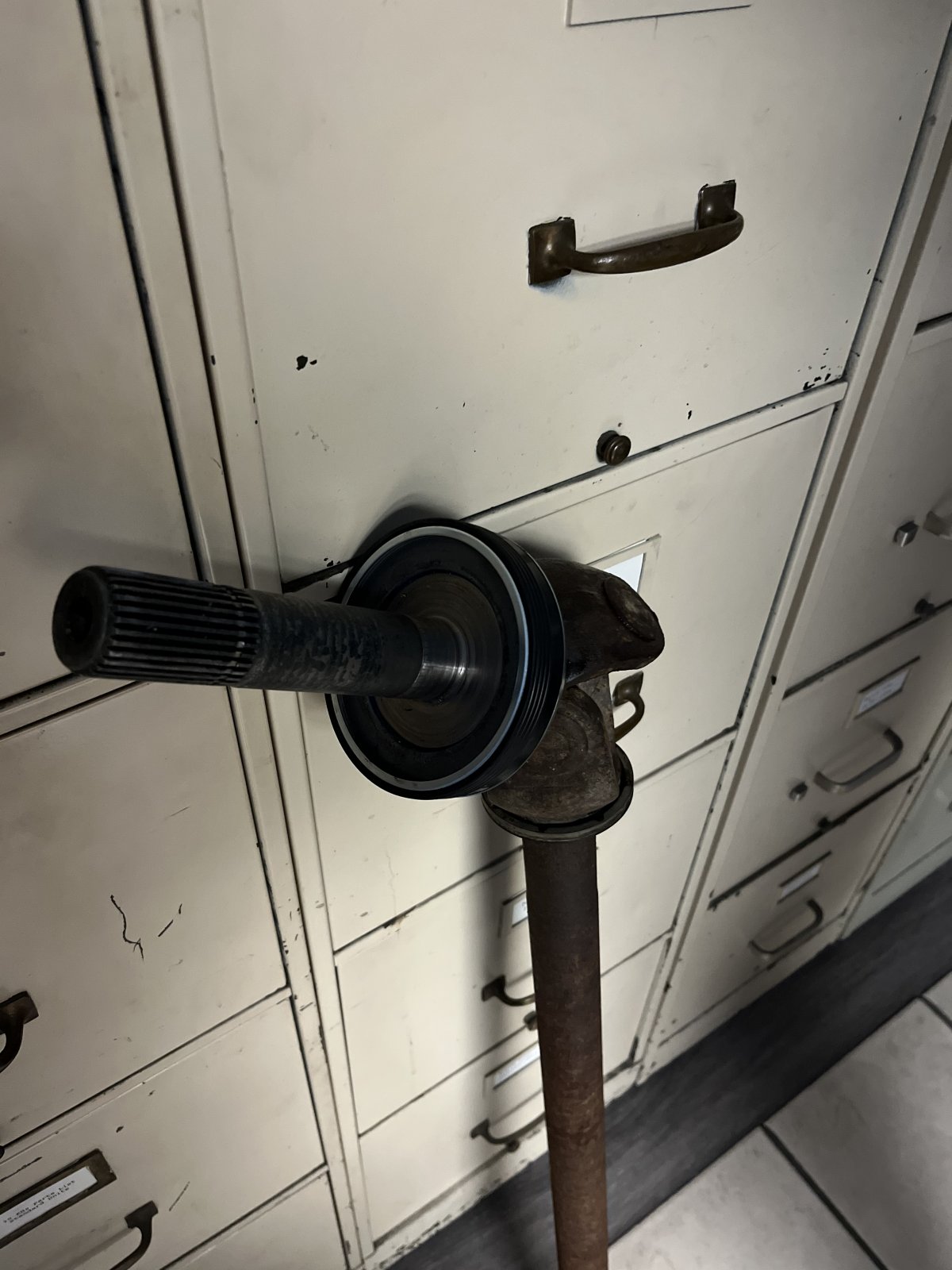

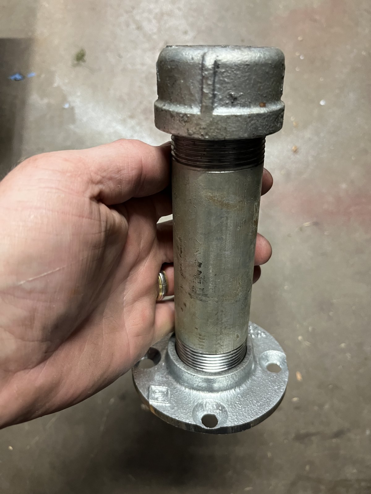

The weekend before Labor Day was spent working on Javier’s F-350. He had the passenger side front axle seal in the knuckle go bad and start coming apart so we had to pull the wheel bearing and the front axle. Iowa rust always makes stuff like this a challenge.
I didn’t realize that you needed a special $80 tool to press the new seal on before we started so we ended up making one with $12 of pipe fittings and some strategic use of a grinder since we needed to get the truck back up and running.
Once we got the seal on and the axle back on, Javier went about changing out the rotors and pads while we had everything apart. I enjoyed supervising that part of the process.

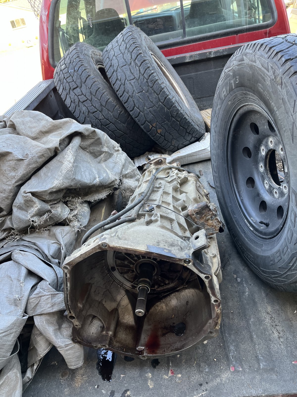

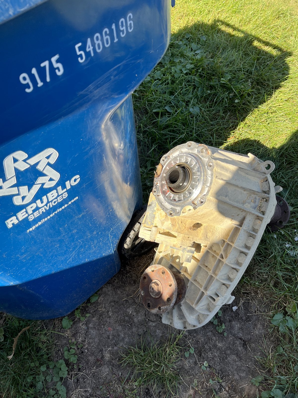

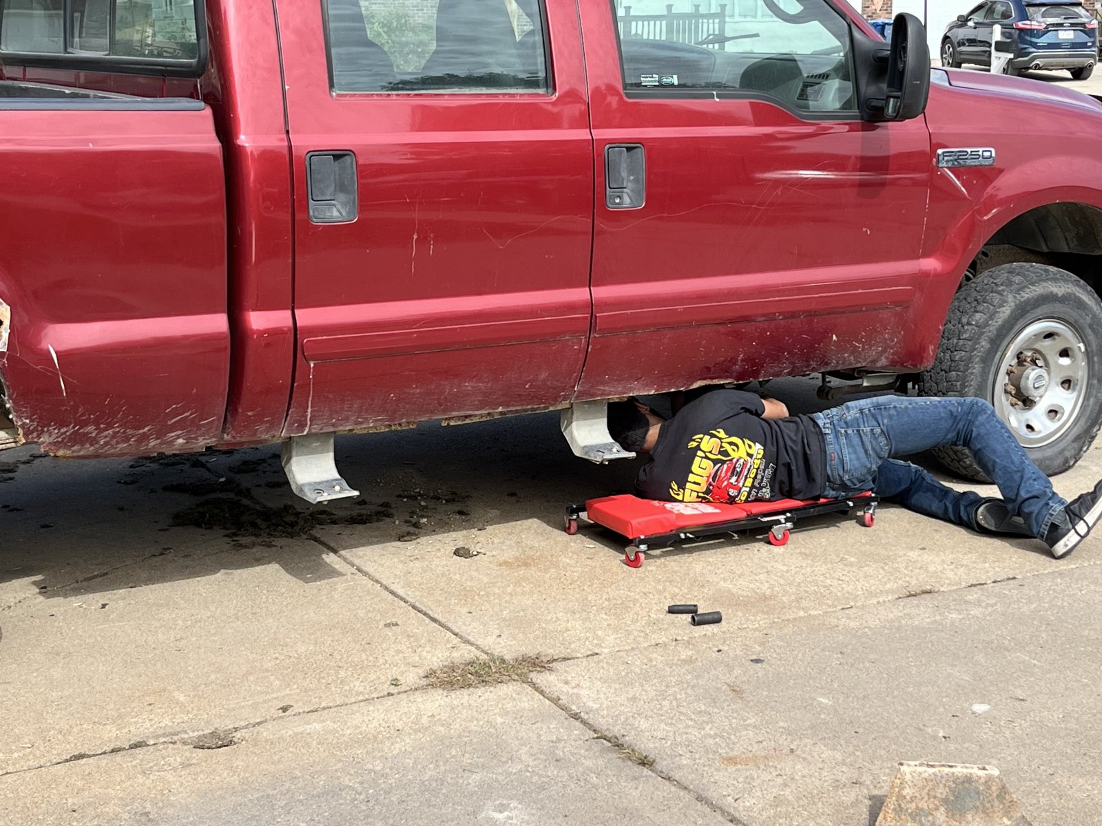

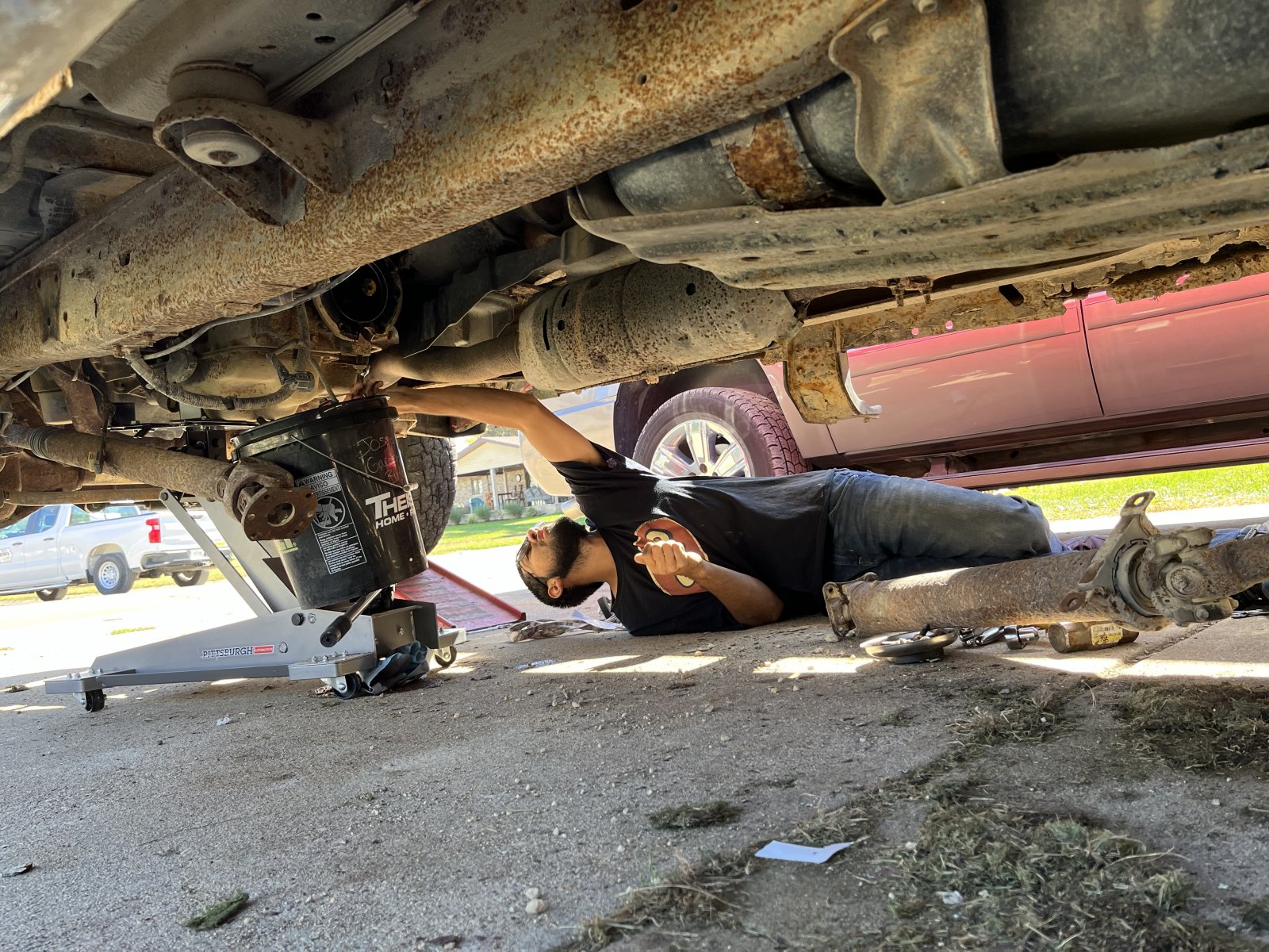

So……a couple weeks ago, the transmission in Javier’s F-350 took a bad turn. Getting anyone to look at it to see if it could be rebuilt was next to impossible. The ones that did say they’d be willing to try and rebuild were booked out a couple months and said it would cost about the same as a buying a rebuilt which was outside of his budget. We started looking at our options and found that my cousin’s son-in-law had a 2002 F-250 for sale with a blown motor that had the same transmission as Javier’s truck. $800 later, I had a working transmission that was wrapped in a truck still.
Today, Javier and I pulled the transmission from the donor truck.
Next is pull the transmission from his truck and install the donor transmission. Then I’ll try and recoup some money and sell/part out the donor truck.

Well, we got back at it today. We got the transmission pulled from Javier’s truck and was able to get the transmission from the donor truck put in place before we got rained out. The fluid definitely had the distinct smell of burnt fluid. We did go ahead and replace the rear main seal while we had the transmission pulled. I’ve had a few people ask me if it was worth all the effort for a 21 year old truck that has 190K and a lot of rust. I think it is absolutely worth it. It’s been a lot of fun working with Javier on this project and whats better than being able to spend time with my son. Can’t believe he will be turning 19 here in a few weeks.
