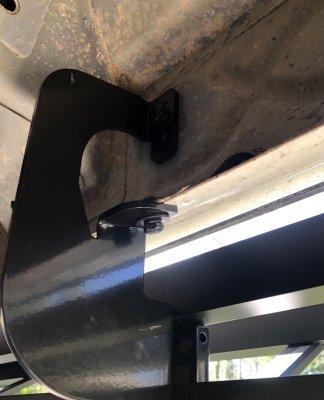

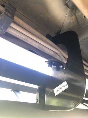

I’d love to see how those are mounted.
I also noticed they have gone up in price.
I’ll add a shot from underneath tomorrow. They’re mounted to the factory running board mounting points. There’s a bunch of threaded holes already in place along the pinch weld and above it. No drilling required, and the brackets are carved out to fit around the heating and cooling lines under the passenger side.
Here you go:
View attachment 274522 View attachment 274523
Thanks for the pics. That helps envision them a lot.
