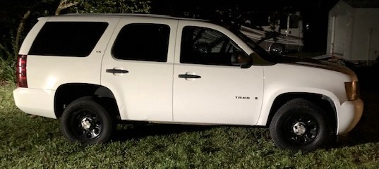

I decided late in 2020 I was ready to build another project. I’d been out shopping Wranglers again, and once again decided they lack the road comfort we like in a trail runner. We spend a significant part of each year traveling North America exploring remote areas and 4x4 trails. I like something comfortable on the interstate and in the woods. I stumbled across a dealer offering retired government vehicles and I was intrigued.
Found this one with only 60k on the odometer. The manager said he couldn’t (wouldn’t?) tell me anything about where it came from but the guy in the back lot wrenching on them was more forthcoming and told me it was CBP in Texas. Which the service records in Carfax confirm the area.
No rust, no significant body damage, no oil leaks or crankcase blow by. Interior in like new condition except the cracks in the dash. (Those “like new” seats will be back to haunt me later.) So home she came.

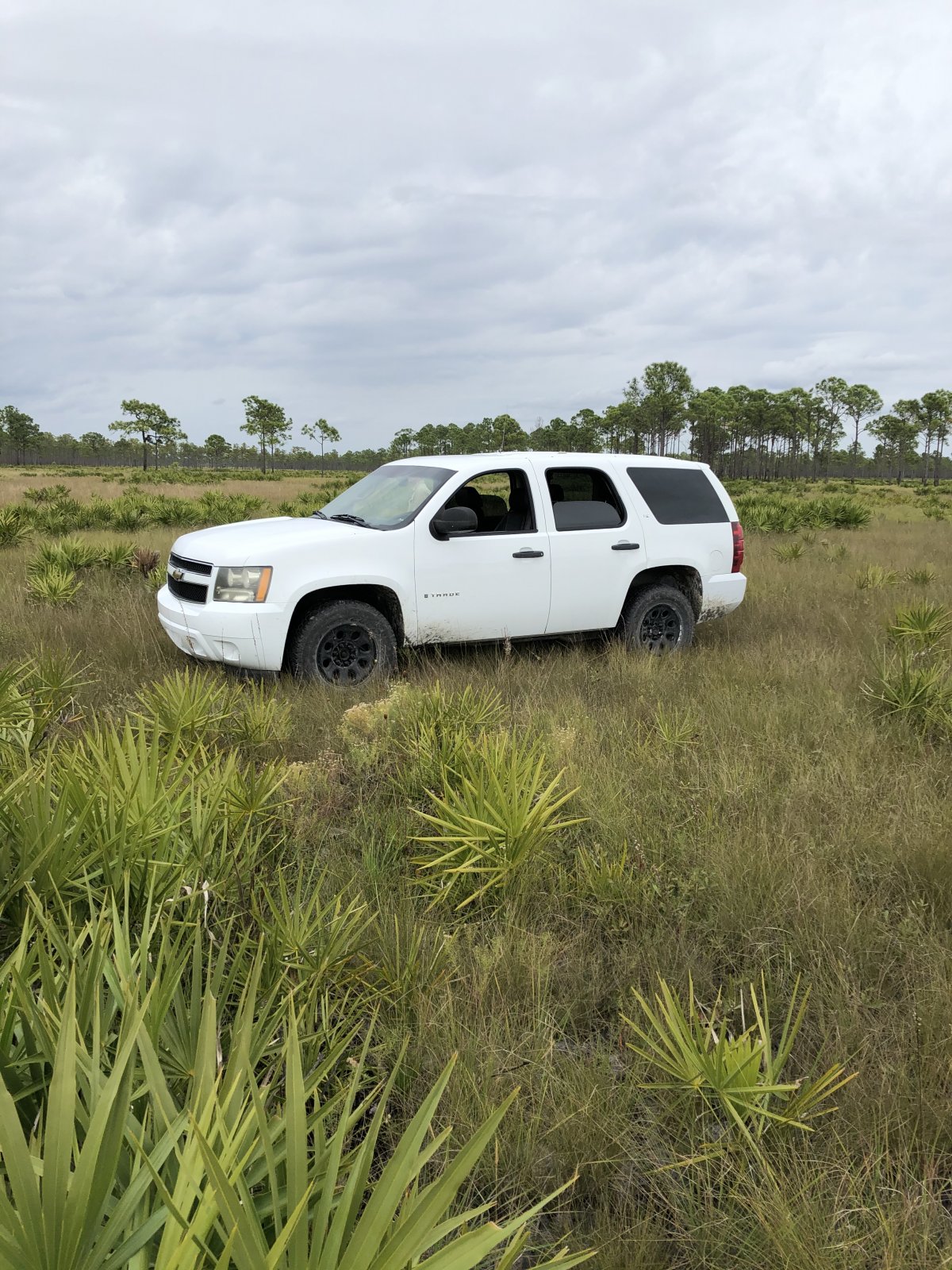

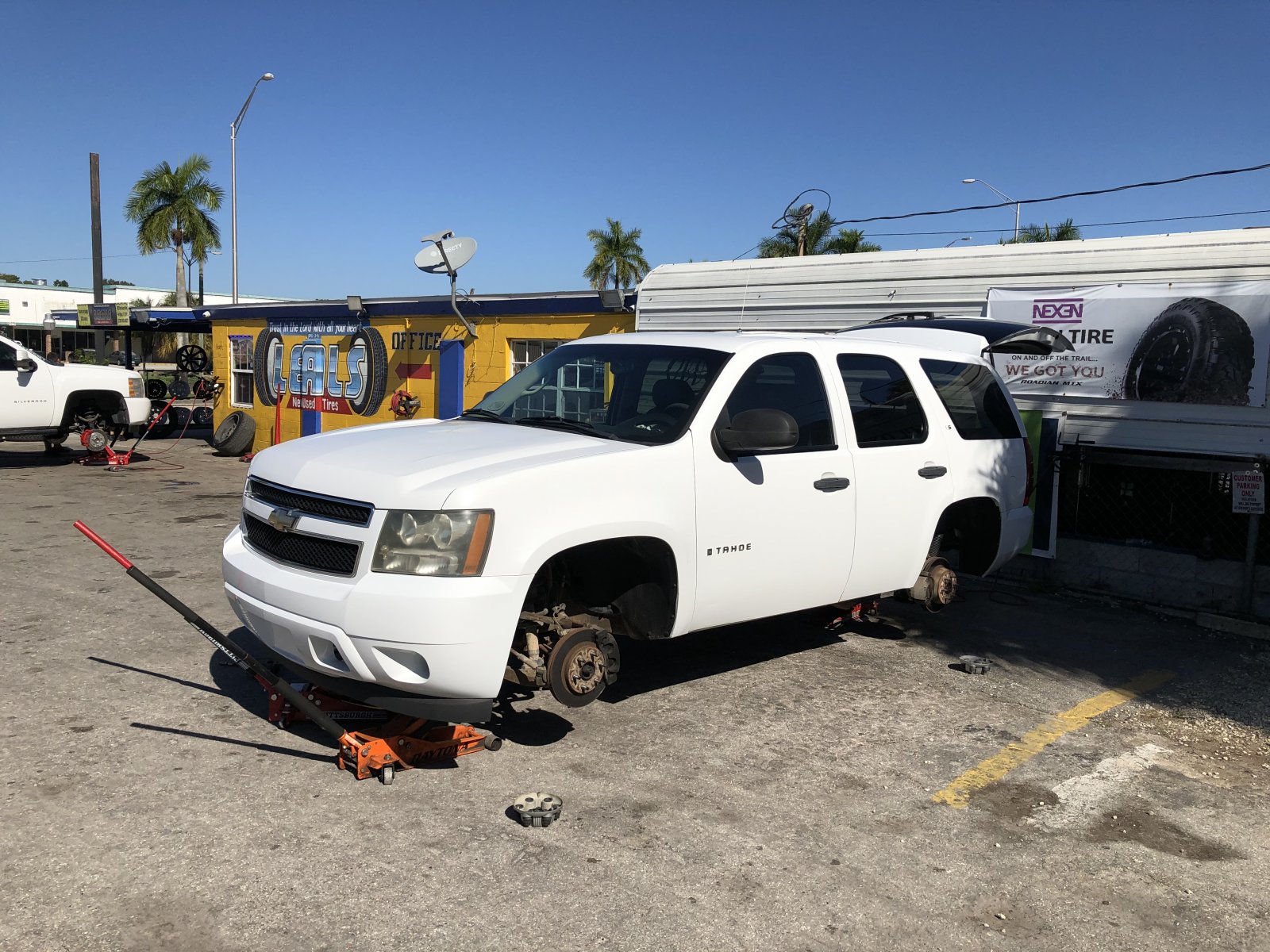

Next up was taking care of miscellaneous deficits.
AC wanted a new expansion valve in the rear, so the whole rear evap assy was replaced with OEM.
One rear caliper was sticky, and remained so even after I fiddled with it some, so I replaced both rear calipers and pads.
Check engine light, due to evap codes. Wrong gas cap. Fixed that and now I'm getting an occasional code related to the purge valve. I'll deal with that later.
Stability, traction control error lights. Initially I thought the barbed wire had grabbed a wheel sensor, but it turned out to be from not having four identical size tires.
And of course the tires were weather cracked, so I replaced them with new. P265/70/17 for now.
Seems somehow poetic to see a former CPB vehicle in the hispanic part of town up on blocks.

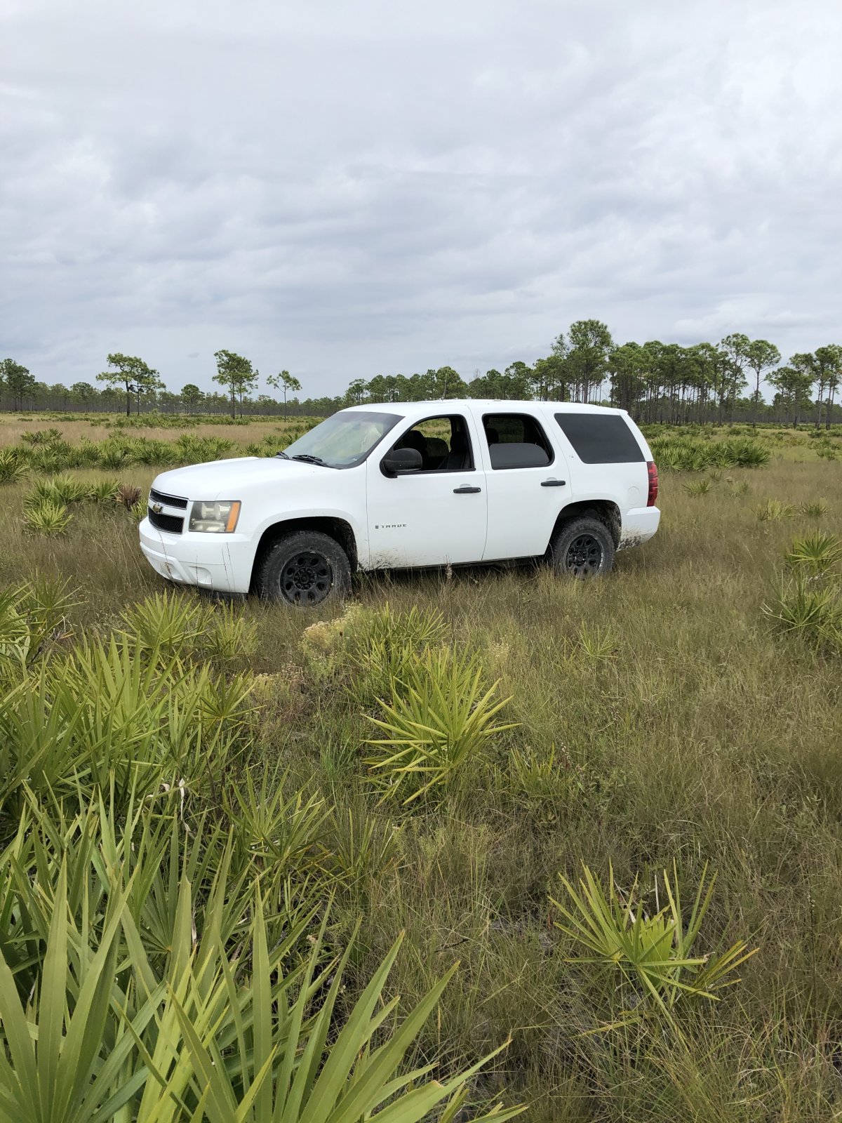

Took a celebratory trip to the woods.

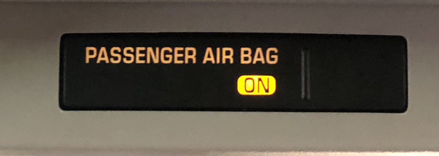

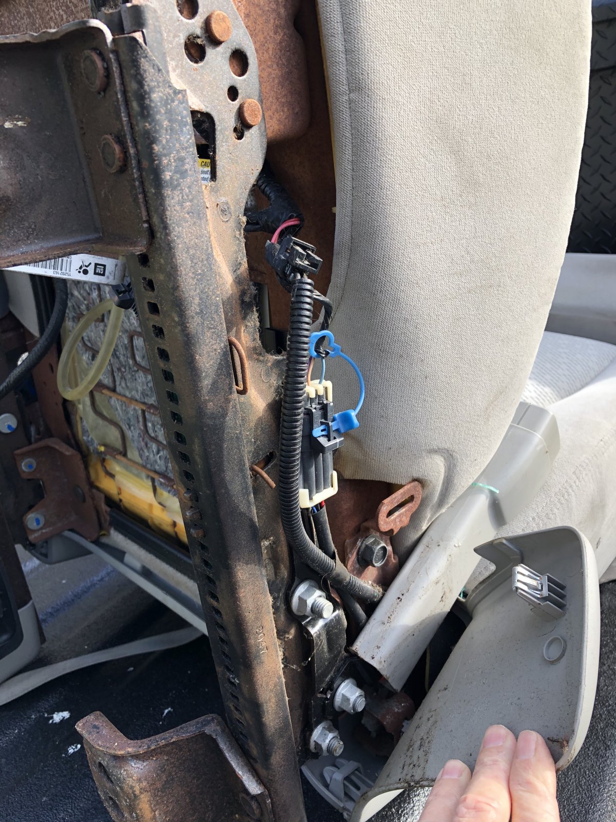

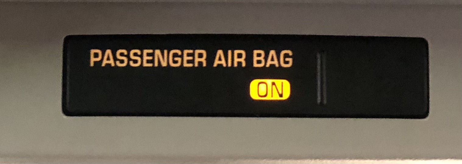

She came with a nice shiny interior, vinyl floor covering :waytogo: and vinyl seats. Just what the doctor ordered for a vehicle to run around in the woods with a couple of dogs and dirty boots.
But there turned out to be a darkside. The SRS (airbag) system was showing a fault, and after I bought myself a new scanner to check it out, it told me the passenger seat had the wrong component for the passenger presence sensor. At first I was just going to buy one- almost $500- and then I discovered if I did, it wouldn't even match the wiring harness in the seat.
Turns out somewhere along the way, probably when decommissioned, the seats were swapped for newer ones. With different wiring. SMH
Then I set out shopping seats, which were all far away and expensive. Finally found a guy in my own neighborhood that had some Silverado seats with the correct sensor. Bought one for cheap, pulled out the sensor and the wiring, and married it to the later model seat in the Hoe to get everything working.

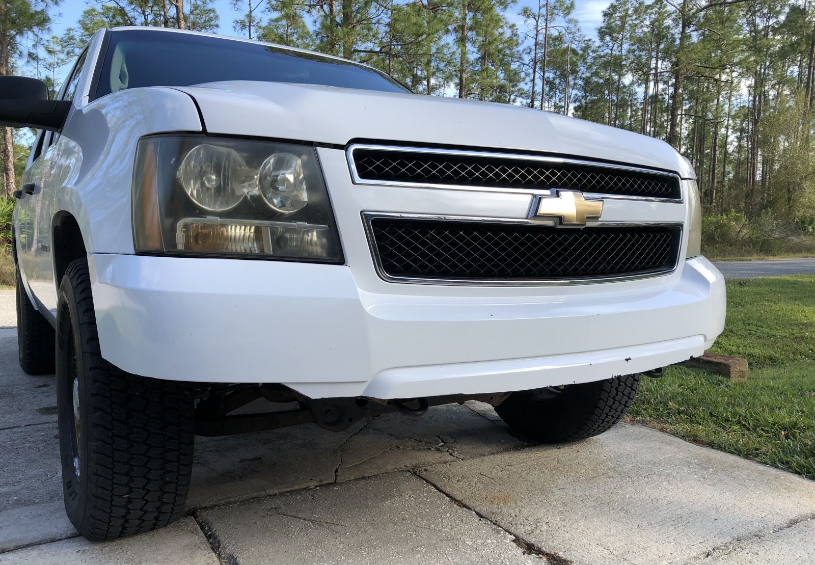

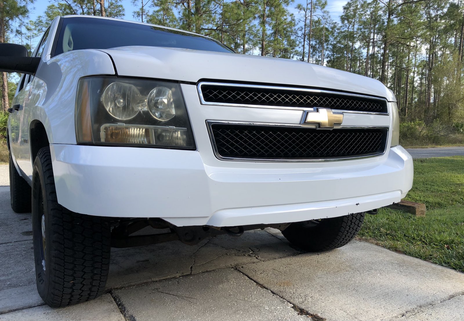

When I bought it the front facia was complete. Here's a crappy photo after arriving home.
But I could tell the facia had been replaced with a new (ish?) one when they decommissioned it because the alterations to the front frame show where the pushbars etc. were located. But this facia is more or less perfect, no holes.
B
Bill 1960
Testing the Limits
Dec 17, 2020
1,480
2,866

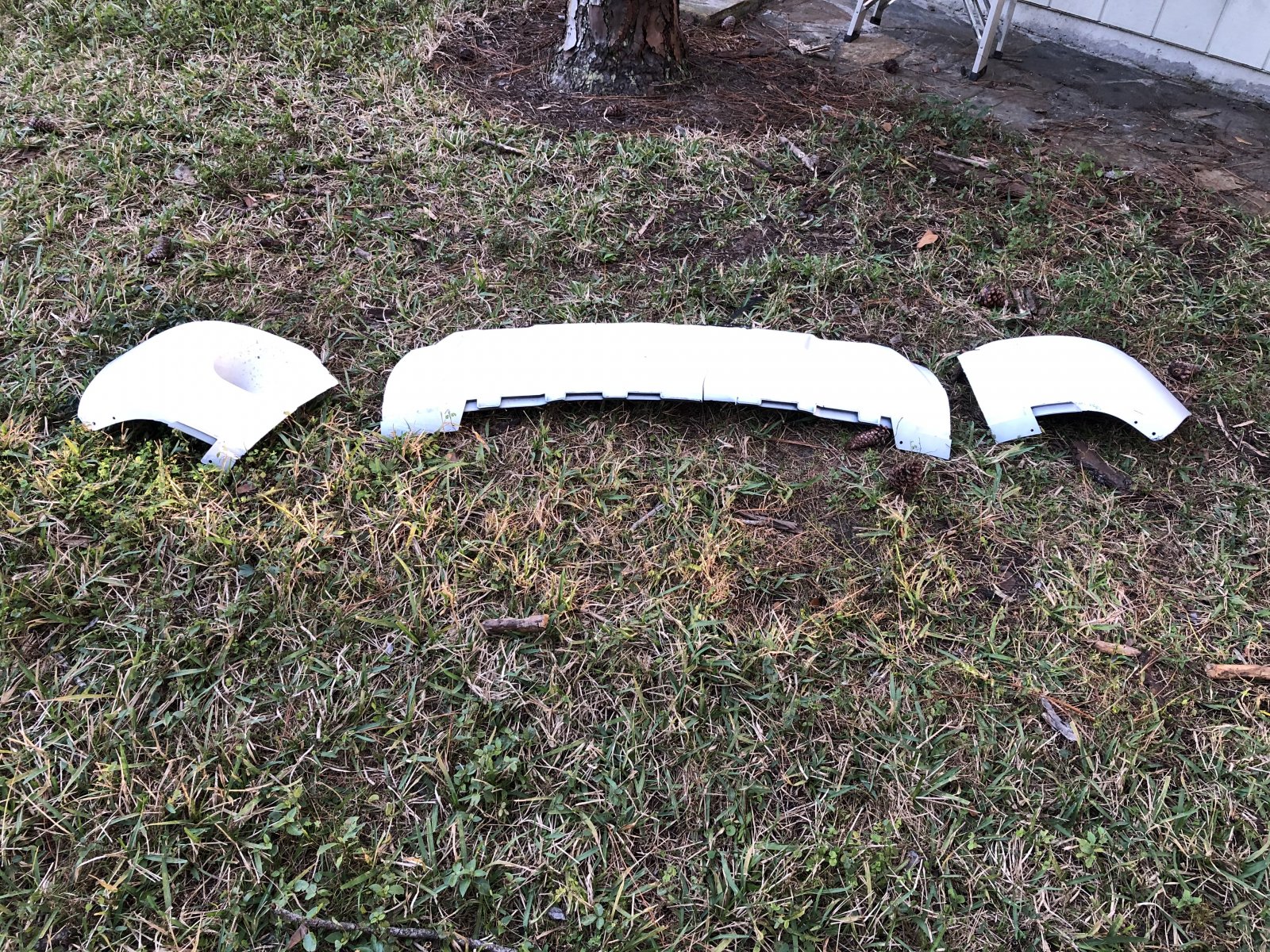

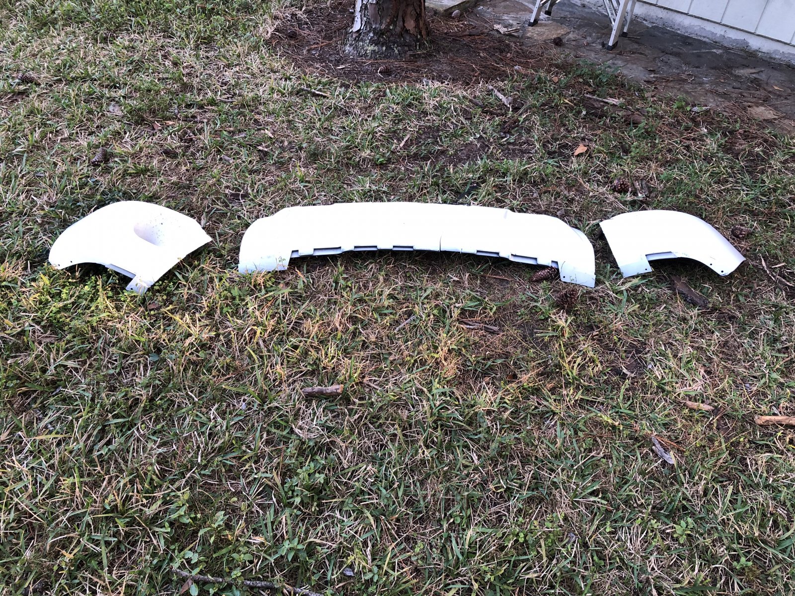

So, of course I did this:
60F9A5D0-6B55-4100-B8F3-34DA77A00ADD.jpeg 91086A32-06C4-467C-AD8B-BB246756E2FE.jpeg
Some things are just meant to be.
View attachment 267631 View attachment 267632
Later I'll be building a recessed winch mount and an offroad bumper / pushbar. I didn't like any of the commercially available options because the winch bumpers all protrude and diminish your angle of approach.
How much else did you have to trim along with the bumper skin?
B
Bill 1960
Testing the Limits
Dec 17, 2020
1,480
2,866
Not a thing. Probably because some of the OEM lower brackets were missing I believe. Looks to me like when it was modified originally they took out some stuff to install a skidplate, push bar, or whatever they mounted on the front.
The new front end they hung on it was only bolted at the top and sides where it intersects the wheel well. Took me all of five minutes to remove the front and ten minutes with a circular saw to cut it along the crease in the bumper skin.
The OEM steel bumper is still hidden right behind the trimmed up skin. Everything I removed is just air dam, basically.

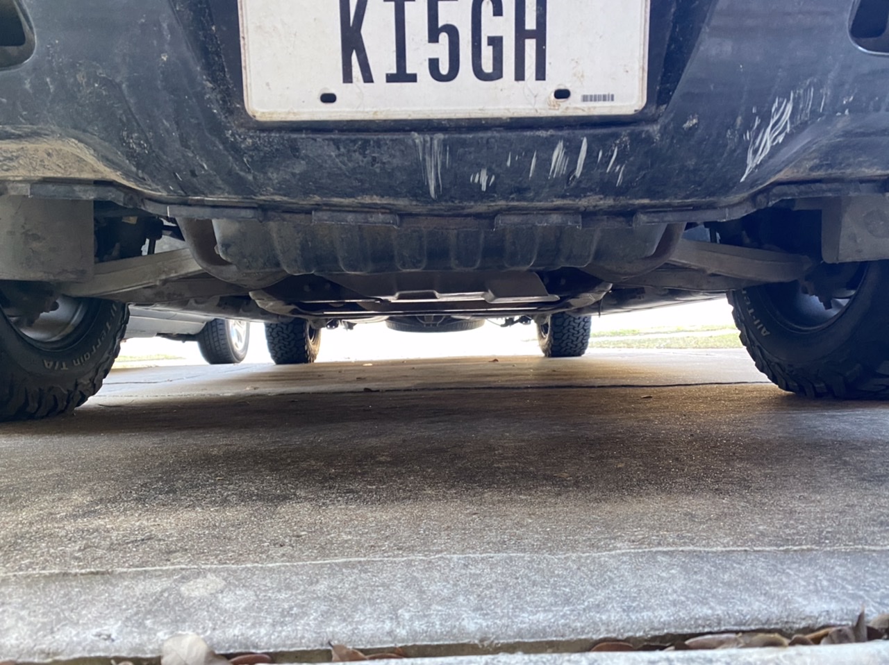

Here’s some new chin pinstripes from my last adventure at new year’s. I had removed the air dam itself months ago. The fender wells are just visible in front of each tire if you’re looking carefully. I’m guessing yours were already trimmed.

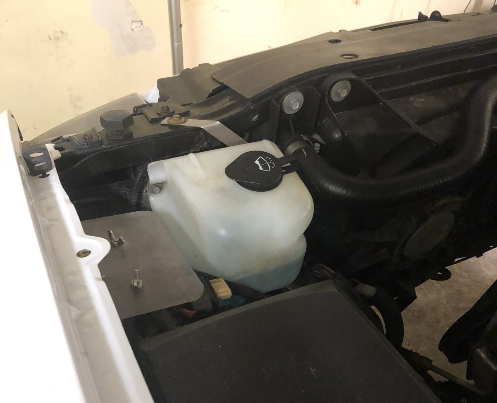

The washer fluid tank is one thing I’m curious about as far as doing the CBP trim.
B
Bill 1960
Testing the Limits
Dec 17, 2020
1,480
2,866

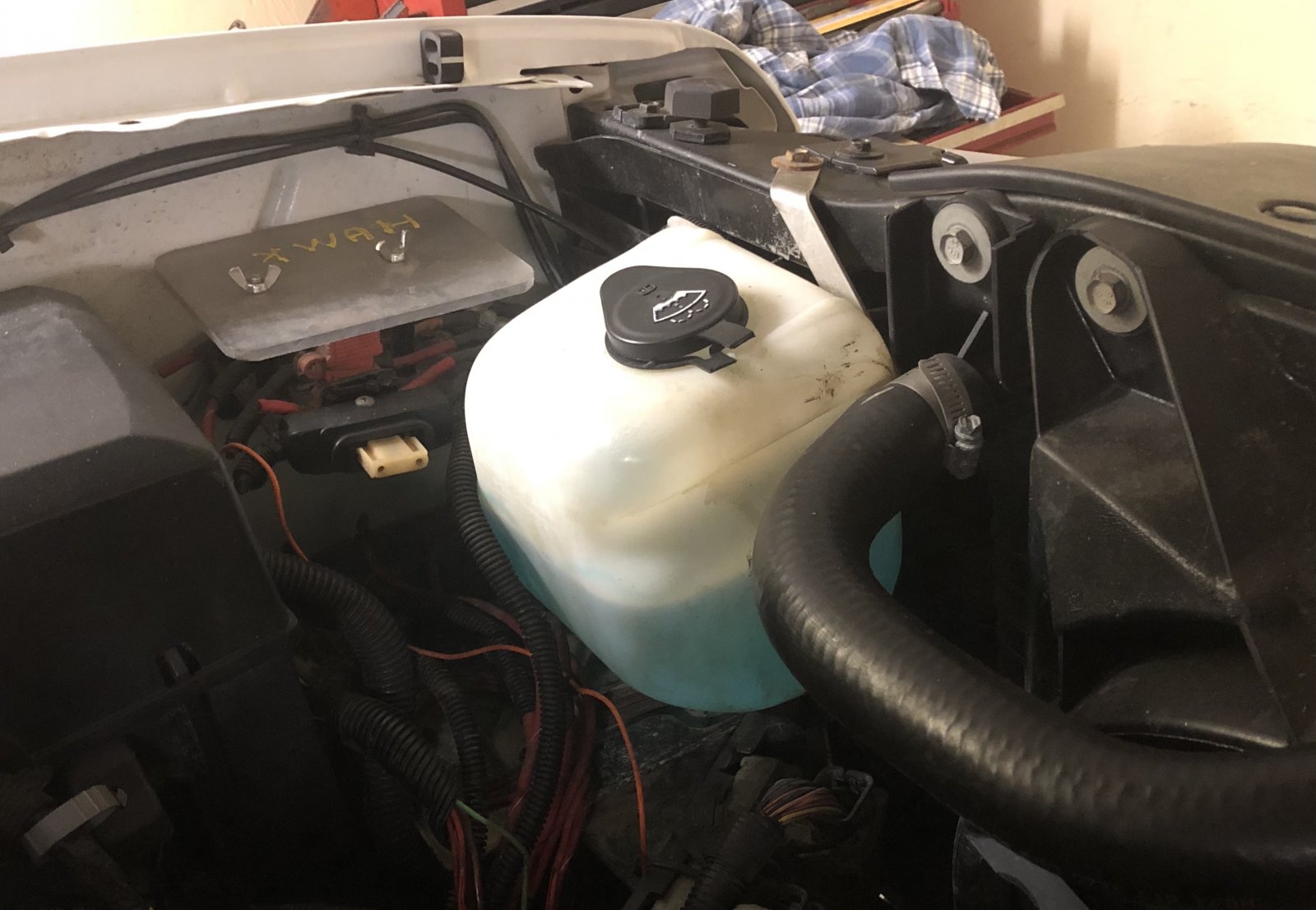

@Sparksalot , I've been curious about where the factory washer fluid tank sits, I'm guessing it's in front of the LF tire like my Jeep used to be before I trimmed on that.
My Hoe came with an aftermarket tank mounted on top of the secondary battery tray. Which I'd like to move so I can put a second battery in. Show me your factory tank and I'll show you my aftermarket. Pics:
E702B54E-E771-4944-B573-0A952B328AA9.jpeg ECFD457C-D8FB-4599-BC48-47ABAD9711A6.jpeg
If anyone needs a part number off this tank I'll see if I can find one when I get around to relocating it for the new battery. In the past I had no problem finding a square aftermarket tank for my Jeep when I cut out the factory tank.
