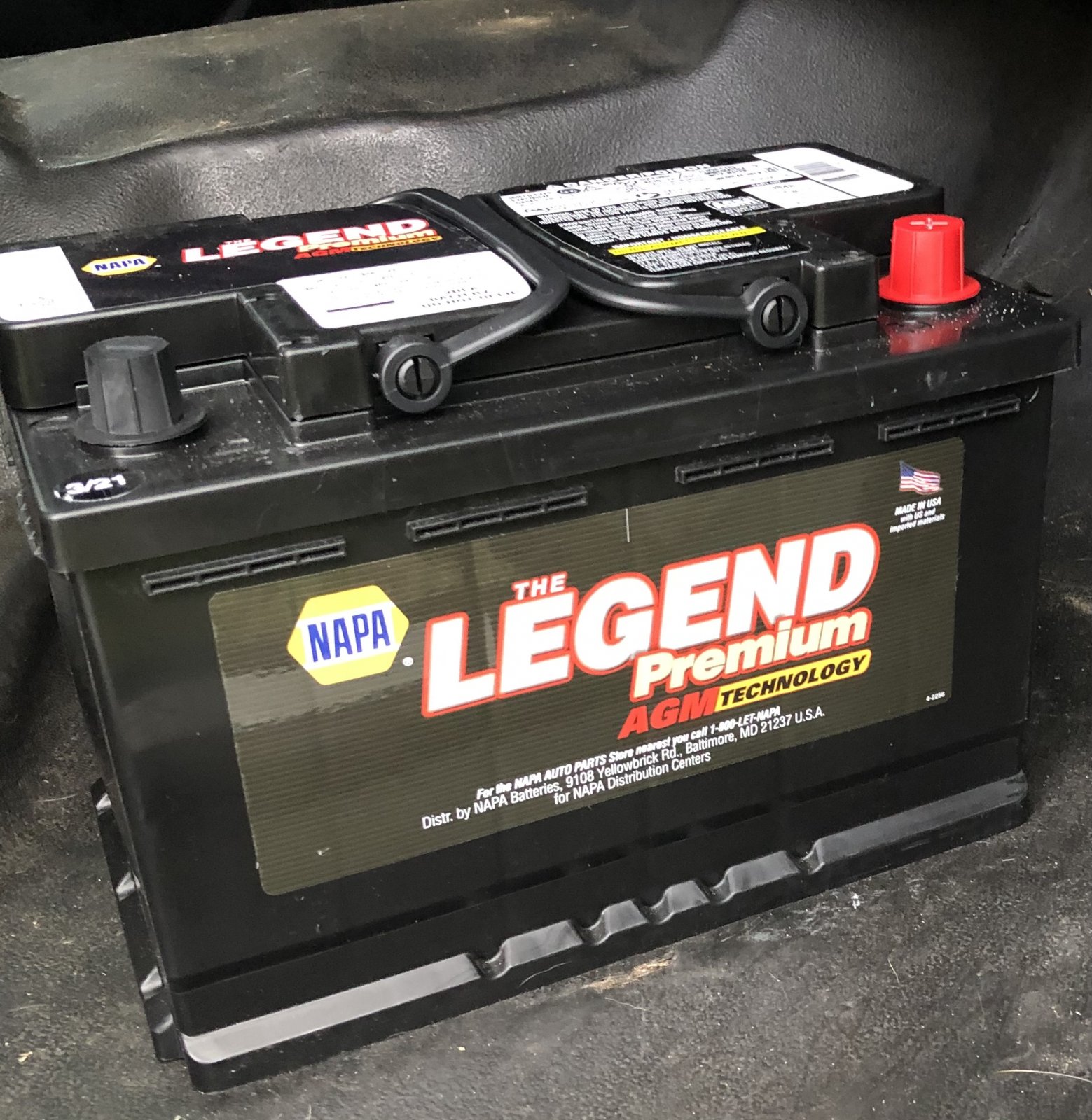

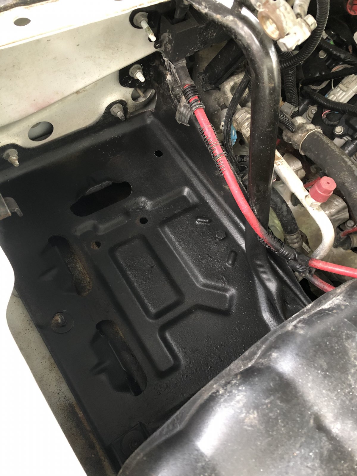

The battery was on life support when I bought the truck, so time to drop in a new AGM. I hate cleaning up acid spills and corrosion so that’s the only type I buy. While I was in there I cleaned up the battery tray and sprayed some rattle can bedliner on it.
View attachment 271507 View attachment 271508
I bought a pair of AGMs to go into thecopcar in December.

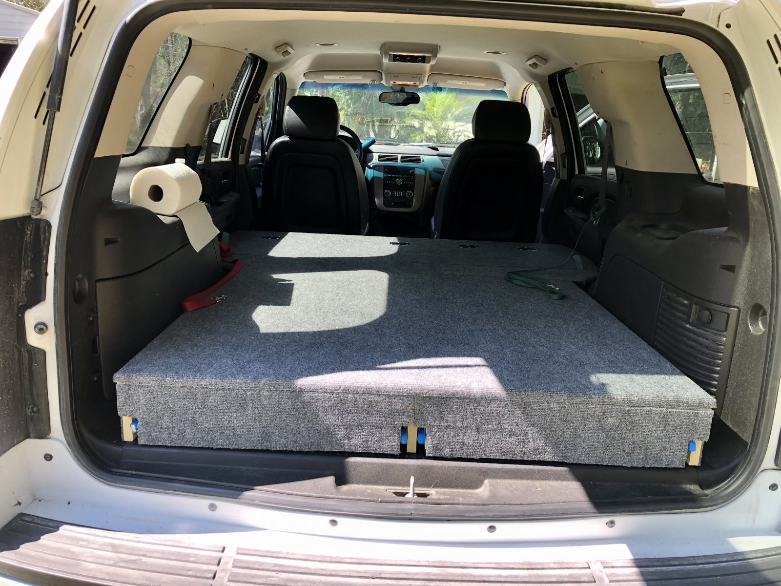

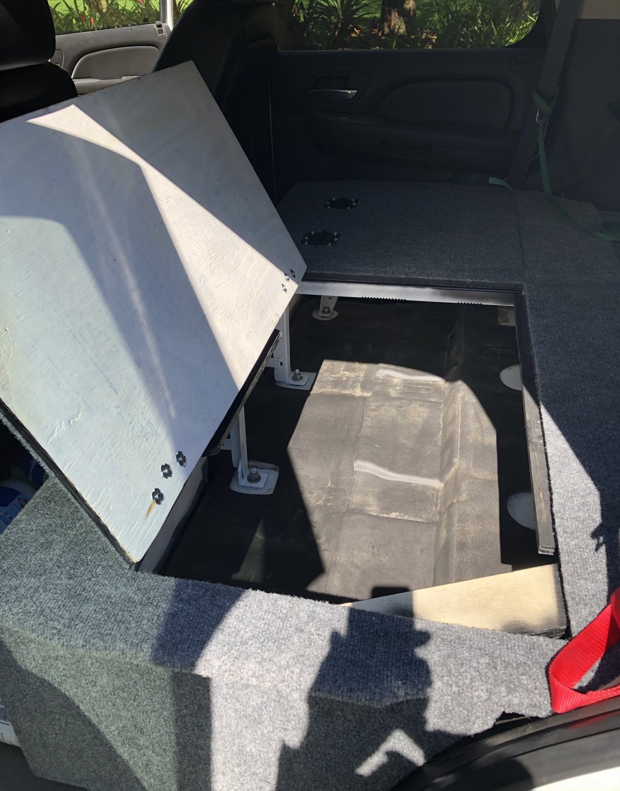

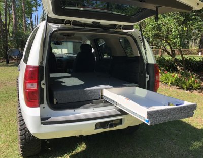

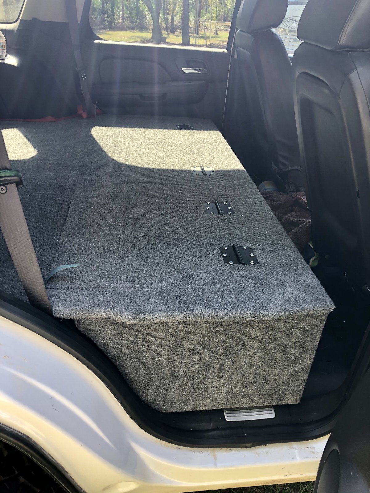

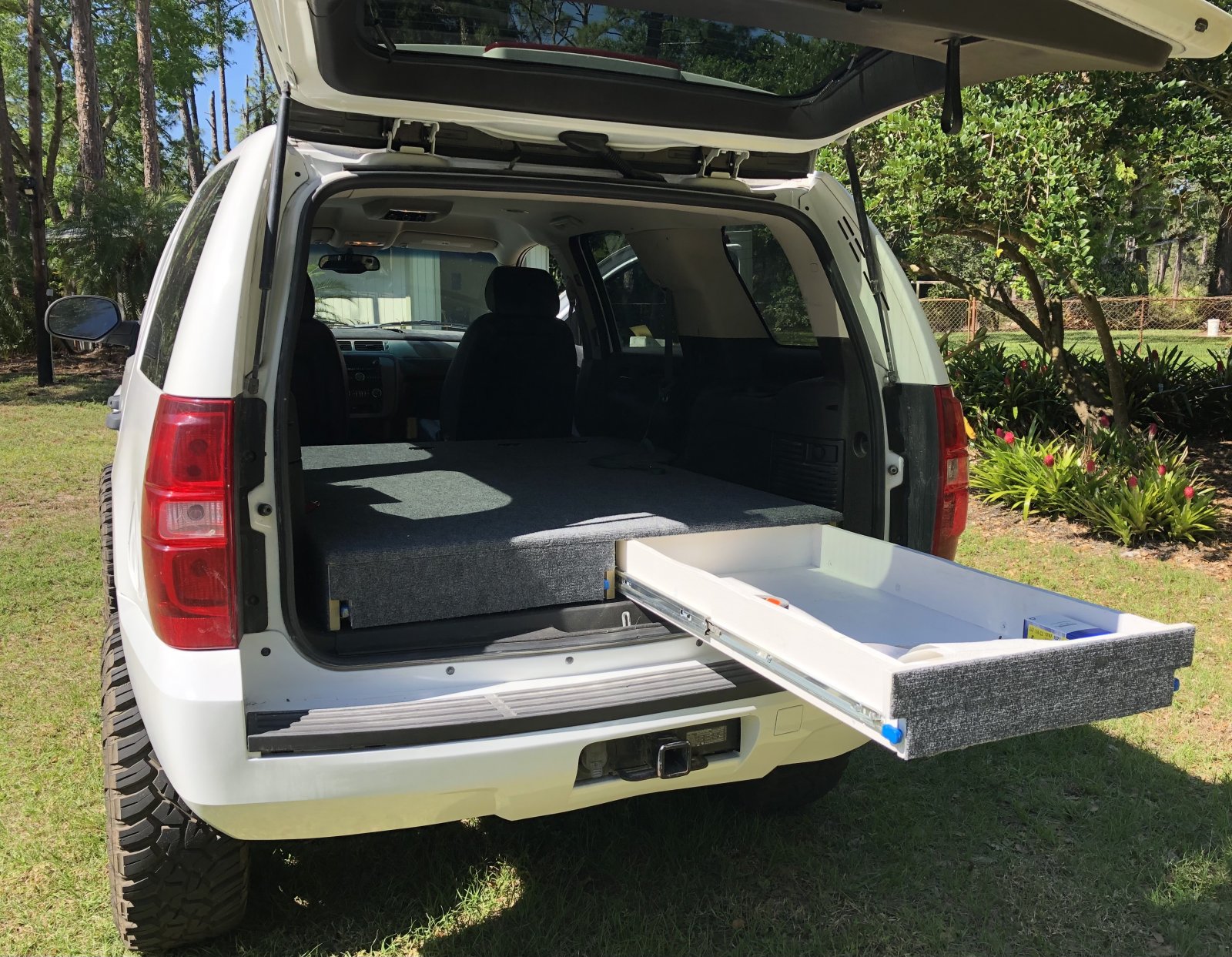

I wrapped up the rear deck and it’s in the more or less finished state. No doubt I’ll do some tweaking after a few trips.
Built in three sections, the rear drawers can be used with or without the rear seats. The sections over the rear seating positions are built 60/40 like the seats so I can run 1 or 2 more seats if I ever need to.
Built with plywood over a steel frame that bolts to the seat mounting points and the cargo ties in the rear. God forbid this thing ever crashes or rolls but if it does I won’t have this flopping around in the cabin. Plus I really hate loose rattling cargo off road.
The drawers will be for miscellaneous small things we access frequently like snacks and dog bowls. Under the front hatches I’ll have tools, recovery gear, clothes, things less often needed or too big for the drawers.
The deck overall is 74" front to rear, so there's enough room for two of us to sleep if ever needed. Two people plus two dogs; well, that may be an issue. :dogpile:
I left enough space between the deck and the front seats so the fronts can still fully recline. So maybe it'll sleep four?
Unseen, but hidden in the front cargo storage I placed some LED strips around the interior. So it won't be a black cave when I'm trying to find something.
The rear drawers are full extension. If I ever get into camping much out of this I'll probably do something more elaborate. But that's not in my to do list at present.

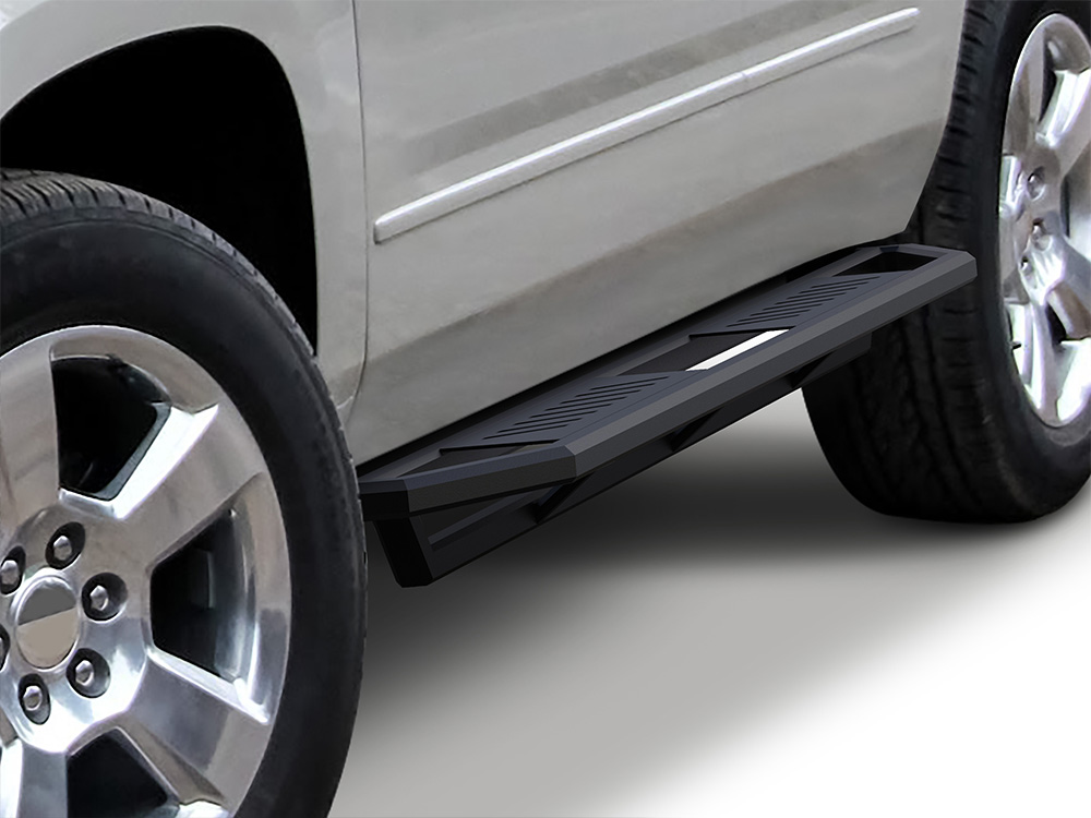

Ordered a set of these inexpensive steps / sliders. Not advertised as "real" sliders but they will give some protection. APS IA03SAC1B.
Stock image, not my photo.
Later on I plan to build my own, as there seem to be no real hard core offroad sliders offered by vendors for Hoes, but I don't have time for that right now and it's a long climb up.
I have a set of those on my wishlist. I’m curious how they do versus the running boards. Also if they are tucked a little higher.
1BADI5
Feb 2, 2014
1,833
2,991
DMV
Yeah if they just mount to the pinch weld/seam.....in the even you rub or smash a rock on the trail, you'll do more damage then good.
Mounting of rock rails needs to be considered, IMO, wait and buy the correct set for you desired needs.
