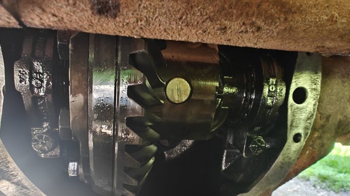

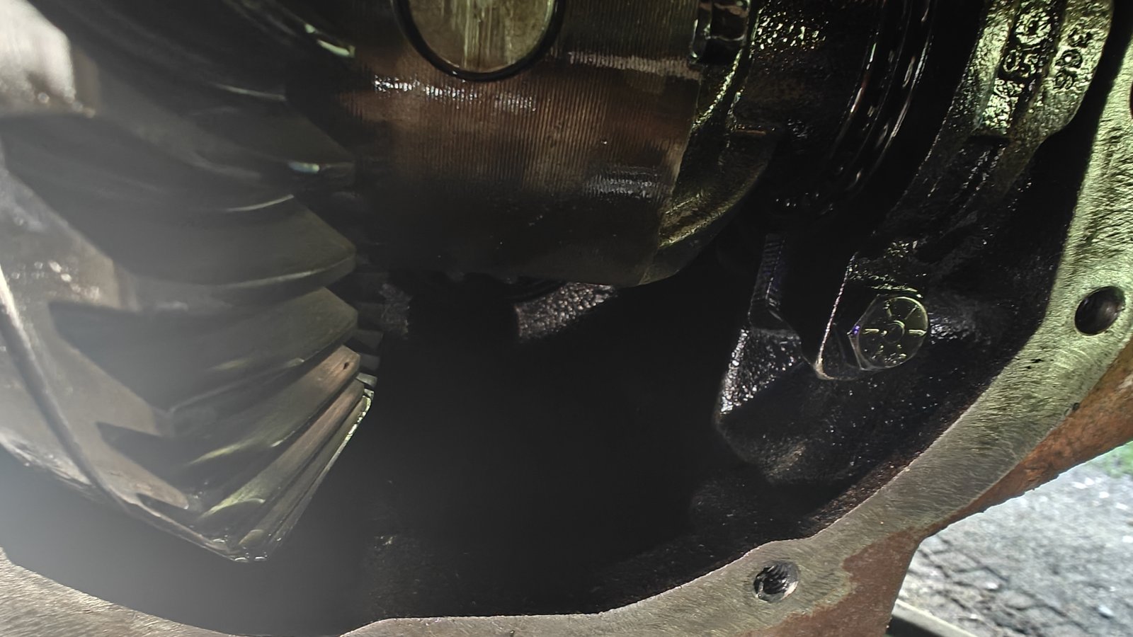

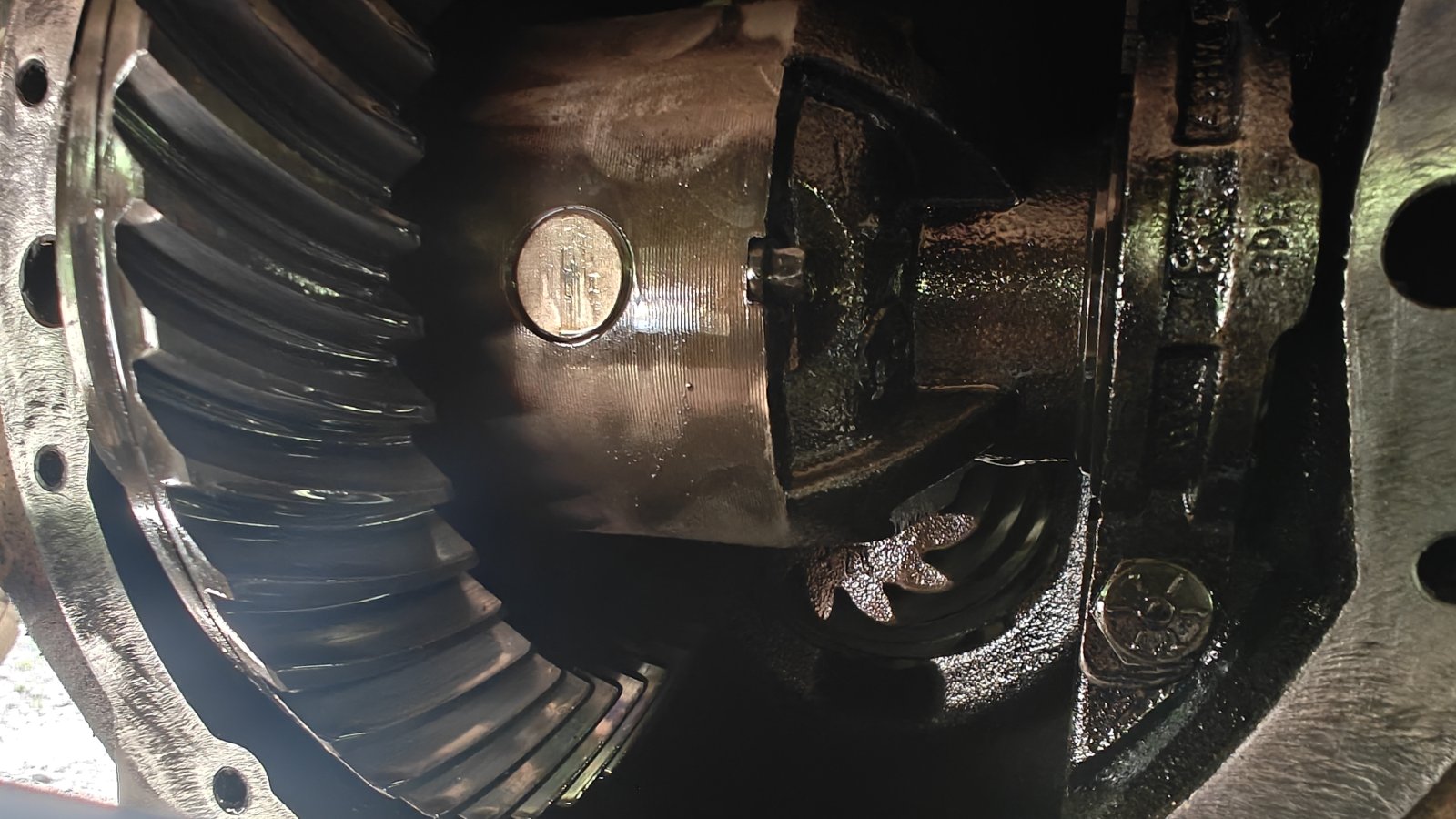

I think I can safely eliminate the rear axle from this. I pulled the cover today and drained the oil to make sure nothing was floating around that wasn't supposed to. The gears all seem to look ok and didn't see anything out of the ordinary. Only a small amount of filings on the magnet for the fill plug.
