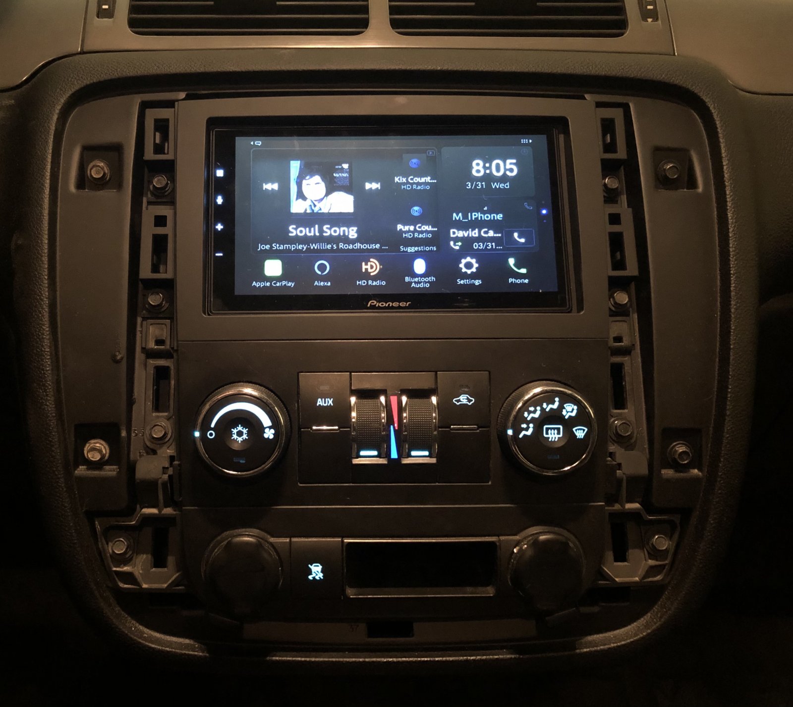

Got the new head unit in, finally. Had some delay waiting for the installation accessories. The only thing I should have done differently is choose a network adapter that supports the speed sensitive volume. I may revisit that someday.
This is a Pioneer DMH-4660NEX. Other installation parts below.
My main reason for choosing this model was the support for wireless CarPlay.
The dash trim is out in the photo because I’m still waiting on a USB socket to replace one of the cigarette lighter sockets.
Supporting components:
Metra 95-3305 Double DIN Installation Multi Kit
Metra 40-CR10 antenna adapter
PAC LCGM29 Radio Replacement Interface (as mentioned above this item does not support speed sensitive volume)

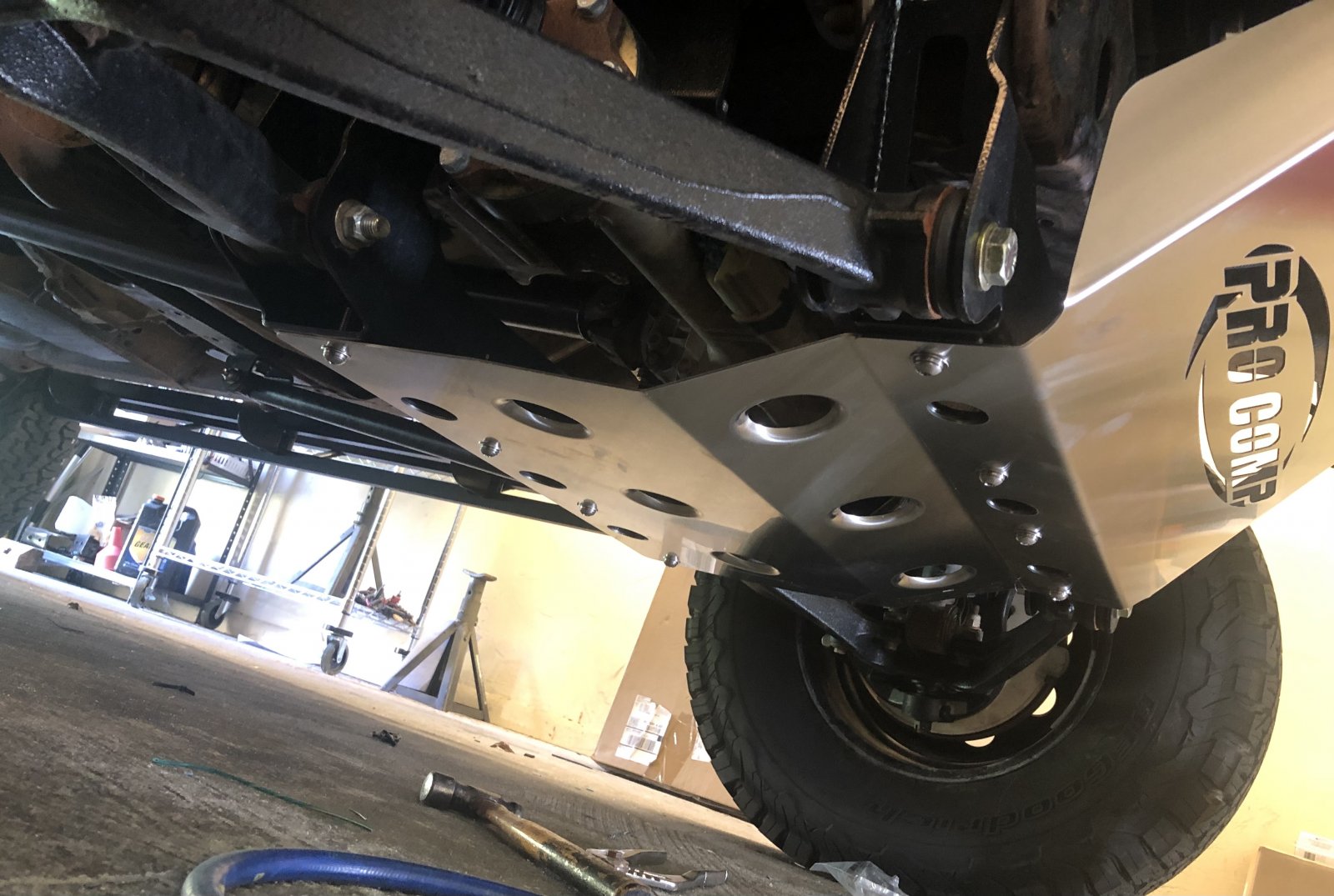

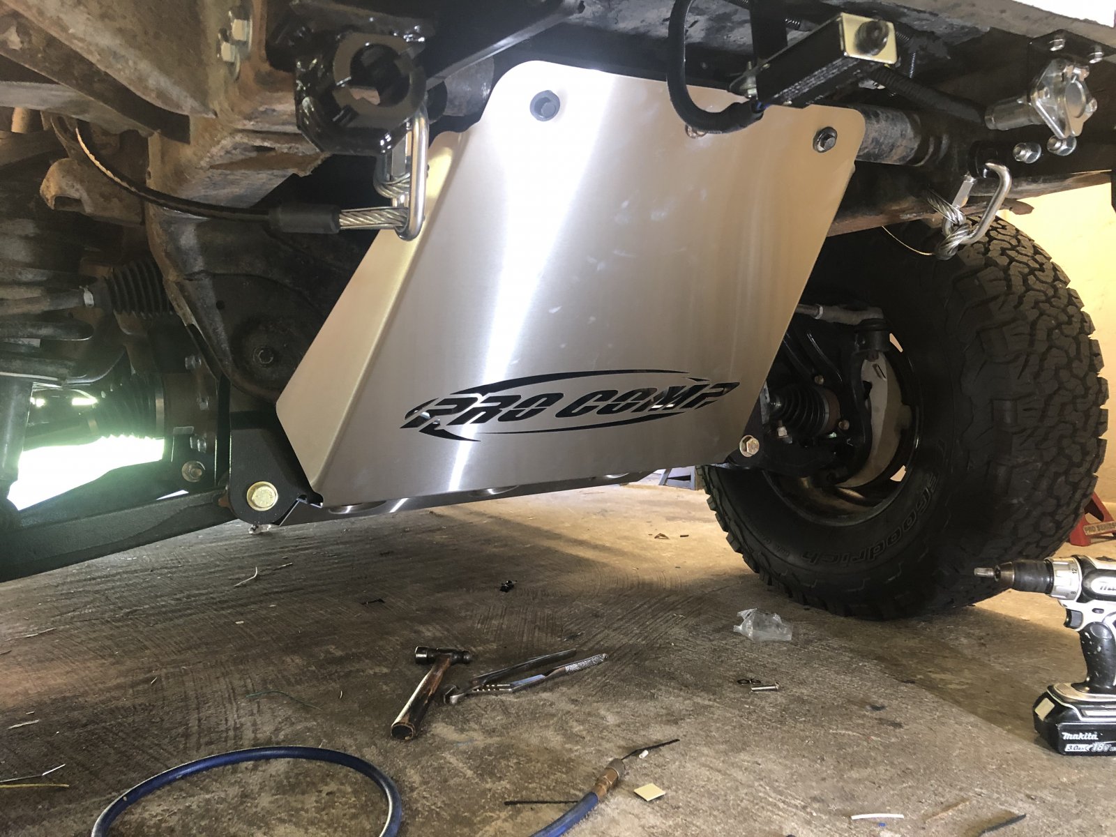

Today I installed the ProComp front skidplate. It's a separate item, not included with the lift kit. Fit and finish is great. All stainless. I can't wholeheartedly recommend it, because although it's not cheap, it's made with thin material, and worse, weakened in the center because they laser cut their logo through it. I guess the marketing department won that debate with engineering.
Of course they covered themselves with this legal garbage: "This item is designed as a decorative accessory item. It is not intended to provide additional vehicle safety or protection."
This precaution of course, is supplied in the INSTALLATION INSTRUCTIONS, not the ADVERTISING.
My own assessment- it's adequate for keeping brush and debris out of the front of the engine and the underside. Which is all I really need it for. Rock crawling protection it is NOT. Later on when time permits I'll pull it off and reinforce the backside with some heavier material.
In all the searching I've done for skid plates I've found two. The factory z-71 plate for ~$450, or that one. I didn't like the logo at all, then if your REALLY DIG hard, you find the fine print about it being matched with their lift kit.

Yeah, @Sparksalot you’d need different skids depending on the lift situation because the big lifts with drop cross members change the lower front mounting points.
It would be relatively simple fabrication to build these from scratch for anyone with metal working tools. I simply don’t have the time now, so I got these. And I’m not building a rock hopper anyway. I don’t even enjoy trails that rough when the machine is built for it. Too slow for my taste.
If I wasn’t lifted I’d go prowling the junkyards for the Z-71 part or just buy some steel plate and start cutting and bending.
Finding any of the nnbs hoes in a junkyard seems like a unicorn search. Most of them are being parted out on eBay. But even there, I’ve only seen new pieces up for sale.
I’m not after rock protection per se, but unwanted pokey stuff coming through the plastic splash guard. I did fab a very light sheet steel piece that fit behind the plastic. I have a heavier piece of aluminum I recently acquired to replace it sometime.
